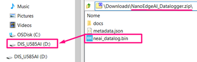

After generating the data logger, you have downloaded a “NanoEdgeAI_Datalogger” (*.zip) file with a binary (*.bin) file in it. Connect your board to your PC, then drag and drop this binary file to your connected board.
Figure 5 - Binary Programming (Drag and Drop)Figure 5 - Binary Programming (Drag and Drop)

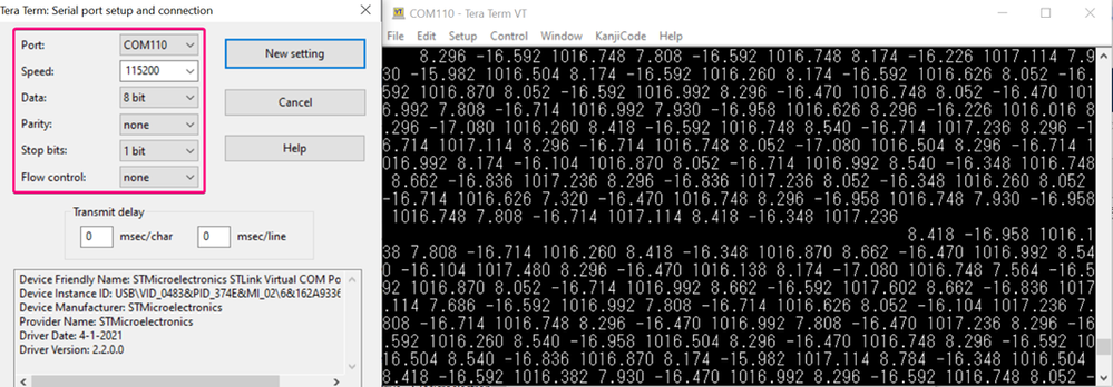

The onboard STLINK’s COM LED blinks while the binary is flashed onto the board. You can check the data logger in action by opening a VCOM Terminal and configuring it to your board’s serial communication settings.
For example, when using Tera Term, you can see the board’s sensor raw data being printed on the terminal:
Figure 6 - Raw Data DisplayFigure 6 - Raw Data Display
