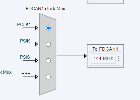

  • Ensure that the FDCAN clock source is derived from the system clock or a dedicated peripheral clock with minimal jitter.

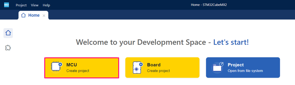

Open STM32CubeMX2. On the Home page, click the [MCU square] to create a new project.

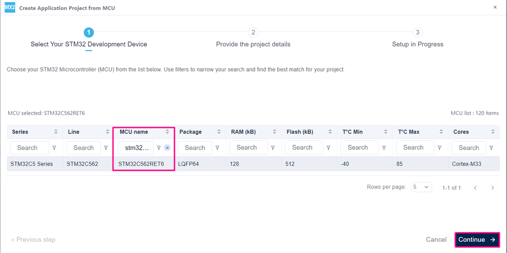

In the search field under MCU name, enter STM32C562RE and select your board. Click [Continue].

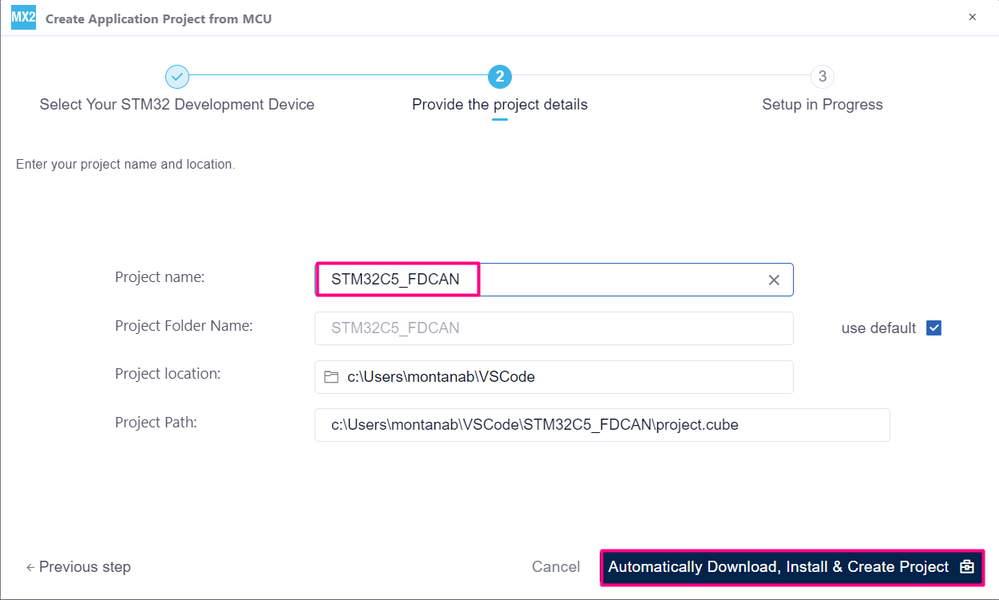

Enter your project name and location. Click [Automatically Download, Install & Create Project] to finish project creation.

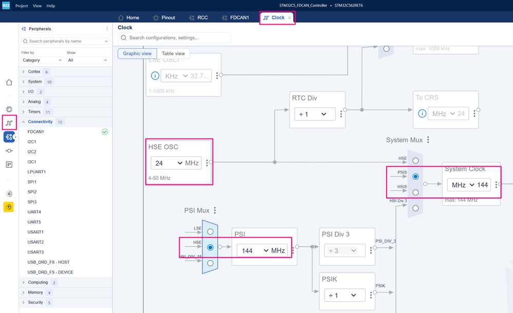

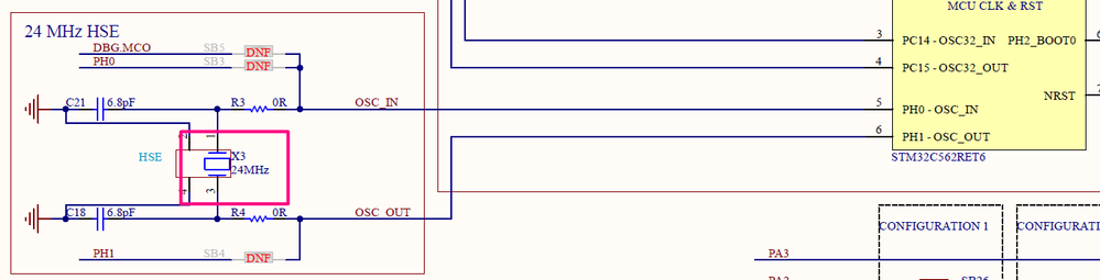

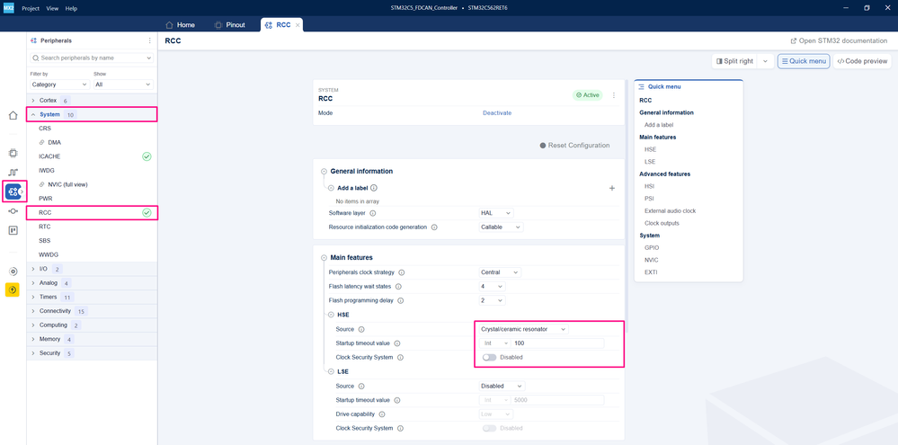

Go to the "Peripherals" → "System Core" → RCC and enable the HSE. The Nucleo board has a 24 MHz crystal available:

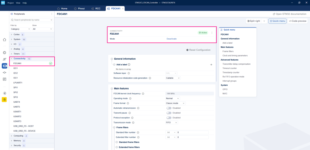

Go to "Peripherals" →"Connectivity" → FDCAN1 and enable the FDCAN1 peripheral.
Go back to the "Clock" tab and adjust the FDCAN1 origin clock, HSE value, and PSI:

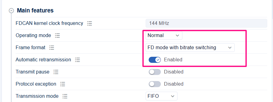

Configure the operating mode and frame format.

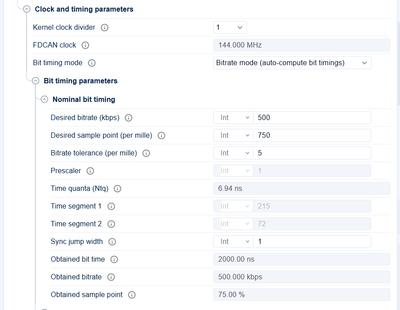

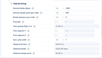

Configure the bit timing parameters, including the desired bitrate. In this case, 500 kbps was chosen.

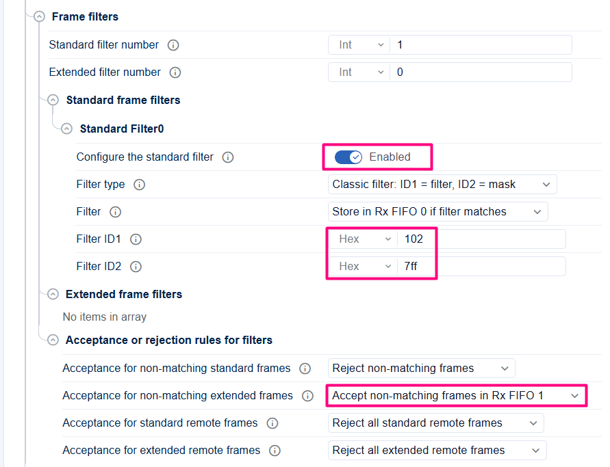

Configure the required filters. In this case, only the standard filter is used. Non-matching frames are directed to Rx FIFO1.

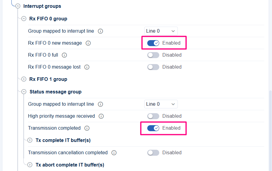

Enable the Rx FIFO 0 for new messages and the transmission completed status message.

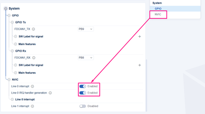

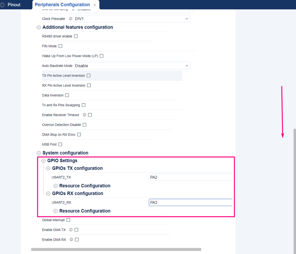

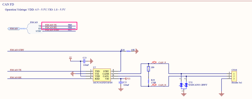

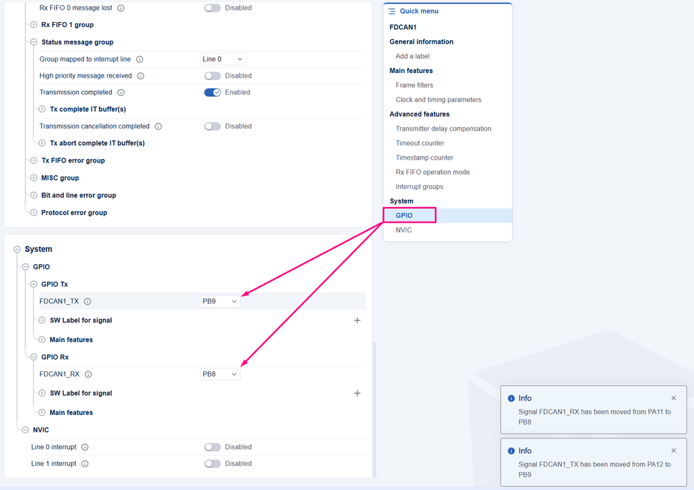

Make sure your GPIOs are allocated based on the hardware.
Enable [Global Interrupt] and [IRQ handler generation] if you plan to use interrupt-driven communication.

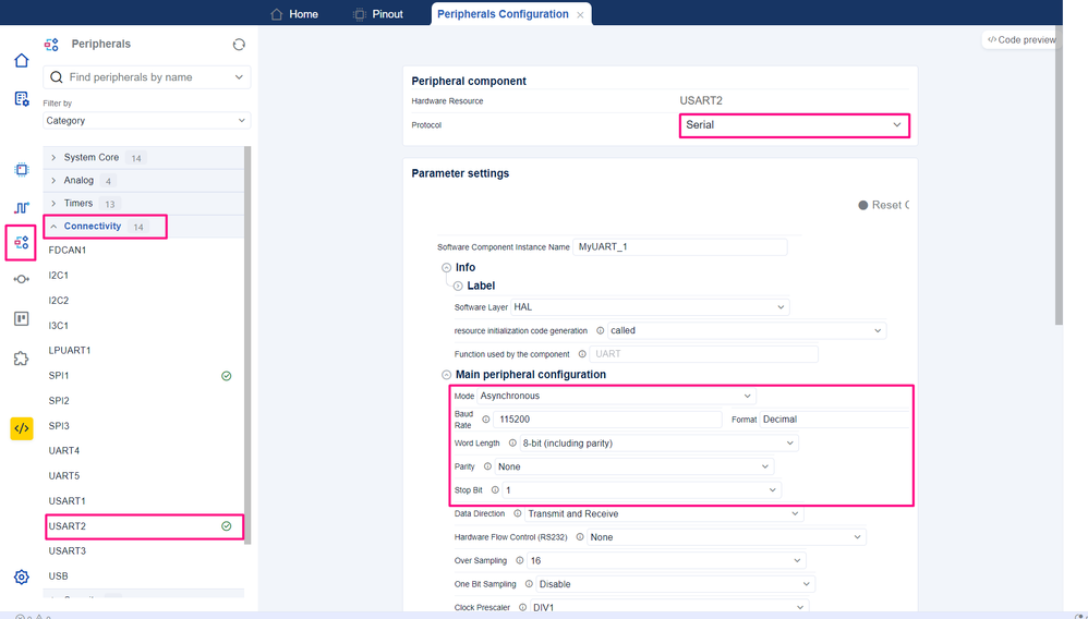

Optionally, configure additional GPIO like LED or UART for status indication. In this case, a simple printf is used, so UART2 with PA2/PA3 is added.

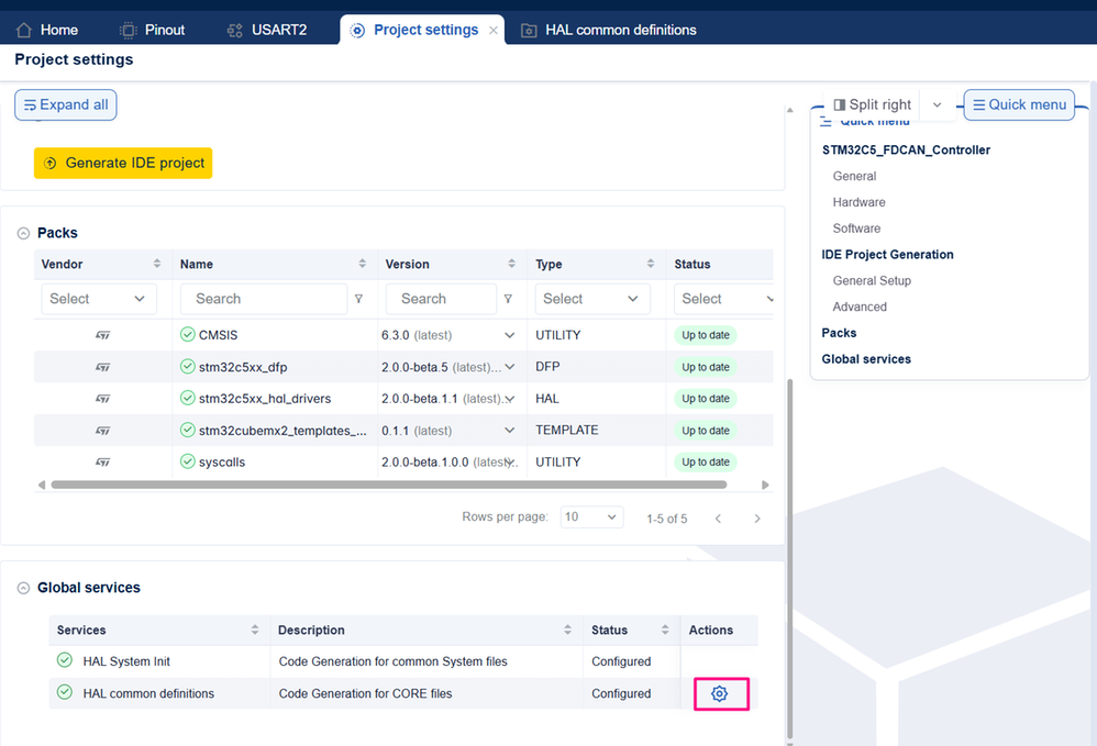

  2. Under "IDE Project Generation", select your IDE (for example, CMake for STM32Cube for Visual Studio Code).

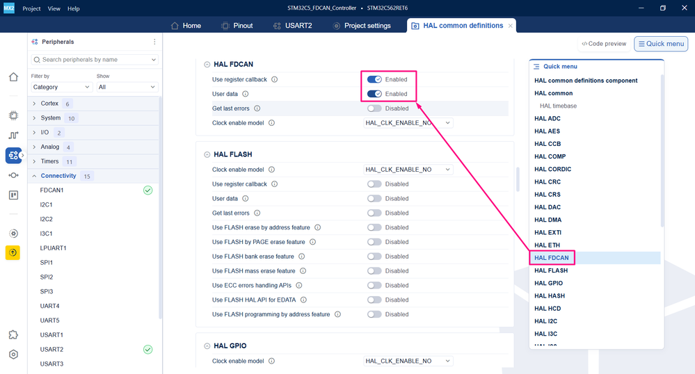

  3. Locate the Global services and click on the Actions’ engine to add the register callback.

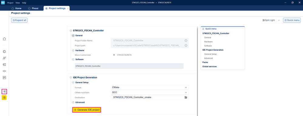

  1. Go back to the "Project Settings" tab and generate the project.
Click Generate Code and open the generated project folder in your IDE.

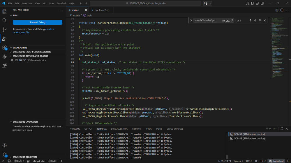

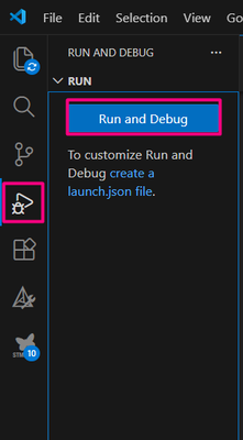

5. Configuring the project in Visual Studio Code
Open Visual Studio Code and open the project folder.

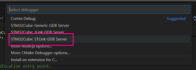

You are prompted with a selection. In case you miss click or that does not appear, press Ctrl+Shift+P, type CMake: Select Configure Preset, and choose your debug configuration.
Build the project to ensure that everything is properly set and then we move to the implementation code.

Once in debug mode and before running the code, press Ctrl+Shift+P, type Open Serial, select COMXY (STMicroelectronics), and set the baud rate to 115200. The communication runs in an endless loop, and it is possible to open two serial monitors to check both sides of the communication.
