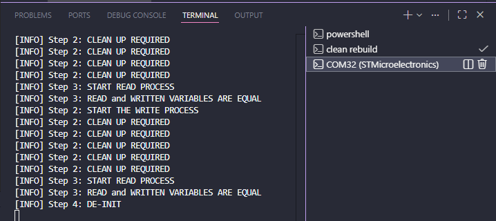

The Visual Studio Code example demonstrates this pattern by checking for EE_INFO_CLEANUP_REQUIRED after each write and calling EE_CleanUp() when needed.

The example code checks these return values and:
  • Calls EE_CleanUp() when cleanup is requested.
  • Aborts the scenario and reports an error if an unexpected status is returned.

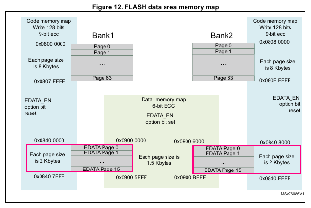

EDATA sector overview
On STM32C5, the EDATA region is a dedicated 64 Kbyte FLASH sector intended for EEPROM emulation:
  • Total size: 64 Kbytes
  • Banks: 2 banks
  • Pages per bank: 16 pages
  • Page size: 2 Kbytes
This organization provides:
  • Small page size, which improves endurance and flexibility for wear leveling.
  • A dedicated region, separated from the main program FLASH, simplifying memory mapping and protection.

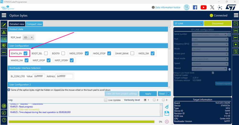

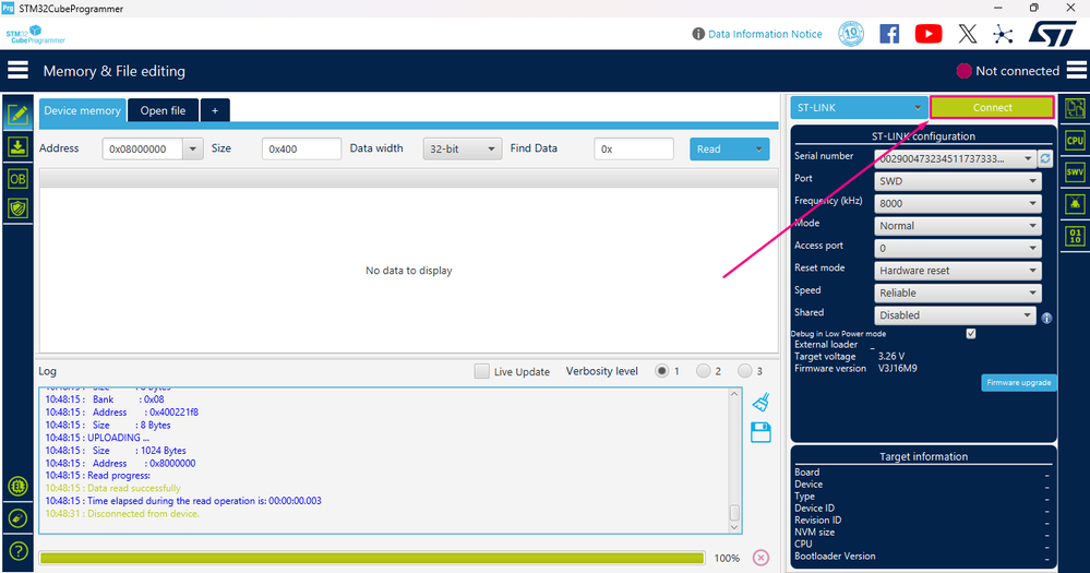

Configuring EDATA via STM32CubeProgrammer
The EDATA region is enabled and configured outside the Visual Studio Code project, using STM32CubeProgrammer:
  1. Launch STM32CubeProgrammer and connect the NUCLEO-C562RE board to the host PC using the USB Type-C® cable.
  2. Select the appropriate connection interface, then click [Connect].
  1. Open the Option Bytes tab and enable [Compact View].
  2. In the User Configuration section:
    • Enable the EDATA (EDATA_EN) option to activate the EDATA sector for 16‑bit or 32‑bit data granularity, consistent with the EEPROM emulation driver configuration used by the example.
  1. Click [Apply] to write the option bytes and let the device reset if requested.
With EDATA correctly enabled and configured, proceed to the next section to observe the structure of the Visual Studio Code and CMake example and how it maps the EEPROM emulation driver onto this dedicated FLASH region.

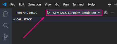

The example is provided as a ready-to-build Visual Studio Code, CMake, and GCC project. The layout is:
  • generated/hal: System and device initialization (startup, clock configuration, HAL init, mx_system_init()).
  • stm32c5xx_drivers/: STM32C5 HAL and low-level drivers.
  • utilities/eeprom_emulation/: Complete EEPROM emulation driver, split into:
    • Core API: eeprom_emul_core.c/.h
    • Algorithms: eeprom_algo_flitf.c/.h, eeprom_algo_nvm.c/.h
    • Interfaces:
      • Flash: eeprom_itf_flash.h, eeprom_itfflash_flitf_edata.c, eeprom_itfflash_nvm_edata.c, templates
      • CRC: eeprom_itf_crc.h, eeprom_itfcrc_crc.c, template
      • ECC: eeprom_itf_ecc.h, eeprom_itfecc_bch.c, template
  • eeprom_mx_config: Glue and configuration:
    • eeprom_emul_conf.h – configuration of the emulation (algorithm selection, EDATA mapping, endurance, and variable count).
    • mx_eeprom_emul.c/.h – glue tying the generic driver to STM32C5 HAL flash and CRC handles.
  • Application:
    • example.c/.h – demonstration scenario: initialization, write, cleanup, read and verify, de-initialization.
    • main.c/.h – system entry point, example loop, and LED/status reporting.
  • Build configuration:
    • CMakeLists.txt and related CMake files to drive GCC.
    • Visual Studio Code configuration files (.vscode/) to build, flash, and debug via the STM32Cube extension.

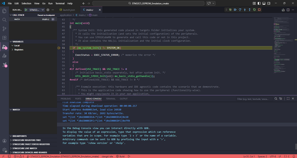

4.4 Application scenario (example.c)
The application layer shows how to use the EEPROM emulation API in a real sequence. It is structured into four steps, exposed via three functions:
  • app_init()
  • app_process()
  • app_deinit()
and controlled by main.c.
Overall flow
  • Step 1 – Initialization (app_init): Call mx_eeprom_emulation_init() and report success or failure.
  • Step 2 – Write all variables and handle cleanup (app_process, first part): Write 1000 8‑bit variables (IDs 1..1000) into the emulated EEPROM, handling EE_INFO_CLEANUP_REQUIRED.

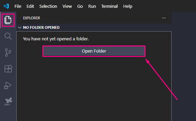

  • Launch Visual Studio Code.
  • Select Open Folder.

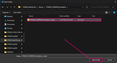

  • Browse to and select the root folder of the EEPROM Emulation project.
  • Click Select folder to load the project into VS Code.

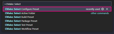

  • Press Ctrl+Shift+P and [CMake: Select Configure Preset].
  • Select [debug_GCC_NUCLEO_C562RE].

Using the existing STM32C5_EEPROM_Emulation configuration
The project provides a launch.json file with a debug configuration named STM32C5_EEPROM_Emulation, based on the STM32Cube ST-LINK GDB server. You do not need to create or modify it; just select and use it.
  1. Open the Run and Debug view
    • Press Ctrl+Shift+D (Run and Debug) in VS Code.
    • In the configuration drop‑down, select:
  2. Start debugging
    • Connect the NUCLEO‑C562RE board to your PC via USB Type-C® (ST‑LINK).
    • With STM32C5_EEPROM_Emulation selected, press F5 or click Start Debugging.
  • The debugger launches the ST‑LINK GDB server and start your application.
  • Execution halts at main().

Stepping through the EEPROM Emulation example
To understand and validate the EEPROM emulation flow, set breakpoints in the key functions:
  • Initialization path
    • main() – the overall control flow (mx_system_init(), app_init(), loop).
    • app_init() – calls mx_eeprom_emulation_init() and reports init status.
    • mx_eeprom_emulation_init() – calls EE_Init() and binds FLASH/CRC handles.

  • Console logs (if USE_TRACE=1)
In the serial/ITM output, you should see:
  • [INFO] Step 1: EEPROM INITIALIZATION COMPLETED.
  • [INFO] Step 2: START THE WRITE PROCESS
  • Optionally [INFO] Step 2: CLEAN UP REQUIRED when cleanup is triggered
  • [INFO] Step 3: START READ PROCESS
  • [INFO] Step 3: READ and WRITTEN VARIABLES ARE EQUAL
Any [ERROR] message indicates where the scenario failed (init, write, read, or comparison).

  • Initialization errors
    • Check EDATA option bytes in STM32CubeProgrammer (EDATA_EN enabled, granularity matches the driver).
    • Verify that the CRC is correctly initialized in the system startup code.
    • Confirm that MX_EEPROM_FLASH_HANDLE() and MX_EEPROM_CRC_HANDLE() return valid HAL handles.
  • Write/read mismatches
    • Look for ERROR RETURNED BY EE_WRITE FUNCTION or ERROR RETURNED BY EE_READ FUNCTION in the logs.
    • If needed, perform a one‑time EE_Format(EE_FORCED_ERASE) or erase EDATA to clear previous test data.
