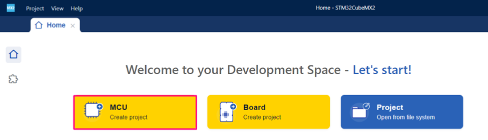

  1. Open STM32CubeMX2. On the Home page, click the MCU square to create a new project.

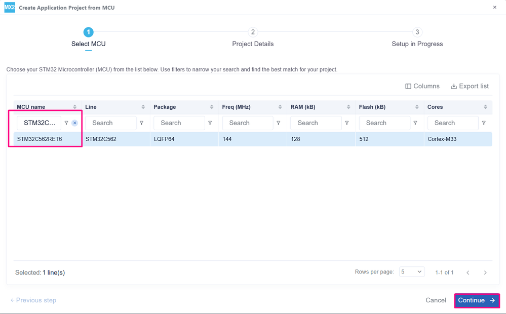

  1. In the search field under MCU name, enter STM32C562RE and select your board. Click Continue.
  1. Enter your project name and location. Click [Automatically Download, Install & Create Project] to finish project creation.

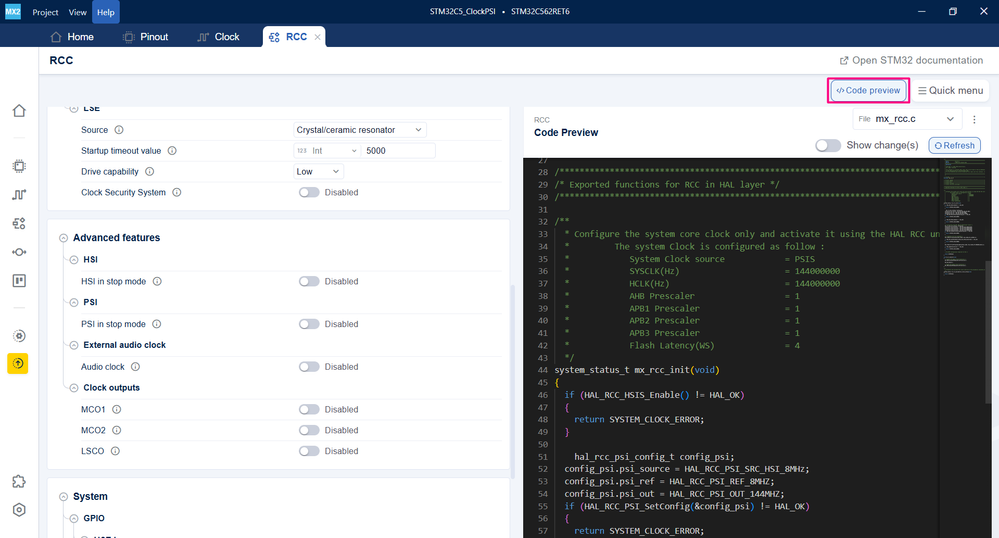

9.2 Clock tab use case

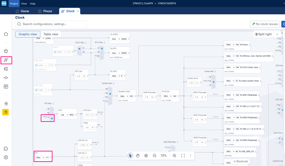

The default view shows the HSI being used as the entry point of the PSI.
Notice that the LSE and HSE are not available at this point in time, as it is necessary to enable them via the Peripherals/System/RCC.
Each one of those options, when changed, cause your generated code to change. To see it in the code before generation, the [Code Preview] can be used.

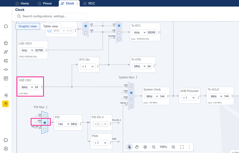

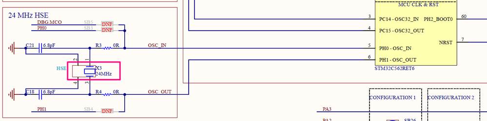

Let’s change the clock source to use the 24 MHz HSE, available on the NUCLEO board as well as the 32.768 kHz for the LSE.
In the "Clock" tab, change the PSI entry point and HSE value.

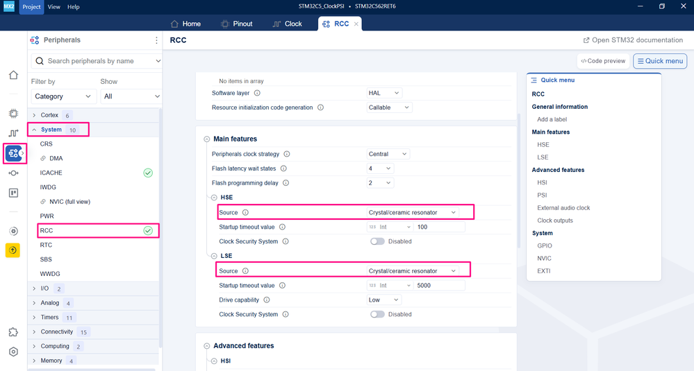

Now, go back to the RCC peripheral tab and use the code preview to inspect the change:
