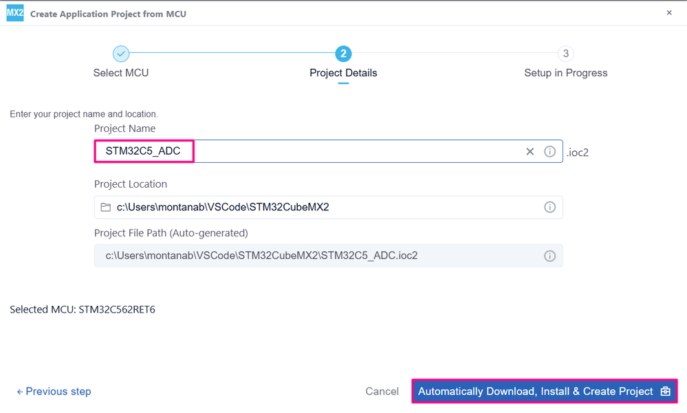

Enter your project name and location. Click [Automatically Download, Install & Create Project] to finish project creation.
Select [Launch Project] to start.

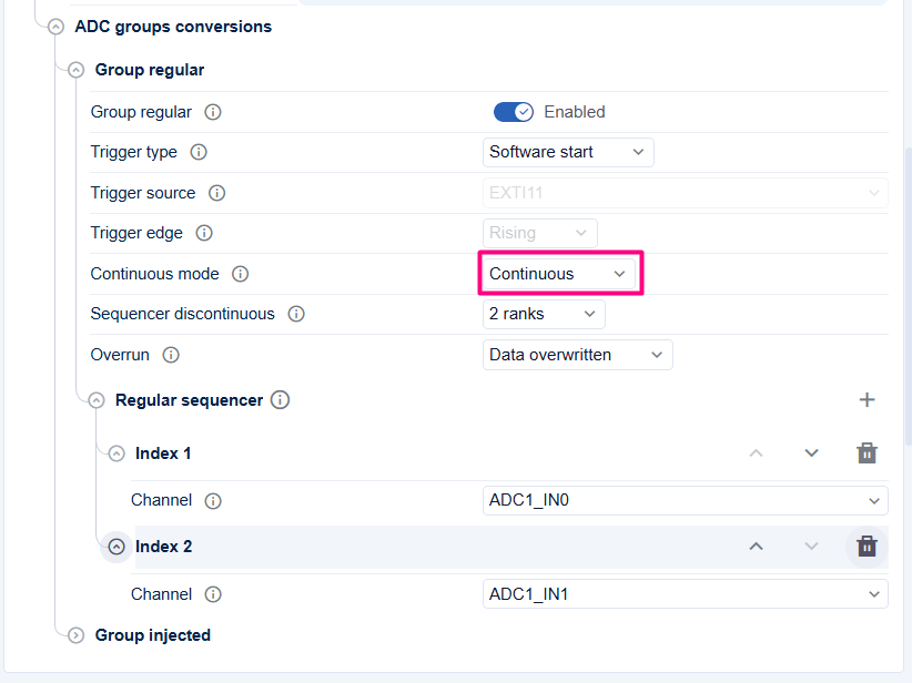

The ADC can be configured in several different modes, but for simplicity, two channels are used to showcase the typical application. A continuous conversion, scanning the channels.

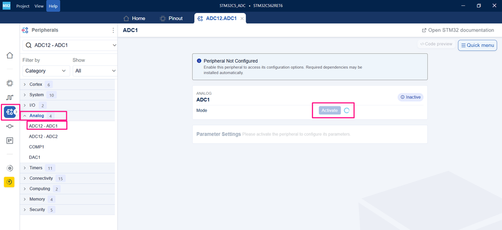

Go to Peripherals → Analog → ADC1 and enable ADC1.

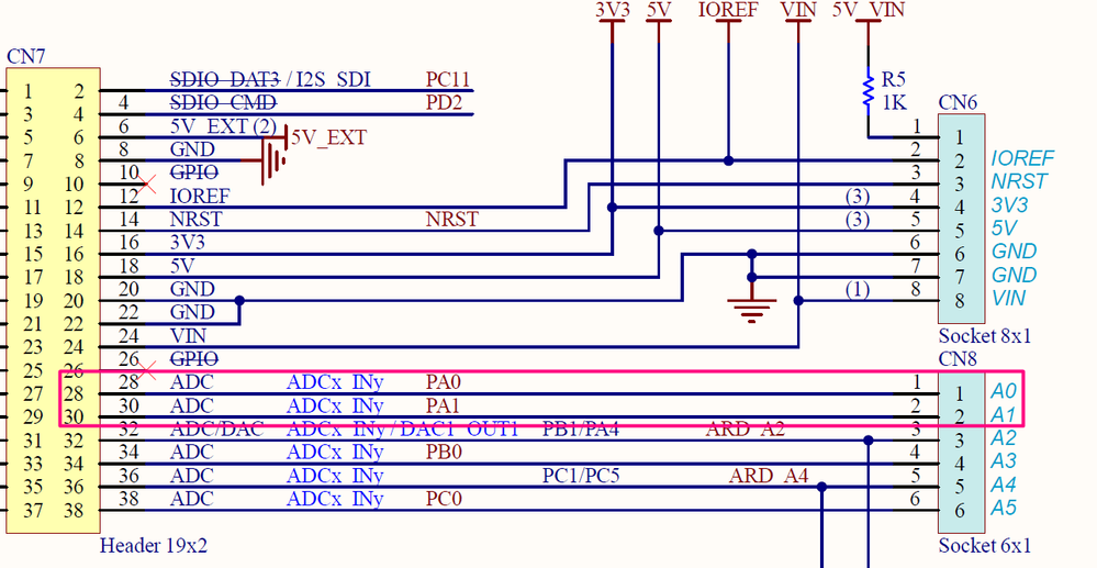

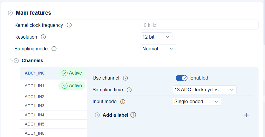

Enable Channel 1 and Channel 2, those will be allocated at PA0 and PA1, readily available at CN7 and CN8.
Configure the channels to have the desired sampling rate and to work as single-ended.

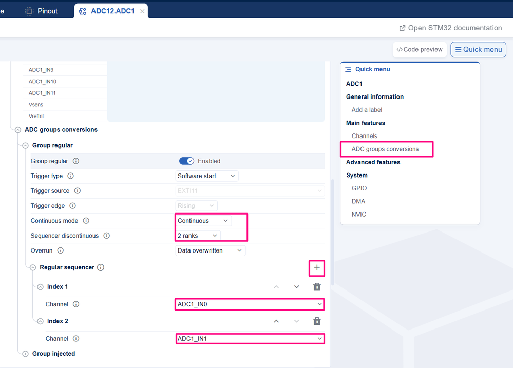

In ADC group configuration, select the Continuous Mode, sequencer with 2 ranks, so we can assign each channel an order and then, set the index order.
Optionally, in this same area, one can enable the NVIC as well as the DMA, but for now, we focus on the polling method.

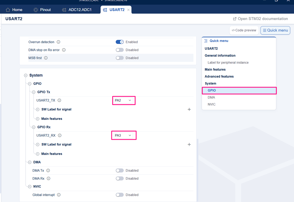

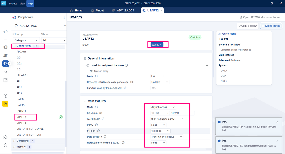

1.3 Optional configuration for printf

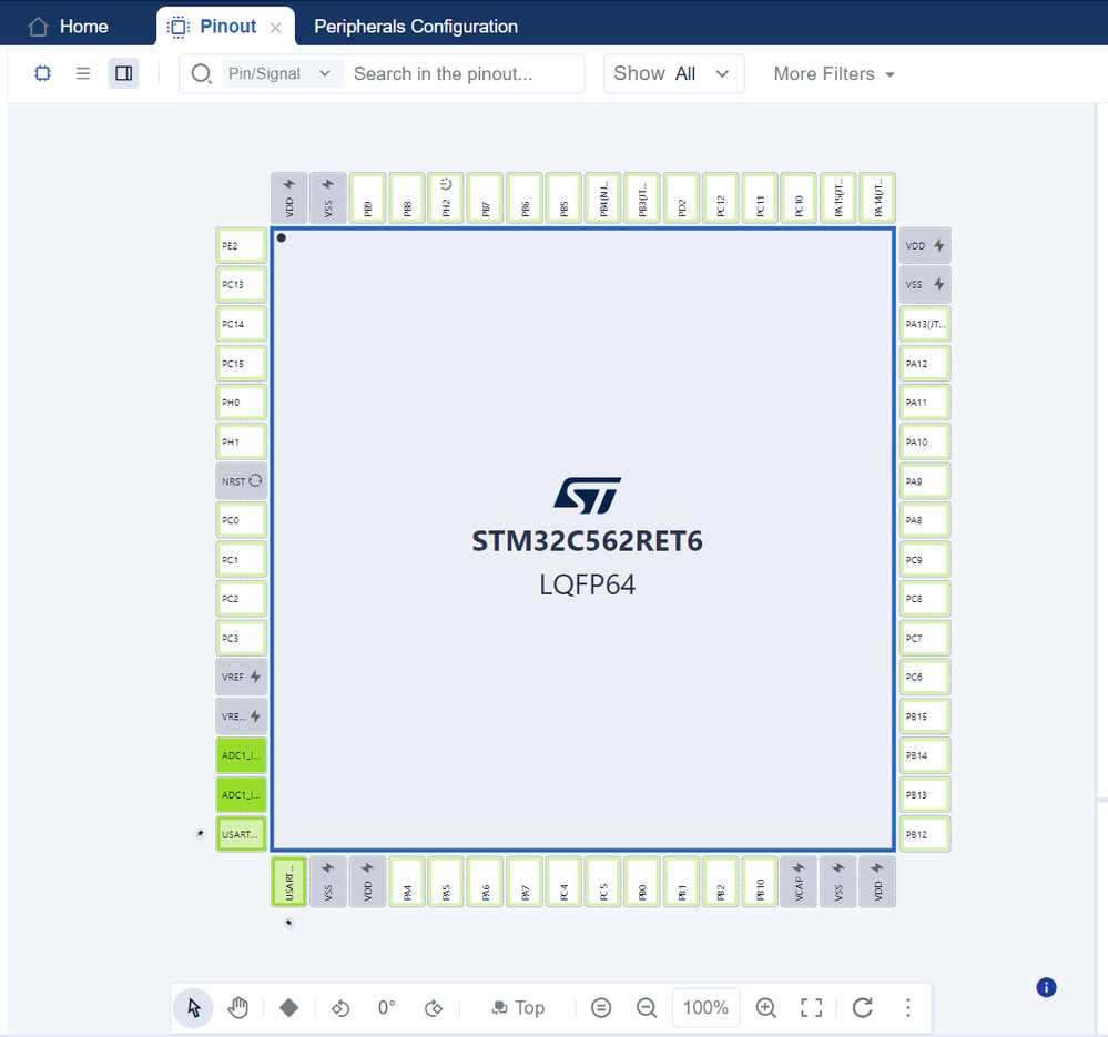

In the "Pinout" tab, it’s possible to double check the two pins allocated for the ADC as well as configure the PA2 and PA3 for UART2, to allow printf.
Configure the UART2.

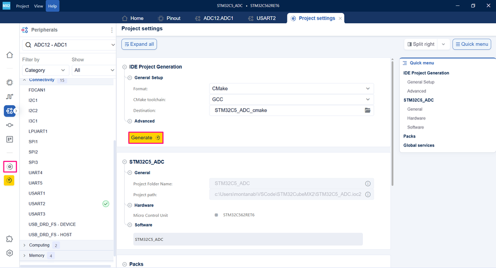

1.4 Code generation
To generate the code:
  1. Click on the [Project settings] icon and select the desired IDE.
  2. Click the [Generate] button.

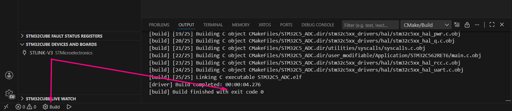

2. Configuring the project in Visual Studio Code
Open Visual Studio Code and open the project folder.
If prompted, select the configuration. If not prompted, press Ctrl+Shift+P, type CMake: Select Configure Preset, and choose the debug configuration.
Build the project to ensure everything is set, then proceed to code implementation.

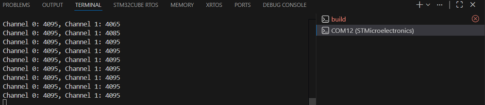

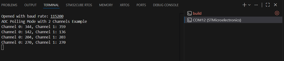

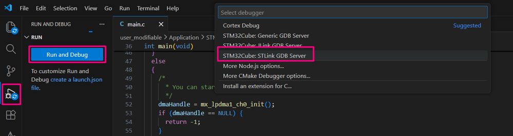

3.1.1 Validation
After building the application, select the [Run and Debug] icon. Create a debug session by selecting the STLINK GDB Server option.
Press Ctrl+Shift+P and type [Open Serial] > COMXY (STMicroelectronics) > 115200.
PA0 and PA1 floating:
It might be simpler to ensure that you have the proper data by connecting the PA0 and PA1 to a known voltage, such as GND or 3v3, available on the nearby connector. In this case, both were tied to the board’s 3v3

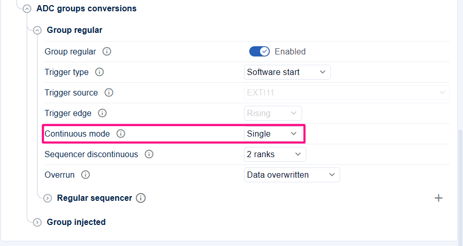

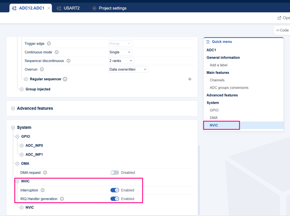

3.2.1 STM32CubeMX2 editing
In the ADC tab, change the ADC settings from "Continuous" to "Single".
And using the Quick menu to navigate, click in the NVIC and enable it.

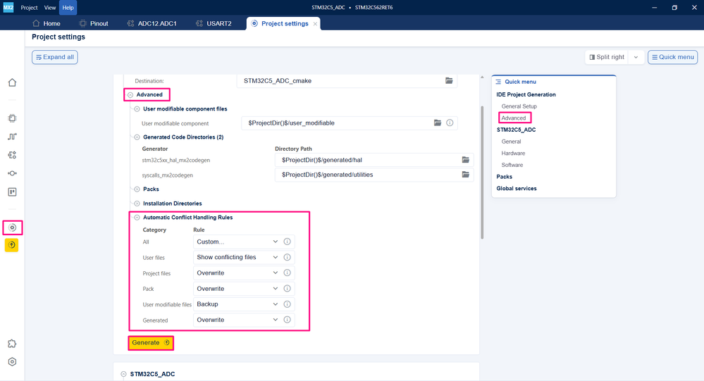

Generate the code. To either keep or backup the previous user files and other aspects of the project, use the "Advanced setup" to customize according to your needs.

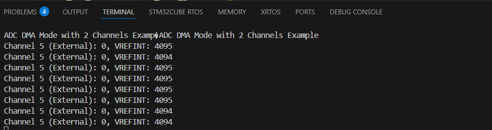

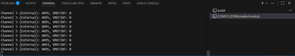

3.2.3 Validation
Enter in debug mode and monitor the change. A breakpoint can be added in the callback.

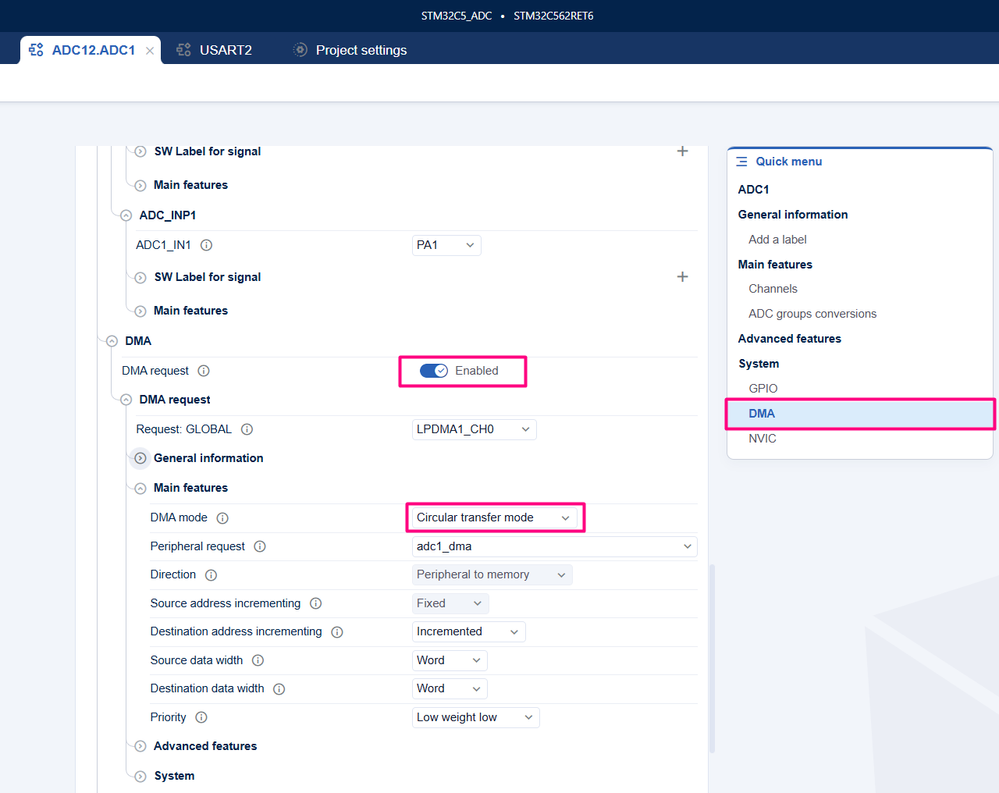

3.3.1 STM32CubeMX2 editing
In the ADC tab, change the ADC settings back to [Continuous] and Enable the DMA in Circular transfer mode.
Generate the code. To either keep or backup the previous user files and other aspects of the project, use the Advanced setup to customize your needs.

    while (1) {
#ifdef USE_DMA
      if (adcConvComplete) {
        adcConvComplete = 0;
        printf("Channel 5 (External): %lu, VREFINT: %lu\r\n", adcValues[0],
               adcValues[1]);
        HAL_Delay(1000);
        HAL_ADC_REG_StartConv_DMA(mx_adc1_gethandle(),adcValues,ADC_CHANNEL_COUNT* sizeof(uint32_t));
#endif
#ifdef USE_IT
               adcValues[1]);
        HAL_Delay(1000);
        HAL_ADC_REG_StartConv_IT(mx_adc1_gethandle());
#endif
#ifdef USE_POLLING
      for (int i = 0; i < ADC_CHANNEL_COUNT; i++) {
        // Configure ADC channel rank dynamically if needed
        // Or rely on scan mode configuration in CubeMX
        if (HAL_ADC_REG_StartConv(mx_adc1_gethandle()) == HAL_OK) {
          if (HAL_ADC_REG_PollForConv(mx_adc1_gethandle(), ADC_TIMEOUT) ==
              HAL_OK) {
            adcValues[i] = HAL_ADC_REG_ReadConversionData(mx_adc1_gethandle());
          // if the conversion had a different trigger, it might be interesting
          // to stop the regular conversion
          // HAL_ADC_REG_StopConv(mx_adc1_hal_gethandle());
      printf("Channel 0: %lu, Channel 1: %lu\r\n", adcValues[0], adcValues[1]);
      HAL_Delay(1000);
#endif

3.3.3 Validation

The HAL_ADC_REG_StartConv_DMA function expects the last parameter to be the actual byte count, thus the ADC_CHANNEL_COUNT* sizeof(uint32_t)
