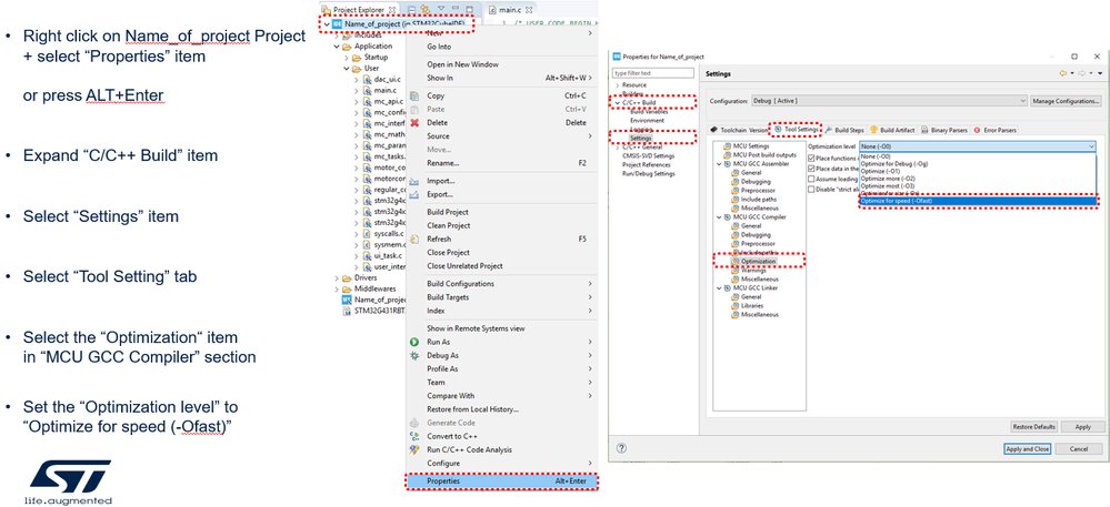

3. Switch on optimization level for speed

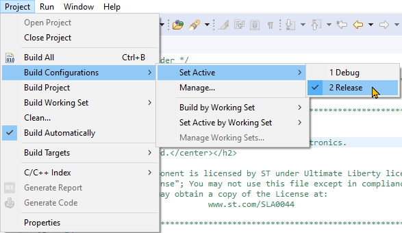

We have to switch on the optimization level for speed, or we have to use the "Release" build configuration with the appropriate optimization settings. The image examples below illustrate this process in STM32CubeIDE.
3.1 Option 1: Switch on the optimization for speed
3.2 Option 2: set the Build configuration "Release" as active
3.3 Option 3: Directly Build the "Release" build configuration
