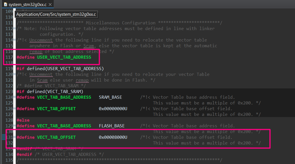

To change the NVIC’s location, go to the [Project Explorer] tab. Inside the [Core] folder, open the [Src] folder, and locate the [system_stm32g0xx.c]. Uncomment the #define USER_VECT_TAB_ADDRESS and change the #define VECT_TAB_OFFSET from 0x00000000U to 0x8000U, as illustrated:

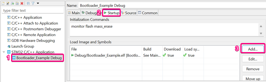

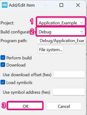

Finally, some configurations are necessary to download both projects inside the STM32. First, access [Debug Configurations] in the bootloader application.
Inside [Debug Configurations], go into the [Startup] tab then click in [Add], select the project to be the application created and click [OK], finally apply modifications.

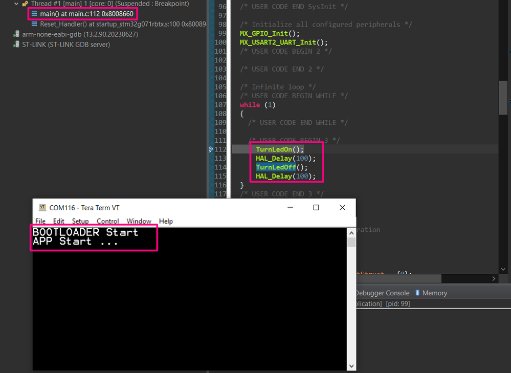

With the configurations in place, every time the bootloader project is debugged, the code from the application is also downloaded inside the STM32.
Now, when testing, you should be able to see in the terminal that the bootloader has jumped into the application and the LED should be blinking. The screenshot displays the terminal message and a breakpoint is placed in the applications main.c file:

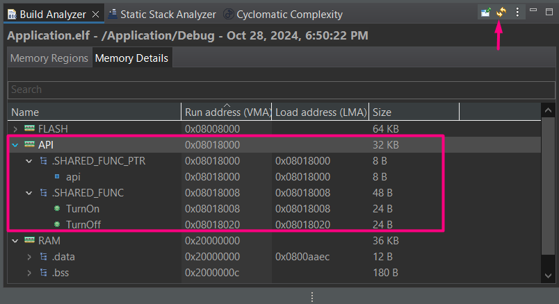

Press [Ctrl + B] to build the projects. There should be no errors or warnings. You can click on the [Refresh] icon in the [Build Analyzer] tab and then expand the [Memory Details] to see the [API] section and usage. The memory used will be either 0 or a few bytes, depending on where the API is created from. In this example, since it was created in the application project, it's displayed there:
To debug, enter using the bootloader project, same as done earlier. You should see the LED blinking before making the jump at a lower pace and then the jump to the application, where it blinks at a higher frequency.
