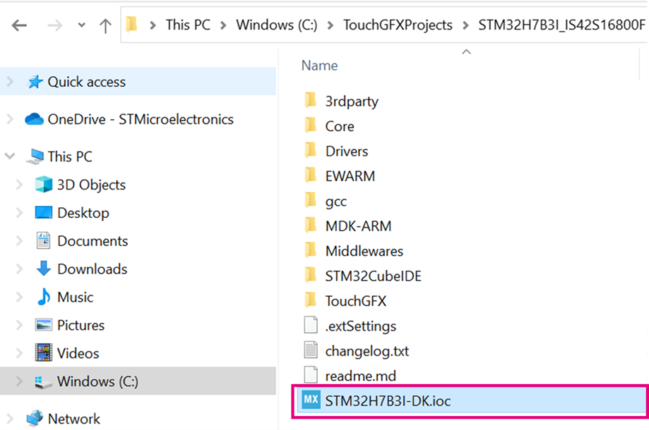

  1. Open the STM32CubeMx project
Under the project location, open the STM32CubeMx project by double-clicking on STM32H7B3I-DK.ioc

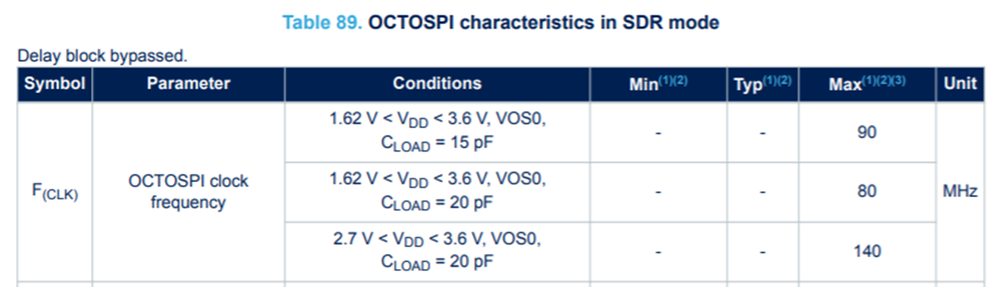

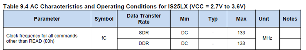

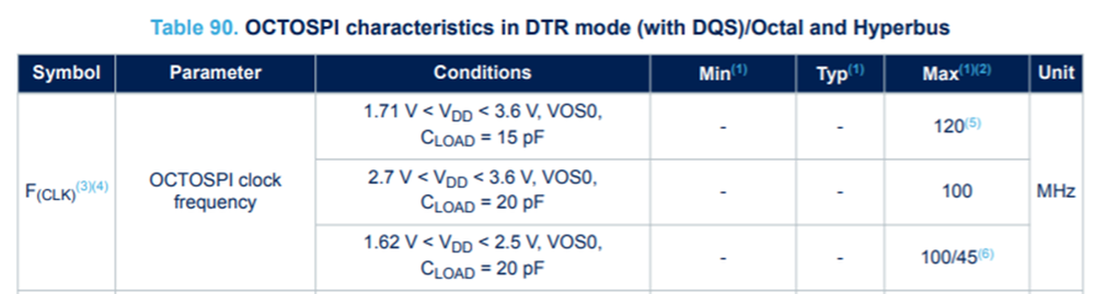

From the OSPI memory datasheet, we see that the max clock of the OSPI is 133MHz.
Per the STM32H7B3LI datasheet, we see that the maximum OSPI clock depends on the mode (either Single-Data Rate (SDR) or Double-Transfer Rate (DTR)), the supply (VDD) voltage, and the load capacitance (CLoad). Table 89 and Table 90 (below) show the different values:
In this article we’ll use the OSPI kernel clock frequency, which is the clock that feeds the OSPI peripheral, at 133MHz. It is important to note the difference between OSPI kernel clock and the OSPI clock:
  • The OSPI kernel clock is the clock that feeds the OSPI peripheral
  • The OSPI clock is the clock you see on OSPI CLK pin and that’s the clock that feeds the OSPI memory

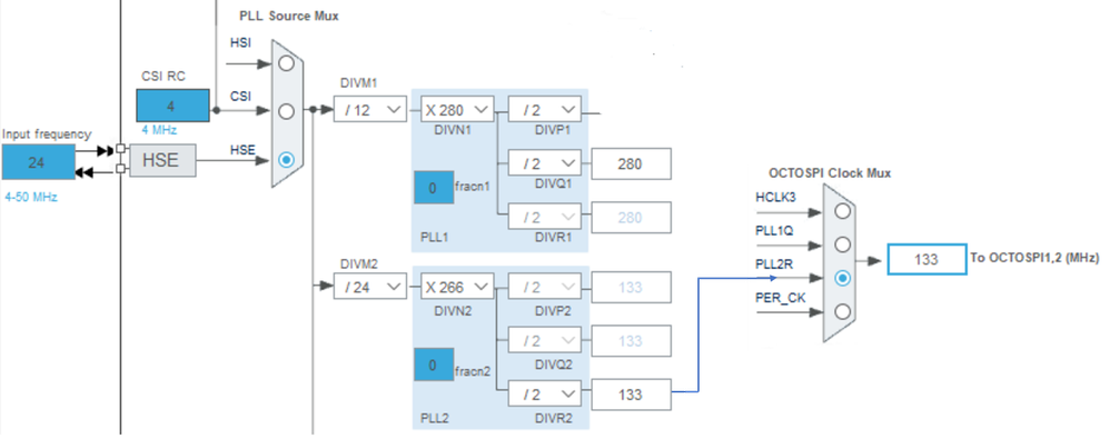

The first step is to setup the OSPI kernel clock. Here we will use PLL2 to set it to 133MHz. We’ll see later that the OSPI clock is derived from this OSPI kernel clock and using 133MHz you can get up to 133MHz as OSPI clock with the prescaler set to 1. Refer to section 6) v)
In STM32CubeMx, under the Clock Configuration Tab, we see the OCTOSPI clock mux. As shown below, the OSPI clock can be derived from PLL2, PLL1, HCLK3, or Peripheral Clock (PER_CK).  Thus, we need to set up the DIVM2 and PLL2 “N” multiplier, “R” and the divider right after the output of the PLL2 in a way to get 133MHz to the OSPI peripheral.
One possible solution is to have DIVM2 = 24, N = 266, R = 2. This solution gives an OSPI kernel clock of 133MHz. This clock will get divided by 4 later in the OSPI configuration – refer to section “6) v)”.

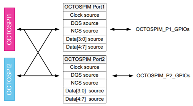

  1. Set up the OSPI mode
STM32H7B3 family embeds two instances of OSPIs:
  • OCTOSPI1: addressable from 0x9000 0000 in memory-mapped mode
  • OCTOSPI2: addressable from 0x7000 0000 in memory-mapped mode
The internal pins of OSPI1 and OSPI2 each could be mapped to either port 1 or port 2 as shown below:

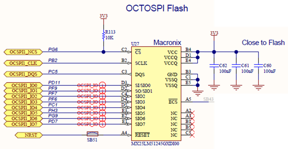

Per the schematic below:
  • OCTOSPI1 is used to interface with OSPI memory.
  • 8 pins for data (IO0 to IO7) meaning in the mode we need to select OCTO mode.
  • DQS pin is used

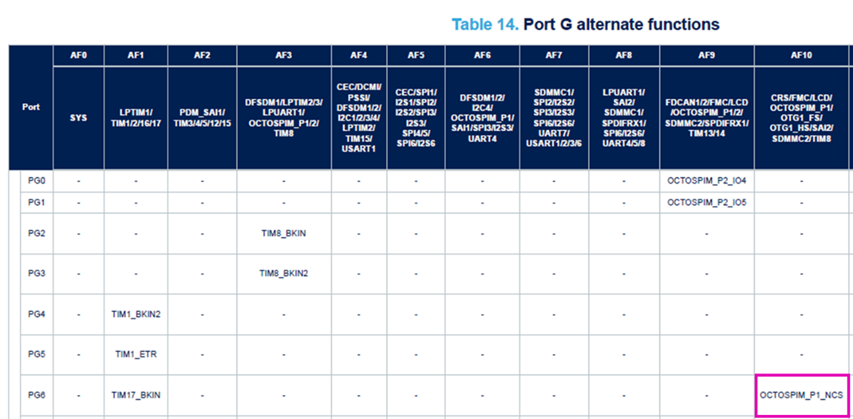

  • OSPI Port 1 is selected to map the internal OSPI pins to the GPIO pins. PG6, for example, can be mapped to OCTOSPIM_P1_NCS (P1 stands for Port 1) using AF10 as shown in Table 14 of the device datasheet. Similarly, Clock, Data Strobe, Data [3:0], Data [7:4] are mapped to OSPI port 1.

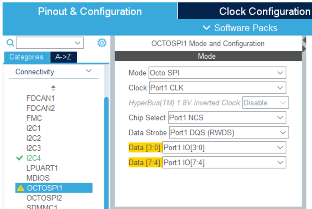

Based on the configuration above, in STM32CubeMx we can set the OSPI1 mode to OCTO mode and then use port 1 for the control and data signals.

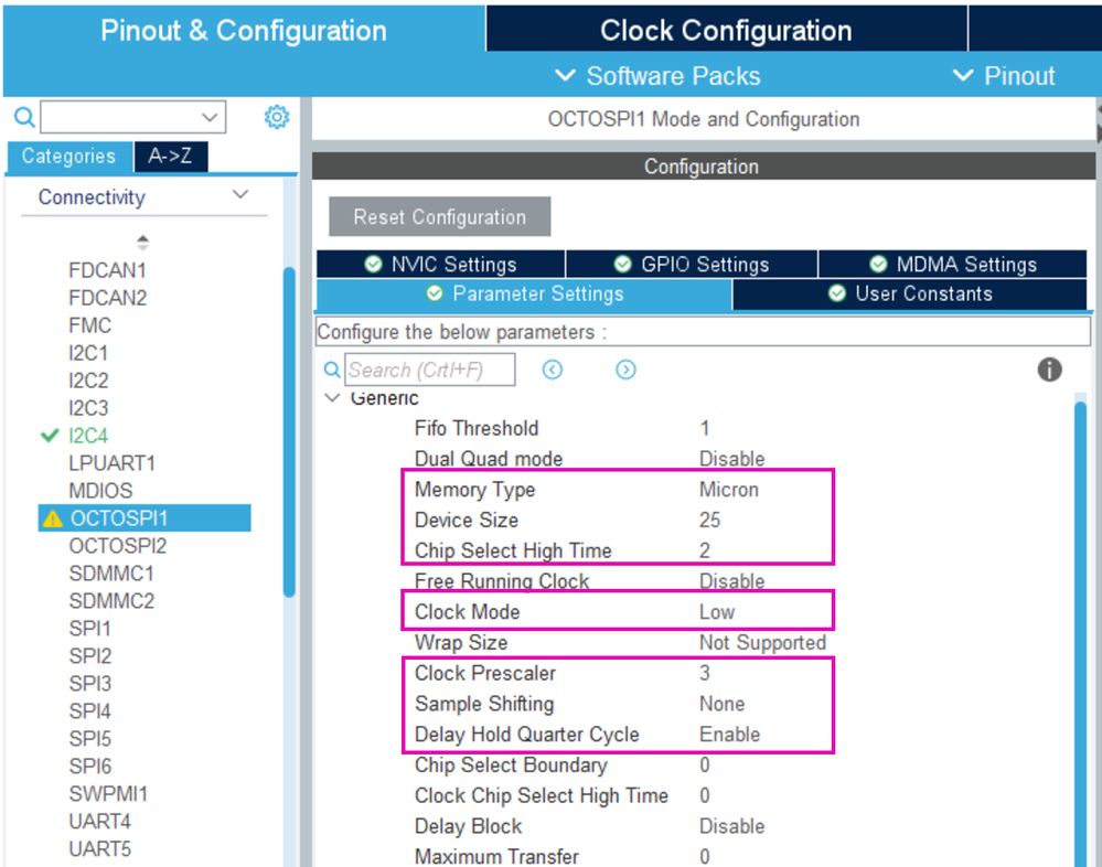

  1. Set the OSPI parameters
The next step is to setup the following parameters:

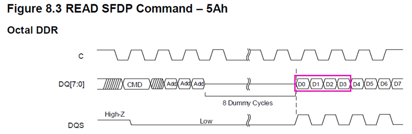

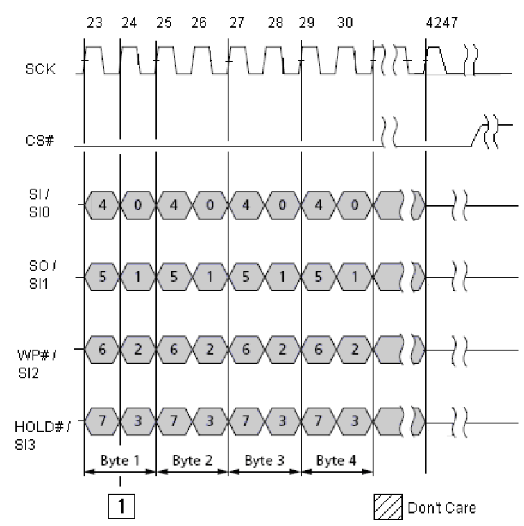

      1. Memory type: The data is organized D0 – D1 – D2 – D3 as shown below. In STM32CubeMx we set the mode to “Micron”:639.png
      1. Device Size: The size of the OSPI memory in bytes and expressed in 2^n. The datasheet of the IS25LX256 is 256MBits = 32Mbytes = 0x200 0000. We see the bit 25 is set  meaning 2^25 = 32 MBytes. In STM32CubeMx we set the device size field to 25.

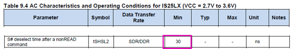

      1. Chip Select High Time is the minimum number of clock cycles where the CS must remain high between commands. The IS25LX256 specifies 30ns – page 88. We divide the 88ns by the clock persiod of OSPI 30ns/(133MHz / prescaler) = 133MHz / 3. The clock period is 3/133MHz. 30ns /(3/133MHz) = 1.33. we round up to the next integer value which is 2. In CubeMx we set the chip select high time to 2.640.png

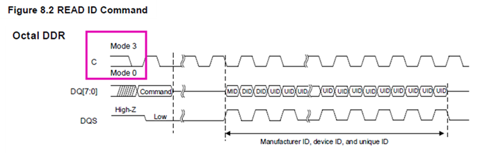

      1. The clock mode specifies the level of the clock – In page 47 of IS25LX256 datasheet, we see the memory supports Mode 0 or low level and Mode 3 which is high level. The memory supports high and low. In STM32CubeMx, we’ll select low.641.png
      1. Clock prescaler: In STM32CubeMx, we’ll set the prescaler to 3. This means the clock on the bus is 133MHz / 3 = 44.3MHz.

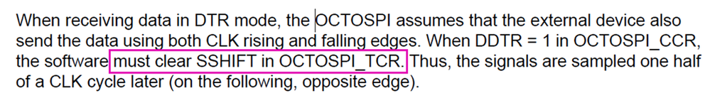

      2. Per the OSPI specification in RM0455, the sample shifting needs to be set to none in DTR mode – see excerpt below. In STM32CubeMx, we set sample shifting to “none”.642.png
      3. Per the OSPI specification in RM0455, it is recommended to enable the delay hold quarter cycle meaning a quarter cycle delay on the outputs in DTR communication. See excerpt below from RM0455.643.png
      4. The other parameters will be left with the default values.
The screenshot below shows the various parameter settings for the OSPI peripheral:

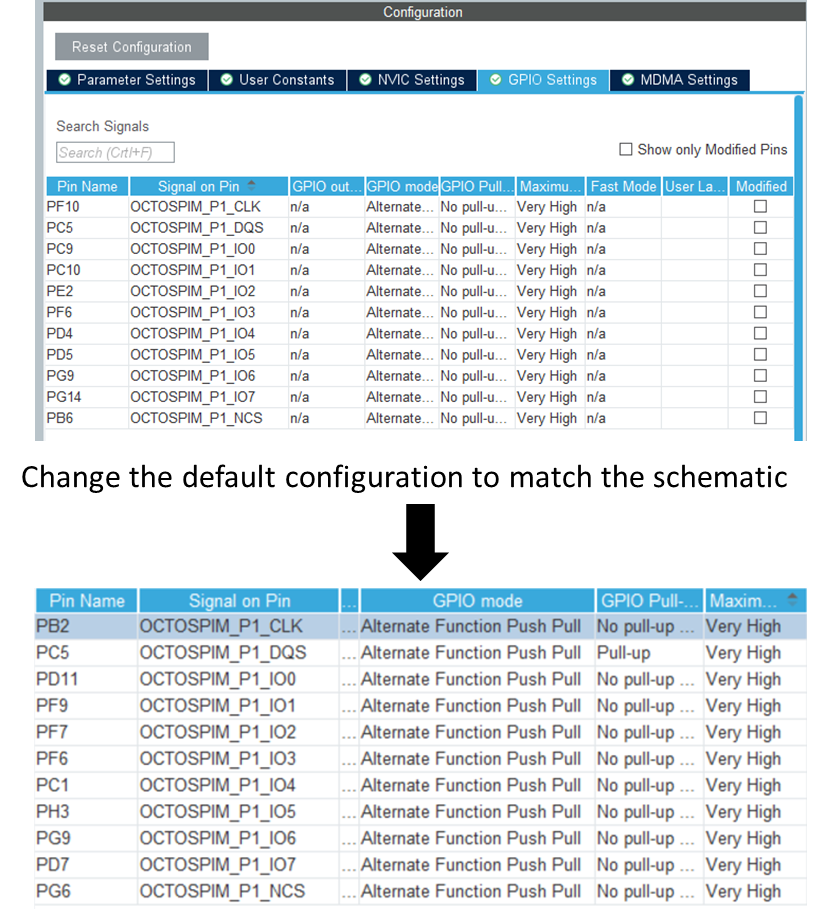

  1. Setup the GPIO

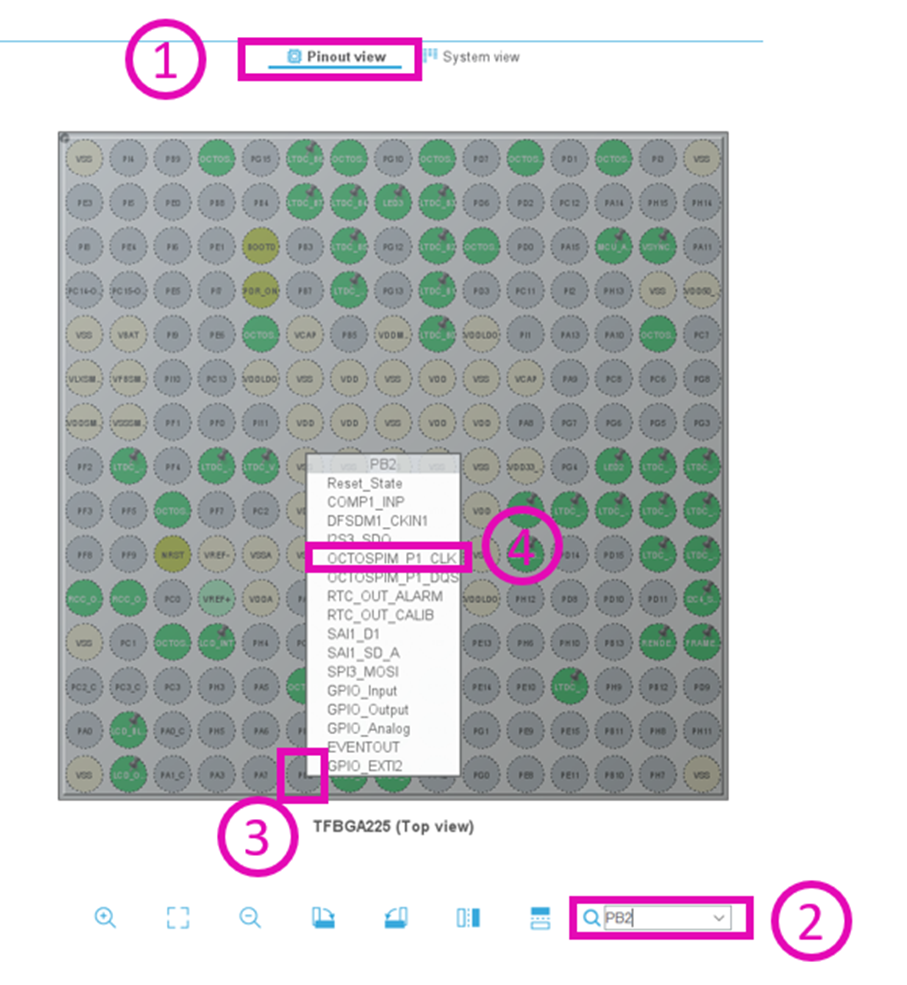

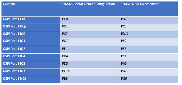

Finally, we select the GPIO settings Tab where we see that the STM32CubeMx default pinout for OSPI port 1 is different from the STM32H7B3I-DK schematic except OSPI Port 1 IO3 (PF6) and OSPI Port 1 IO6 (PG9). The table below shows the differences:
Hence, we need to change the mapping of OSPI pins listed in the table above to match the STM32H7B3I-DK schematic:
In the pinout view tab, type the name of the pin in the search field, the pin will be highlighted, left click on the pin and then change the alternate function to OSPI signal.
The example below shows how to change OSPI Port 1 CLK from PF10 to PB2:

I noticed you configured memory type to Micron in the OSPI parameter setting even though a ISSI flash was used.
I am curious to know which memory type should be selected when connecting a flash which is not in the supported list?
The supported list I refered to is stm32xxx_hal_ospi.h.
#define IS_OSPI_MEMORY_TYPE(TYPE)
                                            (((TYPE) == HAL_OSPI_MEMTYPE_MICRON)      || \
                                            ((TYPE) == HAL_OSPI_MEMTYPE_MACRONIX)     || \
                                            ((TYPE) == HAL_OSPI_MEMTYPE_APMEMORY)     || \
                                            ((TYPE) == HAL_OSPI_MEMTYPE_MACRONIX_RAM) || \
                                            ((TYPE) == HAL_OSPI_MEMTYPE_HYPERBUS))
I am currently working on STM32U575 so the file name is stm32u5xx_hal_ospi.h.
@Glee.4​  I agree this could be confusing. The memory type depends on the D0/D1 ordering: The micron (and compatible memories) use D0/D1 Ordering while Macronix (and compatible memories) use D1/D0 data ordering.
If you have a memory different from Micron and Macronix you simply need to look at the data ordering in the memory datasheet and then select the one that matches it in STM32 OSPI configuration.
That’s what I did with ISSI memory. It is not listed so I looked at the data ordering in ISSI memory datasheet and I figured it is compatible with Micron.
I hope this helps and let me know if you have any questions.
