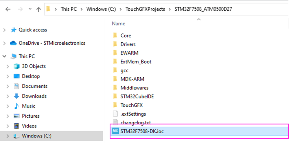

  1. Open the STM32CubeMx project
Under the project location, open the STM32CubeMx project by double-clicking on STM32F7508-DK.ioc

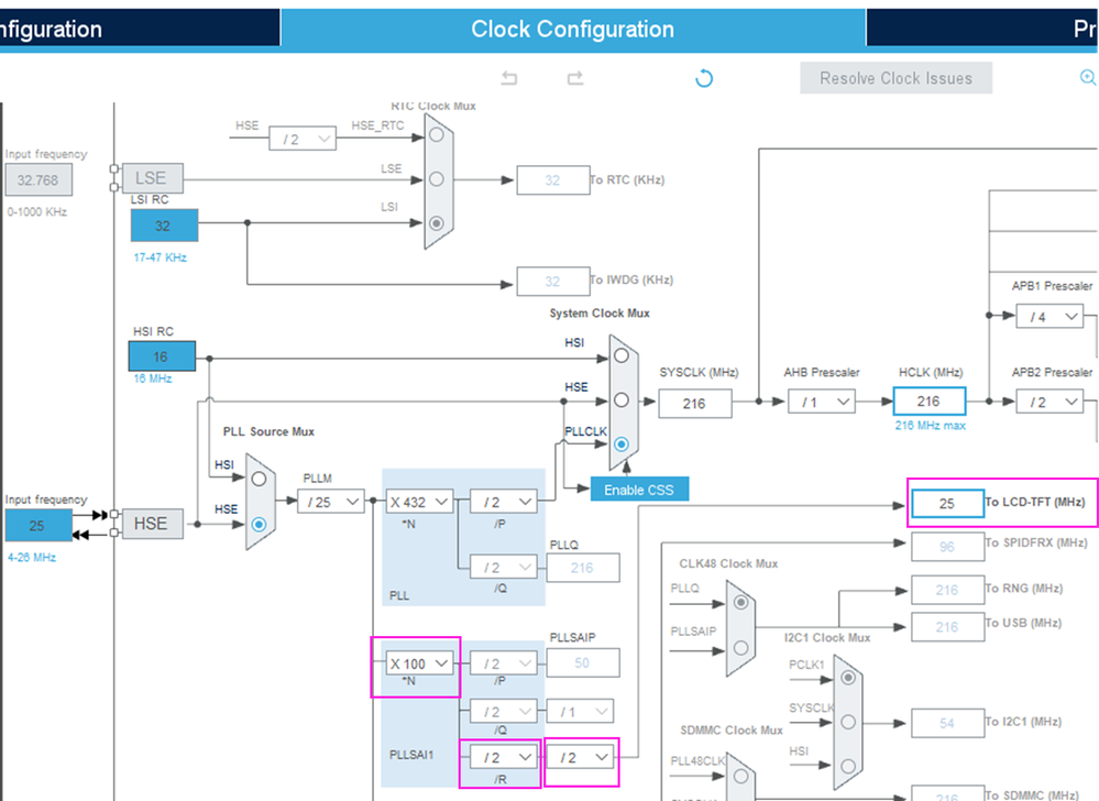

  1. Set up the LTDC clock

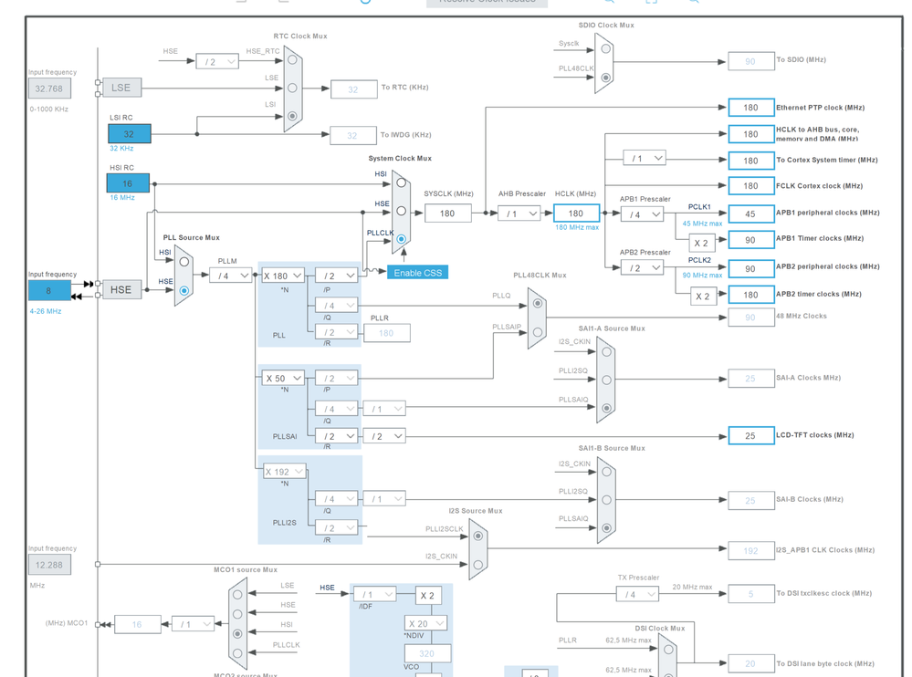

When we look at the display panel datasheet, we see the specification of the pixel clock or dot clock “DCLK”. This pixel clock is the speed at which pixels are transmitted. It is specified in MHz and for this panel it is 25MHz typ.
In STM32CubeMx, under the Clock Configuration Tab, is where the pixel clock is set up. As shown below, the LCD-TFT clock is derived from PLLSAI1. Thus, we need to set up the PLLSAI1 “N” multiplier, “R” and the divider right after the output of the PLLSAI1  in a way to get 25MHz to the LCD-TFT.
One possible solution is to have N = 100, R = 2, and the divider right after the output of the PLLSAI1 = 2 . This solution gives a pixel clock of 25MHz.

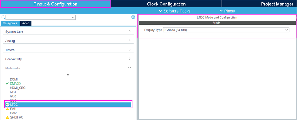

  1. Set up the display type

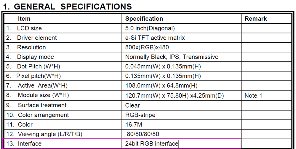

When we look at the general specifications of the display panel, we see the display interface supports 24-bit RGB:
Under Pinout & Configuration Tab, we select Multimedia category and then LTDC peripheral. Under LTDC Mode and Configuration, we select the display Type: RGB888 (24 bits).

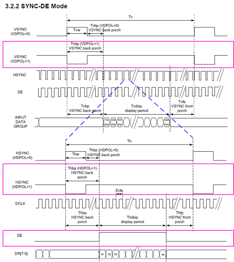

  1. Setup the horizontal and vertical timings

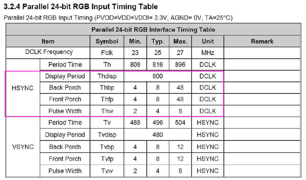

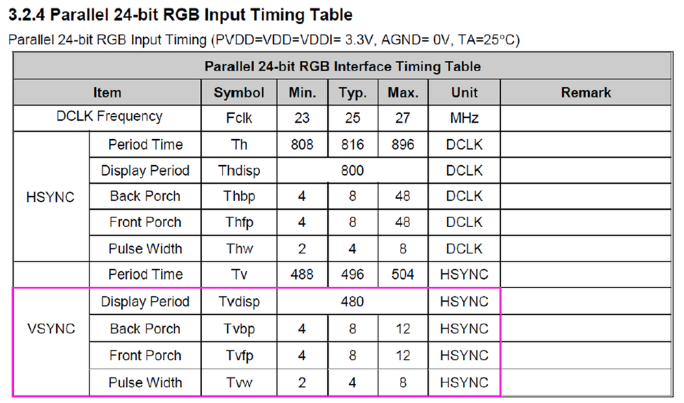

The Timing Table of the display panel shows the horizontal and vertical timings:

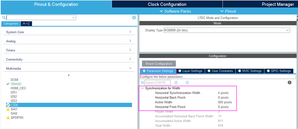

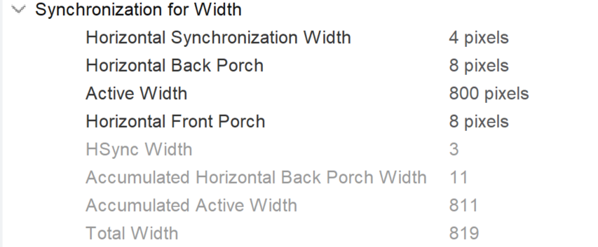

  1. The horizontal timings highlighted below gives a display period of 800 which is the same as display width. Besides, it gives a back porch of 8, a front porch 8, and a pulse width or horizontal synchronization width of 4.
Under Parameter Settings, we provision the horizontal timings given by the datasheet of the display panel as shown below:

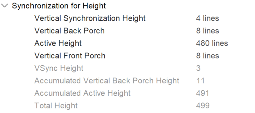

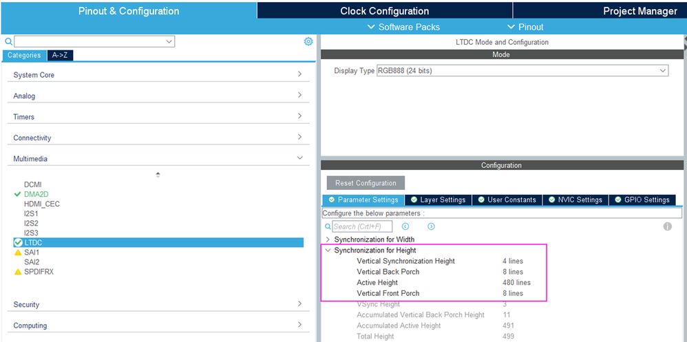

  1. The same timing table in the datasheet of the display gives the vertical timings: display period of 480 which is the same Active height. Besides, it gives a back porch of 8, a front porch 8, and a pulse width or vertical synchronization width of 4.
Under Parameter Settings and then Synchronization for Height, we provision the vertical timings given by the datasheet of the display panel as shown below:

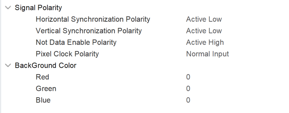

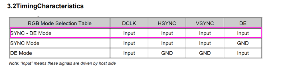

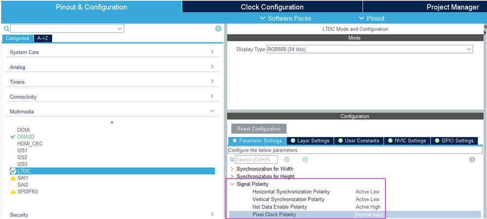

  1. Signal Polarity
The display panel supports three modes: SYNC mode, SYNC-DE mode, and DE mode. We’re more interested in SYNC-DE mode as it uses the three signals: Pixel clock (DCLK), HSYNC, VSYNC, and Data Enable (DE).
The display panel has already VDPOL and HDPOL tied to High. This means the VSYNC and HSYNC are active low. Besides, the figure below shows the DE signal is active high.
Based on the signal polarity given by the datasheet of the display panel, we provision the configuration under Signal Polarity.

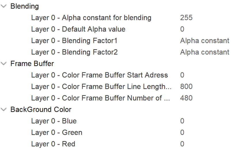

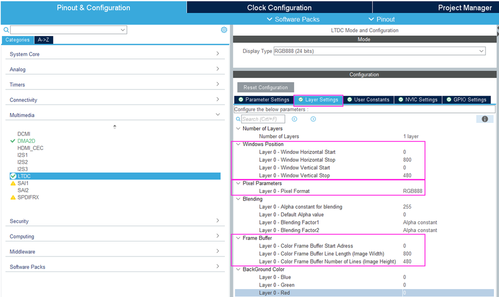

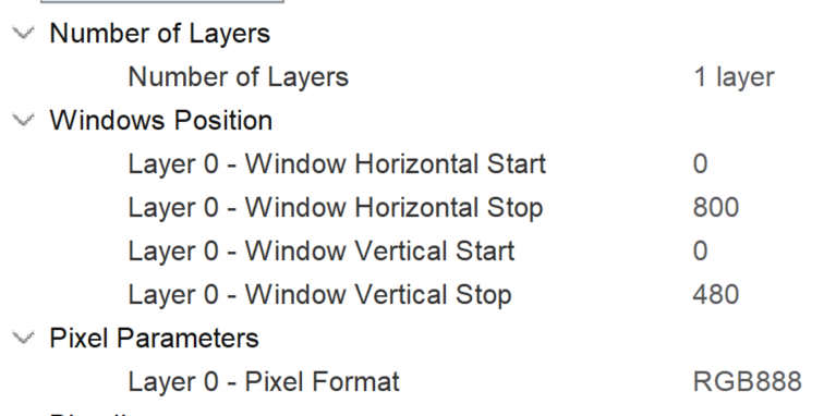

  1. Set up the layer settings
We will match the layer settings to the display settings:
  • Horizontal Stop to the display width which is 800
  • Vertical stop to the display height which is 480
  • Pixel format to the display type which is RGB888
  • Frame buffer Line Length to the display width which is 800
  • Frame buffer number of lines to the display width which is 480

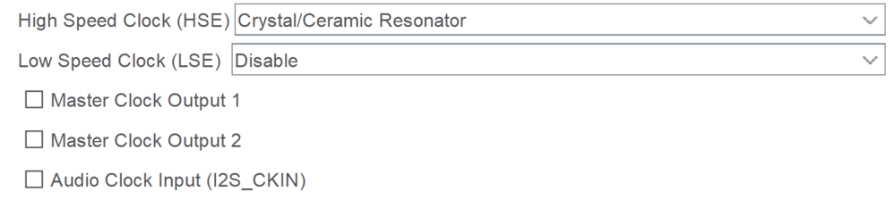

I was using your guide to setup an AZ display. However, I am not able to change the color within the hltdc.Init.Backcolor to ensure proper functionality, it remains all white. I want to make sure I do not have something configured wrong and determine if it's hardware related. Can you please let me know if a setting seems off to you?
I’m using a custom board with a STM32F479BIT6 (PH0/PH1 8Mhz oscillator only) interfacing with a ATM0500D27K.
RCC config:
_legacyfs_online_stmicro_images_0693W00000JOJFiQAP.pngSYS Config:
_legacyfs_online_stmicro_images_0693W00000JOIrsQAH.pngLTDC Config:
_legacyfs_online_stmicro_images_0693W00000JOJLRQA5.pngClock Config:
_legacyfs_online_stmicro_images_0693W00000JOJM0QAP.pngLTDC GPIO config:
SPoor.1
Associate
Hi @Laura C.​ , thanks a lot for your post. Just a small note:
"Only the DE control signal must be inverted versus the DE polarity indicated in the display
datasheet. The other control signals must be configured exactly like the display datasheet."
