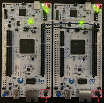

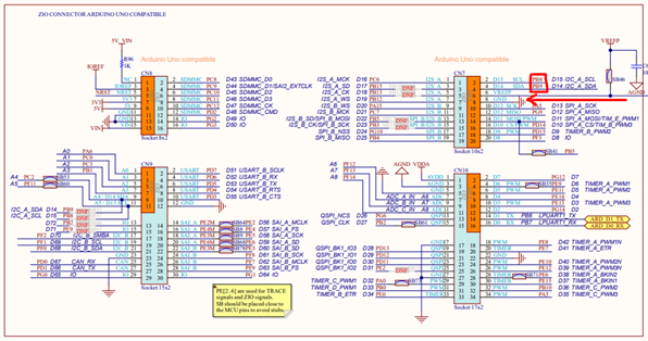

Connect the NUCLEO-H563ZI controller (left) and NUCLEO-H563ZI target (right) boards together using the following connections.
Controller PB8 (SCL) -> Target PB8 (SCL)
Controller PB9 (SDA) -> Target PB9 (SDA)
Controller GND -> Target GND
Fig 1. NUCLEO-H563ZI board schematicFig 1. NUCLEO-H563ZI board schematic
Fig 2. Controller (left) & target (right) board connectionsFig 2. Controller (left) & target (right) board connections

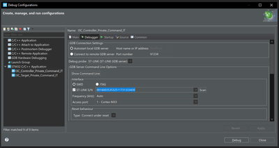

First, plug the NUCLEO-H563ZI controller board into your computer. In the "Debug Configurations" window for the controller example project, check the "ST-LINK S/N" box, click "Scan", and select this board’s "ST-LINK S/N."
Fig 5. CubeIDE debug configurations - controller projectFig 5. CubeIDE debug configurations - controller project
Then click "Debug" to flash the project to the controller board. Once the board is flashed, terminate the debug session. Make sure that the code is running on the controller board (LD1 should be flashing roughly three blinks per second).

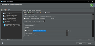

Keeping the controller board plugged in, now plug the NUCLEO-H563ZI target board into your computer. In the "Debug Configurations" window for the target example project, check the "ST-LINK S/N" box, click "Scan", and select this board’s ST-LINK S/N.
Fig 6. CubeIDE debug configurations - target projectFig 6. CubeIDE debug configurations - target project
Then click Debug to flash the project to the target board. Once the board is flashed, terminate the debug session.

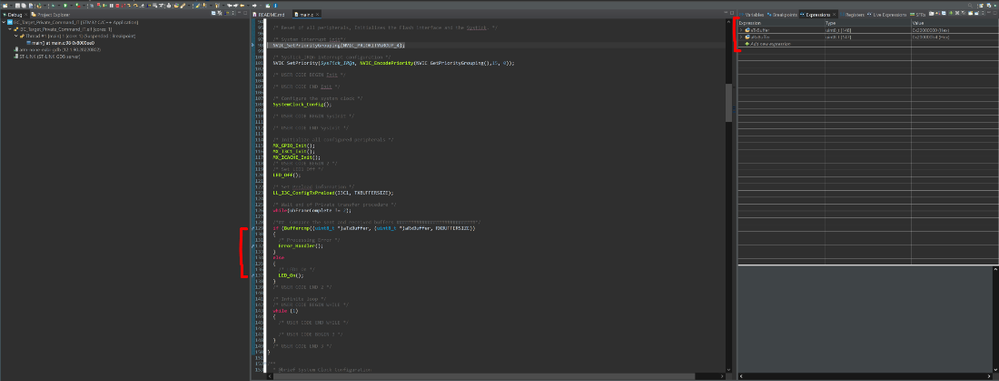

Launch a debug session for the controller example project and place breakpoints at lines 213, 216 & 221 for testing purposes. Add the buffers aTxBuffer and aRxBuffer to the expressions tab so we can monitor their values.
Fig 7. CubeIDE breakpoints & watched expressions - controller projectFig 7. CubeIDE breakpoints & watched expressions - controller project
Now, click the "Run/Resume" icon to run the code on the controller board. LD1 on the controller board should be blink fast (roughly three blinks per second). LD1 on the target board should be off.

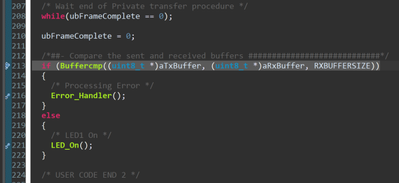

Fig 8. CubeIDE line 213 breakpoint - controller projectFig 8. CubeIDE line 213 breakpoint - controller project

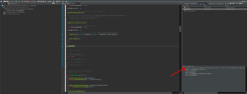

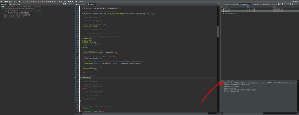

Click the Run/Resume icon and the breakpoint at line 221 should be hit. At this point, check the details field of the aRxBuffer. It should contain the same " ****I3C_TwoBoards communication based on IT**** …" message that is in the aTxBuffer.
Fig 9. CubeIDE line 221 breakpoint - controller projectFig 9. CubeIDE line 221 breakpoint - controller project

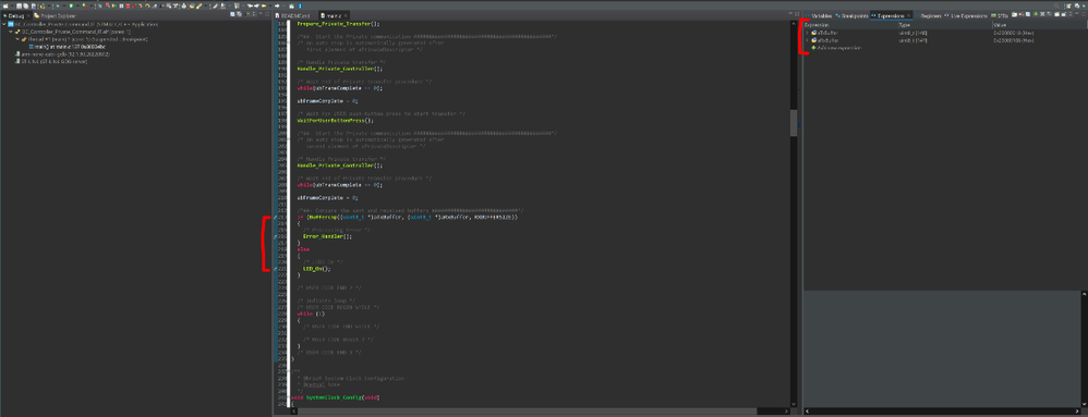

Launch a debug session for the target example project and place breakpoints at lines 129, 132 & 137 for testing purposes. Add the buffers aTxBuffer and aRxBuffer to the expressions tab so we can monitor their values.
Fig 11. CubeIDE breakpoints & watched expressions - target projectFig 11. CubeIDE breakpoints & watched expressions - target project
Now, click the "Run/Resume" icon to run the code on the target board. LD1 on the controller board should be fast blinking (roughly three blinks per second). LD1 on the target board should be off.

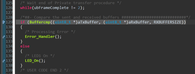

Fig 12. CubeIDE line 129 breakpoint - target projectFig 12. CubeIDE line 129 breakpoint - target project
Click the Run/Resume icon and the breakpoint at line 137 should be hit. At this point, check the details field of the aRxBuffer. It should contain the same " ****I3C_TwoBoards communication based on IT**** …" message that is in the aTxBuffer.
