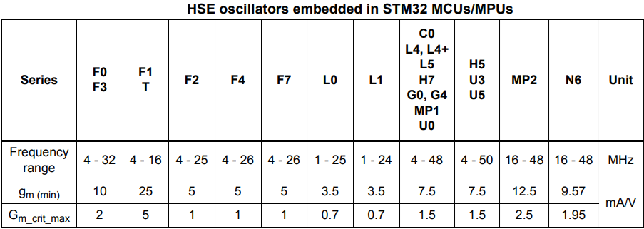

    For HSE:
    Figure 2. HSE transductance by productFigure 2. HSE transductance by product
    Figure 2. HSE transconductance by product

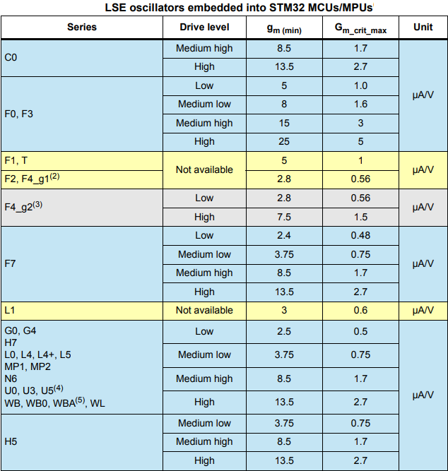

    For LSE:
    Figure 3. LSE transductance by productFigure 3. LSE transductance by product
    Figure 3. LSE transconductance by product

Note that the figures 2 and 3 were extracted from the AN2867 rev 23. The application note is in a continuous update each time a new STM32 MCU is released. So, please refer to that application note if you do not find your STM32 MCU in these tables.

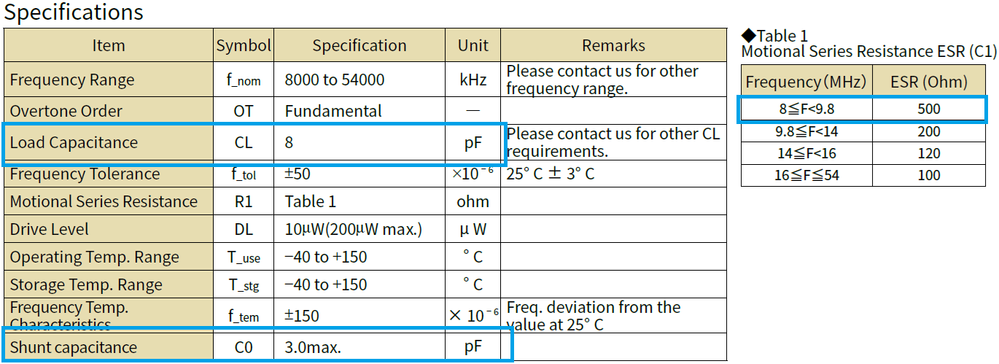

Let us take the crystal part number CX3225GA8000D0PTVCC (datasheet attached) with STM32H743 HSE.
This is the crystal specification from its datasheet:
Figure 4. A screenshot from CX3225GA8000D0PTVCC crystal datasheetFigure 4. A screenshot from CX3225GA8000D0PTVCC crystal datasheet

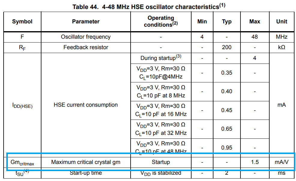

And this is the STM32H743 HSE specification from its datasheet:
Figure 5. A screenshot from STM32H743 datasheet showing Gmcritmax valueFigure 5. A screenshot from STM32H743 datasheet showing Gmcritmax value
mALLEm_8-1741349420721.pngThis crystal is suitable for STM32H743 MCU.

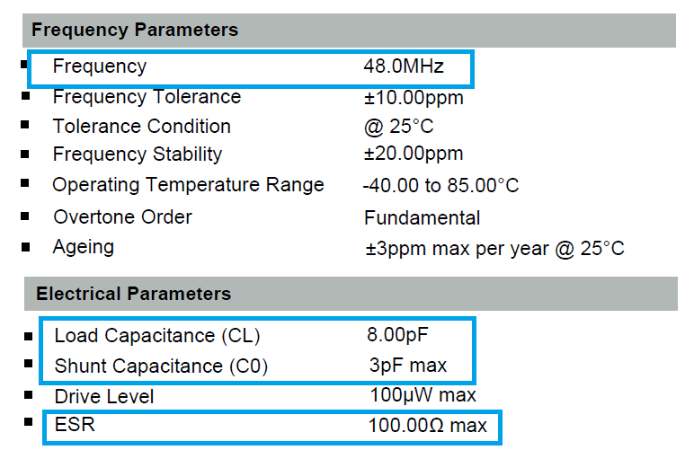

Now, let us take the crystal part number LFXTAL081620 (datasheet attached at the end of the article) for the same MCU STM32H743 HSE.
Figure 6. A screenshot from LFXTAL081620 crystal datasheetFigure 6. A screenshot from LFXTAL081620 crystal datasheet
This crystal is incompatible with the STM32H743 MCU.

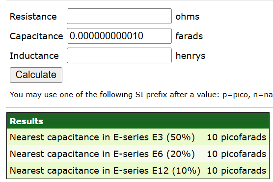

This capacitance value is a standard value of capacitors on the market. To find capacitor standard values, please refer to this link to get the capacitors standard value.
Figure 7. Standard capacitor value in this case is 10 pFFigure 7. Standard capacitor value in this case is 10 pF
Please note that selecting a non-exact value for the calculated capacitor affects the frequency of the oscillator (and therefore the pullability of the crystal). The more the capacitor value deviates from the calculated value, the greater the frequency deviation from the nominal frequency of the crystal.

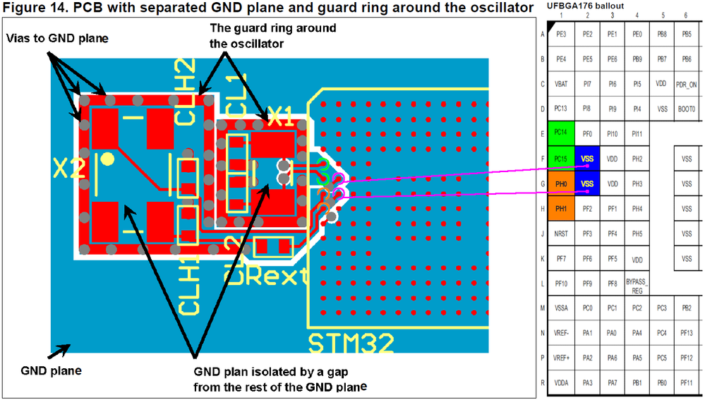

5. Layout considerations
Despite the best values for the capacitors and the crystal, stable operation over the entire voltage and temperature range can be difficult if a suitable layout has not been developed. It is therefore highly recommended to work through the important notes in AN2867, section 7, in order to achieve the desired result.

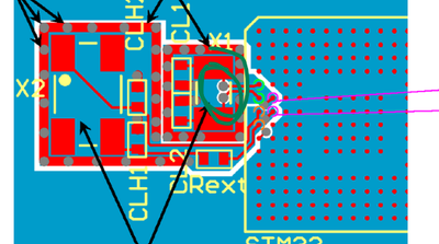

The following image shows figure 14 of AN2867 as an example, in which the pins to which the HSE and LSE crystals that are connected, are marked with green, orange and pink circles. For better clarification, the ballout from the datasheet is also shown on the right, in which the relevant pins are marked.
What is important here is the realization of the 'trough'-shaped shielding of both HSE crystal and LSE crystal. Each of the crystals has:
  • its own, light blue GND 'base plate', which is separated from the other GND (white dividing line).
  • An additional red GND 'wall' around the crystal and its load capacitors on its assembly layer with several vias to the respective GND 'base plate' of the crystal.
  • A separate GND connection of its GND 'base plate' to the nearest VSS pin, possibly separate from the other VSS, as shown in AN2867, Figure 15

cpal
Associate
What are these two vias (circled in green) for? are they connected to the traces that goes to PC14 or PC15 somehow? They don't look like they are connected to the crystal associated local ground plane.
Peter BENSCH
@cpal The example shows the ballout of an STM32F722 in UFBGA176. The green and orange markings are only used to highlight the function so that the assignment to PC14 and PC15 can be immediately recognised. PC14 and PC15 have nothing to do with GND in this device, but rather the functions OSC32_IN and OSC32_OUT.
