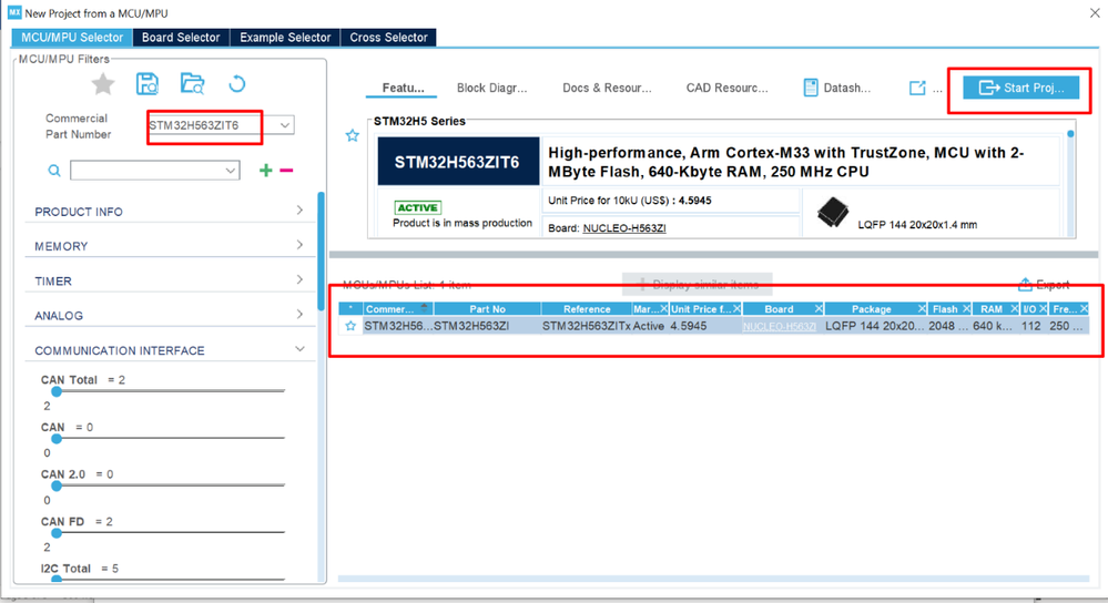

  3. Search for STM32H563ZIT6 and then click on [Start Project]

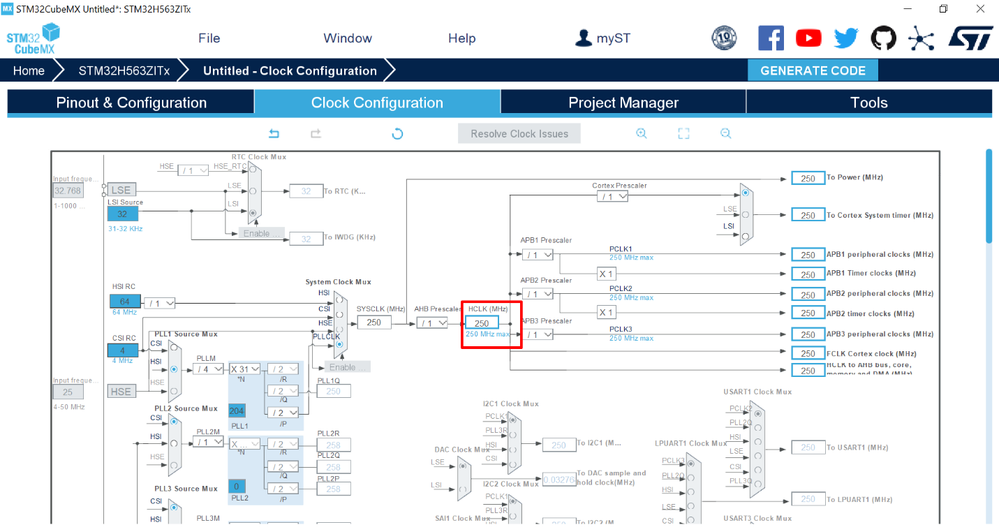

Configure the Clock peripherals. Make sure that the core is running at the maximum frequency of 250 MHz. This can be done by going into the [Clock Configuration] tab and entering 250 in the HCLK box. STM32CubeMX automatically calculates the values for the PLL multipliers and prescalars to generate this 250MHz system clock.
NOTE: Results (CoreMark/MHz) are linear with the clock frequency and hence it is not necessary to run the test at the maximum clock frequency.

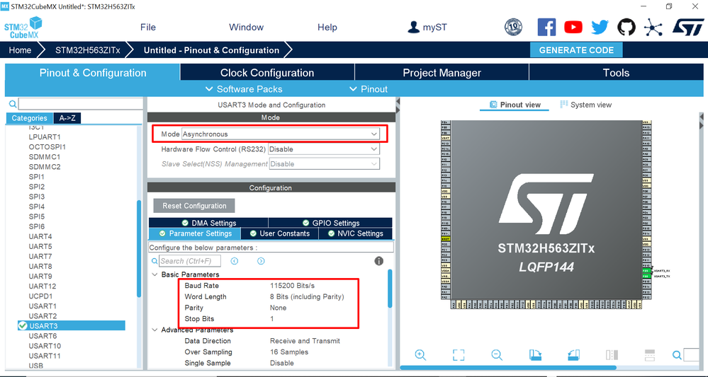

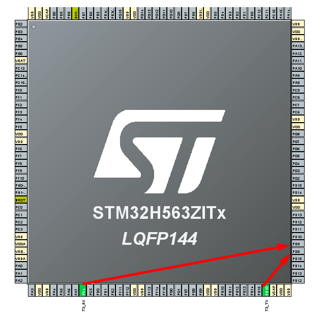

Back to [Pinout & Configuration], let us enable the USART3 under the connectivity menu. By default, USART3 (pins PD8/PD9) is connected to the STLINK Virtual COM port to print out the debug messages from the MCU to the PC.
The Virtual COM port settings are 115200 bps, 8-bit data, no parity, 1 stop bit, and no flow control. By default, USART3_RX and USART3_TX appears on PC4 and PB10 and they have to be redirected to PD9 and PD8. There is a shortcut to do this. Hover the mouse pointer on the pin signal that you want to move, and hold CTRL + left mouse button, move it to the desired alternate function pin that blinks in black color.

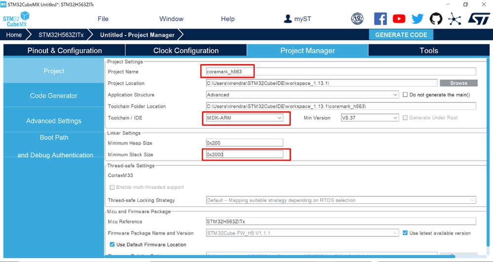

Then go to the [Project Manager] tab and choose a name for the project and change the Toolchain/IDE to MDK-ARM, increase the stack size to 0x2000 and finally click on [Generate Code].

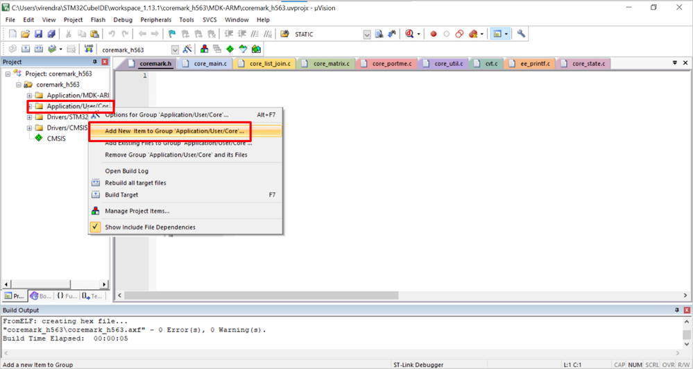

You can add new files to the project as follows:

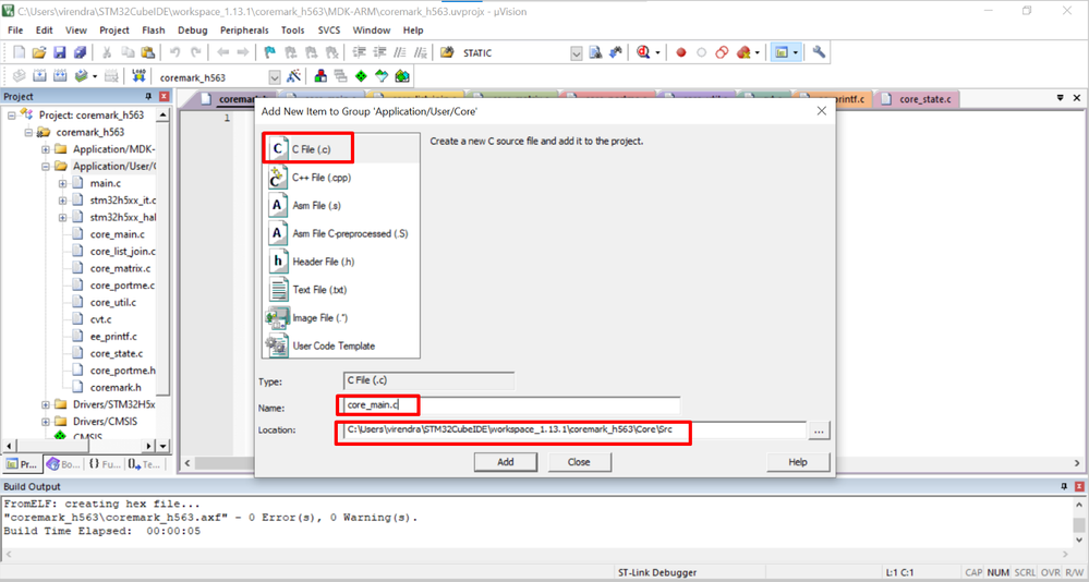

  • Right-click Application/User/Core and select [Add new item to group Application/User/Core]
  • Click on the .c file and enter the name (core_main.c) of the file and make sure that you place the files in the right folders.
  •  .c files are present in Project_name\Core\Src folder and .h files are present in Project_name\Core\Inc folder.
  • Similarly create and place the remaining required .c and .h files in the respective path.

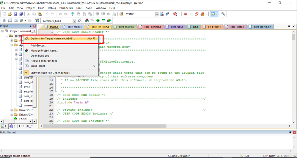

Right click on the project name and select [Options for Target ‘coremark_h563]

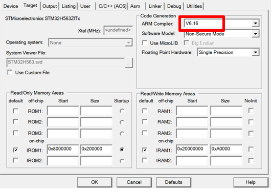

Make sure you have chosen the right compiler version under the tab [Target].

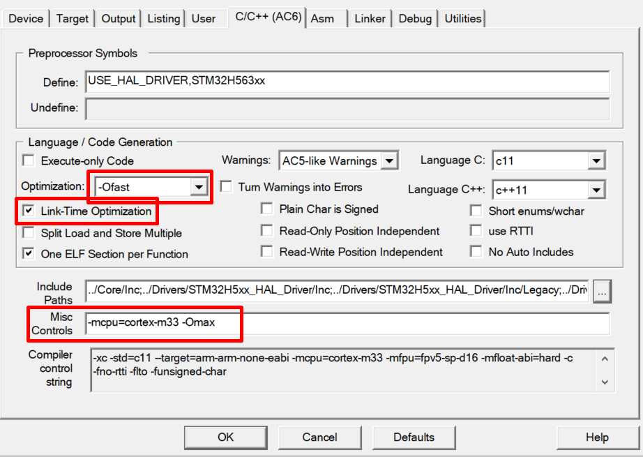

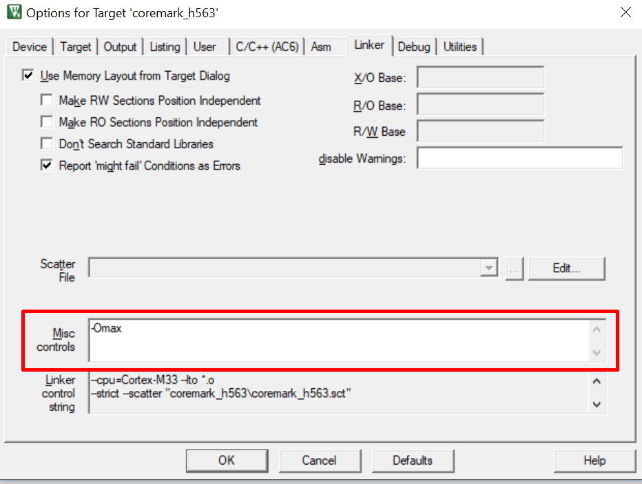

Choose the compiler optimization level to -Ofast under the tab ‘C/C++ (AC6)’ and add this line (-mcpu=cortex-m33 -Omax) in the Misc Controls box. Make sure that you enable the [Link-Time Optimization] option and add ‘-Omax’ in the misc controls field under the Linker tab

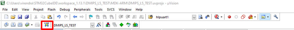

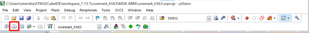

Then compile the project by using the shortcut key F7 or clicking on the button shown below. The project should be compiled with no errors or warnings.

Connect your board to the PC using a USB cable. Then, load the binary file by using the shortcut key F8 or clicking on the button shown below. The programming should be completed without any errors.

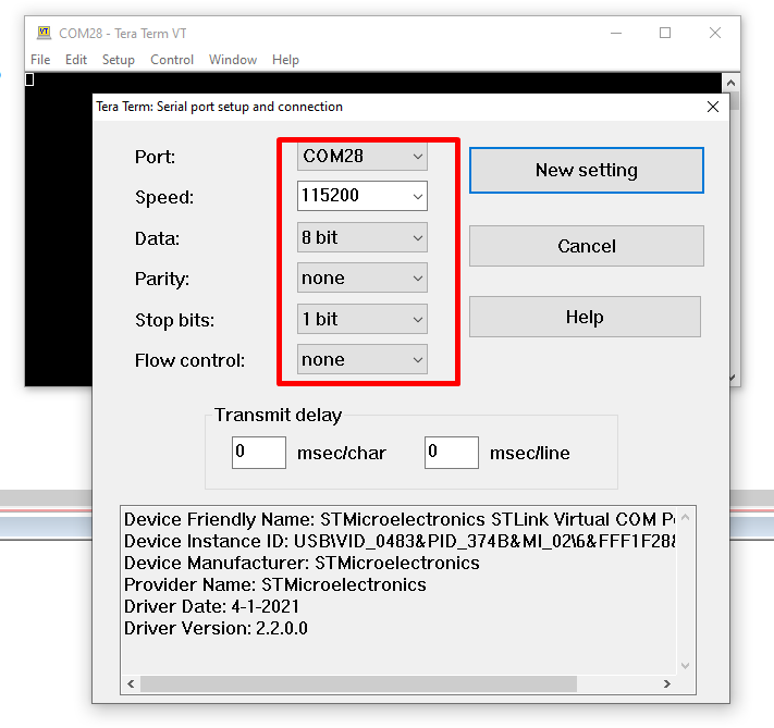

Now, open Tera Term and choose the right COM port that your board is connected. You can do so by checking the [Device Manager] control panel under ports if using Windows OS, and then press OK.
The COM port terminal opens and now you have to make sure the serial port settings are correct.
Verify this by selecting setup -> serial port -> verify the settings using the image below as a reference.

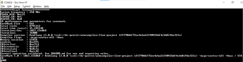

Now, reset the board by pushing the black reset button on the board; the CoreMark tests start running and take about 36 seconds to complete and the results are displayed.
As you can see, we have obtained a CoreMark® score of 1023, which is the same as the benchmark published on the EEMBC website.
