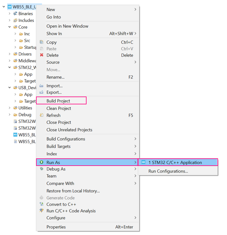

Build the code, check errors and warnings, and run it:

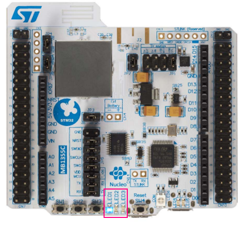

The Green LED must blink, advertising that it is ready to connect.

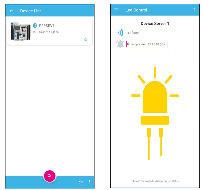

Open the Bluetooth® Low Energy sensor app and you already can see the board available to connection.

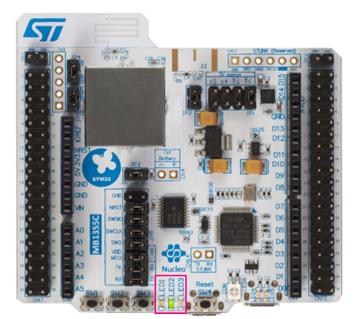

Clicking on the image changes the LED status and you can see that the Blue LED switched on.
Pressing the user button SW1, the message “Button pressed” will appear in the app.

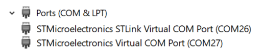

With the user USB connected properly, we can see that a virtual COM Port is opened without any problems:
Well done!
With this setup, the USB CDC class works just fine alongside with the Bluetooth® Low Energy Peer to peer Server!
