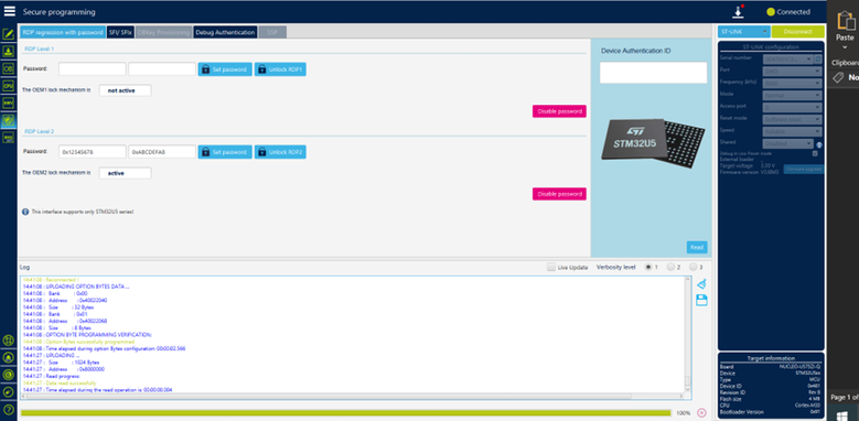

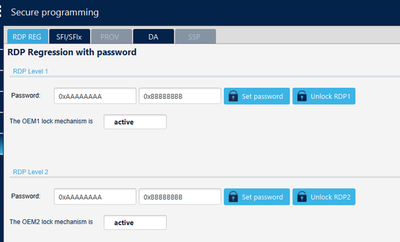

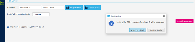

1. How to define an OEM password
To define an OEM2 password, you must do the following:
           1.Check if your sample is on RDP level 0 (no protection).
          2. In the "secure programming" menu, define your password.
  3. Click on "set password" and after on "apply lock RDP2."
At this point, you are sure that the OEM2Key is correctly defined.

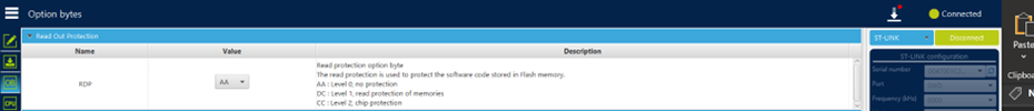

2. How to take the RDP from level 0 to level 2

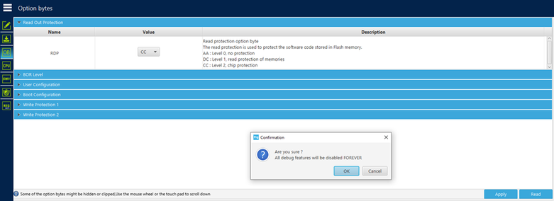

1. In the "read out protection" menu, select the value “CC" then click on apply.
After clicking on "ok" you will lose your connection with STLINK. This is normal behavior.

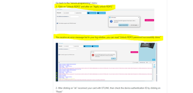

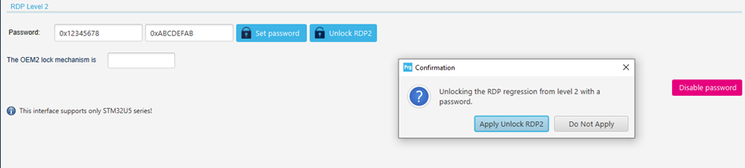

Go back to the "secure programming" menu:

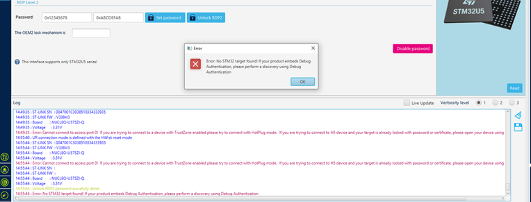

1. Click on "Unlock RDP2" and after on "Apply unlock RDP2."
You receive an error message but in your log window, you can read "Unlock RDP2 password successfully done."
2. After clicking on "ok" reconnect your card with STLINK, then check the device authentication ID by clicking on "Read."

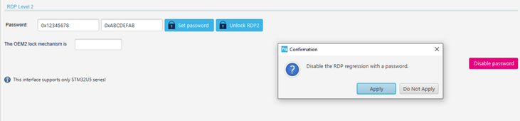

3. Disable the RDP regression with a password.

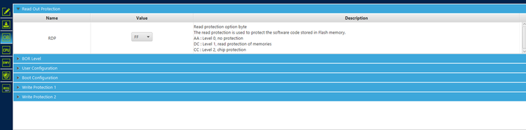

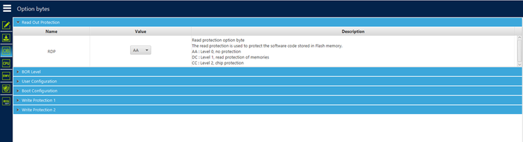

4. Go back to the "Read Out Protection" menu and check the value of the RDP.
5. Change the RDP value to “AA” then click on apply.
You have correctly downgraded the RDP from level 2 to level 0.

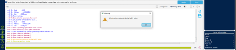

I followed the procedure, but I bricked another chip: at the moment if I try to conect to the chip I get the following error:
Error: No STM32 target found! If your product embeds Debug Authentication, please perform a discovery using Debug Authentication
How can I regress from RDP2 to RDP0 if I can't connect to the chip?

Errata: I did connect the STLINK wrong. Now I fixed the connection, but still getting an error, this is the log:
13:10:01:707 : UR connection mode is defined with the HWrst reset mode
13:10:01:935 : ST-LINK SN : REDACTED
13:10:01:936 : ST-LINK FW : V2J40S7
13:10:01:936 : Board : --
13:10:01:936 : Voltage : 3.35V
13:10:01:936 : ST-LINK error (DEV_UNKNOWN_MCU_TARGET)
13:10:01:936 : ST-LINK SN : REDACTED
13:10:01:937 : ST-LINK FW : V2J40S7
13:10:01:937 : Board : --
13:10:01:937 : Voltage : 3.38V
13:10:01:937 : Error: ST-LINK error (DEV_UNKNOWN_MCU_TARGET)
13:10:01:957 : Disconnected
13:10:01:962 : halt ap 0
13:10:01:963 : ST-LINK SN :
13:10:01:964 : ST-LINK FW :
13:10:01:964 : Board : --
13:10:01:965 : Voltage : 3.38V

If I try to follow your procedure and press "Unlock RDP2" and then "Apply unlock RDP2", I get the same error.

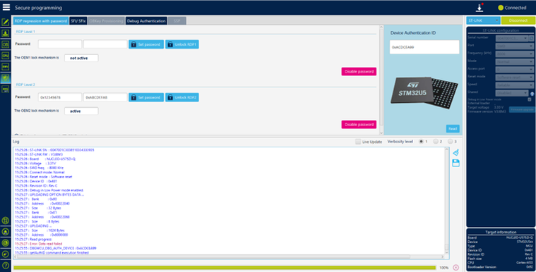

@Diane POMABIA , @Jocelyn RICARD  hello, I'm working on a STM32U595 and I encountered the same issue (not being able to do the regression from RDP2 to RDP1 even with my OEMKEY1 and 2 set etc.
First of all I configured OEMKEY1 and 2 :
Then I followed the full process using Reference Manual + a nice tutorial by ST
:https://www.youtube.com/watch?v=B3l6iuA7U8Q&list=PLnMKNibPkDnEkeKd_fytwc_9x2Ht2gRUn&index=2&ab_channel=STMicroelectronics
However, it doesn't work, I have two weird behavior :
If I use STM32CubeProgrammer I can read the Auth device ID :
But I can't unlock RDP2 (By the way I tried twice as you answered above):
I tried in command line and what a surprise to see " Unlock RDP2 password failed!"

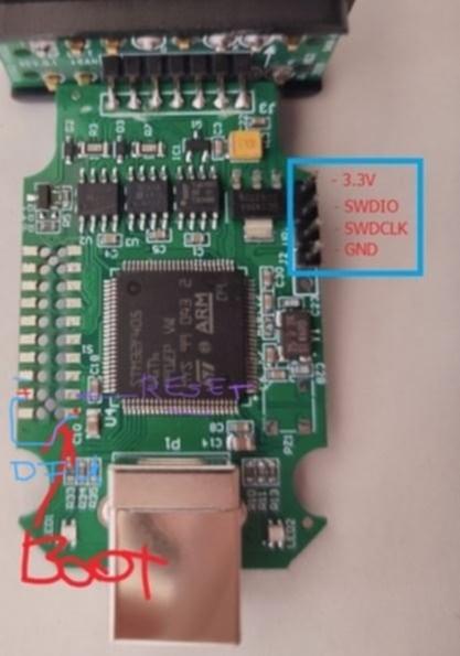

Thanks to @Diane POMABIA  I solved my issue. The problem was just my STLink version not up-to-date, you must have at least V2J38 STLink FW Version to process regression! Now with V2J42S7 everything is fine!
Diane POMABIA
@eSenKaa  as discussed in inbox, your problem was related to your version of STLINK.
To perform a regression, your STLINK FW version Must be at least V2J38 for ST-Link/V2 and V3J8M3 for ST-Link/V3.
We recommend that you always use the latest version of STLINK.

UPLOADING OPTION BYTES DATA ...
Bank : 0x00
Address : 0x40022040
北北北北北北北北北北北北北北北北北北北北北北北北北 0% 圹圹圹圹圹圹圹圹圹圹圹圹圹圹圹圹圹圹圹圹圹圹圹圹圹 100%北北北北北北北北北北北北北北北北北北北北北北北北北 50% 圹圹圹圹圹圹圹圹圹圹圹圹圹圹圹圹圹圹圹圹圹圹圹圹圹 100%
Bank : 0x01
Address : 0x40022068
PROGRAMMING OPTION BYTES AREA ...
北北北北北北北北北北北北北北北北北北北北北北北北北 50% 北北北北北北北北北北北北北北北北北北北北北北北北北 0%
Bank : 0x00
Reconnecting...
Error: failed to reconnect after reset !
Bank : 0x00
Error: Uploading Option Bytes bank: 0 failed
Error: Reloading Option Bytes Data failed
Time elapsed during option Bytes configuration: 00:00:07.030

Unlock RDP2 password succefully done!
Error: Cannot connect to access port 0!
If you are trying to connect to a device with TrustZone enabled please try to connect with HotPlug mode.
If you are trying to connect to H5 device and your target is already locked with password or certificate, please open your device using Debug Authentication.
C:\Program Files\STMicroelectronics\STM32Cube\STM32CubeProgrammer\bin>STM32_Programmer_CLI.exe -c port=SWD mode=UR -unlockRDP1 0x12345678 0xABCDEFAB
STM32CubeProgrammer v2.13.0
ST-LINK SN : 53FF71068389505253152567
Board : --
Voltage : 3.39V
If you are trying to connet to a device with TrustZone enabled please try to connect with HotPlug mode
C:\Program Files\STMicroelectronics\STM32Cube\STM32CubeProgrammer\bin>STM32_Programmer_CLI.exe -c port=SWD mode=UR -ob RDP=0xAA
Board : --
Voltage : 3.39V
C:\Program Files\STMicroelectronics\STM32Cube\STM32CubeProgrammer\bin>STM32_Programmer_CLI.exe -c port=SWD mode=UR -unlockRDP1 0xFFFFFFFF 0xFFFFFFFF
Board : --
Voltage : 3.38V
C:\Program Files\STMicroelectronics\STM32Cube\STM32CubeProgrammer\bin>STM32_Programmer_CLI.exe -c port=SWD mode=UR -ob displ
Board : --
Voltage : 3.39V
C:\Program Files\STMicroelectronics\STM32Cube\STM32CubeProgrammer\bin>cd C:\Users\mfferrero\Desktop

great ,  Now can you do power off/on on your board with your modif ? and after that retest this code
@Echo OFF
SETLOCAL
SET TOOLDIR=c:\Program Files\STMicroelectronics\STM32Cube\CubeProgrammer1.14\bin
SET TOOL=%TOOLDIR%\STM32_Programmer_CLI.exe
SET MY_CURR_DIR=%cd%
@Echo ON
cd %TOOLDIR%
"%TOOL%" -c port=SWD mode=HOTPLUG -ob displ
"%TOOL%" -c port=SWD mode=UR -unlockRDP2 0x12345678 0xABCDEFAB
"%TOOL%" -c port=SWD mode=UR -unlockRDP1 0x12345678 0xABCDEFAB
"%TOOL%" -c port=SWD mode=UR -ob RDP=0xAA
"%TOOL%" -c port=SWD mode=UR -unlockRDP1 0xFFFFFFFF 0xFFFFFFFF
"%TOOL%" -c port=SWD mode=UR -ob displ
cd %MY_CURR_DIR%
@ENDLOCAL
@PAUSE
The aim here is to send the regression command after.

Hello
I'm using a STM32U5 on a NUCLEO-U545RE-Q. Trustzone is not enabled.
Thanks to STM32CubeProgrammer and STLINK-V3EC, I set OEM1KEY and OEM2KEY, while the chip was in RDP level 0.
Then I set RDP to level 1, then to level 2.
I able to regress from RDP level 2 to level 1 by unlocking RDP2 with OEM2Key password with STM32CubeProgrammer.
Thanks to openGDB, a Digilent HS2 JTAG connected to MIPI10, Jumper JP3 set to [7-8] "5V source from ST-LINK in USB charger mode without USB negotiation (CN1)", Jumper JP1 set to [1-2] " An external debugger can be used on the MIPI10 connector (CN4). The level shifter (U2) is in high-Z. STLINK-V3EC no longer drives the embedded STM32", I also able to switch from RDP level 0 to level 1, then to go back to RDP level1 with OEM1KEY.
I can switch from RDP level 1 to RDP level 2, but I didn't succeed to regress from RDP level 2 to level 1 or level0 through openOCD.
Is it possible to regress from RDP level 2 to RDP level 0 ou level 1 without using neither STLINK-V3EC nor STM32CubeProgrammer?
Indeed, on our production board, we will have only JTAG connector, but not STLINK-V3EC connector. And I would find a way to shift the OEM2KEY through JTAG HS2 connected on MIPI10.
Below are the confif files used with OpenOCD :

I have an STM32F429 microcontroller (VCDS USB cable) accidentally locked to RDP2 due to a bad firmware (FLY firmware). Since then:
DFU / bootloader does not appear on USB
ST-Link does not connect
Even Connect under reset does not work
Only two LEDs flash briefly
I know that RDP2 is “final”, but I would like to know if there is any realistic or documented way to reset the chip (hardware tricks, ST tools, ROM commands, etc.), or is it really just a matter of replacing the MCU.
Details:
MCU type: STM32F429VET6
unfortunately I loaded a different firmware: FLY !! / VCDS clone cable
I put it in DFU mode but the system still doesn't see it :(
Is there any way to unlock RDP2?
Is there an ST internal tool / command for this?
Can hardware methods (e.g. glitch) help?
Can ST service help with this?
Thanks in advance for all your answers!
