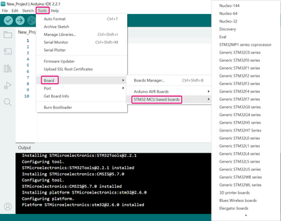

Now, click on Tools > Board > Boards Manager:
Select “Contributed” type, search for "STM32 MCU based boards" and install:
3.2 Selecting the STM32 microcontroller
After the installation is complete, close the board manager and go to Tools > Board > STM32 MCU based boards.
A list of STM32 MCUs appears, so you can choose between Nucleo, Discovery and Evaluation boards, or generic STM32 MCUs.
By selecting the specific board type, you are able to choose the specific board part number for your board later on.
By choosing the Generic STM32xx Series option, later you are able to select a generic microcontroller for the selected family.

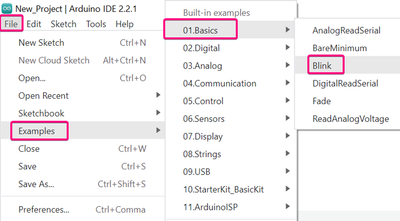

After installing the software and the STM32 cores, go to File > Examples > Basics > Blink:
The Blink LED code pops up in a new window and we can now set the appropriate STM32 board.

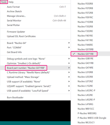

After selecting the board type, as we previously made, click again on Tools > Board Part Number > Select the used STM32 device part number:

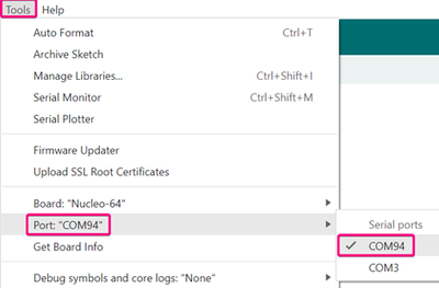

With the microcontroller correctly selected and the board properly connected, let us define the COM Port where the device is connected. Go to Tools > Ports > Select the Port Number:

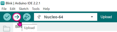

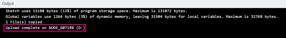

Click the Upload Button, wait for the code to be compiled and the board to be programmed:
As we can see, the download is successfully finished!
Congratulations! You have now successfully programed your STM32 device through the Arduino's IDE!

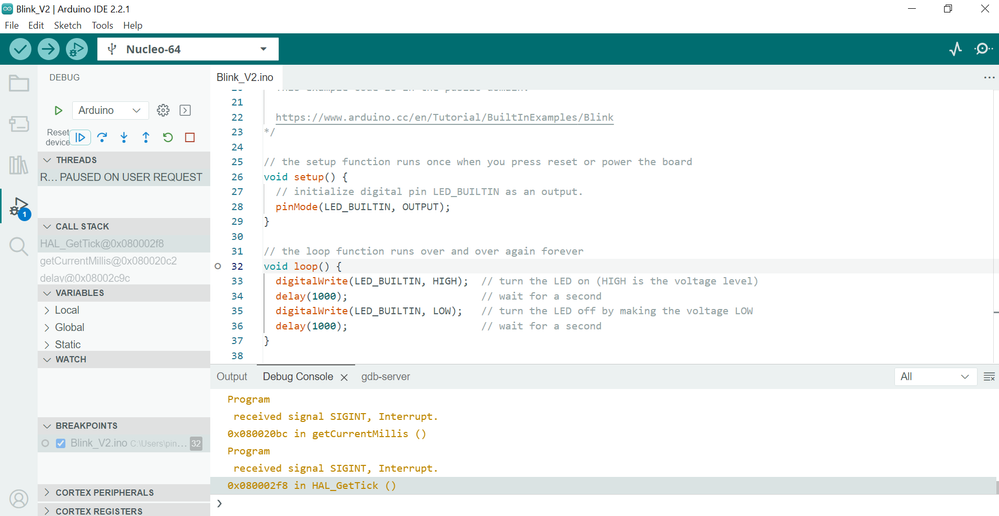

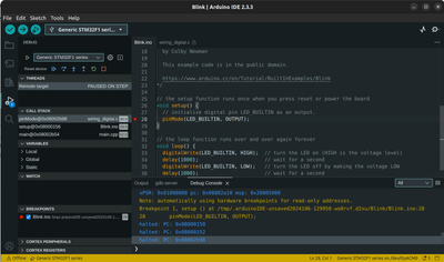

4. Debugging the STM32 over Arduino's IDE

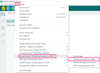

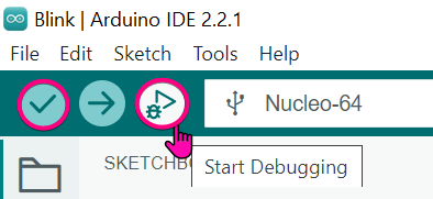

To start a debug session in the Arduino’s IDE, click on Tools > Upload Method > “Serial Wire Debug” option, as follows:
After that, click on the “Verify” symbol to compile the code and then on the “Start Debugging” button.
The perspective changes to the Debug Perspective, as follows:
And with all that set, the debug session is up and running!

I'm using an STlinkV2 programmer with an STM32F103C8T6 minimum system development board. While the Arduino IDE (version 2.1.0) recognizes the STlink and allows me to program the board, I encounter an issue when trying to debug. When I click the debug button, I receive the error message: "Request 2 cancelled on connection close." Could you please take a look and let me know what might be causing this issue? Thank you!
UnderGnd
@BaiBai
You should use latest Arduino IDE 2 version and use latest STM32 core 2.8.x.
Then enable the "Optimize for Debugging" in the "Sketch" menu.
After "upload", click on "Start Debugging" button and it should work.
