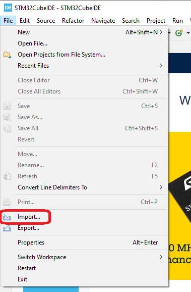

Another way to open a STM32CubeIDE project is to use the "File -> Import" menu.
  1. Start STM32CubeIDE
  2. Choose a workspace location (preferably different from your project location)
  3. Open STM32CubeIDE menu "File -> Import..."

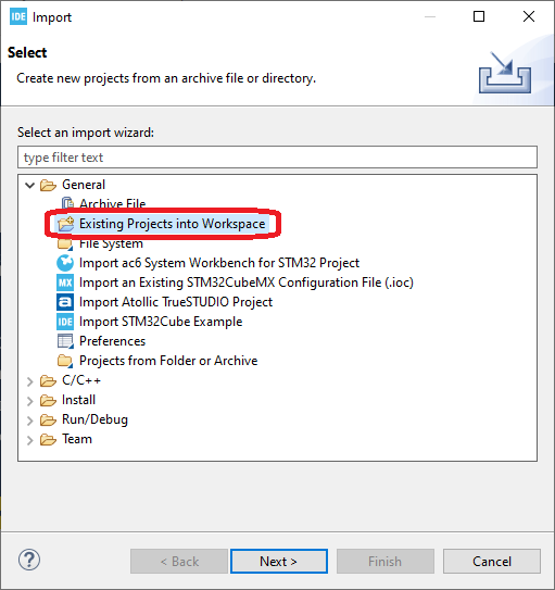

  4. In the "Import" window, select "General -> Existing Projects into Workspace". Click on Next.

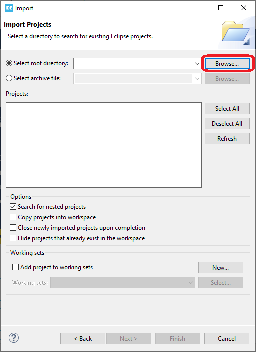

  5. At line "Select root directory", click on "Browse..."
  6. Navigate to the directory of the project's .project and .cproject files. Click on "Select folder".
  7. STM32CubeIDE displays what project was found. Select the project you want to import. Click on "Finish."
