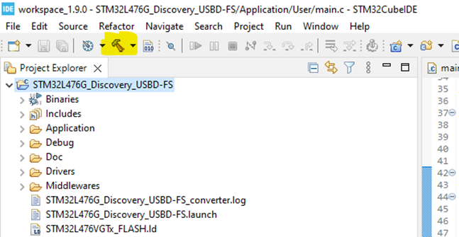

  • Build the firmware now. Make sure the project is selected in the explorer and hit the hammer icon in the toolbar

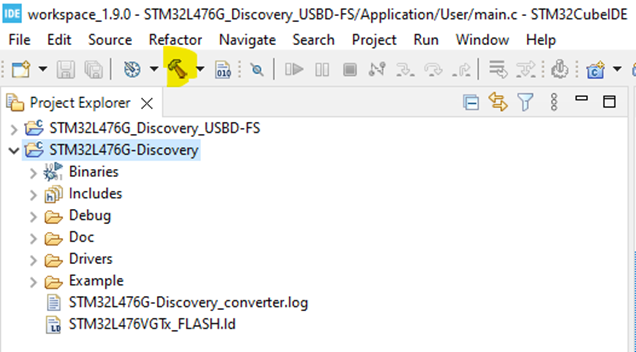

  • Build the firmware now. Make sure the project is selected in the explorer and hit the hammer icon in the toolbar.

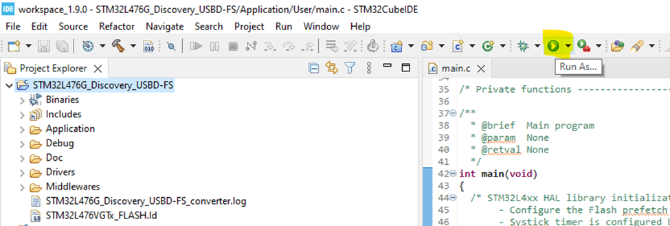

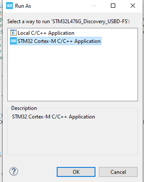

  • With both firmwares built, it’s time to load the USB DFU firmware onto the board. Connect the STM32L476-DISCOVERY board the your computer via the CN1 ST Link USB connector with a USB type A to mini cable. In CubeIDE, select the USB DFU project in the explorer and upload the firmware to the board with Run As… -> STM32 Cortex-M C/C++ application:
  • Keep the run configurations at the default settings and select OK. This will load the USB DFU firmware to the board. Now connect USB USER CN7 connector to the PC via a USB A to micro cable. This cable handles the USB DFU data transfer.

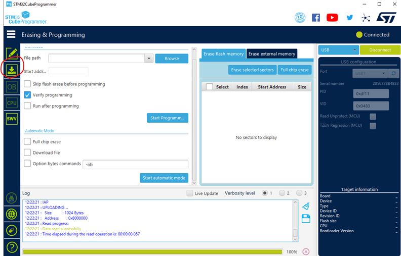

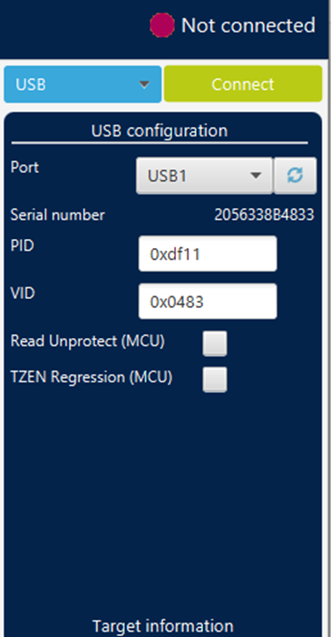

  • Now open STM32CubeProgrammer.  In the right panel, select USB in the drop down menu next to the connect button. Now press the refresh button next to the port field, and you should see the USB DFU port show USB1. Press Connect.
  • Once connected, navigate to the erasing and programming section:
  • Now we need to browse to the file path of the binary created by the GPIO_IOToggle application. This can be found in the Debug folder within the project folder. Select the Browse button next to the file path field and navigate to the binary:

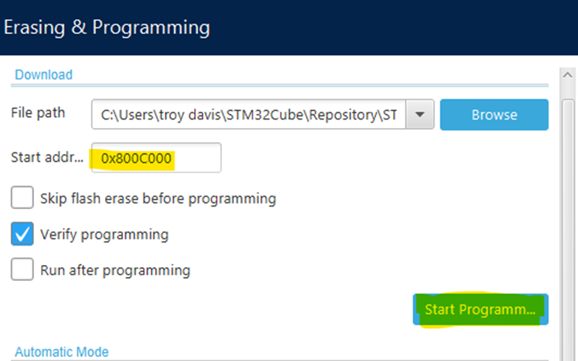

  • Set the Start address to 0x800C000 and click Start Programming.
  • Once it has finished downloading, disconnect STM32CubeProgrammer. While holding the joystick center button down on the board, press the reset button. This will cause the DFU firmware to jump to the GPIO_IOToggle application, and you should see the user LEDS LD4 and LD5 starting to flash. If the reset button is hit without the joystick button being pressed down, the board will once again be in USB DFU mode.
