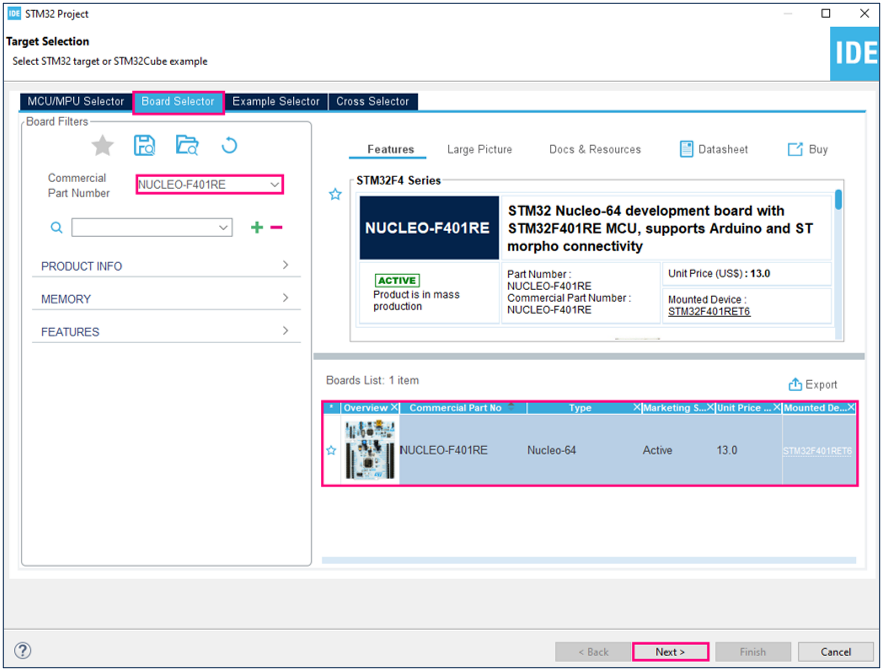

2. Create a new project using the NUCLEO-F401RE board.
Select NUCLEO-F401RE boar using Board Selector:

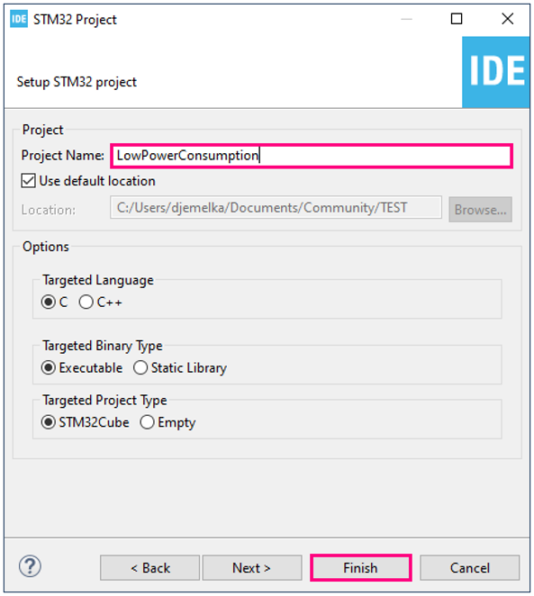

3. Enter a name for the project, for example "LowPowerConsumption".

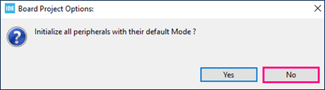

4. Initialize all peripherals with their default Mode?
Answer No to minimize power consumption as below:

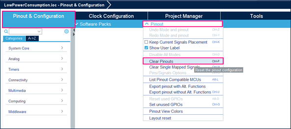

5. Clear pinouts as shown in the below figures or by using "Ctrl+p".

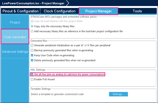

6. Set all free pins as analog (to optimize the power consumption).
In Project Manager tab, select code generator and click on Set all free pins as analog (to optimize the power consumption).
Note that this feature allows the addition of these code lines in the Mx_GPIO_Init function in the main.c file:

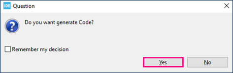

7. Generate Code.
Save the project and generate the code by clicking "Ctrl+s".

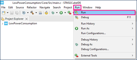

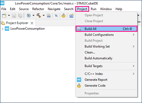

9. Build the project and run the code as shown in the below figures.

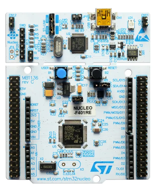

10. To measure the consumption current, just remove jumper 6 and place a multimeter instead of it.

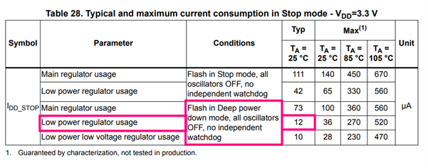

11. In this case the power consumption will be equal to 17µA. This value is similar to the value shared in the datasheet .

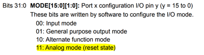

@KDJEM.1 , since this option applies only to unused pins, what's the rationale for not having it as the default? What is the context in which you wouldn't want to set your unused pins to a power-saving configuration?
KDJEM.1
Hello @BarryWhit ,
To optimize the power consumption it is recommended to set all free pins as analog.
For the STM32 Ultra Low Power MCUs  like as STM32L4 the reset state of the GPIO port mode is analog mode.
--> since this option applies only to unused pins, what's the rationale for not having it as the default?
I reported this request internally.
The internal ticket 187991 (not accessible by community users) has been opened to confirm and fix the issue.
Thank you for your sharing and for your contribution in STCommunity :).
Kaouthar
BarryWhit
Lead II
@KDJEM.1
Actually, I was legit just asking why this was the case and assumed that there actually is a good reason. I was not suggesting it should be default, since I obviously don't know what I don't know.
