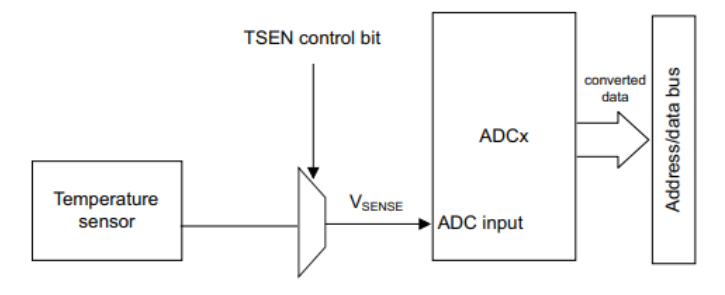

From an STM32 application point of view, the TJ temperature of the die (junction temperature) can be measured by an internal sensor. Notice that the internal sensor is not designed to acquire the temperature of surrounding air, due to various thermal resistances in between.
The temperature sensor is connected to one of the input channels of an ADC, for example, channel 18 of ADC3

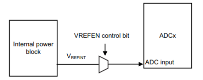

Hint: On a Nucleo board, the VREF+ pin is connected to VDDA by default. Thus, VDDA acts as an ADC reference. To avoid hardware modification (short circuit of VREFBUF and VDDA otherwise), VREFINT connected to channel 19 of ADC3 is used to evaluate the accurate momentary value of VDDA. If a hardware limitation is not present on a given board, VRFBUF can be used as an ADC internal reference and no need for a VREFINT ADC channel to be acquired.
VREFINT = 1.216 V typ
https://www.st.com/resource/en/reference_manual/rm0433-stm32h742-stm32h743753-and-stm32h750-value-line-advanced-armbased-32bit-mcus-stmicroelectronics.pdf#page=993https://www.st.com/resource/en/reference_manual/rm0433-stm32h742-stm32h743753-and-stm32h750-value-line-advanced-armbased-32bit-mcus-stmicroelectronics.pdf#page=993

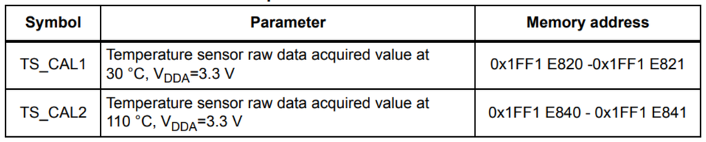

It is possible to increase acquisition accuracy both for temperature sensor and VREFINT using calibration values. Given macros (stm32h7xx_LL_adc.h) are used to evaluate the precise value of temperature and VDDA.
https://www.st.com/resource/en/datasheet/stm32h743ag.pdf#page=178https://www.st.com/resource/en/datasheet/stm32h743ag.pdf#page=178
__LL_ADC_CALC_TEMPERATURE()
https://www.st.com/resource/en/datasheet/stm32h743ag.pdf#page=110https://www.st.com/resource/en/datasheet/stm32h743ag.pdf#page=110
__LL_ADC_CALC_VREFANALOG_VOLTAGE()
