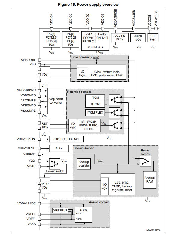

The block diagram (from RM0486) below illustrates the power supply architecture and how the domains connect internally and externally.

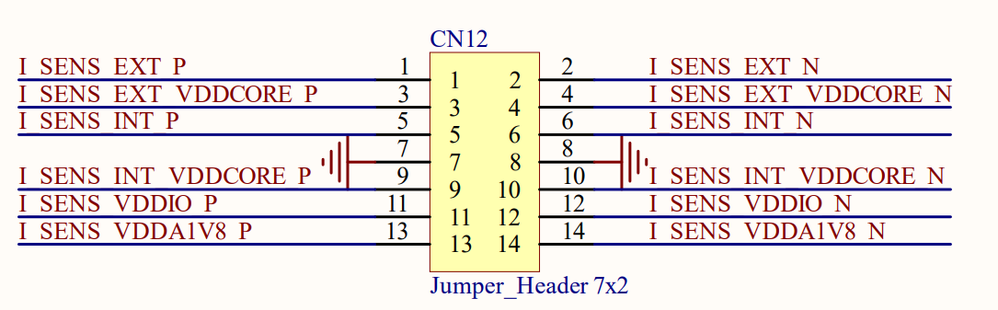

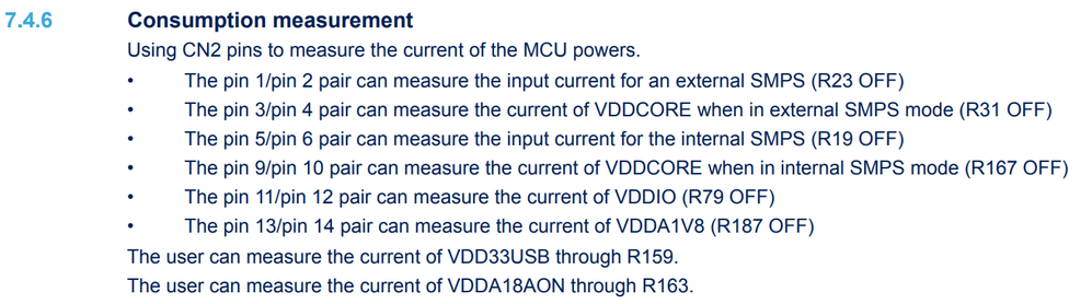

4. Identify the measurement points
To measure power, locate the appropriate measurement points on the boards. Refer to the schematic and user manuals for guidance:

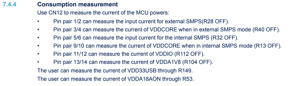

  • Discovery board: Section 7.4.6 of the user manual describes consumption measurement using the CN2 pins (14-pin header).
  • Nucleo board: Section 7.4.6 of the user manual describes consumption measurement using the CN12 pins (14-pin header).
Use the schematics to understand why certain resistors must be removed to enable power measurements. For example, pins 1 and 2 on the header are connected via a resistor that needs to be removed to insert your measurement tool.
Discovery board measurement points on CN2:
Nucleo board measurement points on CN12:
Nucleo board schematic of CN12

To measure power on the STM32N6 Nucleo or Discovery boards, modify the hardware by removing specific resistors (and capacitors, if using STLINK-V3PWR). Let us walk through an example of how to measure power on pins 1 and 2 of the CN2 (Discovery) and CN12 (Nucleo) connectors.
Discovery board modifications:
Nucleo board modifications:

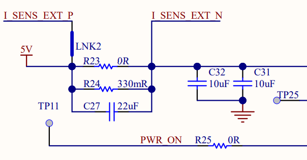

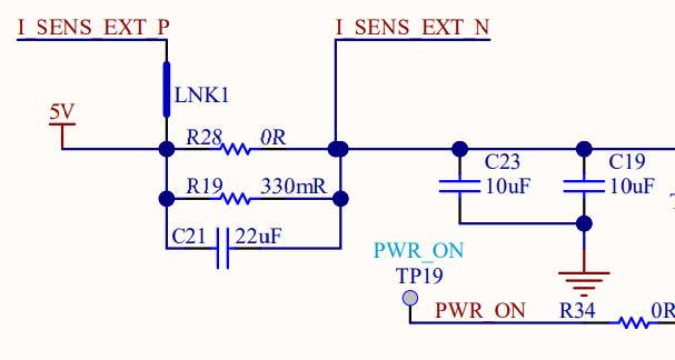

5.1 Example: measuring power on pins 1 and 2 (external SMPS input current)
  1. Locate the measurement points:
    • On the Discovery board, pins 1 and 2 of the CN2 connector correspond to the external SMPS input current.
    • On the Nucleo board, pins 1 and 2 of the CN12 connector serve the same purpose.
  2. Remove the resistor:
    • The zero-ohm resistors connect pins 1 and 2. Removing it breaks the circuit, allowing you to measure the voltage drop across the shunt resistor.
    • Refer to the user manual and schematic to identify these resistors on the physical board.

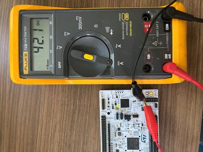

  3. For STLINK-V3PWR users and digital multimeter in ammeter mode:
    • In addition to removing the resistor, you need to remove nearby components.
      • On the Nucleo board, remove C21 and R19.
      • On the Discovery board, remove C27 and R24.
    • These components are located near the previously removed resistor and are shown in the schematic for reference.

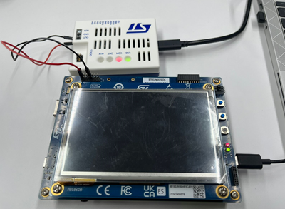

  4. Connect your measurement tool:
    • For a digital multimeter:
      • Attach jumper wires to pins 1 and 2 of the CN2 (Discovery) or CN12 (Nucleo) connector.
      • Connect the multimeter probes to the jumper wires. Make sure that the multimeter is set up to measure current (for example, move the red probe to the correct input to measure current and set the knob to DC current).
    • For STLINK-V3PWR:
      • Screw jumper wires into the OUT and GND terminals of the STLINK-V3PWR.
      • Connect the jumper wires to pins 2 (OUT) and 8 (GND) of the CN2 (Discovery) or CN12 (Nucleo) connector.
  5. Power the board
    • Use a USB Type-C® cable to connect the Nucleo or Discovery board to a power source (for example, a computer).

6.1 Digital multimeter
  1. Ensure your multimeter is properly configured and connected to the STM32N6 board as described in the previous section.
  2. Power the board using a USB Type-C® cable (connected to a computer or other power source).
  3. Observe the current value displayed on the multimeter.

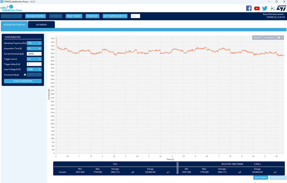

6.2 STLINK-V3PWR with STM32CubeMonitor-PWR
  1. Connect the hardware
    • Attach jumper wires to the OUT and GND terminals of the STLINK-V3PWR and
    • Use a USB Type-C® cable to power the STLINK-V3PWR and the board.
  2. Launch STM32CubeMonitor-PWR
    • Open the software and select the STLINK-V3PWR from the SELECT BOARD dropdown (for example, "STLinkV3PWR @ COMX").
    • Click TAKE CONTROL to establish communication.
  3. Adjust settings (optional)
    • Increase the current threshold (for example, to 50,000 µA) in the "Settings" menu to avoid errors during measurement.
  4. Start the acquisition
    • Click START ACQUISITION to begin recording current measurements.
    • Monitor the real-time current graph and numerical values on the dashboard.BMontanari_0-1751027578761.png
  5. Save the data (optional):
    • Use the save or export option to save your measurement data for analysis.
