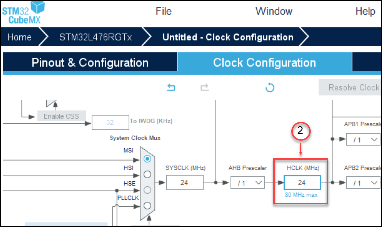

2. Under the Clock Configuration tab, adjust the value of HCLK to 24MHz.

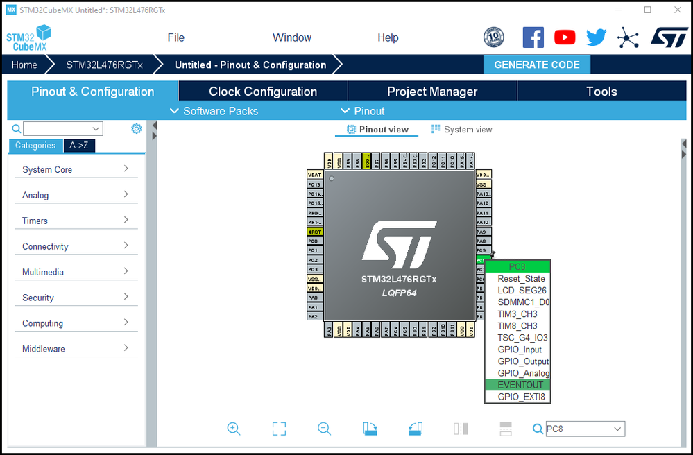

3. Under the Pinout & Configuration select one pin to be the EVENTOUT function.  In this example, choose pin PC8.

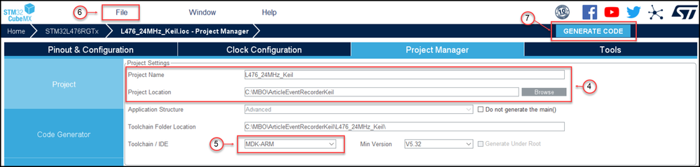

4. Under the Project Manager tab, choose a project location and project name in the project settings.
5. Select the toolchain / IDE for Keil® by selecting "MDK-ARM" in the project settings.
6. Click on [File] then select [Save Project].
7. Next select [Generate Code]

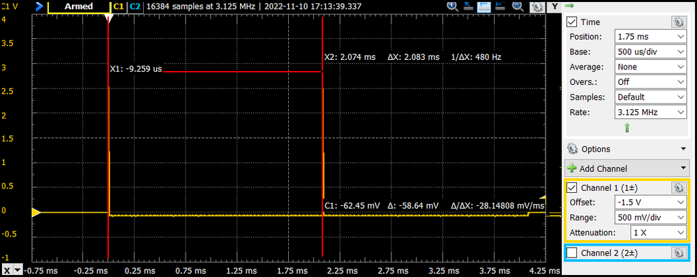

Results
When the code is executed the time measurement between the two pulses from front the SEV assembly commands are measured at pin PC8 on an oscilloscope. The time measured is approximately 2.083ms as shown below.
