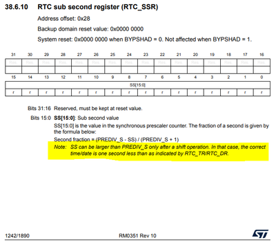

By this logic, (PREDIV_S + 1) is the maximum number of sub seconds we can have in 1 second. Therefore, SS will typically be a value between 0 and PREDIV_S + 1.
As noted in the reference manual, SS can be a value greater than PREDIV_S only when a shift operation is performed to try and synchronize the RTC with a remote clock.

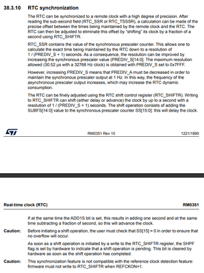

For more details on RTC synchronization, refer to the reference manual for your specific STM32 part number. For STM32L476xx MCUs, RM0351 section 38.3.10 discusses RTC synchronization in detail.

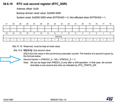

The Second fraction is an equation given in the reference manual and can be found in the section for the RTC_SSR register.
The Second fraction equation uses the RTC’s sub second value (SS) to compute the number of fractions of a second in the current time-of-day.
In simpler terms, the Second fraction equation converts the RTC’s raw sub second value (SS) into fractions of a second, which is generally a more meaningful way to interpret the value.
