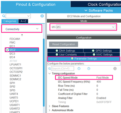

Going back to the *.ioc file [Pinout & Configuration] tab, we first need to configure the I²C. Go to the [Connectivity] tab and select the [I2C2]. At the [Parameter Settings] select the I²C speed mode as “Fast Mode”:

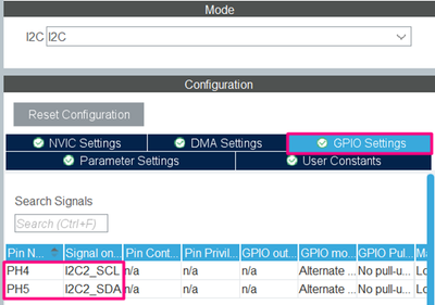

At the [GPIO Settings] tab, change the I²C pinout to the following pins, according to the MCU schematic:

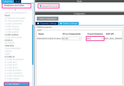

We can now select the software package for our project. Go to [Middleware and Software Packs] → [X-CUBE-MEMS1] and check the “Board Part AccGyr” box. Then, select “I2C2” as [Found Solutions] at [Platform Settings]:

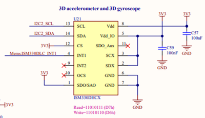

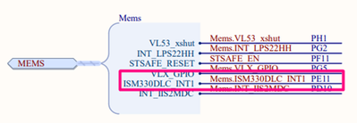

The next step is to set the ISM330DHCX interruption pin, also through the MCU schematic:
Looking for the INT1 interruption pin, we have the PE11 as the final pinout:

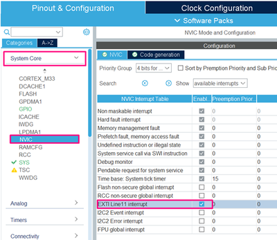

Then, select the PE11 pin and set it as GPIO_EXTI11. After this, go to [System Core] → [NVIC] and check the “EXTI Line11 interrupt” box:

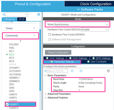

The last peripheral to be set is the USART1, so the result can be printed through serial communication.
Go to [Connectivity] → [USART1] and configure it as the figure below:

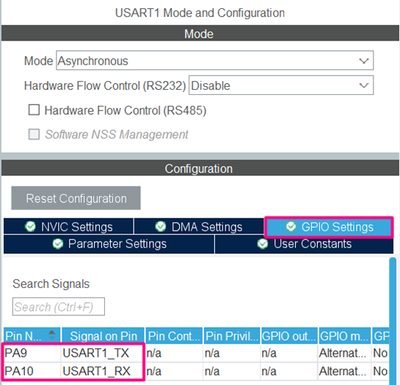

Make sure to change the USART1 pinout as well for PA9 and PA10, like the figure below:

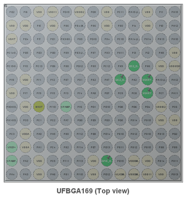

By the end of the configuration, the MCU graphical interface should look like the figure below:

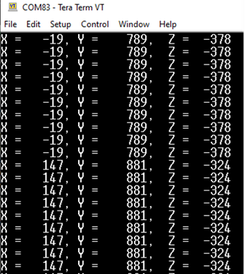

After completing the code execution, you can build and run it onto your board by clicking right in the project name, then selecting:  “Run As” → STM32 C/C++ Application.
4. Code validation
To verify if the code is properly working, open the STM32CubeIDE embedded terminal or Tera Term Terminal with the following parameters: 115200 / 8 / N / 1
By adding the software pack, initializing and configuring peripherals, and programming the firmware for the accelerometer, you can easily open the preferred serial terminal to monitor the sampled data transmission.
