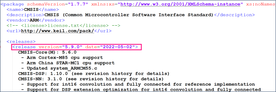

Before you get started, open the ARM.CMSIS.pdsc file in \STM32Cube_FW_xx_Vx.x.x\Drivers\CMSIS folder with notepad to know which CMSIS version is included in the package.

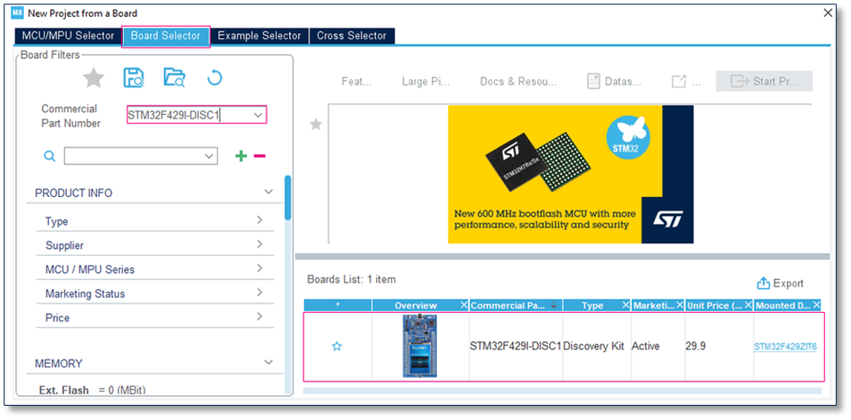

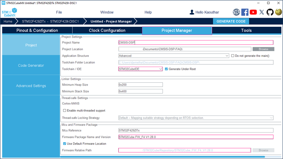

1. Create a new project using STM32CubeMX and STM32F429-DISC1 board.
2. After finishing the settings, generate the code with the STM32CubeIDE tool chain and STM32CubeF4 1.28.0

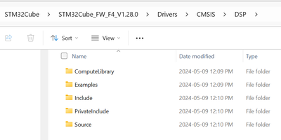

4. Copy these folders in the created folder:
<STM32Cube_Repository>\STM32Cube_FW_F4_V1.28.0\Drivers\CMSIS\DSP\Include
<STM32Cube_Repository>\STM32Cube_FW_F4_V1.28.0\Drivers\CMSIS\DSP\PrivateInclude
<STM32Cube_Repository>\STM32Cube_FW_F4_V1.28.0\Drivers\CMSIS\DSP\Source

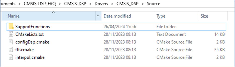

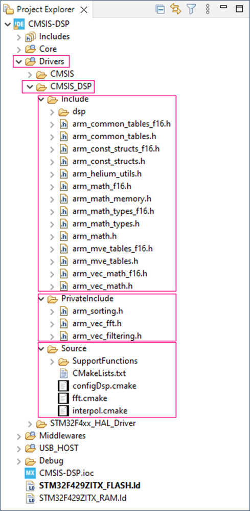

5. For this example, only the SupportFunctions are used. For that, open the "Source" folder under "..\Drivers\CMSIS_DSP" and keep only the SupportFunctions (other folders can be removed).

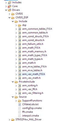

6. Make sure that you have these folders in your project with this structure

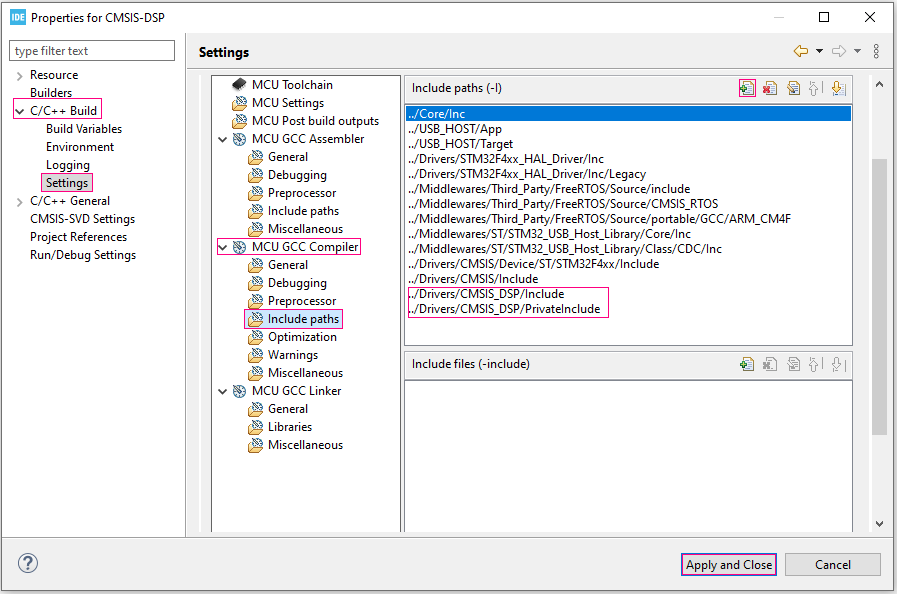

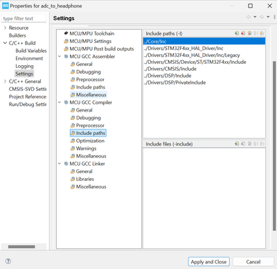

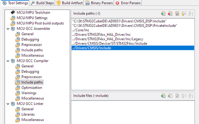

7. Update include paths:
Include paths: Select project properties from the [Project Explorer] section
From the [Project menu or [File menu], go to [Project properties] > [C/C++ Build] > [Settings] > [Tool Settings] > [MCU GCC Compiler] > [Include paths]
  • Click on [Add] to include the new paths.
  • Add the ../Drivers/CMSIS_DSP/Include path and the ../Drivers/CMSIS_DSP/PrivateInclude path

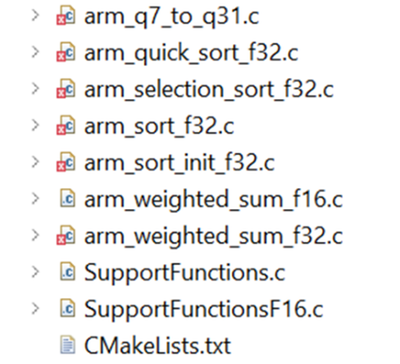

8. Open SupportFunctions.c and SupportFunctionsF16.c files and comment these lines of code:

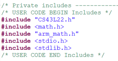

9. Now, you can use the DSP libraries in your project. For that open main.c and add the required header file "arm_math.h" and declare the used variables:
#include "arm_math.h"

There are some mistakes in 7.
The path is wrong(but they're correct in the figure)
  • Add the ../Drivers/CMSIS/CMSIS_DSP/Include path and the ../Drivers/CMSIS/CMSIS_DSP/PrivateInclude path  <- Path here is wrong
KDJEM.1
Hello @Bruce_nForeTek and welcome to STCommunity :),
Glad to know that this FAQ can help to integrate the DSP library with STM32U5.
Thank you for bringing the step 7 typo to our attention.
The typo is fixed.
Thank you again for the continued feedback; it is much appreciated!

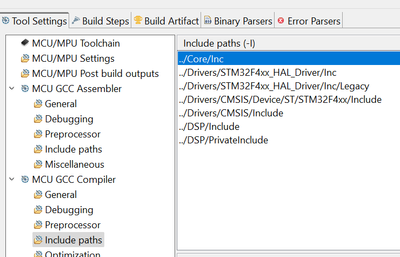

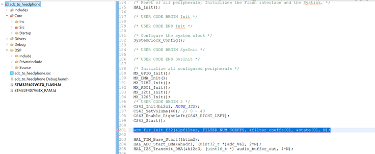

I had a project working with the CMSIS 5.8.0 but wanted to update it to use CMSIS 5.9.0. I followed your steps, but things are not working as expected. I get an undefined reference to `arm_fir_init_f32' error when I try to compile, which is the first function I try to use from CMSIS-DSP. To be clear, I removed the arm_cortexm4lf_math library that I used to need. I did not comment anything out of any .c files, so all functions should be available. Do you have any idea what the problem might be? Thank you so much for your advice!
Edit: Since I did not put my DSP folder inside Drivers folder, I had to add DSP folder as Source Location. Then the DSP functions were located, but tons of complaints about multiple definitions. Originally I thought you were commenting out stuff in SupportFunctions.c and SupportFunctionsF16.c because you weren't using those bits, but wow those <foldername>.c and <foldername>F16.c files have to be commented out or deleted in every folder a person keeps in their project! So I did all that and my code compiles, but I am still not all the way there. My filter code that worked with the previous CMSIS-DSP setup (with the arm_cortexm4lf_math library and all) now does not work and causes all kinds of strange behaviours. Still wrestling. Will report back if/when I figure it out.
Further edit: Code was fine, but my filter with 101 coefficients that worked fine before now takes too long for my 1024 half DMA buffer. If I reduce to a filter with 81 coefficients, everything is OK. Surprised that the previous setup for CMSIS-DSP would be faster then the new setup. Other interesting note: the output of my code completely dies (even talk-through, no filter) when I set -Ofast flag.
KDJEM.1
Hello @JvdV,
Which error did you get about "arm_fir_init_f32.c"?
If you encounter any issues, we suggest that you create a post in the ST Community for further assistance.
To check the issue could you please share your project when you create a new thread in the community?

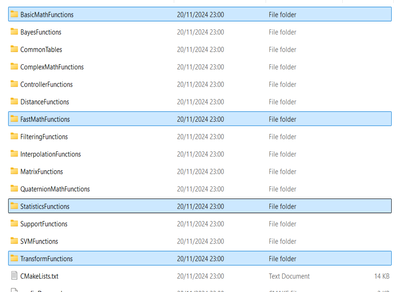

Many thanks for these instruction, however I think I have not been the only person to be a little confused by them and I hope that the following clarification will be helpful to others.
The example given above is not a complete description of how you can gain access to all of the CSMIS-DSP functions in your project. Consider, for example, a project for which you want to use a complex FFT, a power-measurement and some general maths utility functions (sin, cos, tan etc). In that case, and assuming that you are not yet familiar with CSMIS-DSP, you need to start by navigating to your repository and browsing the source code folder, for example, in my setup this location is:  "..\Repository\STM32Cube_FW_F4_V1.28.1\Drivers\CMSIS\DSP\Source".
You will find there a bunch of folders with names that should guide you to where your wanted functions live, like this:
In some cases it won't be totally obvious as to which folder contains a function that you want to use. In that case you need to have a poke around inside likely looking folders and hopefully you will soon find what you're after. You can of course use the CMSIS-DSP documentation (which is excellent) and search for your wanted function API to identify where it lives in the distributed file system.
I've highlighted the locations where the examples that I mentioned happen to live:
  • BasicMathFunctions & FastMathFunctions for useful maths utilities
  • StatisticsFunctions for the power calculation
  • TransformFunctions for the FFT
Having identified your wanted folders, copy them into your workspace's Drivers/CMSIS_DSP/Source folder, alongside the SupportFunctions folder that's described earlier in this post.
Now for the crucial and rather odd step that must also be followed: For each and every one of the source folders that have been copied into your workspace (e.g. Dir-1 = TransformFunctions; Dir-2 = FastMathFunctions etc..) you must edit the file pairs such as: (1a) TransformFunctions.c and (1b) TransformFunctionsF16.c; (2a) FastMathFunctions.c and (2b) FastMathFunctionsF16.c to comment out their #inclusion of all source files. If you don't do this you will see hundreds of compiler errors due to multiple definitions of the various functions.
I don't know why the code is distributed in this weird way, but anyway, once you understand what needs to be done it's not hard to get up and running.

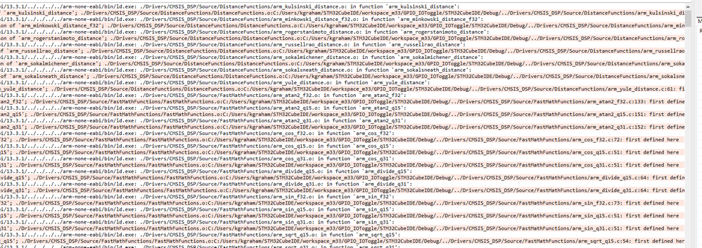

I am trying to import the entire CMSIS-DSP library into my project. I believe I have followed the tutorial example, but I am getting the following errors while I am building the project, multiple definitions of the CMSIS DSP functions.
How can I resolve this issue?  Thank you.
JvdV
Associate II
Hi kag_embedded, I recall having this issue also. I made some instructions for my students that may be helpful. I've pasted them in. Good luck!
Adding CMSIS DSP functions to your project
Go to your File Explorer. In the Drivers folder of your project, create a folder called DSP.

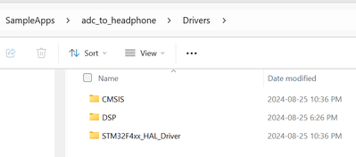

Go to C:\Users\your_user_name\STM32Cube\Repository\STM32Cube_FW_F4_V1.28.0\Drivers\CMSIS\DSP

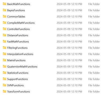

This directory contains the folders shown:
From this directory, copy the Include, PrivateInclude, and Source folders into the DSP folder you created.
Open the C:\DSP Concepts\AWECore ST_EVAL_CortexM4 Release-8.D.2.7\SampleApps\cmsis_dsp\Drivers\DSP\Source directory. Delete any folders that your project does not need. For the remaining folders, delete any functions that your project does not need.
One at a time, open each folder that remains in the DSP/Source folder your project. Each folder contains a file called <foldername>.c, and many also include a file called <foldername>F16.c. For example in DSP/Source/SupportFunctions, the last two files are SupportFunctions.c and SupportFunctionsF16.c. Delete these two functions to avoid multiple declaration errors. Do the same for each folder in the DSP/Source directory.
Go to STM32CubeIDE. In the Project Explorer, right-click on your project name and click on Properties. In C/C++ Build – Settings – MCU GCC Compiler – Include paths, click on the final entry, and then click the green plus. Add the path ../Drivers/DSP/Include. Repeat to include the path ../Drivers/DSP/PrivateInclude. Click Apply and Close.
In your Project Explorer, go to Core/Src and double-click on main.c to open it. To use the CMSIS DSP code, you must add #include "arm_math.h" to the USER CODE Private includes area.
kag_embedded
Associate III
Thank you. Deleting these files resolved my issue.

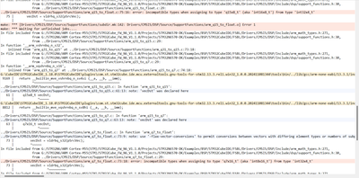

Hello, in the process of importing DSP library, I followed the tutorial steps to delete the relevant files, but in the SupportFunctions folder, I reported the above two errors, how to solve? thank you
JvdV
Associate II
I have not experienced those errors, JACK-LUCK. Maybe check that you added the folders to your project's include paths as shown above, and have #include "arm_math.h"?
kag_embedded
Associate III
What mcu are you compiling the support_functions that you are having the errors?
JACK-LUCK
Associate II
I included the relevant content according to the tutorial, also added #include "arm_math.h", I used STM32N657X0H, please, thank you
KDJEM.1
Hello @JACK-LUCK and welcome to the community;
For STM32N6 devices could you please try to add this flag -flax-vector-conversions in Project => Properties => C/C++ Build => Settings => MCU/MPU GCC Compiler => Miscellaneous => "Other flags"
If the issue isn't solved, I recommend you to create a new post in the community and share your project?
I hope this help you!
Thank you.
Kaouthar
