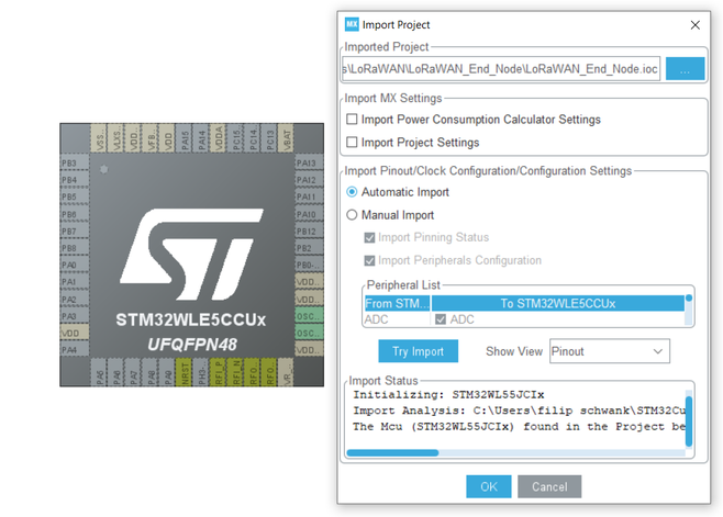

  1. Open STM32CubeMX (standalone) and create a new project for QFN STM32WLE5CC.
  2. Navigate to File -> Import project and navigate to the .ioc file of the Nucleo End_node  "\STM32Cube_FW_WL_V1.3.0\Projects\NUCLEO-WL55JC\Applications\LoRaWAN\LoRaWAN_End_Node".
  3. Import all configurations using the automatic import feature and click on "Try import."
  1. Once the import is complete, the configuration for the QFN package should be the same as for the BGA package.

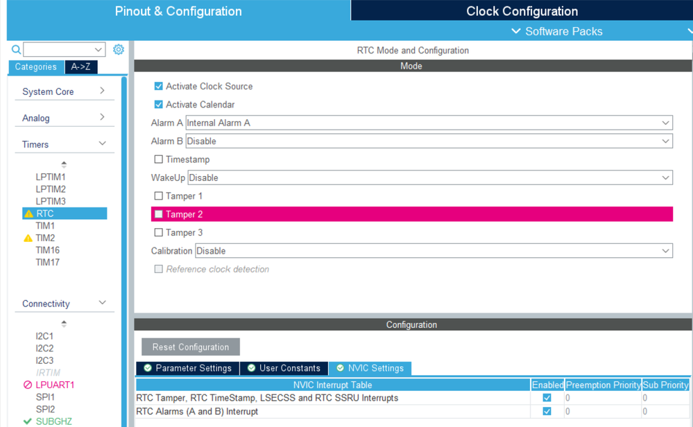

  1. Enable "Alarm A" for RTC and ensure that all necessary interrupts are enabled in NVIC RTC, UART, and sub-GHz.

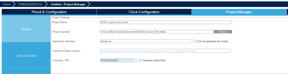

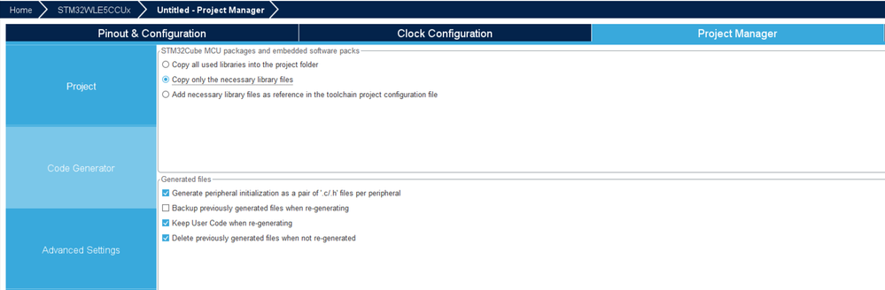

  1. In the project settings, provide a name in the "Project options". and select an IDE to generate for (e.g., STM32CubeIDE).
  1. Ensure that STM32CubeMX is set to "copy only the necessary library files". This means the project is linked to libraries copied within the project and not to the STM32CubeWL repository. By doing so, the project is standalone.

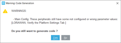

  1. Generate the code. The generator may report some pins that cannot be generated. These warnings can be ignored as they can be redefined manually in main.h.

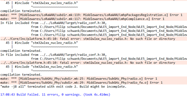

  1. Once the project is generated, open it in an IDE (in this case CubeIDE). If you compile now, it reports a missing BSP (board support package – a simple library for the specific Nucleo board that the example was made for).

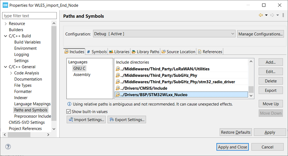

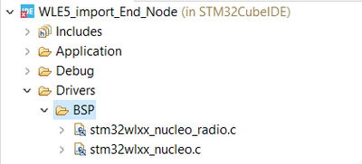

  1. Manually copy the BSP from the STM32CubeWL repository \Drivers\BSP\STM32WLxx_Nucleo into the project \Drivers folder. To link .c files in STM32CubeIDE, create a BSP folder in the STM32CubeIDE project structure. Drag and drop (link only, the file is already copied manually) the .c files from \WLE5_import_End_Node\Drivers\BSP\STM32WLxx_Nucleo.
  1. To link the .h files, open the project properties, C/C++ General, Paths and Symbols. Add ../Drivers/BSP/STM32WLxx_Nucleo

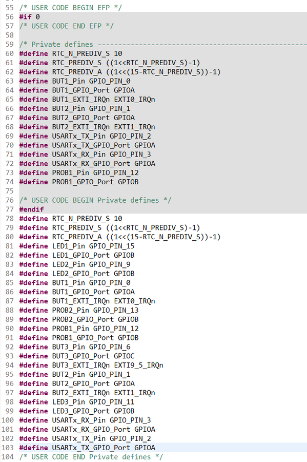

  2. Copy the definitions main.h from the example STM32Cube_FW_WL_V1.3.0\Projects\NUCLEO-WL55JC\Applications\LoRaWAN\LoRaWAN_End_Node. Keep in mind that any modification outside of the user code section can be overwritten by the next STM32CubeMX code generation.  Therefore, a #if 0 trick can be used.

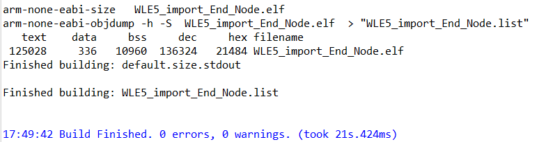

  4. At this point, the project should be able to compile successfully and can be even run on a WL55-Nucleo.FilipSCHWANK_32-1702398638712.png
