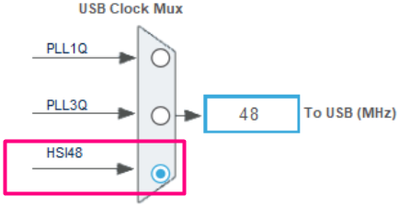

Go to the Clock Configuration tab. We suggest increasing the frequency of HCLK to achieve the best application performance. See the clock example settings used for this application.
Most importantly, change the USB Clock Mux source to the HSI48.

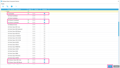

Once the package is installed, enable the following required components:
  • USB USBX -> USBX -> CoreSystem
  • USB USBX -> USBX -> UX Device CoreStack
  • USB USBX -> USBX -> UX Device Controller
  • USB USBX -> USBX -> UX Device Class HID Core
  • USB USBX -> USBX -> UX Device Class HID Mouse
Note: a warning message might appear, but it can be ignored.
You can select different classes depending on your application. Make sure to have the CoreSystem, CoreStack, and Controller enabled. These components are required for the application. After selecting the packages, press OK.

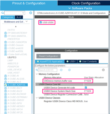

Now, back to the X-CUBE-AZRTOS-H7 under the "Middleware and Software Packs" and enable USB USBX components:

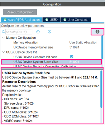

Once the USB USBX package is enabled, a configuration menu is shown. In the AzureRTOS application, we need to increase the UXDevice memory buffer size and the USBX Device System Stack Size. For the HID class, 5KB is sufficient for our application. Enabling the information menu, you are able to see the suggested amount of memory needed for each class when selecting the USBX Device System Stack Size:

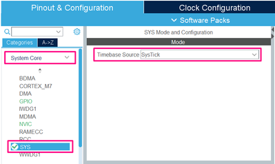

It is necessary to set a timebase for our application. Since we are not using RTOS, we can use the default SysTick to be our timebase. So, go to System Core->SYS and select the SysTick as the timebase source:

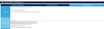

Now, go to the "Project Manager" tab and then the "Code Generator" section. Enable the “Generate peripheral initialization as pair of ‘.c/.h’ files per peripheral”. This facilitates the access to the peripheral resources in the code.

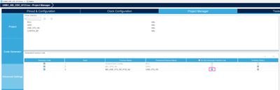

The final last step is to disable the USB_OTG_HS peripheral initialization code in the Advanced Settings also in the Project Manager.

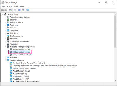

After compiling and flashing this code onto the microcontroller, connect a Mini-USB cable to the user USB connector (CN13). When the USB is connected, pressing the user button makes the mouse to move in the diagonal direction and turn on the yellow LED. The yellow LED stays on as long as the user button is pressed.
