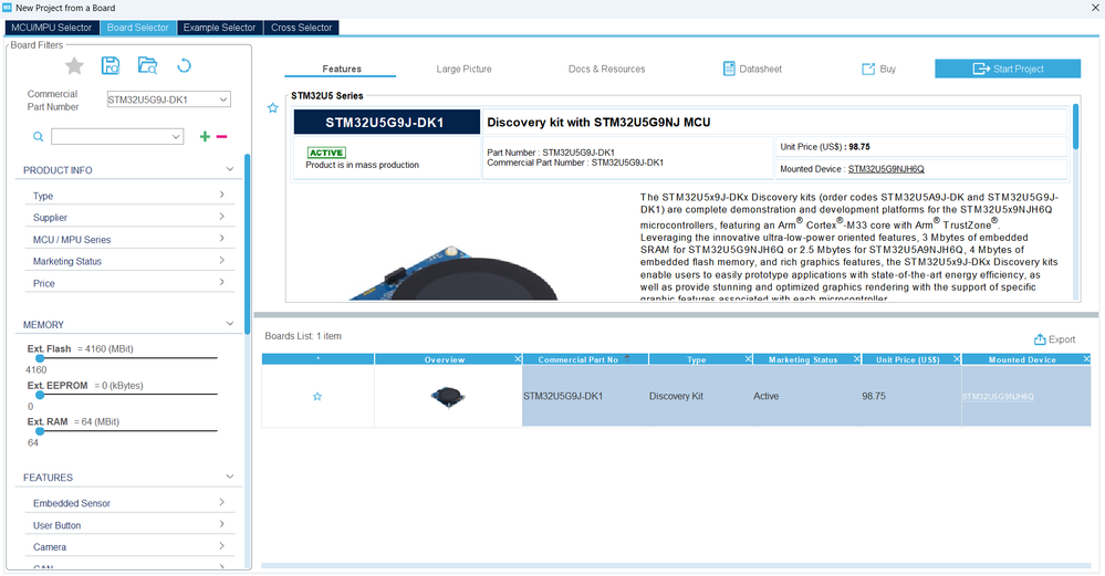

1.1 Create a project
  • Start by creating a new project using the STM32CubeIDE by clicking [File -> New -> STM32 Project]. Use the [Board Selector] tab and select the [STM32U5G9J-DK1].
  • Initialize all peripherals with their default mode.

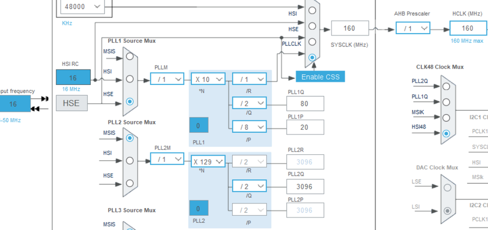

  • In the clock configuration tree viewer, set HCLK to maximum speed.

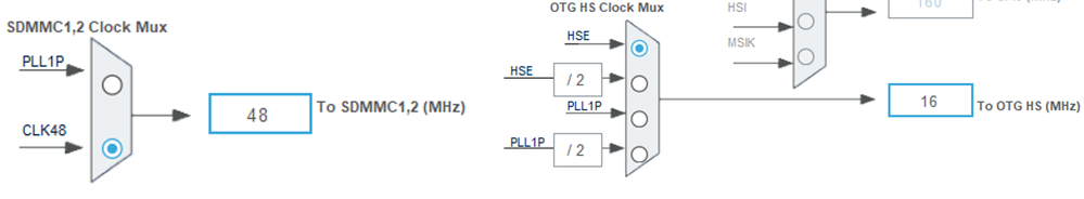

  • Configure SDMMC1 clock source as CLK48 and USBHS clock source as HSE

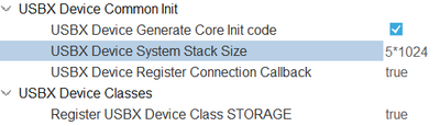

1.2 Configure USBX middleware

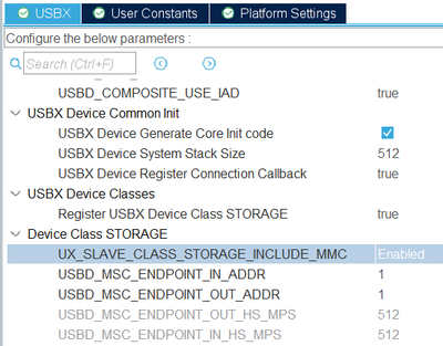

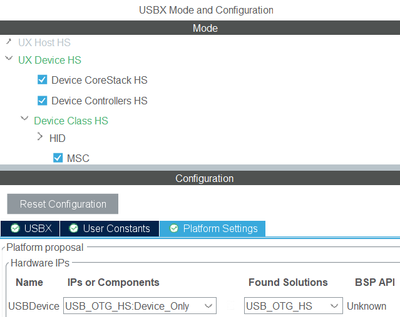

  • Enable the USBX Device middleware package.
  • Configure the following parameters:

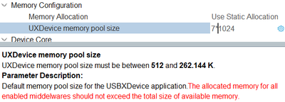

  • Configure the UXDevice memory pool size and USBX Device System Stack Size appropriately:

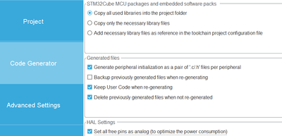

  • In Code Generator Settings, set all free GPIO pins to Analog mode to reduce power consumption.
  • After completing the USBX and peripheral configurations in STM32CubeMX, save your project and generate the initialization code.
