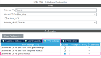

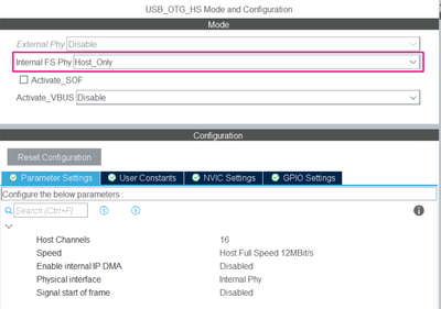

Under the Connectivity tab, enable the USB_OTG_HS peripheral in Host_Only mode for the Internal FS Phy. The standard peripheral settings are used for this example, so it is not necessary to change them.
Go to the NVIC settings tab and enable the USB On The Go HS global interrupt.

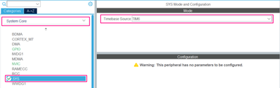

Now, change the HAL Timebase source to Timer 6, since we use the Azure RTOS, and its kernel uses the SysTick for the time base.

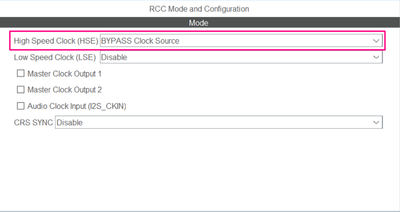

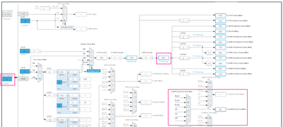

In the next step, we will adjust the project clock settings. The first step is to locate the RCC, under System Core, and enable the HSE in BYPASS Clock Source. This board receives an 8MHz clock from the debugger probe. A stable clock is required for USB Host applications.

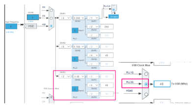

Then, going to the Clock Configuration tab, adjust the HSE input frequency to 8 MHz, and adjust the PLLs to achieve the most convenient frequency according to your project. In this example, set the value to 260 MHz. Also, take care with the USART Clock source.
          Adjust the following peripherals to achieve 48 MHz in the USB peripheral.

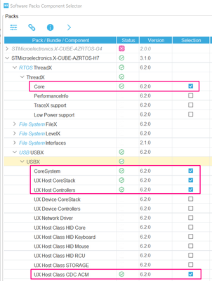

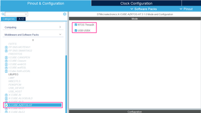

          Now, we can add the X-CUBE-AZRTOS-H7 package with the Azure RTOS and the USBX. For that, go to the Middleware and Software Packs menu, and click over the X-CUBE-AZRTOS-H7 package. By doing that, the Software Packs Component Selector menu pops up. There, it is necessary to add the following components:
Once selected close the menu and go back to the X-CUBE-AZRTOS-H7, there you will have to enable both RTOS ThreadX and the USB USBX packages.

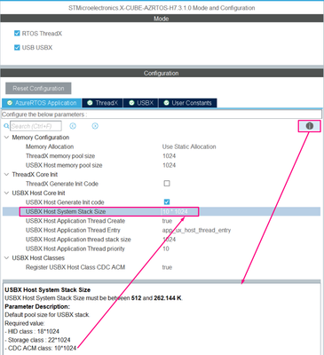

For the next step, we will adjust the amount of data to Host Application Stack. You may find a useful list with the recommended memory footprint needed for each class. This is done by enabling the information menu as shown below:

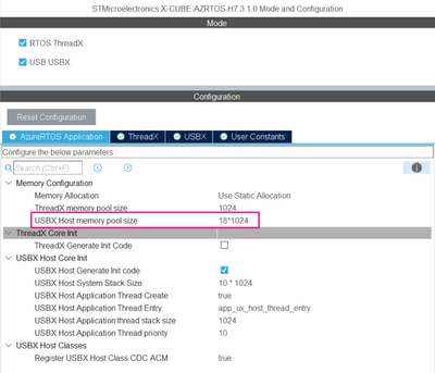

You will have to increase the USBX host memory pool size. This number should be higher than Host system Stack size, since the pool comports the stack. You may also increase this value if your application needs to have some threads. For this example, the selected value was arbitrarily chosen as 18KB, but you can optimize this value according to your application.

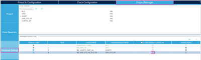

Go to the Project Manager tab, and in the Code Generator section, enable the “Generate peripheral initialization as a pair of ‘.c/.h’ files per peripheral” option.
The last step in the STM32CubeMX is to disable the USB Peripheral initialization code by HAL, as this is handled by the RTOS. For that, go to Advanced Settings and enable the “Do Not Generate Function Call” option for the USB_OTG_HS.

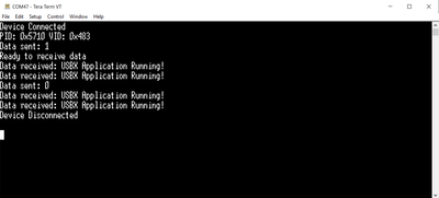

                                                             printf("Device Connected \r\n");
                                                             printf("PID: %#x ", (UINT)cdc_acm -> ux_host_class_cdc_acm_device -> ux_device_descriptor.idProduct);
                                                             printf("VID: %#x \r\n", (UINT)cdc_acm -> ux_host_class_cdc_acm_device -> ux_device_descriptor.idVendor);
                                                            tx_mutex_put(&cdc_acm_uart_mutex);

                                        tx_mutex_get(&cdc_acm_uart_mutex, TX_WAIT_FOREVER);
                                        printf("Device Disconnected \r\n");

                              status = _ux_host_class_cdc_acm_write(cdc_acm, &UserTxBuffer[nibble], 1, &tx_actual_length);
                              if (status == UX_SUCCESS)
                                        printf("Data sent: %c\r\n", UserTxBuffer[nibble]);
                              else
                                        printf("Unable to send data\r\n");

                                        status = ux_host_class_cdc_acm_reception_start(cdc_acm, &cdc_acm_reception);
                                                   printf("Ready to receive data\r\n");

                                        printf("Data received: ");
                                        for(uint16_t count = 0; count < block_reception_count; count++)
                                                   printf("%c", UserRxBuffer[count]);

To try this demonstration project, after flashing the code onto the microcontroller, you can open a terminal on your computer and connect it to the STLINK virtual COM Port. Then, you can connect a USB CDC device to the user USB connector and check the log information.
Once the USB device is connected to the NUCLEO-H723ZG, a message is printed in the terminal showing its PID and VID. After that, the host (STM32H7) will transmit the values 0 and 1 every second to the device, and the received data will also be printed in the terminal.
To test this demo, we used the code constructed in the How to implement the USB Device CDC (VCOM) in STM32 using the Azure USBX package. We invite you to view that article for further details.
