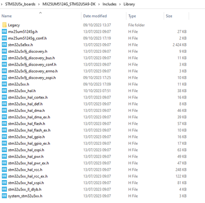

    Ensure the following:

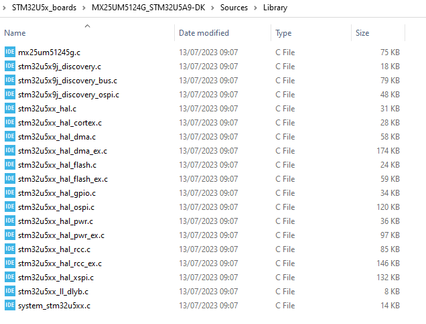

    The MX25UM5124G_STM32U5A9-DK\Includes\Library folder must contain these headers as shown in the below figure:
    The MX25UM5124G_STM32U5A9-DK\Sources\Library folder must contain these headers as shown in the below figure.

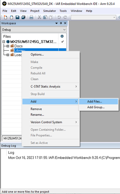

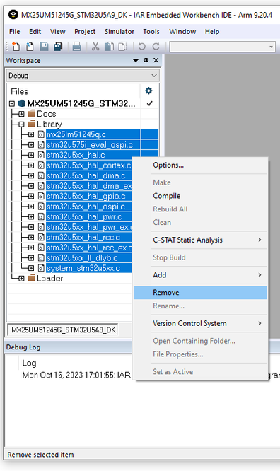

  • Select all sources files in library then click right and remove them as shown in the figure below:
  • Right click on Library -> Add -> Add Files, select all source files available under MX25UM51245G_STM32U5A9-DK\Sources\Library\

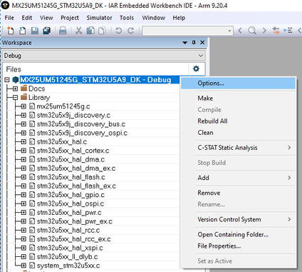

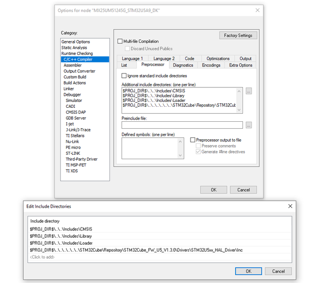

  • Right click in the project then select "options" and add the include path:
    "$PROJ_DIR$\..\..\Includes\CMSIS"
    "$PROJ_DIR$\..\..\Includes\Library"
    "$PROJ_DIR$\..\..\Includes\Loader"
    "$PROJ_DIR$\..\..\..\..\..\..\STM32Cube\Repository\STM32Cube_FW_U5_V1.3.0\Drivers\STM32U5xx_HAL_Driver\Inc"

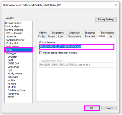

  • Modify the output name:

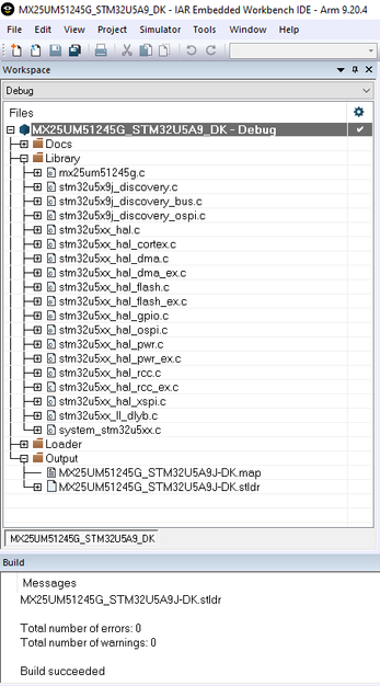

  • Build the project and make sure that the built is succeeded with 0 error and warnings. An MX25UM5124G_STM32U5A9J-DK.stldr is created in the output

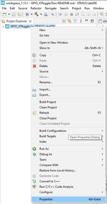

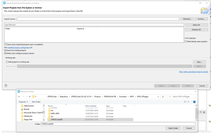

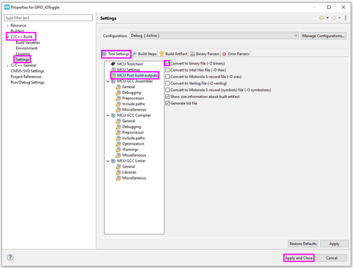

  1. Open GPIO_IOToggle example from \Repository\STM32Cube_FW_U5_V1.3.0\Projects\STM32U5x9J-DK\Examples\GPIO\GPIO_IOToggle using STM32CubeIDE as shown in the below figure:
  2. Right-click the GPIO_IOToggle project to modify its properties
  3.  Select "Convert to binary file(-O binary)" to create a binary file as shown in the figure belowKDJEM1_3-1697038936824.png
  4. Click to Debug  KDJEM1_4-1697038963219.png then click toKDJEM1_5-1697038963220.png

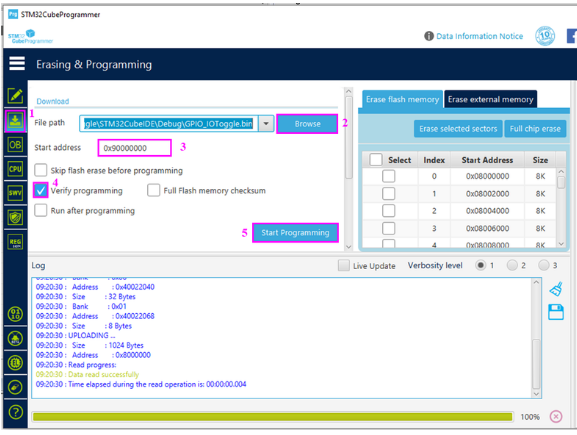

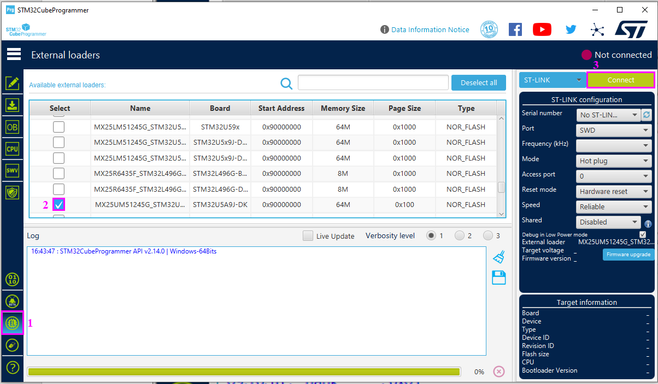

  5. Open STM32CubeProgrammer and click to External loaders, select MX25UM5124G_STM32U5A9J-DK.stldr and click to connect as in the figure below
  6. Click on the icon "Erasing & programming":
    Browse to the GPIO_IOToggle.bin binary created previously.
    Choose the "Start address" 0x90000000 and select "Verify programming" to verify the download.
    Click on "Start Programming".
    Please make sure that the download verified successfully.
  7. Click button reset and you can see LD3 and LD4 toggling.

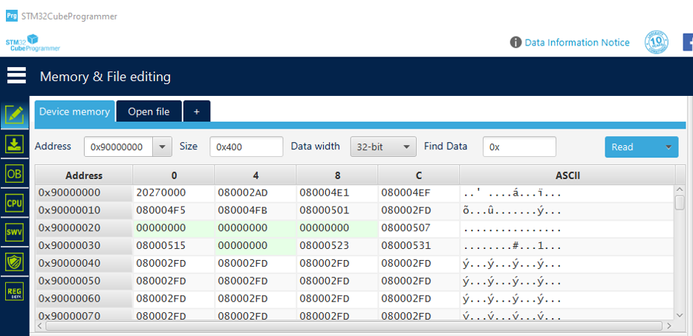

  8. Go to "Memory & File editing" and verify the same data output in 0x08000000 and in 0x90000000.
