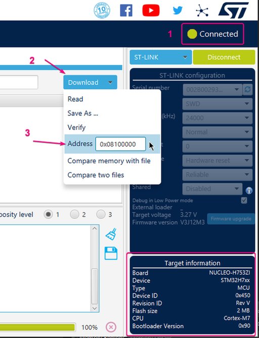

To allocate the web pages as a binary file inside the microcontroller, a tool called fxImageCreator is used, the tool and the software license agreement are attached, please make sure to read the license agreement before using it. The tool creates a bin image with a file system for embedded system memory, containing the structure file tree and identifying the file easily. While it can be used with external memories, it works nicely with embedded memory as this tool can be configured to fill the exact number of bytes made available by the LevelX setting.
The web_demo.bin file is provided in this article, containing all files required for three html pages to be displayed and interacted with. Just as a quick reference, the file about.html is a page displaying a few product features present in the NUCLEO-H753, including an image of the board. A small debrief about the demo is also shown, together with links to the Nucleo board online page and the two other pages hosted by the demo, called Index.html.

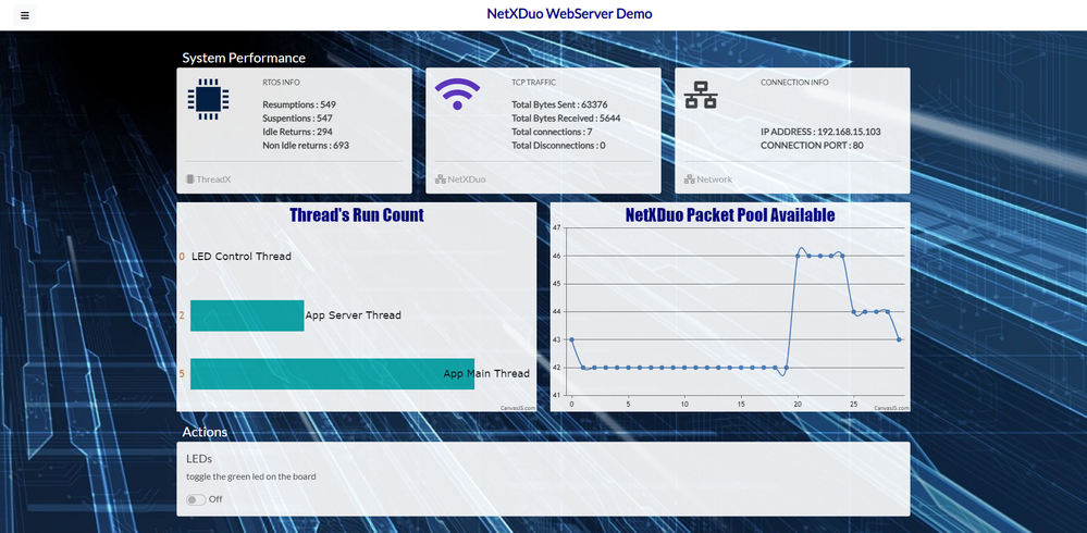

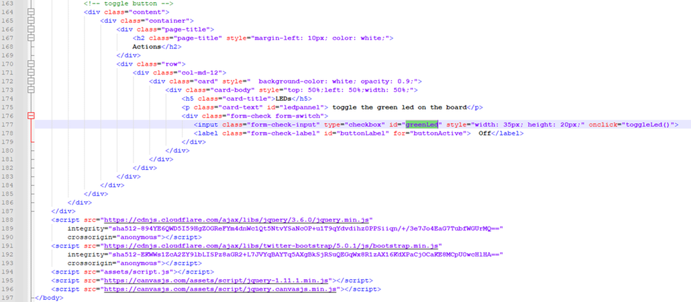

Index.html displays further information about the Nucleo board and its microcontroller with images and links. Furthermore, a description of the Azure RTOS STM32Cube expansion and dashboard.html that displays system performance data regarding RTOS TCP traffic and connection information. Two graphs are shown representing the number of times each thread ran and how many NetXDuo packets are available. A toggle button at the bottom of the page controls the green LED on the board.

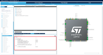

One of the key aspects is properly configuring the MPU on the CORTEX_M7. Enable both CPU caches, speculation default mode and set the MPU control mode as background region privileged access only + MPU disabled during hard fault, NMI, and FAUTMASK handlers. More details about the settings and addresses are covered in this article: https://community.st.com/t5/stm32-mcus/how-to-create-project-for-stm32h7-with-ethernet-and-lwip-stack/ta-p/49308
MPU regions must be configured to specify the access to both Ethernet descriptors, such as in the picture below.
Figure 2 – MPU configurationFigure 2 – MPU configuration

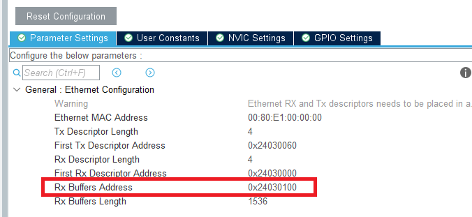

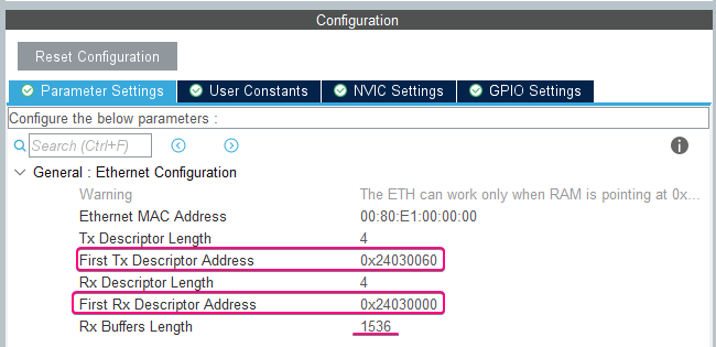

In the connectivity tab, both the Ethernet and USART3 peripherals are used. Ethernet is the focus of this application, and the serial port is used for debug purposes, such as application flow and IP address handling.

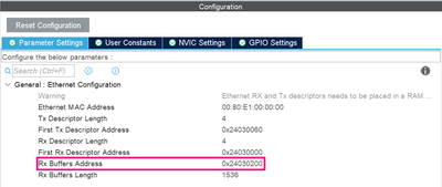

RMII Ethernet mode must be enabled. Configure the Rx buffers length to the maximum value and the first descriptor addresses must be set as such:
Figure 5 – Ethernet configurationFigure 5 – Ethernet configuration

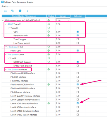

1.1.2 Middleware and software packs tab setup

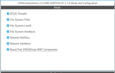

In this tab, "MIDDLEWARES" is selected. Look for the X-CUBE-AZRTOS-H7 and download its latest version if it is greyed out. Once it is installed click it to open the software packs component selector pop-up.
Now, select the following middleware to configure the operational system ThreadX, the file system FileX and its subsystem LevelX. Doing so, we can simulate a NOR interface inside the microcontroller’s memory:
Figure 8 – Software Packs ecosystem configurationFigure 8 – Software Packs ecosystem configuration

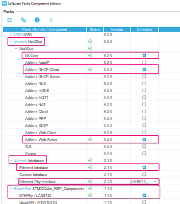

Next, the network middleware and interface must be configured. NetXDuo has its core and both DHCP client and web server addons enabled. The network interfaces and BSP PHY must be configured respecting the parts present in the Nucleo board.
Figure 9 – Software Packs network configurationFigure 9 – Software Packs network configuration
After selecting all the necessary components, press ok and the pop-up will be closed to present a few checkboxes. All of them must be checked so that the middleware is included in the project files.
Figure 10 – Middleware selection tabFigure 10 – Middleware selection tab

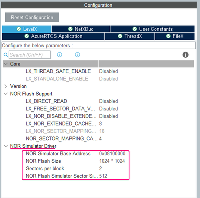

LevelX is used in this application to simulate a NOR driver in the microcontroller’s internal memory.
Figure 11 – LevelX ConfigurationFigure 11 – LevelX Configuration
We must configure the base address of the simulated NOR driver to 0x08100000, its size to 1 MB and sectors to two, as the picture shows. The html files are stored at this address.

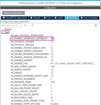

This middleware is the heart of the application, managing the webserver and all its required protocols under the OSI model. Starting with the core, NX_ENABLE_INTERFACE_CAPABILITY must be checked.
Figure 12 – NetXDuo configurationFigure 12 – NetXDuo configuration

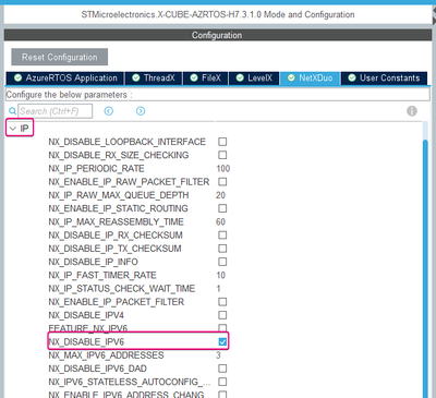

On the IP subsection, the NX_DISABLE_IPV6 checkbox must be ticked and the other parameters as default
Figure 13 – IP configurationFigure 13 – IP configuration

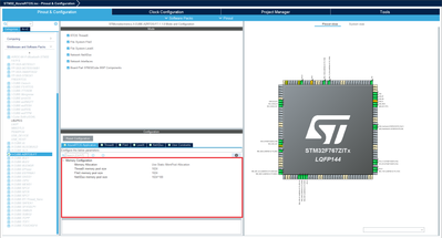

1.1.2.3 AzureRTOS Application Configuration

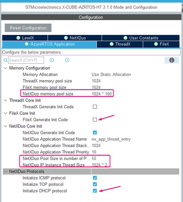

This tab configures the memory allocation and initialization of all related stacks and middlewares.
The NetXDuo memory pool size must be multiplied by 100. "FileX Generate Init Code" box must be unchecked. NetXDuo pool size in number of packets must be set to 50 instead of 5. The IP instance thread size multiplied by 2. The last configuration is to check the "Initialize DHCP protocol."
Figure 14 – Pool size configurationFigure 14 – Pool size configuration

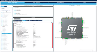

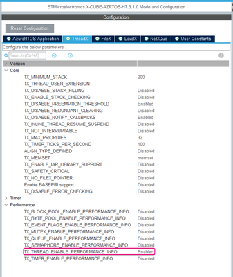

1.1.2.4 ThreadX Configuration
Here is where the kernel is configured. The only difference from default settings is that the TX_THREAD_ENABLE_PERFORMANCE_INFO parameter must be enabled.
Figure 15 – ThreadX configurationFigure 15 – ThreadX configuration

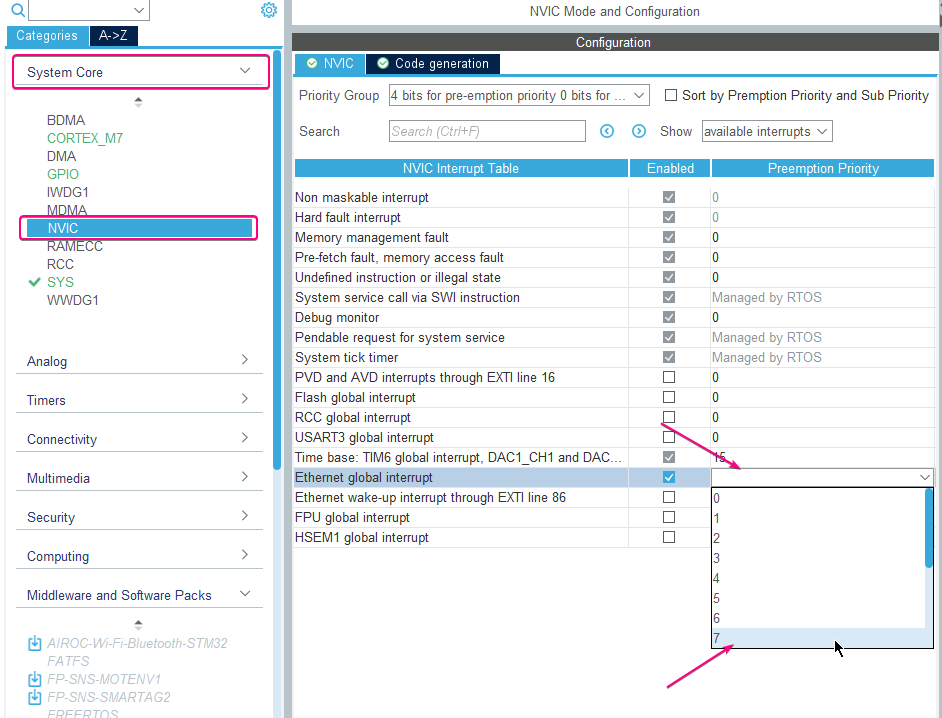

After enabling the RTOS, the preemption priority of the Ethernet interruption must be configured to 7. This is done in the NVIC tab as shown below:
Figure 16 – NVIC configurationFigure 16 – NVIC configuration

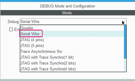

1.1.4 Debug tab setup
In this tab, the "Serial Wire" debug mode must be configured. This adds two signals to the pinout view, both connected to STLINK on the Nucleo board allowing the use of debug features.
Figure 17 – Debug configurationFigure 17 – Debug configuration

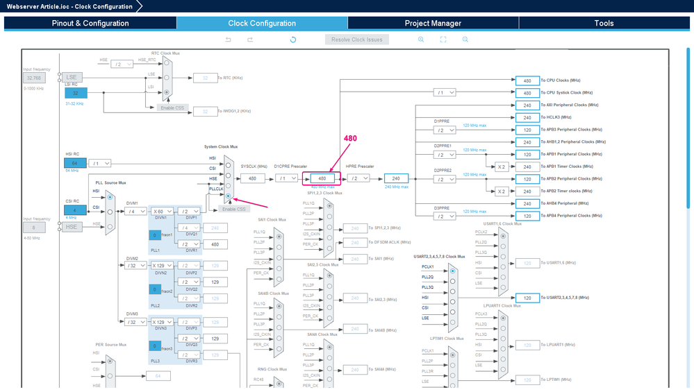

1.1.5 Clock Configuration
As briefly mentioned earlier, to achieve the best possible performance the M7 core must run at the highest frequency allowed. To do so, the SYSCLK source must be set to PLLCLK and the PLL1 block must have its values configured to multiply the 64 MHz HSI clock to 480 MHz. This is given that the hardware revision is rev. V or X, otherwise the maximum frequency allowed is 400 MHz (ES0392).  The STM32CubeIDE calculates the values automatically if the desired clock frequency is inserted in any of the blue contoured blocks.
Figure 18 – Clock configurationFigure 18 – Clock configuration

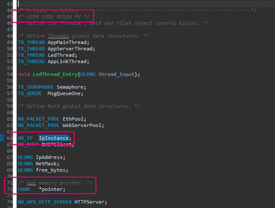

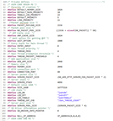

Afterwards, private variables must be created to set data structures essential for ThreadX, NetXDuo byte pools, and the FileX data structures.
/* Define Threadx global data structures. */
TX_THREAD AppServerThread;
TX_THREAD LedThread;
TX_THREAD AppLinkThread;
/* Led toggling thread entry */
void LedThread_Entry(ULONG thread_input);
/* Define NetX global data structures. */
NX_PACKET_POOL WebServerPool;
ULONG IpAddress;
ULONG NetMask;
ULONG free_bytes;
NX_WEB_HTTP_SERVER HTTPServer;
/* Set nx_server_pool start address */
#if defined ( __ICCARM__ ) /* IAR Compiler */
#pragma location = ".NxServerPoolSection"
#elif defined ( __CC_ARM ) || defined(__ARMCC_VERSION) /* ARM Compiler 5/6 */
__attribute__((section(".NxServerPoolSection")))
#elif defined ( __GNUC__ ) /* GNU Compiler */
#endif
static uint8_t nx_server_pool[SERVER_POOL_SIZE];
/* Define FileX global data structures. */
/* the server reads the content from the uSD, a FX_MEDIA instance is required */
FX_MEDIA                Flash_Media;
/* Buffer for FileX FX_MEDIA sector cache. this should be 32-Bytes aligned to avoid
   cache maintenance issues */
ALIGN_32BYTES (uint32_t DataBuffer[512]);

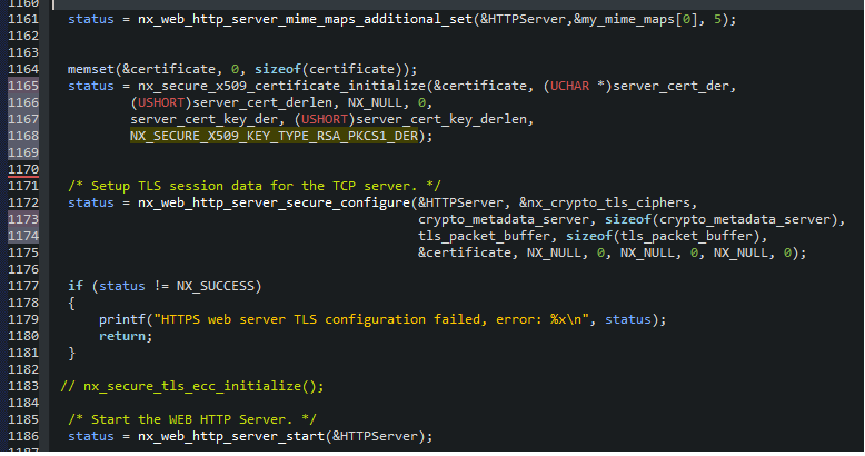

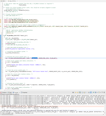

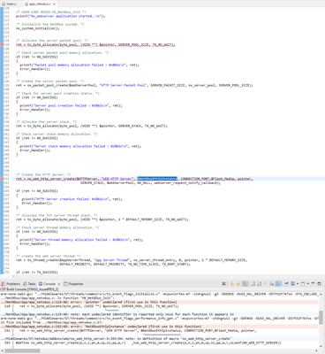

The next portion of code to be modified is USER CODE BEGIN MX_NetXDuo_Init
printf("Nx_Webserver application started..\n");
/* Initialize the NetXDuo system. */
nx_system_initialize();
/* Allocate the server packet pool. */
ret = tx_byte_allocate(byte_pool, (VOID **) &pointer, SERVER_POOL_SIZE, TX_NO_WAIT);
/* Check server packet pool memory allocation. */
if (ret != NX_SUCCESS)
	printf("Packet pool memory allocation failed : 0x%02x\n", ret);
	Error_Handler();
/* Create the server packet pool. */
ret = nx_packet_pool_create(&WebServerPool, "HTTP Server Packet Pool", SERVER_PACKET_SIZE, nx_server_pool, SERVER_POOL_SIZE);
/* Check for server pool creation status. */
	printf("Server pool creation failed : 0x%02x\n", ret);
	Error_Handler();
/* Allocate the server stack. */
ret = tx_byte_allocate(byte_pool, (VOID **) &pointer, SERVER_STACK, TX_NO_WAIT);
/* Check server stack memory allocation. */
	printf("Server stack memory allocation failed : 0x%02x\n", ret);
	Error_Handler();
Here some memory handling takes place: Server packet pool and server stack are allocated, and their allocation is checked. If it fails, a debug message is displayed and the error handler function called. Most threads and functions from now on will have this error checking functionality.
The next step is to allocate memory and create threads for all services going to be used. HTTP server, web server thread, a thread to blink the LED, and a link thread are all created in this portion, also memory allocation for all these services and the TCP server thread.

Web server requests come from the html page or the script under it. The resource string is the request being sent by the web server, such as LedOn. This string is programmed either in the script or the html page itself, this case being the first option.
Figure 19 – Script showcaseFigure 19 – Script showcase
This figure shows the script for the LED toggle slider button on the dashboard.html page provided.
Figure 20 – Led Toggle scriptFigure 20 – Led Toggle script
This figure shows the id of the slider element toggling the LED in the web server page. It is possible to implement your own code if you edit the script for new buttons or extra display spaces. This allows you to append ADC data, PWM channel handling, and many other functionalities.

In this header file a few definitions must be added. Mostly setting thread priorities, a small IPv4 printing macro, and some memory pool size configurations.
/* USER CODE BEGIN EM */
#define PRINT_IP_ADDRESS(addr) do { \
                                    printf("%s: %lu.%lu.%lu.%lu \n", #addr, \
                                    (addr >> 24) & 0xff, \
                                    (addr >> 16) & 0xff, \
                                    (addr >>  & 0xff, \
                                     addr& 0xff);\
                                  }while(0)
/* USER CODE END EM */
/* USER CODE BEGIN EFP */
#define NX_APP_INSTANCE_PRIORITY             5
/* USER CODE END EFP */
/* USER CODE BEGIN PD */
/* Pirority IP creation */
#define DEFAULT_MEMORY_SIZE              1024
#define DEFAULT_MAIN_PRIORITY            10
#define TOGGLE_LED_PRIORITY              15
#define DEFAULT_PRIORITY                 5
#define LINK_PRIORITY                    11
 /*Packet payload size */
#define PACKET_PAYLOAD_SIZE              1536
/* Packet pool size */
#define NX_PACKET_POOL_SIZE              ((1536 + sizeof(NX_PACKET)) * 50)
 /* APP Cache size  */
#define ARP_CACHE_SIZE                   1024
 /* Wait option for getting @IP */
#define WAIT_OPTION                      1000
/* Entry input for Main thread */
#define ENTRY_INPUT                      0
/* Main Thread priority */
#define THREAD_PRIO                      4
/* Main Thread preemption threshold */
#define THREAD_PREEMPT_THRESHOLD         4
/* Web application size */
#define WEB_APP_SIZE                     2048
/* Memory size */
#define MEMORY_SIZE                      2048
/* HTTP connection port */
#define CONNECTION_PORT                  80
/* Server packet size */
#define SERVER_PACKET_SIZE               (NX_WEB_HTTP_SERVER_MIN_PACKET_SIZE * 2)
/* Server stack */
#define SERVER_STACK                     4096
/* Server pool size */
#define SERVER_POOL_SIZE                 (SERVER_PACKET_SIZE * 4)
/* SD Driver information pointer */
#define SD_DRIVER_INFO_POINTER           0
#define NULL_IP_ADDRESS                  IP_ADDRESS(0,0,0,0)
#define NX_APP_CABLE_CONNECTION_CHECK_PERIOD  (6 * NX_IP_PERIODIC_RATE)
/* USER CODE END PD */
1.2.6 STM32H753ZITX_FLASH.ld
The last file to be modified is the flash linker descriptor. Before doing that, it's necessary to check the name of the descriptor sections generated by the STM32CubeMX. The STM32CubeMX versions before the v6.13.0 generates the section names with typos (RxDecripSection instead of RxDescripSection, the same for the Tx) that were already corrected in the new releases (equal or higher than v6.13.0) of the STM32CubeMX. Therefore, it's necessary to verify the correct sections names to proper locate the variables into the memories. The correct names are presented in the main.c file.
STM32CubeMX versions before v6.13.0:
Figure 21 - Main.c file with the older version of STM32CubeMXFigure 21 - Main.c file with the older version of STM32CubeMX
STM32CubeMX versions from v6.13.0 onwards:
Figure 22 - Main.c file with the new version of the STM32CubeMXFigure 22 - Main.c file with the new version of the STM32CubeMX
After checking the sections names, paste the following code in linker file at line 165, this code is responsible for creating a few memory locations to hold both descriptors and memory pool sections.

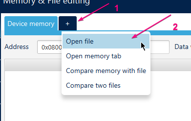

After the code is done building it must be downloaded into the microcontroller, as well as the web content binary file containing the web pages and all its assets. They can be downloaded in any order, but to make things easier it is recommended to first download the web content.
To download a binary to a specific address of the microcontroller, the STM32CubeProgrammer software must be used. After launching the software, press the ‘+’ tab besides ‘Device memory’ to open a file:
Figure 21 – File download on STM32 Cube ProgFigure 21 – File download on STM32 Cube Prog
Search for the web content binary file and open it. Connect the Nucleo board to the computer and press the green connect button on the top right corner. Afterwards, connecting the target information should be displayed on the bottom right corner and a "connected" text on the top right corner.
After making sure that the board is correctly connected, right-click the blue download button (2) and change the address to the one configured as the LevelX nor driver, 0x08100000 (3). After this, press enter, and the binary file will be downloaded to this address.
Figure 22 – File location addressFigure 22 – File location address

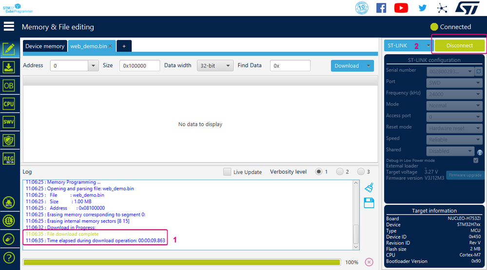

Once the download is successful disconnect the board and move back to STM32CubeIDE.
Figure 23 – File download confirmationFigure 23 – File download confirmation

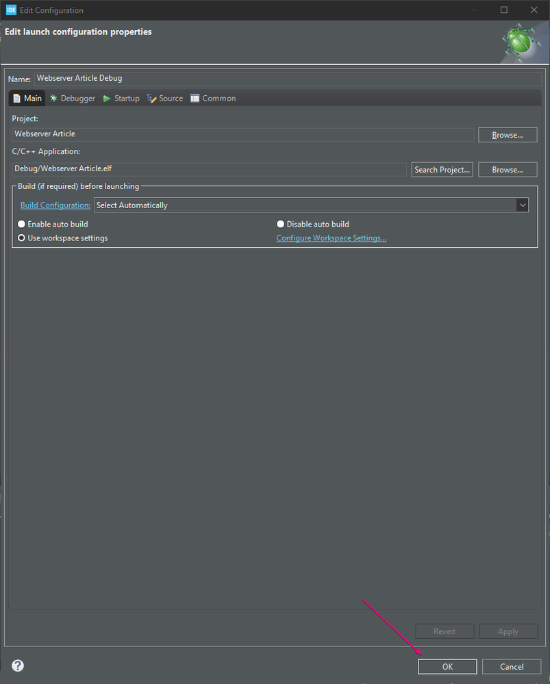

To download the code, there are two options: run mode and debug mode. Debug is preferred for the first launch since it makes error checking easier, thus it is going to be the method demonstrated here.

A pop-up appears to configure the debug session, as the default settings are recommended, simply press ok on the bottom right corner.
Figure 25 – Debug configuration tabFigure 25 – Debug configuration tab

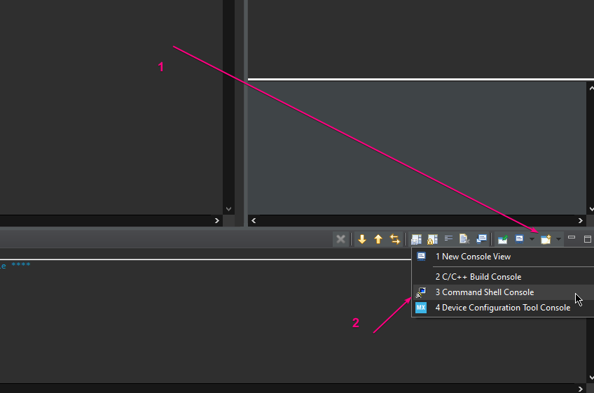

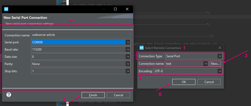

To configure the terminal, left click the console options on the bottom right corner and select command shell console.
Figure 26 – Console openingFigure 26 – Console opening
A setup pop-up appears, the connection type must be set to serial port, encoding to UTF-8, and press the new button to set up the serial port settings. Choose your USART3 configuration and press finish then ok.
Figure 27 – Com port configurationFigure 27 – Com port configuration

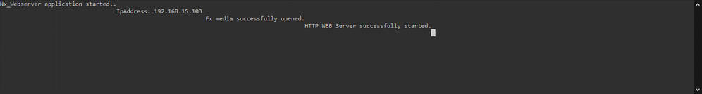

Make sure to connect the board using an RJ45 cable to a router or switch, then allow the code to run by pressing the resume button or the F8 shortcut.
Figure 28 – Resume iconFigure 28 – Resume icon
On the terminal the following messages should be displayed if all steps were done correctly, the IP address varying based on your network’s addressing and architecture.
Figure 29 – Application console outputFigure 29 – Application console output
Make sure that the computer is connected to the same network as the board is, be it via wireless connection or wired. Type the IP address into a browser, followed by either one of the three html pages present in the provided binary file: /about.html; /index.html; or /dashboard.html. The latter providing performance data collected from ThreadX and NetXDuo, and a toggle switch to toggle the board’s green LED blink.
Figure 30 – Dashboard.html webpageFigure 30 – Dashboard.html webpage

Although image creator seems to be working, output image does not work properly. My attempt: create image from web content files from example Nx_WebServer for STM32F429ZI. Output image differs from web_content.bin included in the example. After writing new image to the flash at 0x08100000 and reboot server starts properly and properly opens Fx media (info from debug via uart). But, I am unable to open index.html or dashboard.html, I get information saying that file (index.html or dasboard.html) could not be found on the server. But, flashing original web_content.bin included in the example brings everything back.
In the example, in .ioc file LevelX settings seem to be the same (NOR Flash Size: 1024*1024, Sectors per block: 2, NOR Flash Simulator Sector Size: 512) as parameters passed to FxImageCreator (-S 1048576 -s 512 -b 1024).

The block size mentioned in the readme file is related to a NOR Flash standalone device. However, this parameter should be modified to match the physical block size of the Flash memory that you are using.
The Linux compatible implementation should be coming shortly.

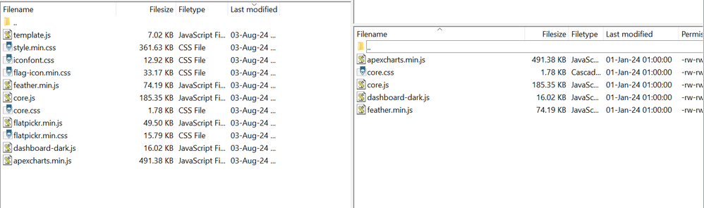

I tested your FxImageCreator, I finally got it to work in my use case, however it only works partially (there are only around half of the expected files in the output binary)
A simple description of my program and use case: I have a custom board (minimalistic STM32H743VIH board with basically only USB FS. There is an USB-X Device RNDIS and NetX HTTP server. On top of it, there is a FTP server. I only need a read-only FileX filesystem to hold the website assets so I decided to go for a sideloaded binary and using the LevelX NOR Simulator with pointer to 0x08060000.
This works, it mounts the filesystem prepared by your tool properly, I can even check via Filezilla FTP client. However my "resources" folder which contains some javascripts and CSS style files does not unfortunately contain all the files. Your tool showed no error (see the output).
I triple checked, there should be enough space in the 1664kB (1703936 Bytes) filesystem (total included files size = 1383902 Bytes)
Is it not enough space for the output binary? Or other issue / bug in the FileX binary builder tool?
Can you please try yourself?
This is the output:
..\FxImageCreator.exe -S 1703936 -s 1024 -b 2048-r . -o ..\output.bin
===============> Configuration <===============
Image Size :1703936
FileX Sector Size :1024
Physical block size :2048
Root directory :.
Output file :..\output.bin
Bin image ' ..\output.bin' ready!
See the picture - left panel shows expected files, right panel is the actual STM32's sideloaded binary content
Ad.: FileX sideloaded binary prepared using DOS FAT12/FAT16 (formatted in Windows 10, using a virtual ImDisk drive mounted to a .bin file) does not work at all - FileX can't read such a filesystem. It might be by design, but it is a bit unfortunate given the fact the old FatFS implementation could read these Filesystems just fine
Looking forward to hear any helpful advice.
Martin

Hello @MatasOn222
To help you with this issue, can you pleas open an online support ticket on this page https://ols.st.com/s/.
You can then post a link to it in here and i'll be able to help you with the files.
Best Regards,
Lucas

I am trying to follow along using the NUCLEO-H743ZI. It appears to me that the memory addresses should be the same as posted here for the NUCLEO-H753ZI, and I have followed all other instructions. However, every time I try to run it gets stuck on "Looking for the DHCP Server." In my debugging it appears that it is just stuck waiting for the semaphore to be unlocked. I am very new to these middlewares as I have only spent time with LWIP ethernet protocols. I used Wireshark and can see that the entire DHCP process goes through and the router acks the Nucleo's IP request. I can also ping the Nucleo using the IP address found from the DHCP request.
Not sure if this is too relevant but many times on startup the print output also will show "Network cable not connected.. Network Cable Connected" Even though the cable is always connected and the link light stays active.
EDIT: When trying to connect to server via browser using the IP address discovered in Wireshark the packets:
SYN -> RST, ACK [repeat 3 times]
TCP Port Numbers reused -> RST,ACK [repeat many times]
Thank you.

Hey @EthanMankins,
The STMH743 and STM32H753 microcontrollers are extremely similar. They only differ on Crypto hardware acceleration, which is not used in this article, meaning everything else is exactly the same so you shouldn't worry about this. You could even load an H753 firmware into an H743 and if no hardware crypto is used, everything works perfectly :)
If you followed all instructions in this article precisely, it should work without problems, so i am more inclined to believe this is some sort of hardware issue, specially because of the "Network cable not connected.. Network Cable Connected" you reported. Make sure you have the most up to date x-cube AZRTOS H7 package, together with the recent CubeMX and your preferred IDE releases. On top of that, have you made any modifications to this nucleo board ?
A good way to isolate between a hardware or software issue is to try and run one of our examples. My suggestion is this LwIP example: STM32CubeH7/Projects/NUCLEO-H743ZI/Applications/LwIP/LwIP_HTTP_Server_Netconn_RTOS at master · STMicroelectronics/STM32CubeH7 · GitHub just make sure you follow the readme instructions and enable the DHCP client functionalities.
Please let me know of the results on your tests.
Best Regards,
Lucas

this post is incredibly detailed and offers the opportunity to those like me who are trying to use the ThreadX operating system with ethernet features for the first time.
I am following the tutorial step by step but I got stuck when you have to change the nx_app_thread_entry function().
This function is not present in the app_netxduo.c file.
I am using a STM32F767ZI board and, during the setup via the graphical interface (the .ioc file) I was unable to set these parameters because they were missing:
LevelX: NOR Simulator Driver
NetXDuo - AzureRTOS Application Configuration: NetXDuo Pool Size in number of P...
NetXduo - AzureRTOS Application Configuration: NetXDuo IP Instance Thread Size
ThreadX Configuration: TX THREAD ENABLE PERFORMANCE INFO.
I post some screenshots for theese missing configuration parameters of the .ioc file.
I hope you can help me.
Kind regards,
Gabriele.

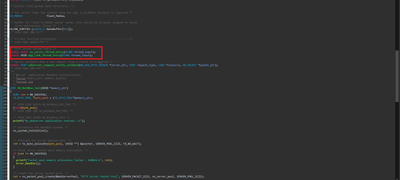

UserGabriele
Associate II
Hello @Lucas_Costa ,
I set up the project from .ioc file as described in the example for cortex F7 for the parts related to ThreadX, NetXDuo, etc. while I followed the example for cortex F4 to set up the part related to LevelX and FileX.
Unfortunately, I got stuck on the code.
All the examples show a lot of code that I can't understand if I have to modify to readapt to my project or if they should be left as they are.
I also noticed that when compiling the project returns 4 errors related to variables/pointers not declared in the app_netxduo.c file.
As for the app_nextduo.h file I noticed that the code creates a constant WEB_APP_SIZE to which it assigns a value of 2048 (I assume bytes). What does this constant mean? Is it the size of the files (html, css, js)?
I saw that on the example projects a web page in .bin format is loaded into memory, how can I get that binary file starting from the 3 original files (html, css, js)?
thanks.
Best regards.
Lucas_Costa
Hey @UserGabriele ,
For the coding part, most of it is done inside the app_netxduo.c file really. The only parts you need to actually write are the ones inside USER CODE sections. For instance, both the pointer and IpInstance handlers are created in the USER CODE PRIVATE VARIABLES section.
You don't seem to have created those handlers in your code, or they have different names.
Regarding the define you mentioned, I am not entirely sure of what it's role is, since it only appears once in the entire project and if taken out, the application still works correctly.
The size of the web page files interfere only on the file system portion of this application, so for the example we are talking, they cannot take more than 1MB of data.
The binary I used was generated by a software described in the 4th paragraph of this articles introduction. It is called FxImageCreator and it is also attached to the article.
Best Regards,
Lucas

thank you for your good explanations, I was able to start my web server according to these explanations, but I had a problem to convert it to HTTPS according to these examples(https://github.com/eclipse-threadx/rtos-docs/blob/main/rtos-docs/netx-duo/netx-duo-web-http/chapter2.md),
and this error is shown on my browser page : (firefox)Error code: SSL_ERROR_NO_CYPHER_OVERLAP
and in (chrome):ERR_SSL_VERSION_OR_CIPHER_MISMATCH
I would be very grateful if you could help me in this matter
this is the part of my code
thankyou,
Best Regards,
Lucas_Costa

Hey @alisey
I analyzed the NetX documentation further and noticed that there's a few extra steps to enable secure connections. If you could please enter an OLS ticket in this link https://ols.st.com/s/, we could exchange more information in private such as your code and more details on your application. If you enter the ticket, please mention my name so it is directed to me 'Lucas Costa'.
Looking forward to hearing from you so we can work together on this issue.
Best Regards,
Lucas

In file included from ../Middlewares/ST/levelx/common/drivers/lx_stm32_nor_simulator_driver.c:13:

Domini
For anyone interested in running this demo in the most recent version of STM32CUBEIDE and STM32CUBEMX, some modifications may be necessary:
The Ethernet Descriptor changed names from RxDecripSection to RxDescripSection and from TxDecripSection to TxDescripSection. Therefore, a modification in the Linker Script is necessary:
.tcp_sec 0x24030000 (NOLOAD) : {
. = ABSOLUTE(0x24030000);
*(.RxDescripSection)
. = ABSOLUTE(0x24030060);
*(.TxDescripSection)
} >RAM_D1 AT> FLASH

Trouble 2:
An example of parameters that works differently is the NOR Simulator Driver :
In this case, I am not able to indicate the FLASH base address (0x08000000 or 0x08100000) into NOR Simulator Base Address, to link the binary file stored in the FLASH memory and get stuck with SRAM base addresses. While the binary file of the web content is about 1Mb, I cannot link this file to LEVELX middleware as asked in the tutorial. The STM32H563 has 640kb of SRAM and 2Mb of FLASH.
Thank you in advance for your answer and don't hesitate to ask more informations, if my explanation misses some.

jfresneda
Associate
As the previous comment im also unable to make this kind of configuration with the ethernet and threadx/netduox work. I presume something changed with the latest release of STM32Cube >FW_H7 V1.12.0 as with previous V1.11.0 where the RX buffers address was not an option i was able to have connection.
Basic functionality of Ping doesn't work but also doesn't enter in any kind of error. I presume the pointers to the memory are off. And I presume it has to do with something that was changed in the code with the new update.
Could ST check this? @B.Montanari @Domini
Domini
Hello @jfresneda and @UnderCaffeinated,
I tested the demo allocating the RX Buffers Address in 0x24030200 and, later in, 0x24030100, the application ran as expected. So long as you leave enough space for the Descriptors the application should work.
Best Regards
