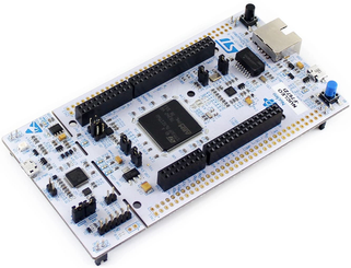

For this tutorial, we use the F767 Nucleo board, which has a USB connector to open two CDC (Communications Device Class) class through the USB communication. The CDC is used to open a virtual COM port communication. This board has an STM32F767 microcontroller, and for further details about the board, refer to its user manual. The steps shown here can be easily adapted to any other STM32. The IAR IDE, the STM32CubeF7 were used to build this tutorial.

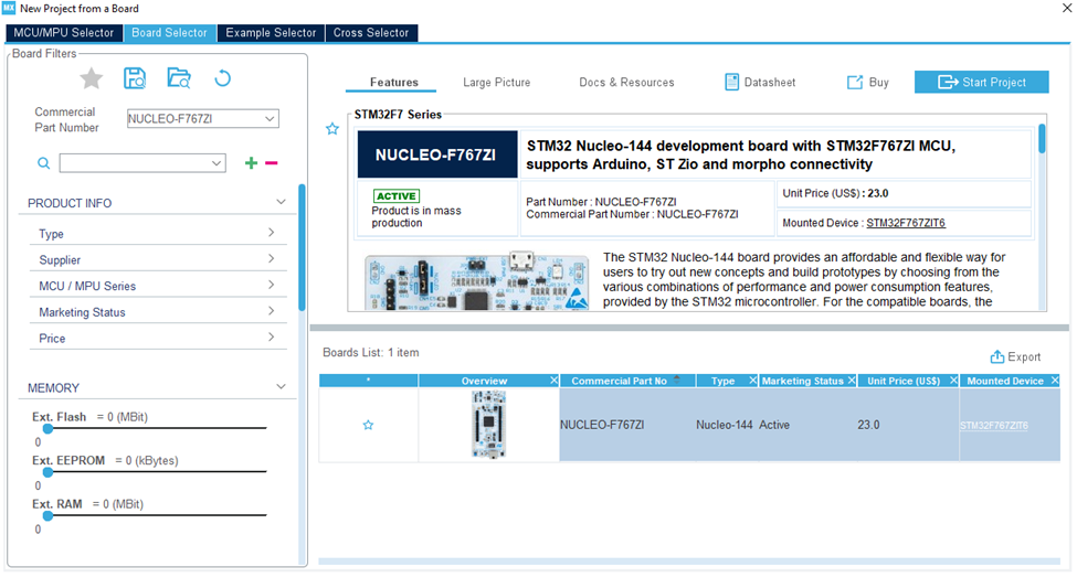

Start by creating a new project using the STM32CubeIDE by clicking [File -> New -> STM32 Project]. Use the [Board Selector] tab and select the [NUCLEO-F767]

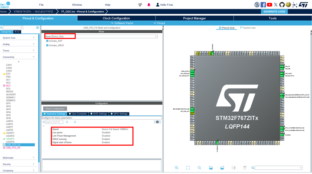

Once the project creation is done, enable the USB peripheral [USB_OTG_FS] peripheral in Device Only mode, located in the [Connectivity] section.

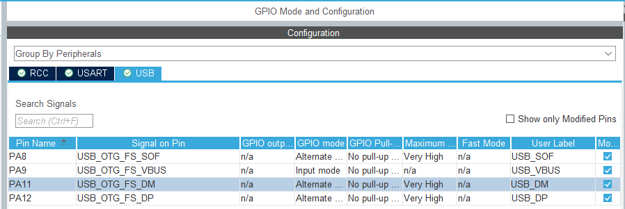

FBL_4-1723457519262.pngAdd naming of the GPIO pins as shown in the image below:

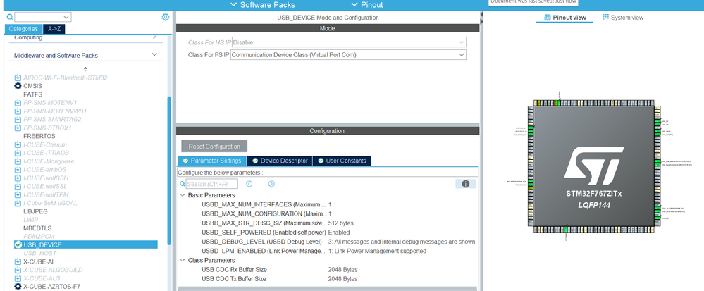

Next, configure the USB device middleware [USB_DEVICE] in CDC class for FS IP mode [Communication Device Class (Virtual Port Com)], located in the [Middleware and Software Packs] section.

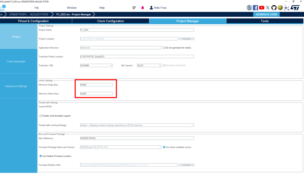

After that, increase the amount of heap and stack size of the project as indicated in the image below, this action is done in the [Project Manager] tab. Then, under [Code Generator], copy all used libraries into the project folder.

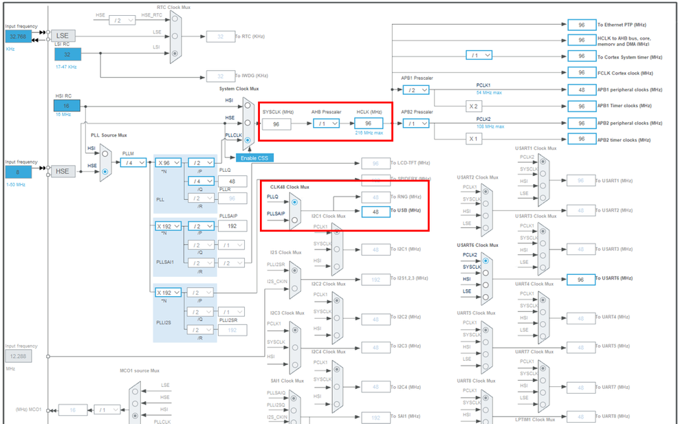

The last step before generating the code is to update the system clock frequency, the USB peripheral is fed with a 48MHz clock frequency.

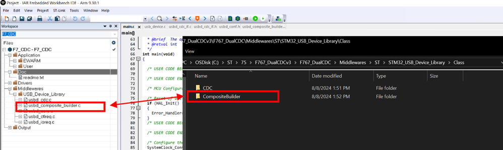

Copy manually files and folders of the composite builder class from STM32Cube\Repository\STM32Cube_FW_F7_V1.17.2\Middlewares\ST\STM32_USB_Device_Library\Class\CompositeBuilder to the folder of your project:  YourProjectName\Middlewares\ST\STM32_USB_Device_Library\Class\CompositeBuilder.
To select both source files, you can add the file in the project tree under Middleware, then add the header file path to the project.
After doing that, we add the header file under project [Options->C/C++ Compiler->Preprocessor->Additional Include directories]
Next step, to facilitate the use of this article, you can simply replace the existent USB_DEVICE folder including App and Target with the one in attached project.

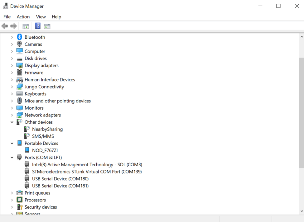

After flashing the code, connect a USB micro cable into the user USB connector and connect it to a computer. Doing that, a USB composite device must be enumerated with two CDC interfaces. Open the device manager to observe the serial port being enumerated.
