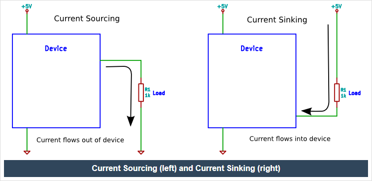

@B.Montanari wrote:
In microcontrollers, "sink current" refers to the ability of a pin to absorb current when it is connected to a lower potential (typically ground) in an electrical circuit.
Not just in microcontrollers - this is a very general term throughout electronics.
A picture is worth a thousand words:
https://startingelectronics.org/articles/current-sourcing-sinking/
