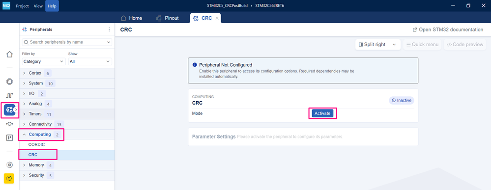

3.2 Enable and configure the CRC peripheral

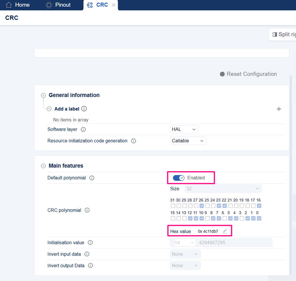

  • Go to "Peripherals" and [Activate] CRC under "Computing" → "CRC".
  • In the CRC configuration: Keep the default polynomial and initial value unless your project requires a custom CRC.
    • The typical default CRC on many STM32 devices is:
      • Polynomial: 0x4c11db7
      • Initial value: 0xFFFFFFFF = (4294967295)10

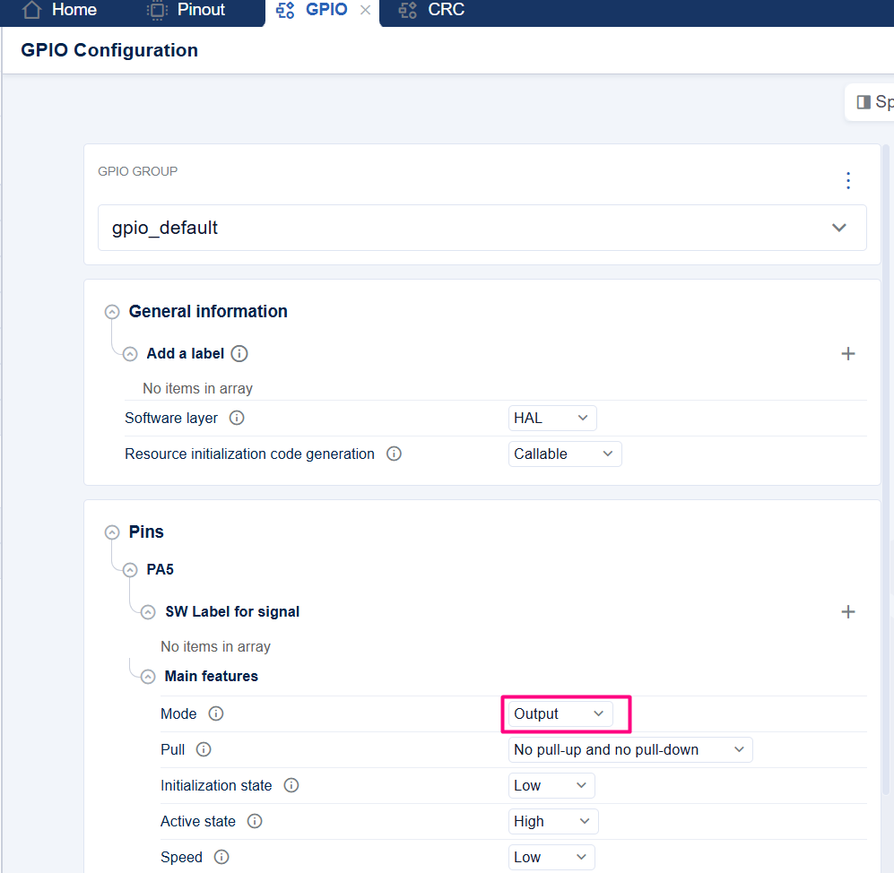

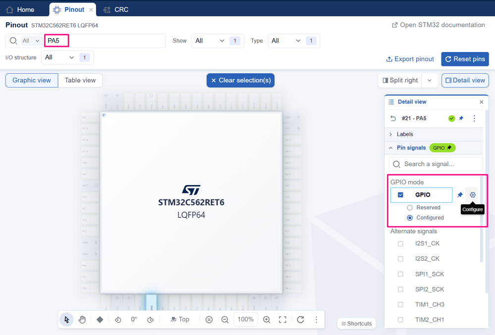

  • Configure PA5 (User LED) as GPIO Output
    • In the "Pinout" tab, select [Table View], and locate PA5.
    • Change "GPIO mode" to [Configured] and configure.
  • In "Pins" → "PA5" → "Main features"l change the "Mode" to [Output]

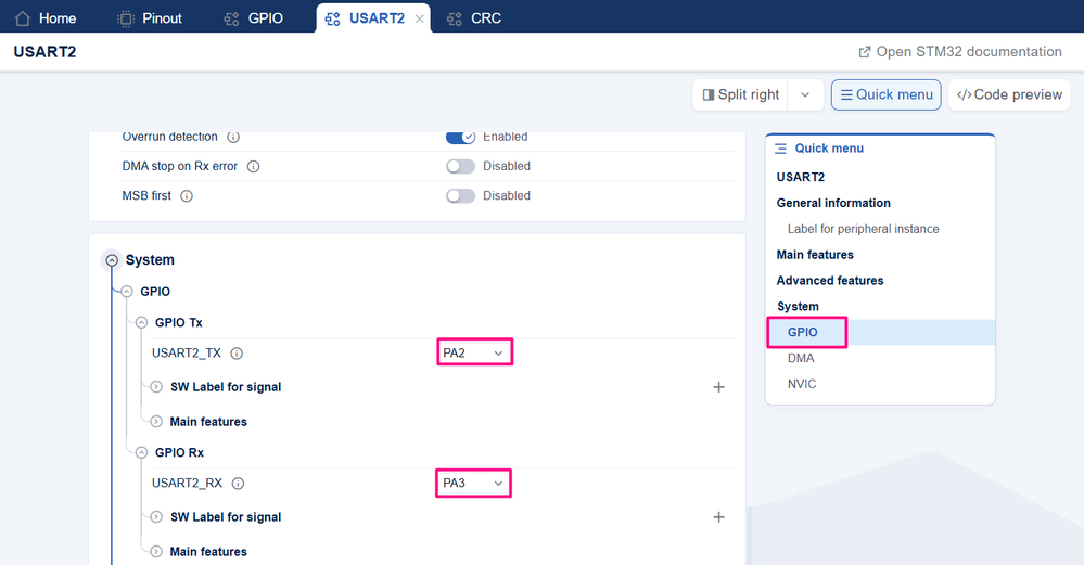

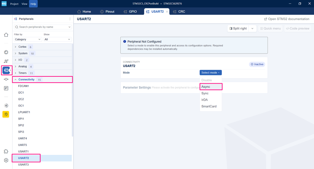

  • Configure USART Connected To STLINK VCP

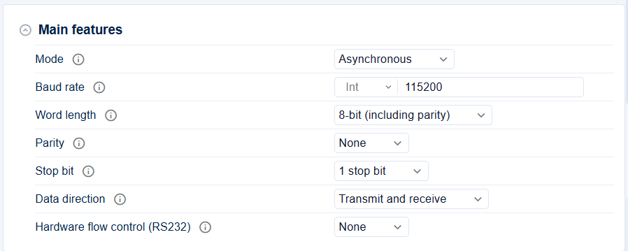

    • Go to "Peripherals" → "Connectivity": Enable [USART2] in [Asynchronous] mode.
  • Configure USART2 parameters (default).
  • Change the pins used to [PA2] and [PA3].

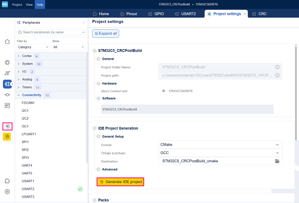

  • Generate project sources for CMake and GCC if you plan to use the STM32 VS Code extension.

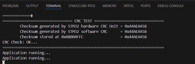

    /* 2 - Print the calculated checksum */
    printf("\tChecksum generated by STM32 hardware CRC Unit = 0x%08X\n\r", (unsigned int)u32CRCValueHw);
    printf("\tChecksum generated by STM32 software CRC      = 0x%08X\n\r", (unsigned int)u32CRCValueSoft);
    /* 3 - Print the stored CRC */
    printf("\tChecksum stored at 0x%08X                 = 0x%08X\n\r", (unsigned int)STD_CRC_ADDR, *(unsigned int *)STD_CRC_ADDR);
    /* 4 - Check if the calculated CRC is equal the stored value */

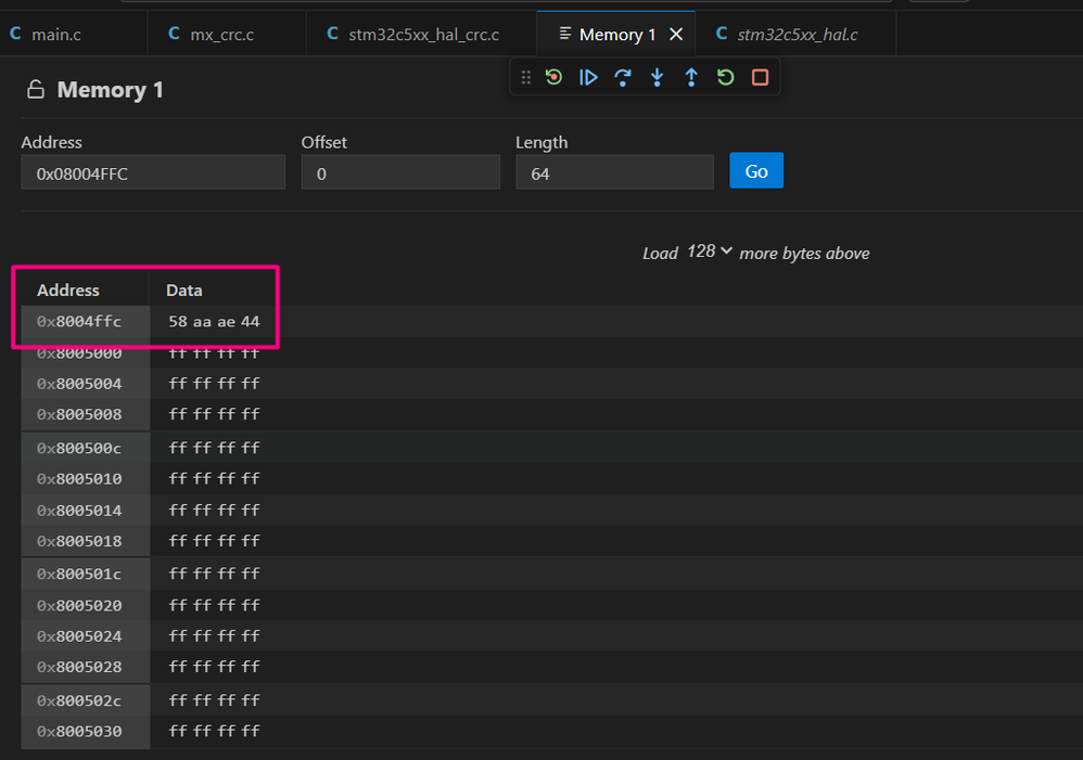

    if(u32CRCValueHw == *(uint32_t *)STD_CRC_ADDR)
      printf("CRC Check: OK...\n\r");
      printf("==========================================================================\n\r");

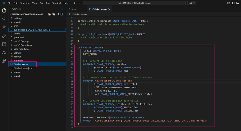

5.1 CMake post-build logic
Add the following code in the final of your main CMakeLists.txt:
add_custom_command(
    TARGET ${CMAKE_PROJECT_NAME}
    POST_BUILD
    # 1) Convert ELF to Intel HEX
    COMMAND ${CMAKE_OBJCOPY} -O ihex
            $<TARGET_FILE:${CMAKE_PROJECT_NAME}>
            ${CMAKE_PROJECT_NAME}.hex
    # 2) Compute STM32 CRC and inject it into a new HEX
    COMMAND "C:/srecord/bin/srec_cat.exe"
            ${CMAKE_PROJECT_NAME}.hex -Intel
            -fill 0xFF 0x08000000 0x08004FFC
            -STM32 0x08004FFC
            -o ${CMAKE_PROJECT_NAME}_SRECORD.hex -Intel
    # 3) Convert CRC-injected HEX back to ELF
    COMMAND ${CMAKE_OBJCOPY} -I ihex -O elf32-littlearm
            ${CMAKE_PROJECT_NAME}_SRECORD.elf
    WORKING_DIRECTORY ${CMAKE_CURRENT_BINARY_DIR}
    COMMENT "Generating HEX and ${CMAKE_PROJECT_NAME}_SRECORD.hex with STM32 CRC at end of flash"
This sequence:
  • Converts ${CMAKE_PROJECT_NAME}.elf to ${CMAKE_PROJECT_NAME}.hex
  • Uses srec_cat.exe (default installation path) with:
    • -fill 0xFF 0x08000000 0x08004FFC to fill gaps with 0xFF.
    • -STM32 0x08004FFC to compute a CRC over [0x08000000, 0x08004FFC] and store it at 0x08004FFC.
    • Writes ${CMAKE_PROJECT_NAME}_SRECORD.hex as the CRC-injected HEX.
  • Converts the CRC-injected HEX back into ${CMAKE_PROJECT_NAME}_SRECORD.elf.
These addresses and range exactly match what main.c uses:
  • Data region: [0x08000000 .. 0x08004FFB].
  • CRC word: 0x08004FFC.

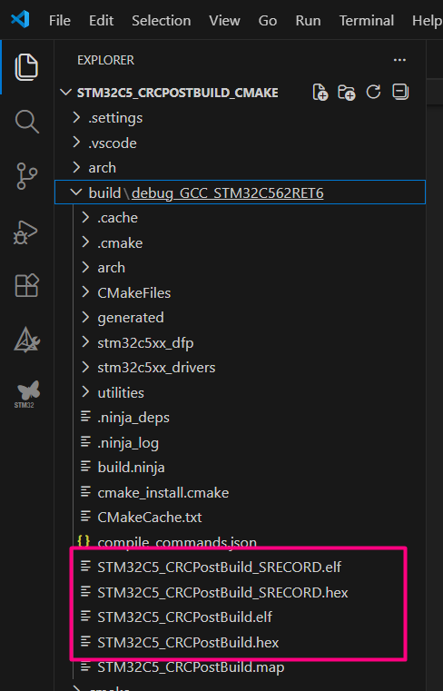

After each build, you have:
  • ${CMAKE_PROJECT_NAME}.elf – original ELF.
  • ${CMAKE_PROJECT_NAME}_SRECORD.hex – HEX with CRC inserted.
  • ${CMAKE_PROJECT_NAME}_SRECORD.elf – ELF version of the CRC-injected image.

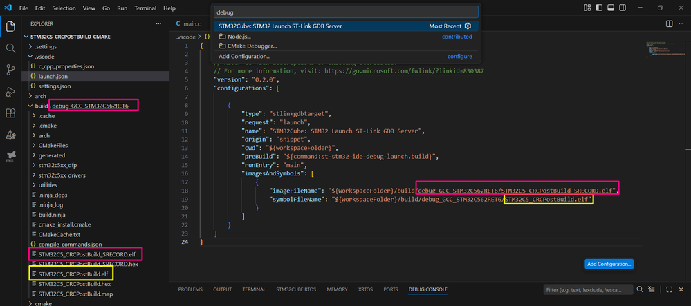

5.2 Programming and debugging the CRC-augmented image in VS Code
With the STM32 VS Code extension and your launch.json, the same debug configuration takes care of:
  • Programming the CRC-injected image, and
  • Using the original ELF for symbols.
launch.json:
Note: Make sure to adjust the *.elf name and path based on your own project.
    "version": "0.2.0",
    "configurations": [
            "type": "stlinkgdbtarget",
            "request": "launch",
            "name": "CRC_Debug",
            "origin": "snippet",
            "cwd": "${workspaceFolder}",
            "preBuild": "${command:st-stm32-ide-debug-launch.build}",
            "runEntry": "main",
            "imagesAndSymbols": [
                    "imageFileName": "${workspaceFolder}/build/debug_GCC_NUCLEO-C562RE/NUCLEO-C562RE_CRC_SRECORD.elf",
                    "symbolFileName": "${workspaceFolder}/build/debug_GCC_NUCLEO-C562RE/NUCLEO-C562RE_CRC.elf"
This configuration does the following:
  • preBuild: calls the extension’s build command, which:
    • Builds the project, and runs the CMake post-build step that:
      • Generates NUCLEO-C562RE_CRC.hex.
      • Runs srec_cat to produce NUCLEO-C562RE_CRC_SRECORD.hex.
      • Converts _SRECORD.hex into NUCLEO-C562RE_CRC_SRECORD.elf.
    • imagesAndSymbols[0].imageFileName:
      • NUCLEO-C562RE_CRC_SRECORD.elf is used as the image to program into flash.
      • This ELF encodes the same content as the CRC-patched HEX (CRC at 0x0807FFFC).
    • imagesAndSymbols[0].symbolFileName:
      • NUCLEO-C562RE_CRC.elf is used as the symbol file for debugging.
      • This is the original, unmodified linker output.
The complete programming and debug flow is:
  1. Press Start Debugging with configuration CRC_Debug.
  2. VS Code:
    • Builds the project (via preBuild).
    • Programs the target with NUCLEO-C562RE_CRC_SRECORD.elf (CRC-injected image).
    • Starts GDB using symbols from NUCLEO-C562RE_CRC.elf.
  3. Execution runs to main, and you can debug while the device runs the CRC-augmented image.

  1. Build the project:
    • In VS Code/CMake (GCC) using the CMake: Build command (which also generates the _SRECORD ELF/HEX), or
  2. Program the image that contains the CRC at 0x0807FFFC:
    • For GCC/CMake: use NUCLEO-C562RE_CRC_SRECORD.elf (from VS Code launch). You can monitor the CRC stored via memory view.

  3. Open a serial terminal on the STLINK VCP COM port at 115200 baud rate.
  4. Reset the board or start the debug session so the application runs from main().
If everything is correctly configured, you should see an output similar to:
Where:
  • Hardware and software CRC values are identical.
  • Stored CRC at 0x08004FFC matches the computed values.
  • The application enters the main loop and prints “Application running…” while blinking PA5.
This confirms:
  • The build-time CRC matches the run-time computation.
  • The flash range and storage address used by srec_cat or IAR checksum configuration match BUFFER_SIZE and STD_CRC_ADDR in main.c.
  • CRC peripheral and UART are correctly configured.
