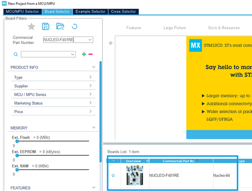

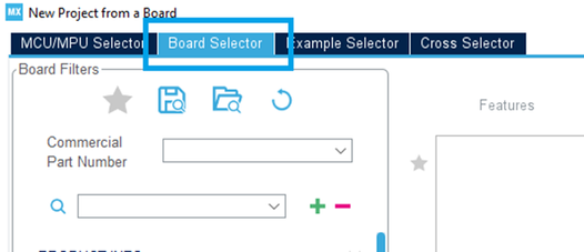

Go to the [Board Selector] tab:
If you know the exact name of the board, for example, in this case: NUCLEO-F401RE, type the name in the [Commercial Part Number] field.
If not in the case of a Nucleo board, simply type a part of the MCU part number. Example in this case: 401 (for STM32F401 microcontroller that features the board).
As shown, two options are provided by the list where the NUCLEO-F401RE board should be selected.
Select it by clicking on it. The board appears at the bottom right of the window as shown in the figure below.

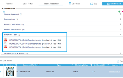

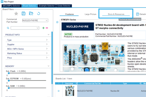

Click on it once. Go to [Docs & Resources] and click on that tab:
Go to [Schematics Pack] and click on that link. The list expands and shows three schematic files.
Each schematic is related to a specific board revision. To know how to find your board revision, refer to section 2. When you identify your boards revision of your board is, click on the corresponding PDF file. The schematics are opened.

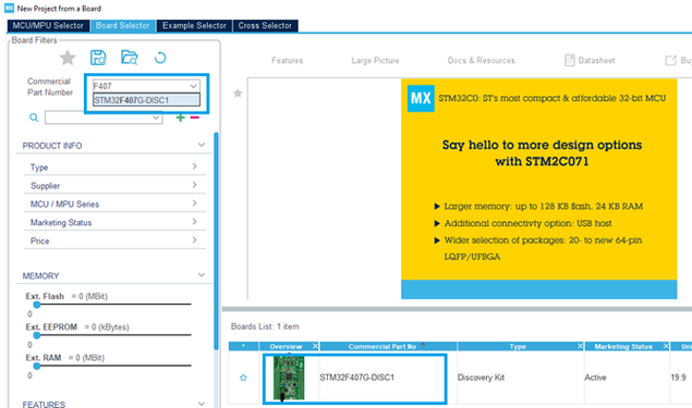

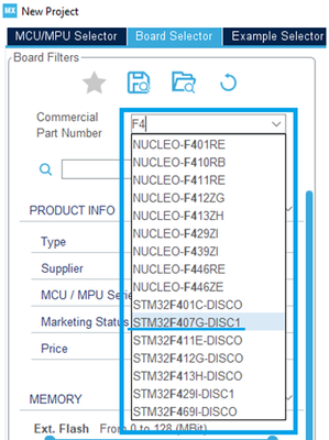

For discovery boards, it is a different approach as the name of the board could not contain the part number of the MCU.Type F4 in the [Commercial Part number] to find the STM32F4DISCOVERY.
As shown in the picture below, there are many options which are provided by the list where STM32F407-DISC1, which is the board we want, is shown:
The board is shown at the bottom right of the window, as seen in the following figure:
Select the board by clicking on it.

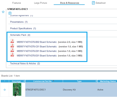

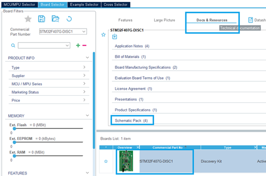

In the top right of the tool, click on the [Docs & Resources] tab and go to the [Schematics Pack] link.
Click the [Schematics Pack] link to show the list. As shown, there are 4 schematics in the list:
Click on the schematics that match the revision of your board. To know how to find your board revision, refer to section 3. When you find what the revision of your board is, click on the corresponding PDF file to open the schematics.

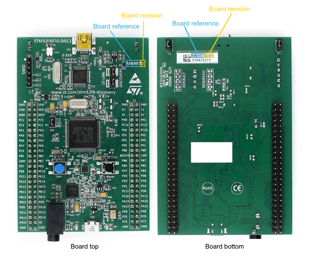

3.1 STM32F4DISCOVERY
The related schematics of the board above with the rev D-01 must have the same revision indicated in schematics title as shown in the figure below:
See section 4. Where to find the schematics from the .pdf file below for more information.

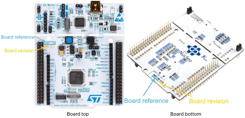

3.2 NUCLEO-F401RE
These schematics are related to NUCLEO-F401RE with revision C04. They are not related to the board shown above with the revision C01
In that case, you need to find a schematic which has that revision. See section 4. Where to find the schematics information from the .pdf file below.

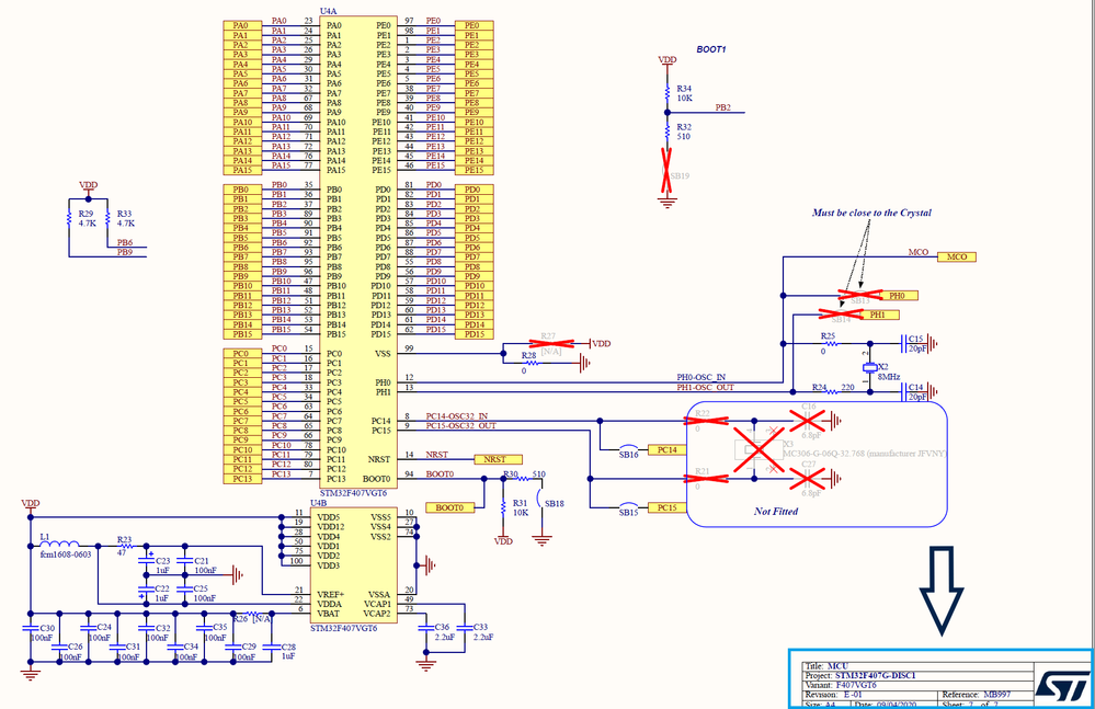

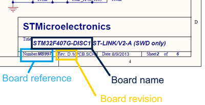

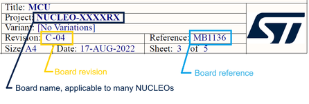

The schematics information is shown in the title in the bottom corner of the .pdf file. See the figure below as an example.
