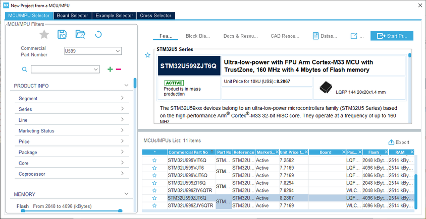

Start the new project for the selected STM32U5 MCU. On the example below, we use the project on STM32U599ZJT6 without TrustZone®.

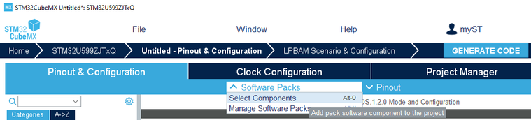

Once the initial configuration is displayed, click [Select Components] under the [Software Packs] menu.

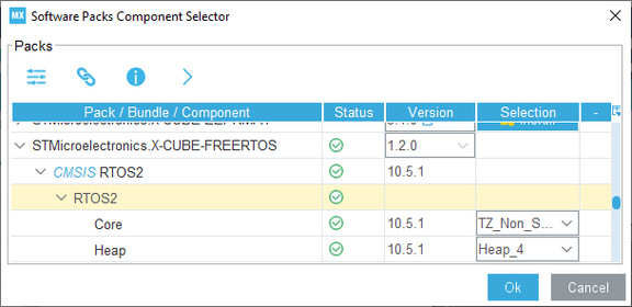

Scroll down the list and select [STMicroelectronics.X-CUBE-FREERTOS]. In case it is not installed or you would need to use a different version, install it first using the [Install] button within the [Selection] column.
The latest version of STM32CubeMX and STM32CubeIDE requires login to the myST account. To do this, select [myST] and log in to your myST account.
2.2. Selecting the FreeRTOS™ version and heap model
After installation of the desired X-CUBE-FREERTOS pack, click the drop-down menu, then click on the drop-down menu [CMSIS RTOS2] and finally [RTOS2]
There are two configuration fields here:
[Core]: Location of FreeRTOS™ within the generated code. In the current implementation, it is a NonSecure application. In this example, there is only one valid option [TZ_Non_Secure].
[Heap]: Memory allocation model, which is used by FreeRTOS™ to manage its components. More information on each of them you can find within our dedicated massive open online course (refer to the "Additional materials" section at the end of this article). In this example, I selected [Heap_4].

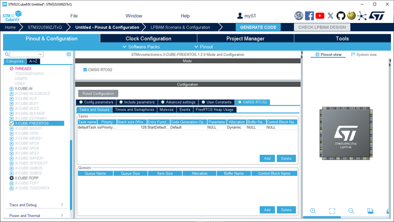

From [Middleware and Software Packages..] select X-CUBE-FREERTOS and enable [CMSIS RTOS2] within the mode window.
After that you should see the complete set of FreeRTOS™ configuration options below.
The [CMSIS_RTOS2] tab contains series of options to enable particular components of the FreeRTOS™.  The rest of the tabs within the [Configuration] window can be used to configure the operating system.
