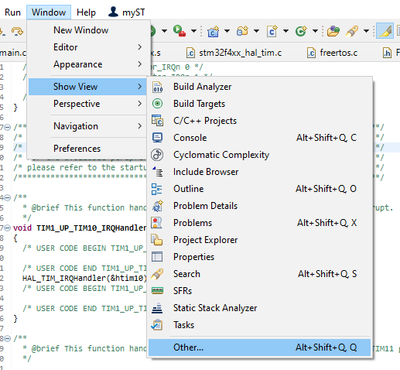

FreeRTOS debug views
From the debugger perspective, you can open the FreeRTOS-related views from the menu. To do so, select the menu command:
Window > Show View > Other > FreeRTOS > FreeRTOS Task List
Alternatively, use “Quick Access”. Search for “FreeRTOS” and select from the views. The FreeRTOS Task List view provides detailed information about all available tasks in the target system. The task list is updated automatically every time the target execution is suspended.

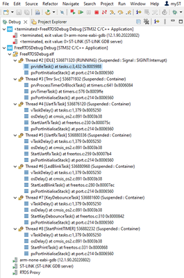

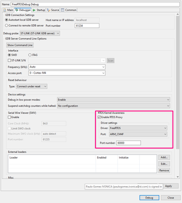

RTOS-kernel-aware debug
The RTOS-kernel-aware debug feature in STM32CubeIDE facilitates support for Microsoft Azure RTOS ThreadX and FreeRTOS™ operating systems, through the use of an RTOS proxy. The STM32CubeIDE includes the RTOS proxy, which can be utilized with an STLINK GDB server, OpenOCD, and Segger J-Link GDB server.
To enable RTOS-kernel-aware debugging, the "debugger" tab in the "Debug Configurations" dialog contains settings to enable and configure the following:
  • RTOS proxy
  • Driver (RTOS ThreadX or FreeRTOS)
  • Port (Cortex® core) and configuration of port number to use with the proxy.
Upon enabling RTOS-kernel-aware debugging and initiating a debug session, all threads are displayed in the debug view. By selecting a thread in the debug view, the current context of the thread is visualized in various views. For example, the variables, registers, and editor views reflect the active stack frame. For example:

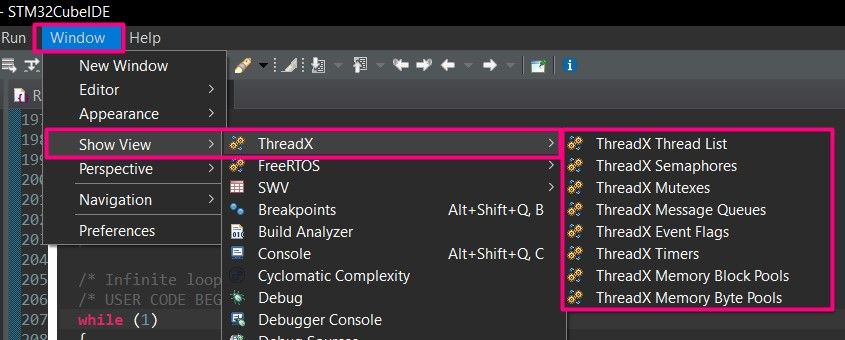

@diverger ,
Yes, you can have a very similar settings for ThreadX, once in debug mode, you can click on [Window][Show View][ThreadX] and select the resources you want to monitor:
ThreadX also allows you to enable TraceX, which is a great way to evaluate the behavior of the RTOS during a certain period of time. That works similar to a log, rather than a regular update during the debug session, but it can be quite helpful. We have two articles talking about it, in case you want to look>

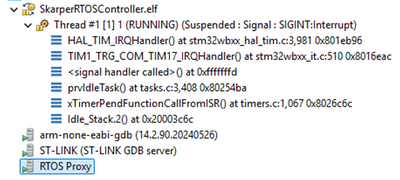

TWood.4
Associate III
This is great. Everything works except the thread view, which only shows one thread. Any tips about how to debug it?
I am using FreeRTOS on a WB55. I have RTOS Proxy enabled and 15 threads running.
