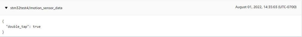

In this case, we want to clearly observe that a double tap event was detected and sent through the MQTT test client. On the topic filter search bar, type in
<name of board given through provision script>/motion_sensor_data
and press subscribe. Once done, physically tap on the board twice with about a half second interval between taps. If all goes well, you should see a message pop up.

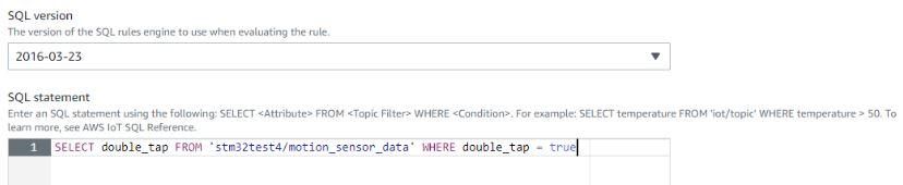

Keep the SQL statement version to 2016-03-23. For the SQL statement itself, write it out as follows:
For context, the SQL statement is looking at the double_tap object in the JSON payload within the motion_sensor_data topic. It only activates the rule if double_tap is true.

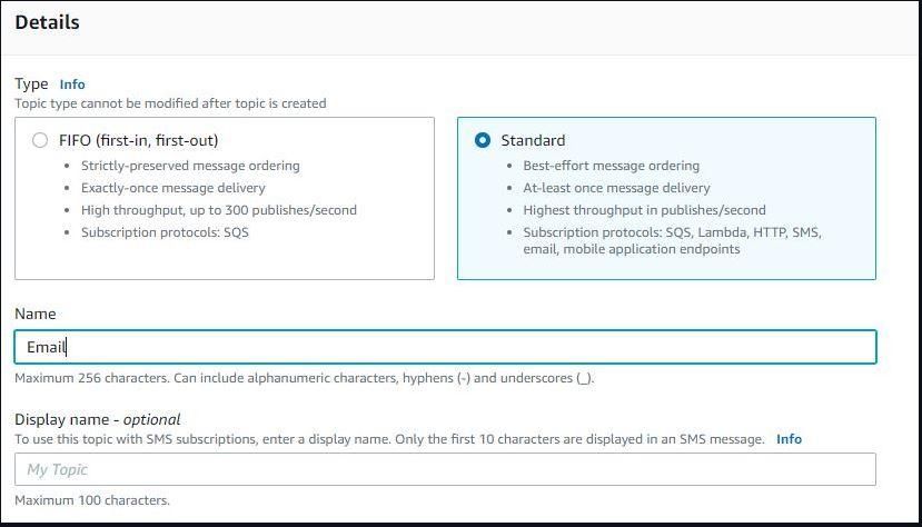

You need to create a new SNS topic. This takes you a new window.
In the new window, set the topic type to standard, give it a name, and create the topic.
