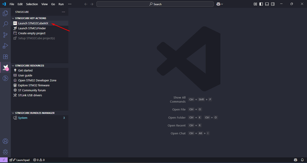

  • Create a new STM32CubeMX project, open VS Code, and click on [Launch STM32CubeMX]:

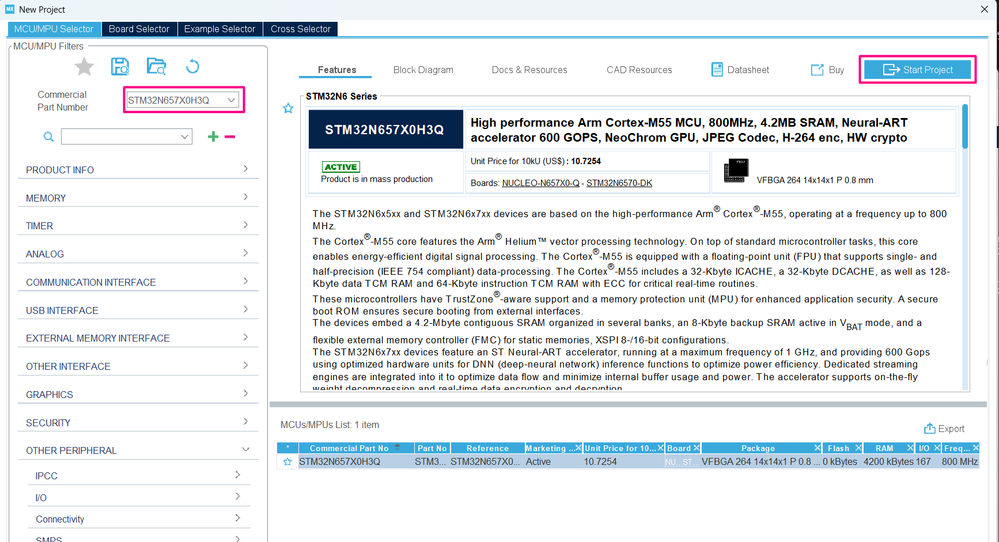

  • Select the [STM32N657X0H3Q]:
  • Select [Secure domain only]:

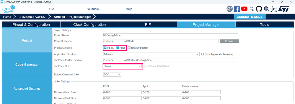

Configure the project to execute code from the external serial NOR flash. If you need assistance with this setup, we have published an article that explains the process in detail. You can find it here: How to execute code from the external serial NOR using the STM32N6.
  • Before the code generation, select the CMake toolchain:

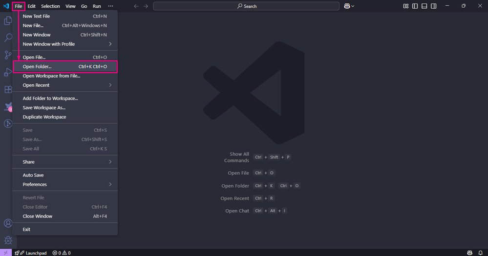

  • In VS Code, import the project folder:

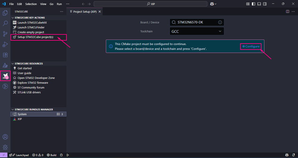

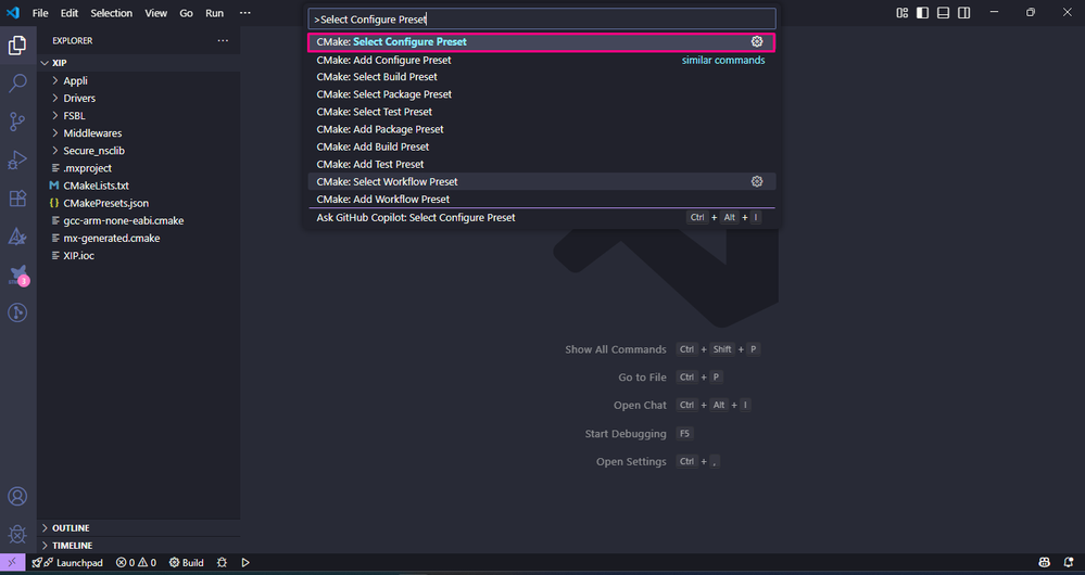

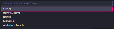

  • Configure the preset [Debug] by pressing Ctrl+Shift+P and type/select [Select Configure Preset] then click on [Debug]:

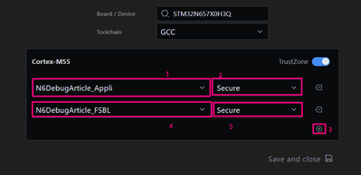

  • Configure CMake discovered Project as STM32Cube Project:
  • Add [PROJECT_NAME_Appli] and [PROJECT_NAME_FSBL] to your environment, save and close:

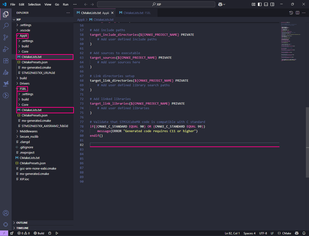

In short, these postbuild commands can be added to the CMakeLists.txt files of [FSBL] and [Appli] projects:
4.1 Edit the FSBL post build

4.2 Edit the Appli post build
Starting from STM32CubeProgrammer version 2.21.0 a new parameter is needed "-align". Please make sure you use the updated command, as follows:

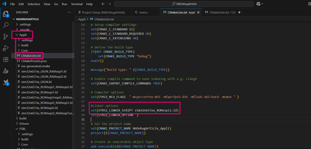

4.3 Linker script for execute in place (XIP)
The default linker script generated by the CMake for the [Appli] project is configured for the selected operation configured in the STM32CubeMX’s EXTMEM_MANAGER, where the selected was XIP. Double check that the linker script used in [Appli] CMakeLists.txt is indeed the correct one:
Note: STM32CubeMX version 6.15 has a minor bug on the linker script creation for CMake that causes a build error on VS Code. I recommend changing the content of said linker script with the equivalent one available in our GitHub here or use the attached on in this article (available at the end of the article.)

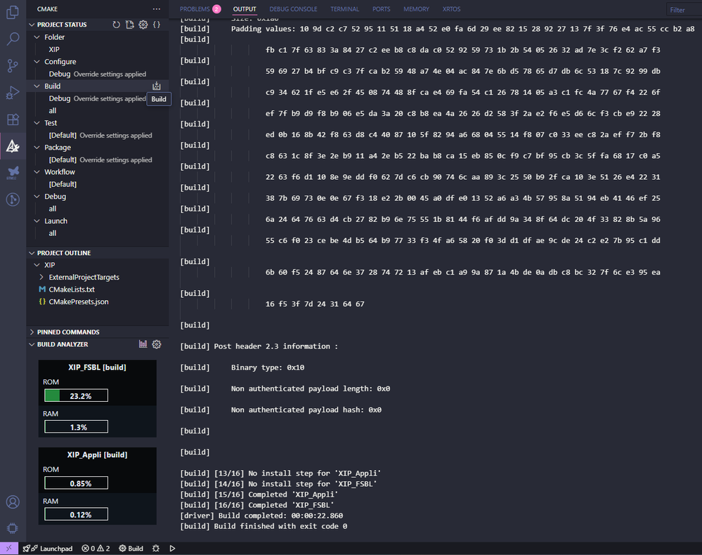

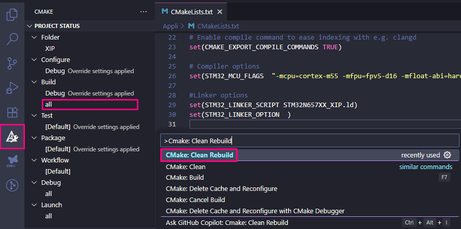

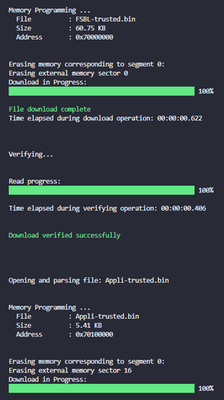

5. Build the project
Now that all steps are configured, it is time to build the application, locate the [CMake] icon on the left, then expand the [PROJECT STATUS] to locate the [Build] [All] to rebuild the projects. Alternatively, press Ctrl+Shift+P and then type/click [CMake: Clean Rebuild] for a clean and rebuild action.
You should see something similar to the following in the Build Analyzer (lower left corner) and Build Output window:

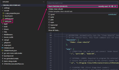

6. Create and modify the launch.json file

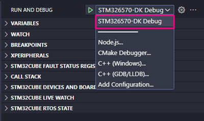

  • Open the [Run and Debug] view (Ctrl+Shift+D.)
  • Click create a launch.json file.

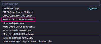

  • Select STM32Cube: STLink GDB Server from the list of debuggers provided by STM32CubeExtension.
  • The extension generates a default launch.json with configurations tailored for STLINK debugging.
Edit the generated launch.json to support debugging with all features enabled:
    "version": "0.2.0",
    "configurations": [
            "type": "stlinkgdbtarget",
            "request": "launch",
            "name": "STM326570-DK Debug",
            "origin": "snippet",
            "cwd": "${workspaceFolder}",
            "preBuild": "${command:st-stm32-ide-debug-launch.build}",
            "runEntry": "BOOT_Application", // Set in BOOT_Application
            "svdPath": "C:/ST/STM32CubeCLT_1.18.0/STMicroelectronics_CMSIS_SVD/STM32N657.svd", // Replace with your .svd path
            "imagesAndSymbols": [
                    "symbolFileName": "${workspaceFolder}/Appli/build/XIP_Appli.elf", // Replace this with your path and your_Appli.elf symbol
                    "imageFileName": "${workspaceFolder}/Appli/build/Appli-trusted.elf",
                    "symbolFileName": "${workspaceFolder}/FSBL/build/XIP_FSBL.elf", // Replace this with your path and your_FSBL.elf symbol
                    "imageFileName": "${workspaceFolder}/FSBL/build/XIP_FSBL.elf", // Replace this with your path and your_FSBL.elf image
            "serverExtLoader": [
                    "loader": "C:/Program Files/STMicroelectronics/STM32Cube/STM32CubeProgrammer/bin/ExternalLoader/MX66UW1G45G_STM32N6570-DK.stldr", // Replace with your external loader path
                    "initialize": false

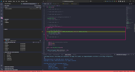

7. Start debugging
  • Connect your STM32 board to your PC using the STLINK debugger.
  • In VS Code, select the debug configuration you created.
  • Press F5 or click the green [Start Debugging] button.

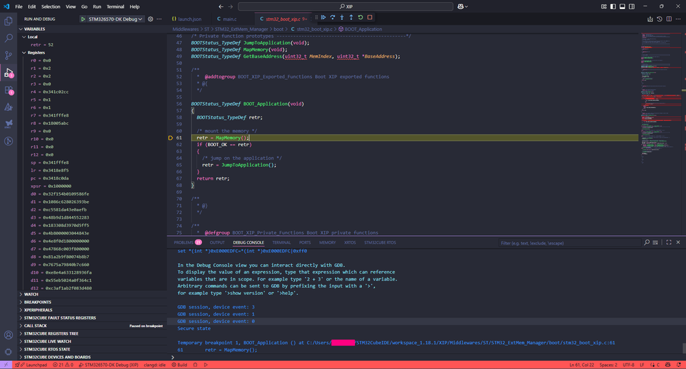

  • The application should halt at the breakpoint set in the BOOT_Application:
The code starts in the FSBL application running from an address within AXISRAM2. After the code stops here, press F5. The green LED should start blinking on the board.
By pausing the code execution, you can confirm that it is running from the external flash by inspecting the function addresses in the call stack. At this stage, all standard debugging features become available, allowing you to:

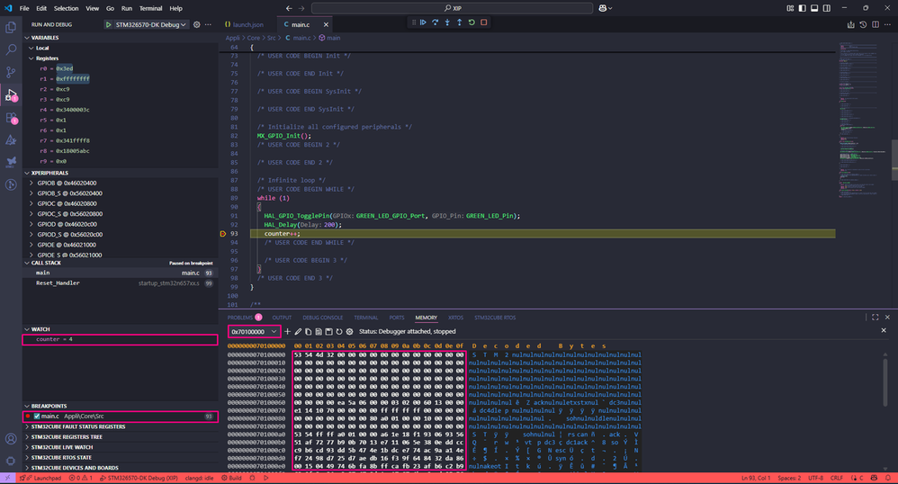

  • Set breakpoints.
  • Step through your program.
  • Inspect variables, registers, and memory.
  • View call stacks.

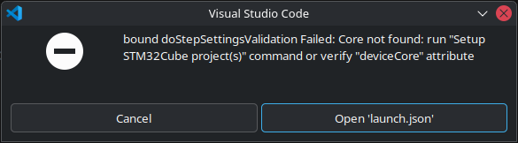

Thank you for this precise article. I've run into a problem while trying to debug, I just get an error message:
ST-LINK SN : 004400303234510E37333934
ST-LINK FW : V3J16M9
Board : NUCLEO-N657X0-Q
Voltage : 3.29V
Error: Unable to get core ID
Error: Cannot connect to access port 1! If you are trying to connect to a device with TrustZone enabled please try to connect with HotPlug mode. If you are trying to connect to a device which supports Debug Authentication with certificate or password, please open your device using it.
Encountered Error when opening C:/Users/zsigm/AppData/Local/stm32cube/bundles/programmer/2.20.0/bin\STM32_Programmer_CLI.exe
Error in STM32CubeProgrammer
Error finishing flash operation
cube is killed by signal SIGTERM
What could be causing this? Is there a way to enable HotPlug mode in the launch.json file?
Thank you in advance!

@zsigmons
You can solve that error by adding following lines to launch.json :
Match the device name to your device
"deviceName": "STM32N657X0H3Q",
"deviceCore": "Cortex-M55",

Step B: Flash using a VS Code Task (DEVBOOT only)
Flashing signed images via the ST‑LINK GDB server in VS Code is fragile in this scenario, especially with external flash and trusted ELFs. A more robust approach is to:
  • Put the board in DEVBOOT (BOOT1=1),
  • Use STM32_Programmer_CLI with the external loader and explicit addresses,
  • And run that via a VS Code task.
Example .vscode/tasks.json:
    "version": "2.0.0",
    "tasks": [
        // This task invokes the STM32CubeProgrammer CLI to program the board.
        // REQUIREMENT: Board must be in DEVBOOT mode (BOOT1=1) for this to succeed.
            "label": "Flash STM32N6 (DEVBOOT)",
            "type": "process",
            "command": "STM32_Programmer_CLI",
            // AUTOMATION: Automatically runs the "Clean Rebuild" task first.
            // If the rebuild fails, this flash command will not execute.
            "dependsOn": [
                "CMake: clean rebuild"
            "args": [
                // CONNECTION: Use SWD port and connect 'Under Reset' (UR)
                "-c", "port=SWD", "mode=UR",
                // EXTERNAL LOADER: Required to program the external Octal-SPI/HyperFlash.
                // Ensure this path points to the correct loader for the STM32N6 DK.
                "-el", "C:/Program Files/STMicroelectronics/STM32Cube/STM32CubeProgrammer/bin/ExternalLoader/MX66UW1G45G_STM32N6570-DK.stldr",
                // FLASHING FSBL (First Stage Boot Loader):
                // Using flat binary (.bin) format requires explicit start address (0x70000000).
                "-d", "${workspaceFolder}/FSBL/build/FSBL-trusted.bin", "0x70000000", "-v", // Verify after write
                // FLASHING APPLI (Main Application):
                // Using flat binary (.bin) format requires explicit start address (0x70100000).
                "-d", "${workspaceFolder}/Appli/build/Appli-trusted.bin", "0x70100000", "-v" // Verify after write
            "problemMatcher": []
After saving tasks.json, run it via:
  • Ctrl+Shift+P → Tasks: Run Task → Flash STM32N6 (DEVBOOT)

  1. Flash in DEV Mode:
    • Set Switch to DEVBOOT mode (BOOT1=1).
    • Run Task: "Flash STM32N6 (DEVBOOT)".
    • Result: FSBL-trusted.bin and Appli-trusted.bin are correctly written to External Flash.

  3. Debug via Hotplug:
    • Press F5 on "STM32N6-DK Hotplug/Debug".
    • Result: Debugging with FLASHBOOT mode (BOOT1=0, BOOT0=0) is now possible.

Thank you very much for this article. It helped me set up VSCode for the STM32N6 Discovery board and also for the Nucleo version of it. I can build the appli and FSBL using the updated CMakeLists and I can also flash them manually with the programmer. However, if I try to use VSCode, I end up with the following error:
bound doStepSettingsValidation Failed: Core not found: run "Setup STM32Cube project(s)" command or verify "deviceCore" attribute
I made the changes to the launch.js but it does not help.

I have of course also done the 'Setup STM32Cube projects' steps. However I do not know what is meant with 'deviceCore Attributes'.
Do you have any hints on what i could have done wrong?
