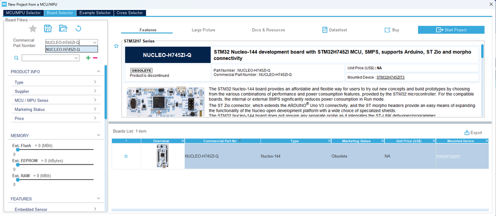

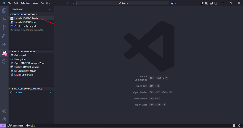

  • Create a new STM32CubeMX project, open VS Code, and launch STM32CubeMX:
The hardware used in this showcase is the NUCLEO-H745ZI-Q, but you can use any STM32H7 board with a Dual-Core architecture.
  • Select the NUCLEO-H745ZI-Q:

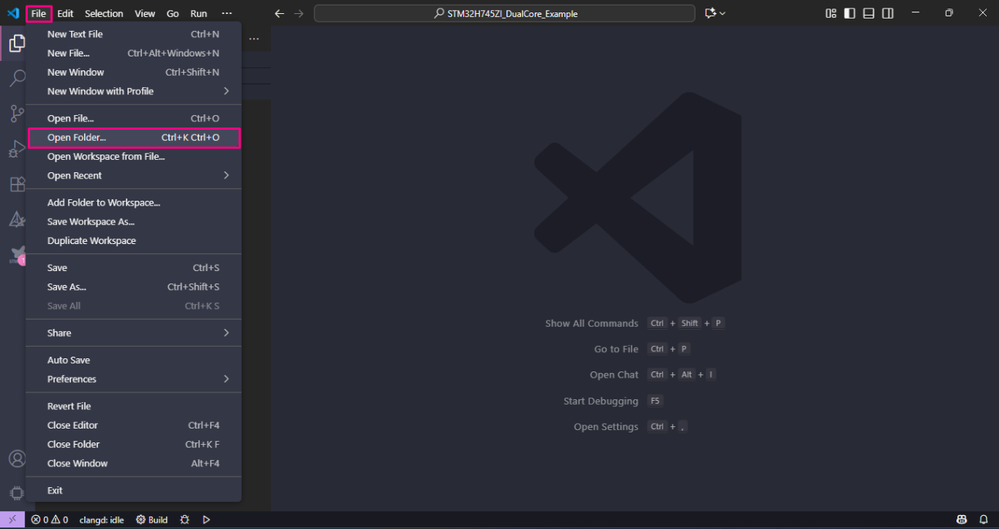

  • In VS Code, import the project folder:

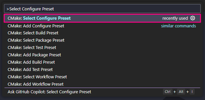

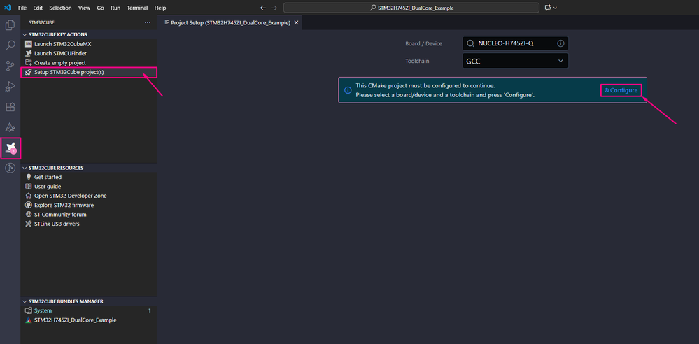

  • Configure the preset [Debug], Ctrl+Shift+P and choose [CMake: Select Configure Preset]:
  • Configure the CMake discovered project as an STM32Cube project:

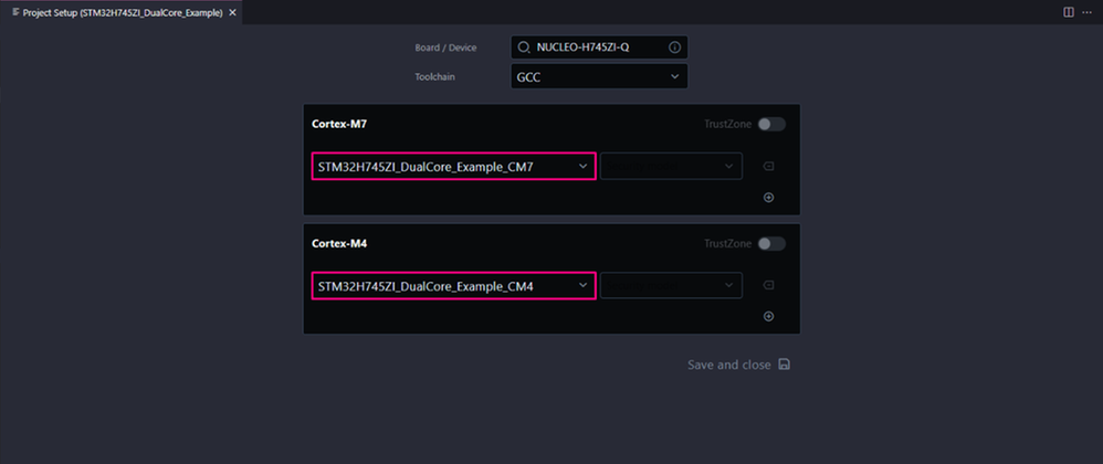

  • Add [CM7] and [CM4] to your environment, save and close:

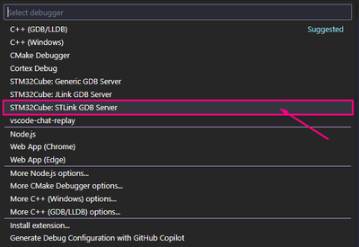

  • Select [STM32Cube: STLink GDB Server] from the list of debuggers provided by STM32CubeExtension.
  • The extension generates a default launch.json with configurations tailored for STLINK debugging.

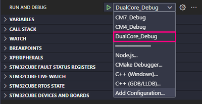

  • In VS Code, select the debug configuration you created.

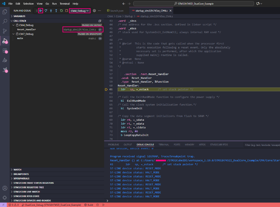

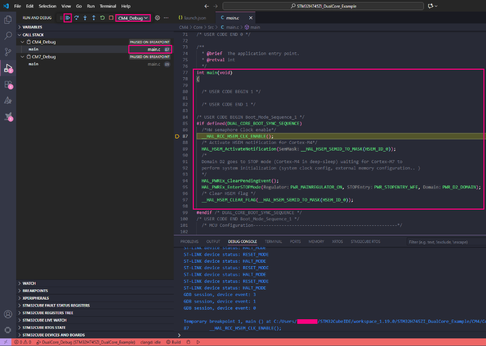

  • The debugger should first halt at [CM4] “startup_stm32h745xx_CM4”:
  • Press [F5] Continue. The debugger should now halt at [CM4] “main.c”:

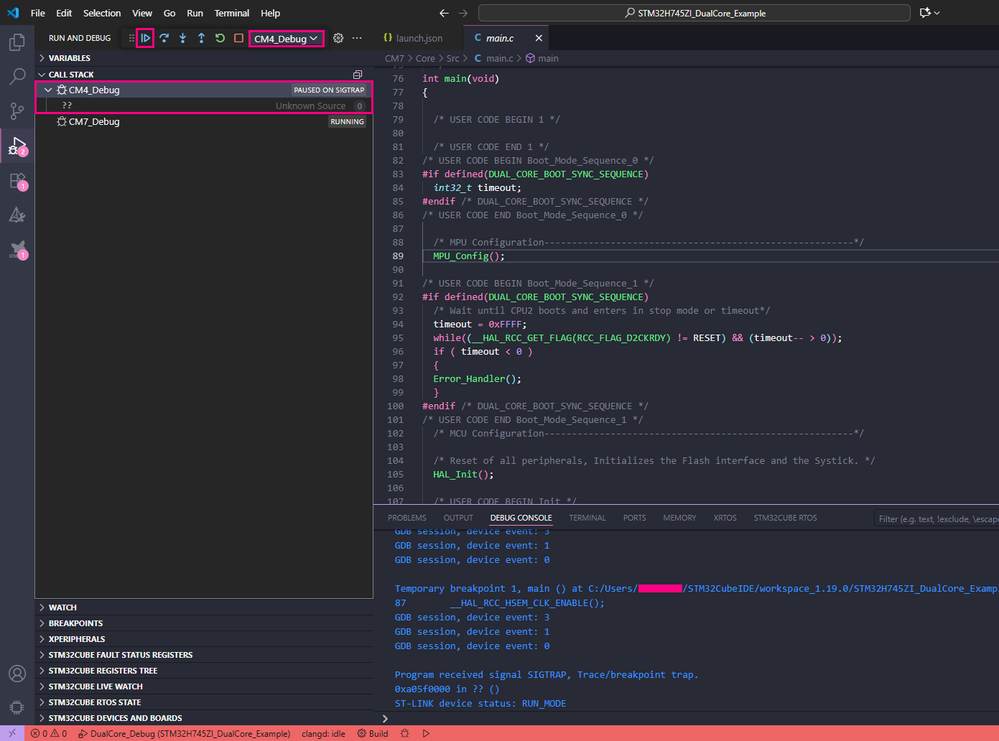

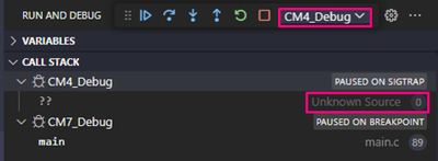

  • Press [F5] Continue. The debugger displays “Unknown Source”:

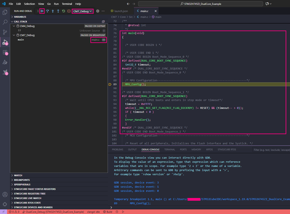

At this point, if you continue execution, you see "Unknown Source" in the debugger because CM4 is halted in STOP mode, waiting for the release signal from CM7. To proceed, you need to run the CM7_Debug session.

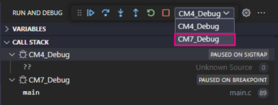

  • Switch to the CM7_Debug session:
The CM7 core performs its own initialization, including system configuration and memory setup, and eventually releases CM4 from STOP mode by clearing the hardware semaphore.
Once this happens, CM4 resumes normal execution, and you can continue debugging both cores as intended. If you do not start and run CM4 to its waiting state before running CM7, the dual-core synchronization fails, and debugging does not work. Maintaining this order is essential for the correct execution of the dual-core boot process and for reliable debugging of both cores.

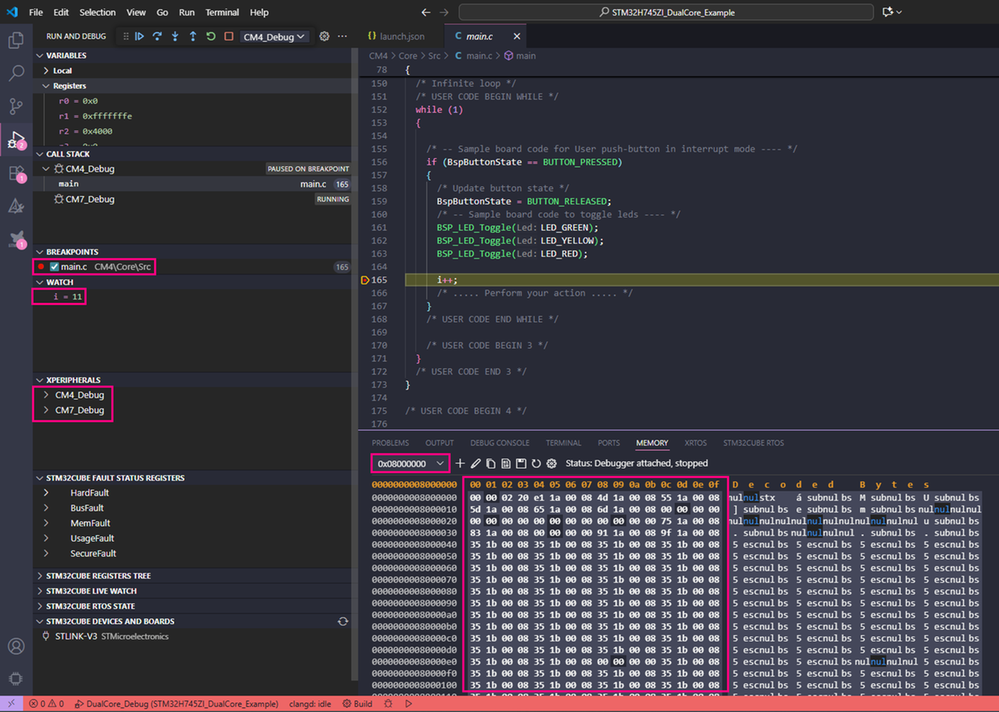

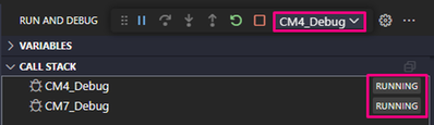

  • Press [F5] Continue, the debugger automatically switches back to the CM4_Debug session:
  • Press [F5] Continue, now both cores run simultaneously:
Once both cores are synchronized and running, all standard debugging features become available, allowing you to:
  • Set breakpoints on either core.
  • Step through your program flow.
  • Inspect variables, registers, and memory for each core.
  • View and analyze the call stacks to track execution context.
