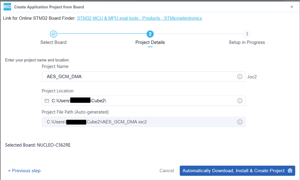

2.1 Create or open the project
Begin by creating a new STM32C5 project or opening the existing one that will host the example. In this example, NUCLEO-C562RE is used as starting board.

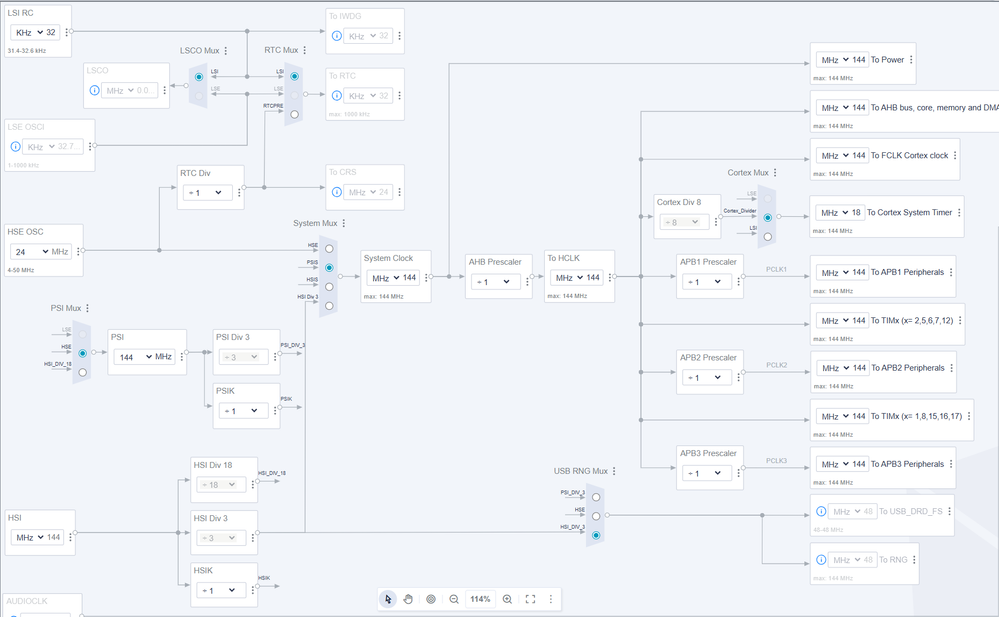

2.2 Configure the system clock
After the project is created, review the clock tree carefully. The clock configuration must be valid for the device and compatible with the intended runtime environment. Although this demo is not particularly sensitive to high throughput, an invalid or inconsistent clock configuration can still prevent the system from starting properly. Additionally, it can disable peripherals indirectly if bus clocks are not configured as expected.
In this example, the default clock configuration is kept.

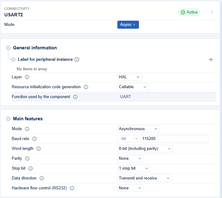

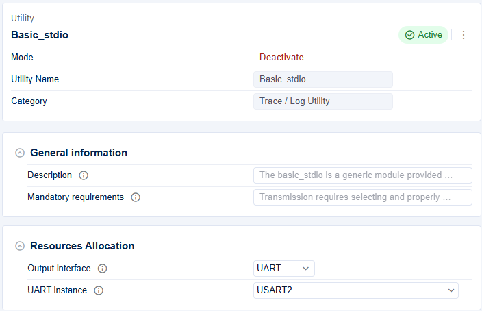

2.3 Configure standard output for runtime logs
The example uses console messages to indicate whether each phase of the demo has passed. For that reason, it is useful to configure a standard output path early in the process. Depending on the project environment, this may be UART-based, a virtual COM port, semihosting, or another redirected standard I/O method.
The purpose of this step is not merely convenience. Visible logs dramatically reduce debug time during bring-up, especially when checking whether the code reached the encryption stage, got stuck waiting for DMA completion, or failed during result comparison.

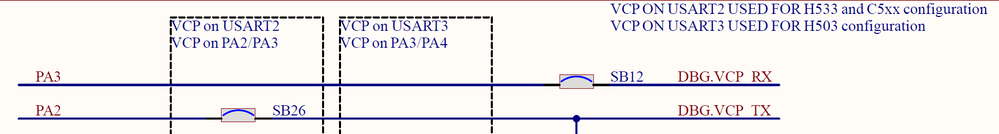

In this example, a virtual COM port is used. By inspecting the board schematics, USART2 is connected to the debug virtual COM port, so it is essential to enable that UART instance.
The default USART configuration is kept.
To simplify the COM port initialization process, the Basic STDIO utility is used. By specifying the USART instance and generating the code, calling mx_basic_stdio_init() inside the main() function takes care of overloading printf() and redirecting its output to UART so it can be displayed on the serial interface.

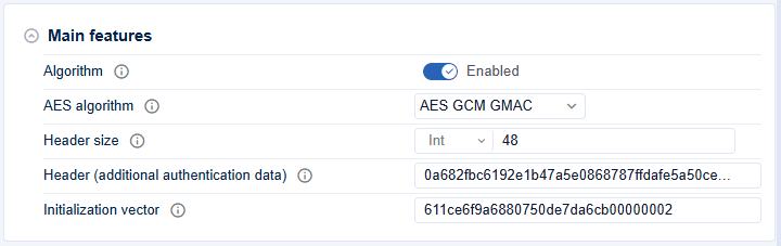

2.5 Algorithm configuration
  • [Enable] the Algorithm option.
  • Set AES GCM GMAC as [AES algorithm].
  • Set Header size to [48].
  • Set Header to the snippet below:
0a682fbc6192e1b47a5e0868787ffdafe5a50cead3575849990cdd2ea9b3597749403efb4a56684f0c6bde352d4aeec5
  • Set the Initialization vector to the snippet below:
611ce6f9a6880750de7da6cb00000002

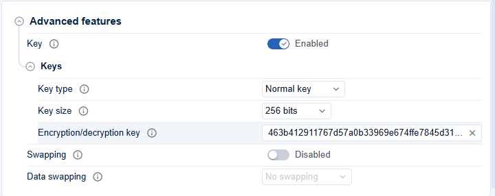

2.6 Key configuration
  • [Enable] the Key option.
  • Set Key type to [Normal Key].
  • Set Key size set to [256 bits].
  • Set the Encryption/decryption key to the snippet below:
463b412911767d57a0b33969e674ffe7845d313b88c6fe312f3d724be68e1fca

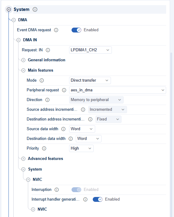

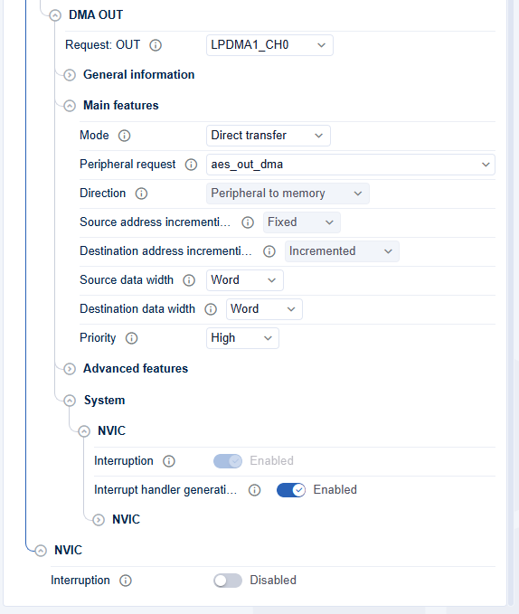

2.7 DMA for AES configuration
After AES is configured, set up the DMA channels used for the AES data path.
  • [Enable] Event DMA request to allow the AES peripheral to trigger DMA transfers.
  • Select [LPDMA1_CH2] for Request: IN. This channel transfers AES input data from memory to the peripheral.
  • Use [Direct transfer] mode with [aes_in_dmaas the peripheral request and [Memory to peripheralas direction.
  • Set both data widths to [Word] and priority to [High].
  • Select [LPDMA1_CH0] for Request: OUT. This channel transfers AES output data from the peripheral to memory.
  • Use [Direct transfer] mode with [aes_out_dma] as peripheral request and [Peripheral to memory] as direction.
For both DMA channels, keep [Interrupt handler generation] enabled so that the required DMA support code is generated automatically.

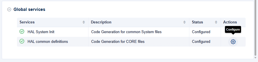

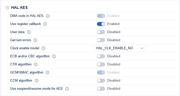

2.8 Enable AES register callback support
Before generating the project code, enable the definition required to register custom AES callbacks. To do this:
  • Open the project settings.
  • Scroll down to Global Services.
  • Click the [Cogwheel] icon on the right of HAL common definitions.
  • Scroll down to the HAL AES section.
  • Enable [Use register callback].
This step is required because the example registers custom AES callbacks for DMA completion and error handling.

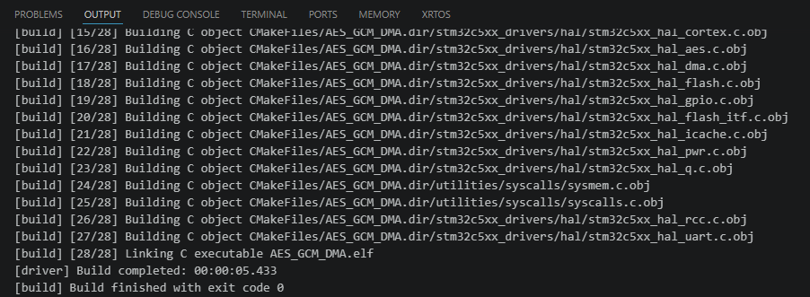

Once the generation is complete:
  • Open the project in VS Code.
  • Perform a clean build.
  • Do this before adding the final application logic.
This intermediate build serves an important purpose. It confirms that the generated startup code, peripheral initialization code, includes, and linker setup are all coherent. If an issue exists here, solving it now avoids confusion later when application code is also present.

3.23 Build and flash
After completing the source code integration, build the project and program the target board.
