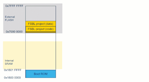

1.1 Application as part of the FSBL
In this mode, the boot ROM fetches the FSBL from external serial NOR flash memory. As the FSBL and application are contained in the same binary, there is a 511 KB size limitation in this mode. This is due to the total area of 512 KB that the boot ROM copies from the external memory into the internal SRAM. The visual representation can be observed in the small animation below:

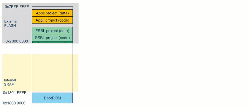

1.2 FSBL with load & run application
In this mode, the boot ROM fetches the FSBL from external flash memory. This time, the FSBL proceeds to configure the external memory and fetch a second binary stored in it, then copy it into the internal SRAM. Once the binary is loaded, the FSBL jumps to the new position in RAM, where the application code is located and starts the execution. This mode is applicable to a few examples available in the STM32Cube_FW_N6. The interesting aspect is that the 511 KB size limitation is no longer applicable, as the user code can be placed in the remaining area of the internal RAM.

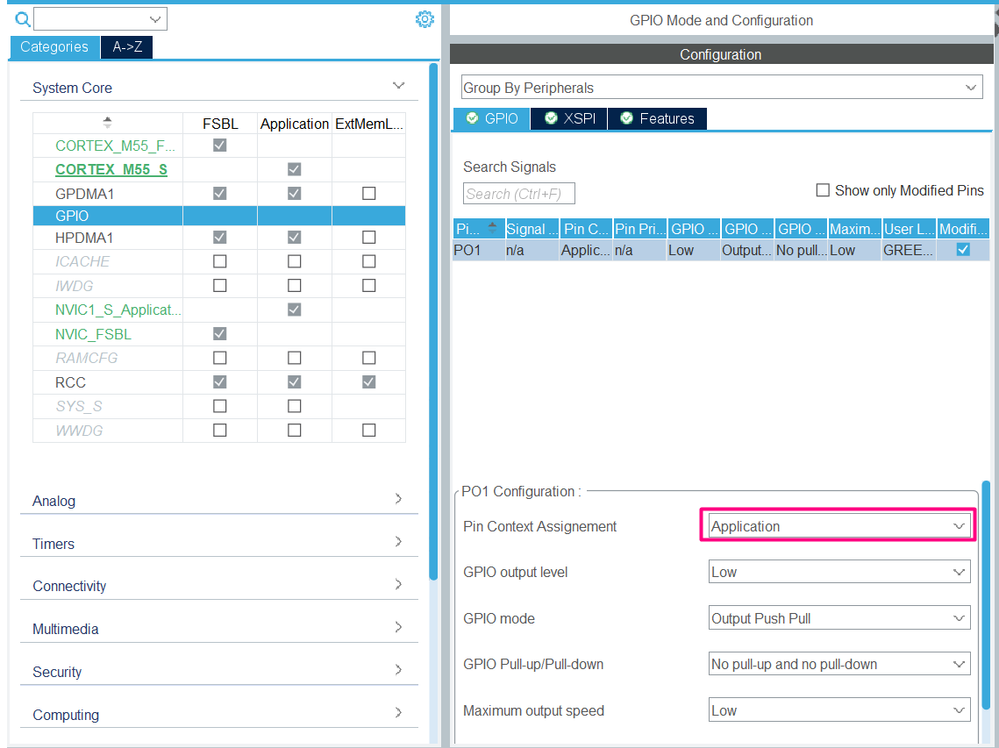

2.1.1 Configure the LED pin
Locate the PO1 and configure it as GPIO_Output and use the label to name it GREEN_LED.

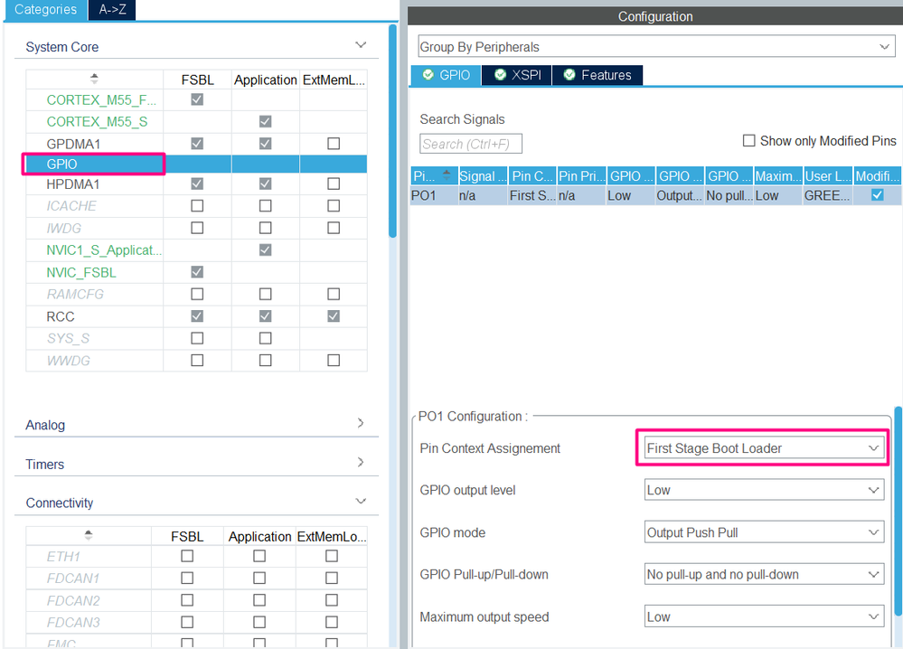

We need to assign the GPIO to be used by the FSBL

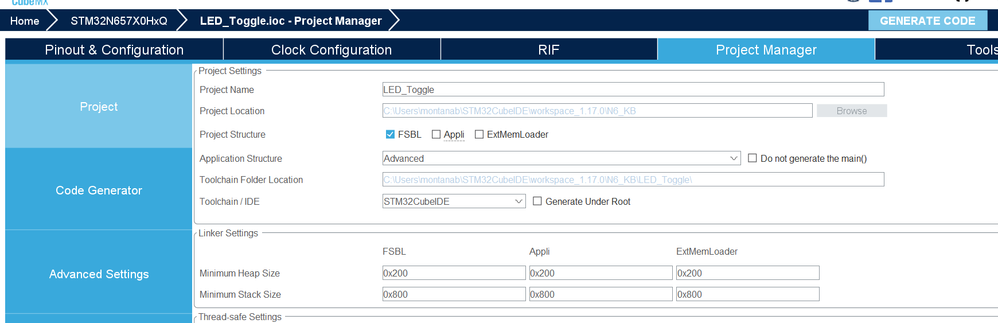

In the [Project Manager] tab, ensure the [FSBL] checkbox is selected and generate the code for your preferred toolchain.

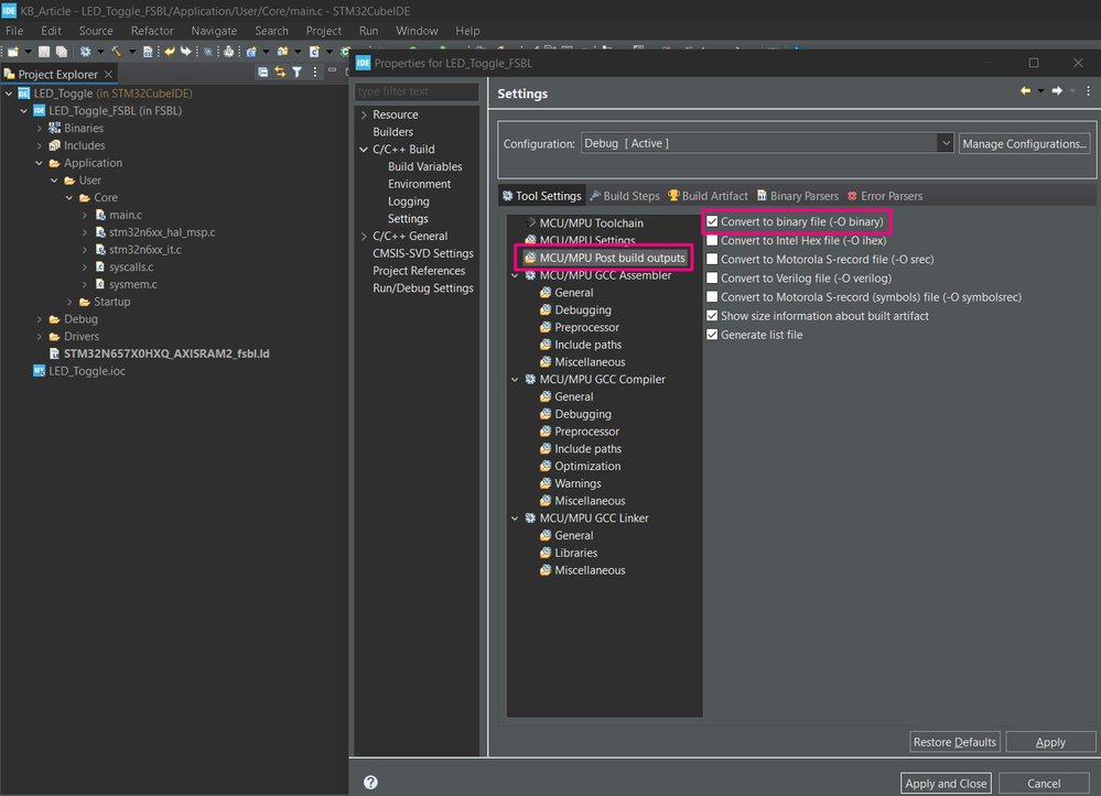

Make sure that your project settings are configured to generate the *.bin as well, since we use it to run the scripts.

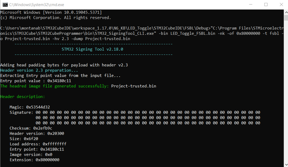

To facilitate the process, its possible to type [cmd] in the binary folder. For example ..\LED_Toggle\STM32CubeIDE\FSBL\Debug. This will pop up the cmd in the selected path and its possible to use the command line interface from STM32CubeProgrammer and its Signing Tool. Starting from STM32CubeProgrammer version 2.21.0, a new parameter is needed at the end "-align". Please make sure you use the updated command, as follows:
"C:\Program Files\STMicroelectronics\STM32Cube\STM32CubeProgrammer\bin\STM32_SigningTool_CLI.exe" -bin LED_Toggle_FSBL.bin -nk -of 0x80000000 -t fsbl -o Project-trusted.bin -hv 2.3 -dump Project-trusted.bin -align
This creates the header for the binary, which can now be loaded into the external FLASH using STM32CubeProgrammer.

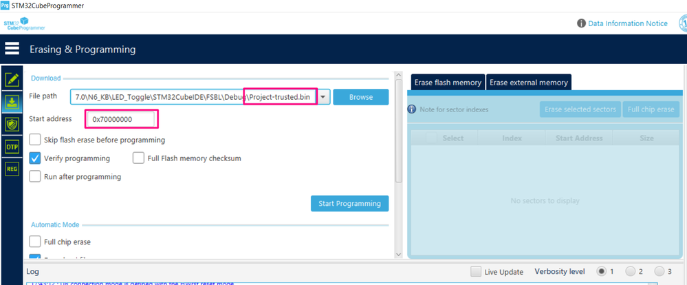

2.1.4 Programming the binary

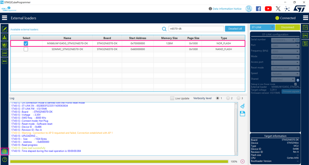

Make sure that the external loader for the flash memory is enabled and use the address [0x7000 0000] to program the binary.
TIP: you might need to power cycle the board in case a failure message appears when clicking [Start Programming].

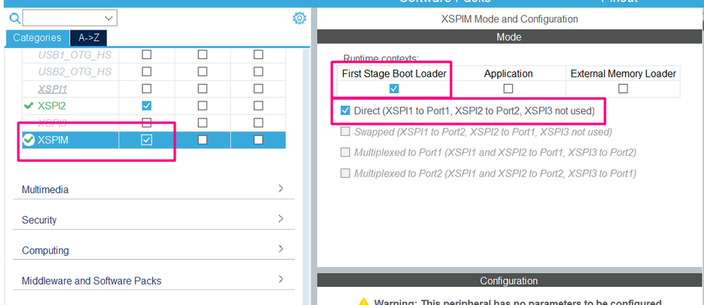

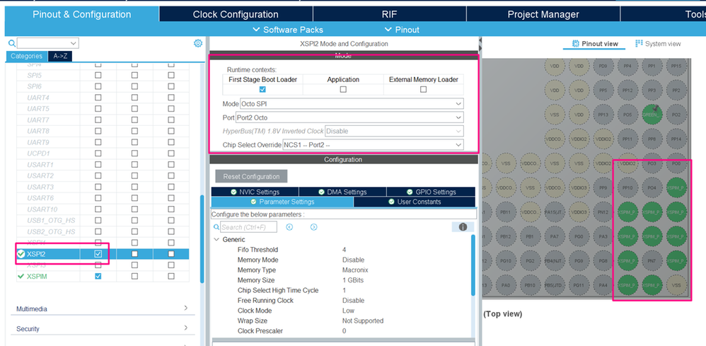

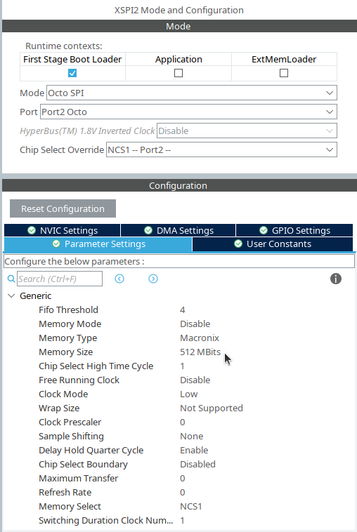

2.2.1 Configure the XSPI and XSPIM

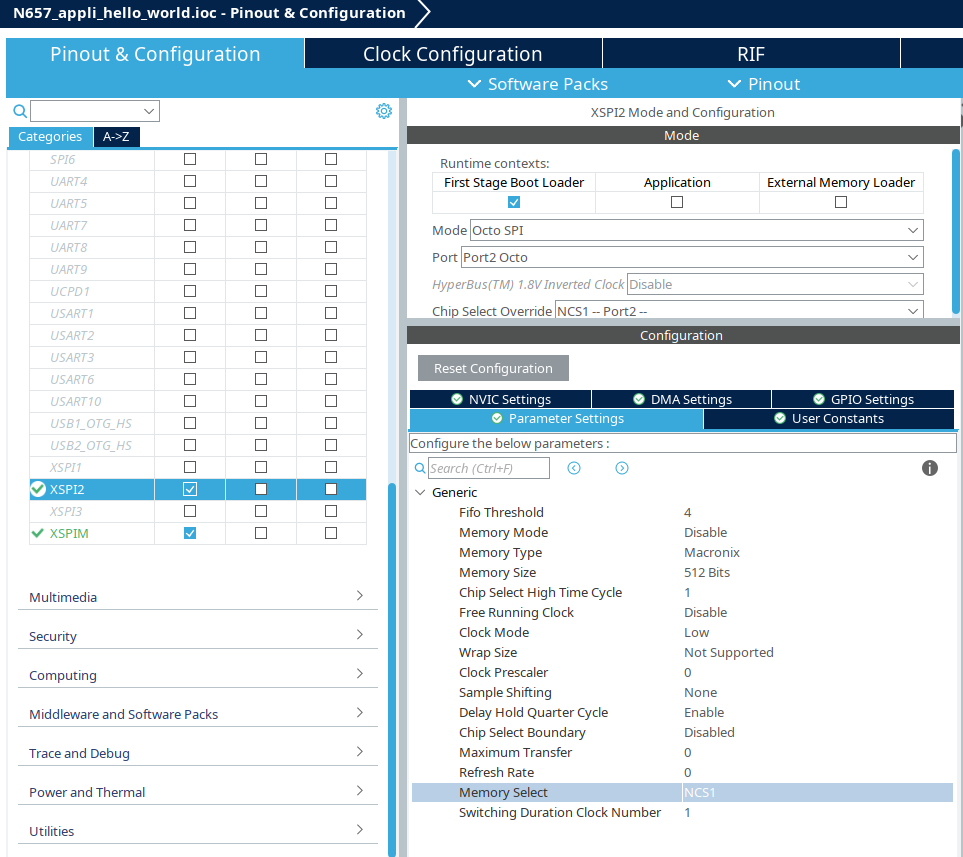

Using the same STM32CubeMX project, locate the [XSPIM] under the [Connectivity] menu on the left and select it to run during the [FSBL] and have the [Direct] mode selected:

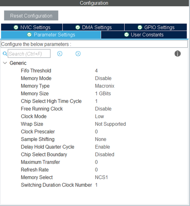

The OCTOSPI flash memory has the following characteristics: 1 Gbit, 1.8 V, 200 MHz, DTR, read while writing. It is connected to the OCTOSPI interface of the STM32N657X0H3Q microcontroller on the STM32N6570-DK board on XSPI2. With that information, go to XSPI2 to configure the peripheral according to the hardware available:
As for the [Parameter Settings], look carefully at the image below:

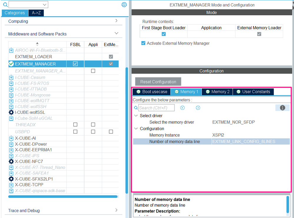

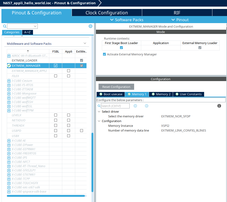

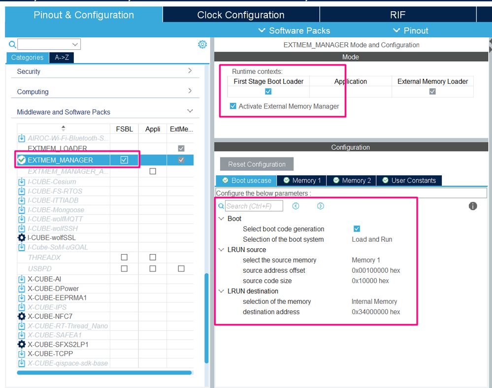

2.2.2 Configure the EXTMEM_MANAGER

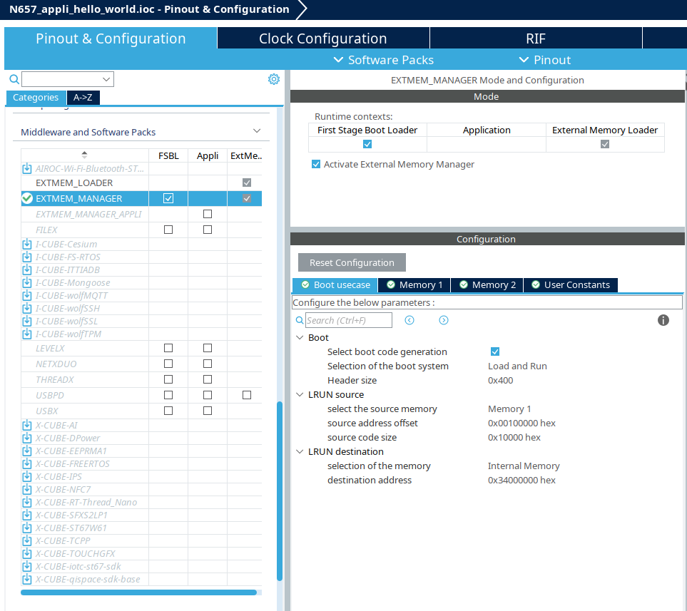

The next step is locating the [Middleware and Software Packs] in the [Categories]. Expand the [EXTMEM_MANAGER]. Add the FSBL and activate it using the following settings:
[LRUN source address offset] =  0x00100000
[LRUN source code size] =  0x10000
[LRUN destination address] =  0x34000000
In the [Memory 1] tab, ensure its as follows:

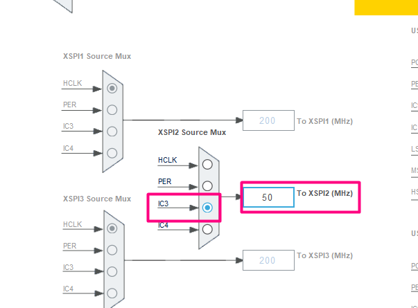

2.2.3 Configure the XSPI clock
The last step for the XSPI is to configure its clock. For this example, we will set the XPI2 clock to 50 MHz. To achieve higher speeds up to the 200 MHz supported by this serial NOR FLASH, you need to make changes to OTP for I/O speed optimization, which is not covered in this article. Go to the [Clock Configuration] tab and have the IC3 as the source for the XSPI2 and type 50 and press enter for the clock to be automatically adjusted:

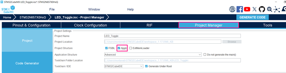

Now that we are done with the XSPI, it is time to add the [APPLI] checkbox in the [Project Manager] tab, so the application project can be created:
And roll back to the [Pinout & Configuration] tab to change the [GPIO] LED pin to be assigned to the application instead of the FSBL:
Proceed with the code generation for both projects.

Use the same process using the STM32CubeProgrammer to program the FSBL at address 0x7000 0000 and the appli at address 0x7010 0000. Remember to have the STM32N6’s BOOT1 set to HIGH and reset or power cycle the board before programming.

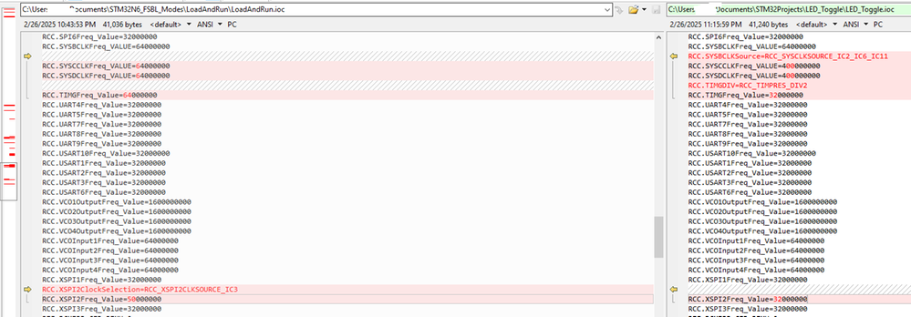

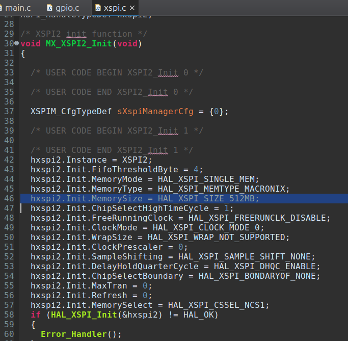

I had the same problem as the OP where the Appli binary wouldn't boot. Upon comparing the code shared by Bruno on Github I noticed the clock for IC3 in XSPI2 was set to 32MHz instead of 50MHz as per this guide. Once I set it to 32MHz and re-built, the Apply binary successfully booted. This change looks to have also made the clock solver to adjust other clocks as well, albeit to different values than what is in the Github repo.
asdfasdf
Associate III
@flexiglass In my case the problem wasn't the XSPI2 clock (that works for me at 50 MHz as in the tutorial), but the SYSB clock (which feeds the AXI). I had this running at 400 MHz whereas @B.Montanari uses just 64 MHz. Lowering SYSB to 64 MHz made it work for me, and it also continues to work even if I increase the CPU clock (SYSA) to 600 MHz.
I have no idea why it is so sensitive to the SYSB clock, as that should not really have to do anything with the external flash I guess? I have the exact same problem when doing XIP instead of LRUN and asked about it here, sadly without an answer so far. This is pretty disappointing, as the MCU is dead-slow with RAM running at just 64 MHz...
B.Montanari
Hi @flexiglass and @asdfasdf ,

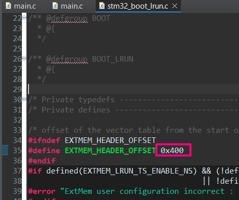

I've just made some changes in the *.ioc file to run the CPU at 600MHz, AXISRAM at 400MHz and kept the IC3 (XSPI2) at 50MHz. Please see the attached *.ioc. In this version I've also added the ICACHE and DCACHE plus the MPU settings, so we should have the fastest performance results without going into overdrive mode, which allows the core to go up to 800MHz. The zip for the changed project is here> STM32N6_FSBL_Modes/LoadAndRun/LoadAndRun_600MHz.7z at main · stm32-hotspot/STM32N6_FSBL_Modes
I'm planning on writing a quick article on the overdrive and another one on the OTP programming, so I could detail more on how to change the settings to get a higher clock on the XSPI2 in a reliable manner as well. I'll have a code example for that as well once I'm done.
Hope this helps and don't forget to change the #define EXTMEM_HEADER_OFFSET to 0x400 after code generation.

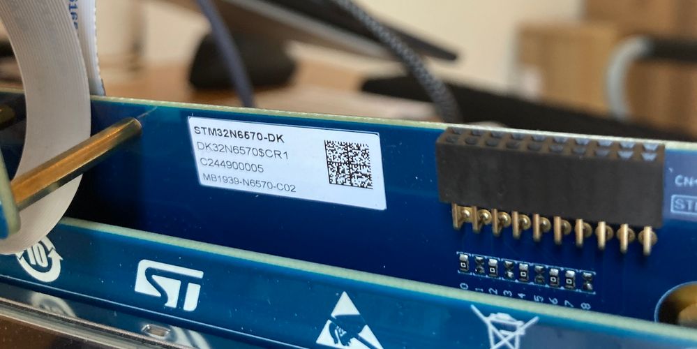

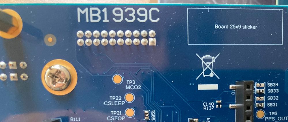

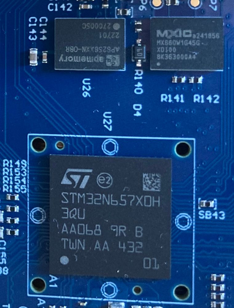

Hi @B.Montanari , thank you very much for your help in resolving this issue! Sadly, even flashing the compiled binaries that you uploaded the board does not start (that is, no blinking LED). I'm starting to suspect something might be wrong with my Discovery board, or that this is due to differing OTP fuse configurations. I have not changed anything in this regard but am using the Discovery board exactly in the state I bought it.
I have attached an Export of the OTP settings generated by CubeProg - would you mind doing the same for your board (where this is apparently working) and diffing with mine to see whether there are any differences?
Also, I attached three photos showing the exact hardware revision of the Discovery board and MCU - it would be great if you could check this against your version as well, just to make sure I'm not having a broken hardware revision or something like that.
Thank you very much!
Best regards, Michael

asdfasdf
Associate III
Ok, so I got it working, the problem was that even when running the XSPI flash at 50 MHz the "high speed IO optimizations" should be enabled - see also this thread.

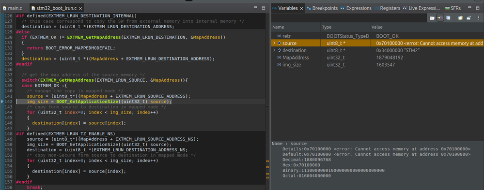

However, when I tried to run it again, the FSBL no longer loaded the APPLI. I have checked the parameters and configurations several times, but to no avail. When I debugged the FSBL, it seemed that it could not access the flash memory. The error is:
0x70100000 <error: Cannot access memory at address 0x70100000>
I am attaching an image:
Hard faultHard fault
This is my configuration:
I use 512 bits because my card is a NUCLEO-N567X0-Q and has 512 Mbit Octo-SPI flash memory.
The board works because I can run the .bin files that were created previously.
Best regards!
Dam
Associate
while solving my problem, I found two errors:
  • I set the memory size to 512 Bits instead of 512 Mbits.
  • Using the latest version of the STM32 Signing Tool (v2.21.0), I had to use the '-align' flag to correctly perform the signing.
.../STM32_SigningTool_CLI -bin ${ProjName}.bin -align -nk -of 0x80000000 -t fsbl -o ${ProjName}-Trusted.bin -hv 2.3 -dump ${ProjName}-Trusted.bin
Now, it works ! Best regards!
