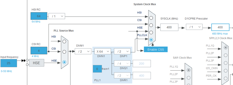

Configure clock tree:
  • In pinout/RCC configure HSE in bypass mode
  • In clock tree configure 400MHz for core
  • In pinout/SYS configure different timebase than SysTick (recommended when using FreeRTOS)
    • TIM6 is usually a good option, since it is a simple timer

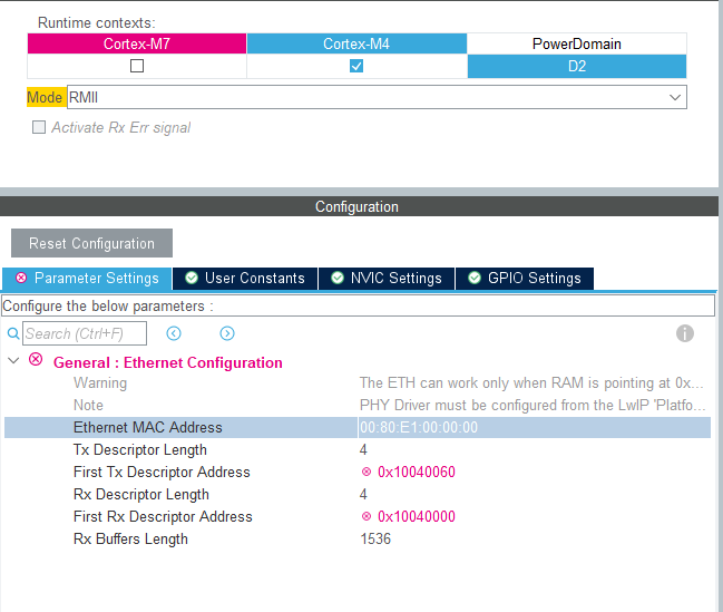

  • Enable Ethernet peripheral in pinout view in MII mode (MII used on the board).
  • Enable Ethernet interrupt and set preemption priority to 5. This is required by FreeRTOS in order to call its functions from interrupt handler.

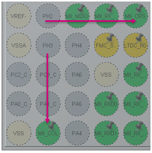

  • Relocate Ethernet CRS and COL signals from PH2/PH3 to PA0/PA3
    • These signals are optional in full-duplex mode and not connected in default configuration
    • This will also allow use PH2/PH3 for QSPI
  • Other pins should be correctly placed, since we create the project from board selector.

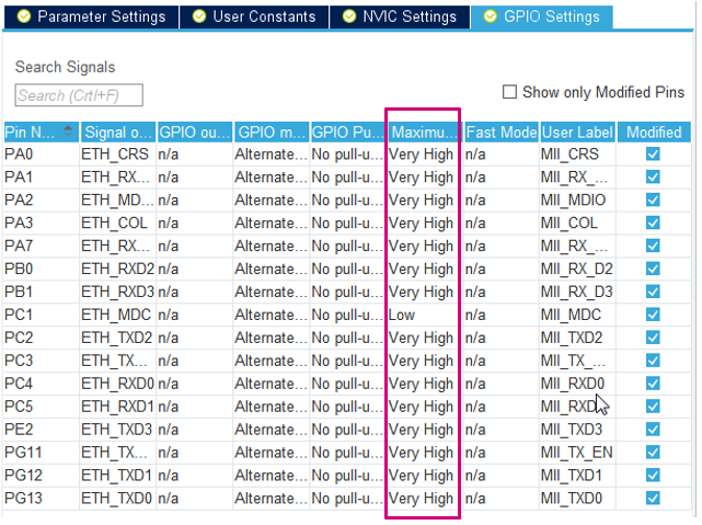

  • Set GPIO pin speed to Very High.
The ETH_MDC speed couldn't be changed for some reason, but it doesn't affect the application and it was already fixed in new versions.

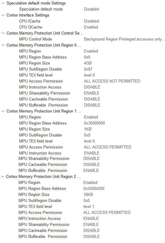

Cortex-M7 configuration
This step can be skipped when using Cortex-M4 core.

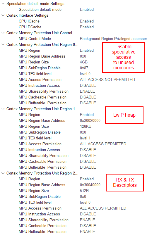

  • Enable ICache and DCache.
  • Enable memory protection unit (MPU) in “Background Region Privileged access only + MPU Disabled ...” mode. Configure regions according to the picture below:
Above example is for STM32H743 device. For other devices or Cortex-M4 core on dual-core device, different addresses and size might be necessary. Please refer to section Memory layout
When using dual-core device and running Ethernet on Cortex-M7 core, it must be ensured that memory used by Ethernet is not used by Cortex-M4. Also note the Cortex-M4 can use different address alias for D2 RAM

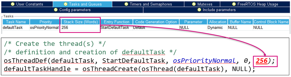

  • Increase the size of defaultTask stack to 512 words1
  • Lower stack values cause memory corruptions
  • Please check also that the generated code is correct, since there is bug when increasing the MINIMAL_STACK_SIZE and there might be old value in code (this should be fixed in new versions)

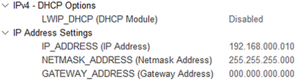

  • In "General settings" tab, disable DHCP server and configure fixed IP address (unless you know how to configure and use DHCP).
  • In the attached examples, the 192.168.1.10 IP address is used (instead of 192.168.0.10 shown on the screenshot).

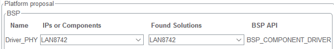

  • In "Platform settings" tab select "LAN8742" in both select boxes. The LAN8742 driver is also compatible with LAN8740 device, which is actually present on the STM32H750-Discovery board. The main difference between these devices is support of MII interface. On other boards LAN8742 PHY chip is used.

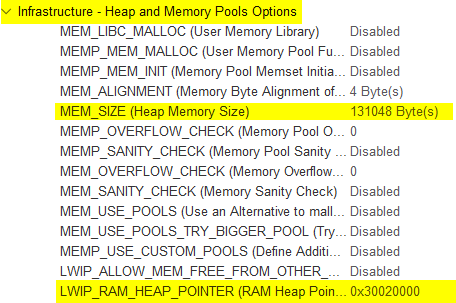

In "Key options" tab:
  • Configure MEM_SIZE to 16360. This specifies the heap size, which we will relocated to D2 SRAM (16kb minus 24 bytes for allocator metadata).
  • Also enable LWIP_NETIF_LINK_CALLBACK (needed for cable plugging/unplugging detection).

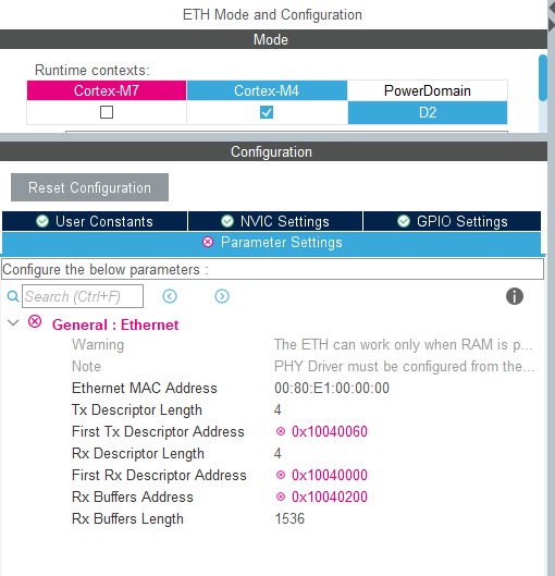

  • Set the LWIP_RAM_HEAP_POINTER to proper address2
  • Set the MEM_SIZE parameter to proper size2

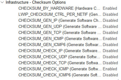

  • (Should be done automatically by new CubeMX) In "Checksum" tab enable CHECKSUM_BY_HARDWARE. Other options should automatically reconfigure and you can leave them in this state.

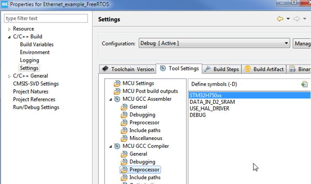

  • Add DATA_IN_D2_SRAM to macro definitions in project:

In the MPU settings:
_legacyfs_online_stmicro_images_0693W00000Lx2UPQAZ.pngAnd finally in ethernetif.c, there is missing setting the rx pool base to the correct address:

Starting with the STM32 Cube FW_H7 1.10.0 version, it becomes impossible to specify the correct location of the ethernet descriptors and buffers officially recommended here in paragraph 10.2 for CortexM4.
Migrating example (p.11. Attached examples) STM32H745_Nucleo_M4_ETH.ioc from 1.9 to 1.10 gives the result shown in the picture.
0693W00000Nr00OQAR.pngIf you are trying to run Ethernet on Cortex M4 while having all it in the M7 region (0x3000000), it still works. But it works very bad and unstable, even a regular ping test gives from 3 to 20% of failed packets, and if you increase the size of the ping packet, it falls immediately.

I didn't implement anything else - only ethernet on M4 core. You can try to create a new empty project to run ethernet on M4 with STM32 Cube FW_H7 1.10.0. And this does not work at all when used in RTOS mode.

But I'm talking about ethernet running on the M4 CORE as part of STM32H7 with new version of FW_H7_V1.10 in RTOS mode. On the M7 core it works as is... and on the M4 its not working even with your last reccomendations.
Your attached examples are perfect, but can you please update just one of them? Just a simple ping test on M4 CORE of STM32H7, please! It would remove SO MUCH questions at once! Such as:
  1. Do I need to configure MPU in M7 when using Ethernet on M4 core?
  2. You have write "LWIP_RAM_HEAP_POINTER set to 0x30044B00" not shure, but maybe you mean 0x30044800 instead? Cause its equals to 18kb.
  3. You have write "This should ensure that all Ethernet specific buffers/descriptors are placed in SRAM3". I thought that we use only RAM_D2 for it.
  4. What means "MEM_SIZE12000"? Should I change something?
  5. What means "size of the memory pool is roughly 1.5kB × 12 = 18kB"? It is a MEM_SIZE (Heap Memory Size)? So, should I still subtract 24 bytes for allocator metadata
  6. Should I change PBUF_POOL_SIZE and PBUF_POOL_BUFSIZE? Or just keep in mind that the number of RX buffers is fixed to 12?
In the link I sent, in comments, It talks exactly about the poor transfer of the Ethernet driver of the M7 core to the M4 as part of the STM32H7 in FW_H7_V1.10. There is even an internal ticket number 126954. But if this has nothing to do with this - Ok.
I just want to make ethernet work on M4 of STM32H7 with FW_H7_V1.10 and FreeRTOS.
I think you get domains and RAMs mixed up. RAM_D2 (Domain 2) is composed of SRAM1, SRAM2 and SRAM3.

It says 192.168.1.10 IP address is used in the LwIP configuration. Is this IP address the IP address it gives to the kit it uses? Or is it the PC!'s IP address? and according to which notation it gives this IP address.

@IOvch​ Unfortunately I do not have a board with both cores, but for FreeRTOS, wouldn't help you replacing
#define INTERFACE_THREAD_STACK_SIZE ( 350 )
in ethernetif.c with
#define INTERFACE_THREAD_STACK_SIZE ( 512 )
I do not know if it will help you, but I have discovered that 350 is not enough.

@heveskar​ Thanks for your advice! It didn't help, but I'll use it by default in the future

Is there a reason to select the clock at 400MHz, instead of the maximum allowed?
I am using H723 and the clock can be 550MHz, do I have to reduce it to 400?

the 192.168.1.10 IP is for the board. I always configure 192.168.1.1 on the PC side, however different IP address from the subnet could be also viable.

I believe that there are some issues with the MPU setup and the linker file locations for the TX descriptor section. Perhaps I don't understand some of the details though.
A ETH_DMADescTypeDef is 40 bytes, 10 integers of 4 bytes each, and DMARxDscrTab has 4 of them for 160 bytes or 0xA0. DMATxDscrTab is the same 160 bytes or 0xA0. These are placed via the info in the linker file at specific start locations.
So if DMARxDscrTab is placed by the linker file at 0x3004 0000 it will extend to 0x3004 009F,
DMATxDscrTab is placed at 0x3004 0060 for 0xA0 bytes, which is overlapping with DMARxDscrTab.
Ooops?
The MPU setup declares a 32k region starting t 0x3004 0000, and another with the same start address for 256B to contain the DMA descriptors. This second region would extend to 0x3004 00FF. The transmit and receive descriptors are a total of 160+160 = 320 bytes, so the 256B region won't apply the appropriate shareability or bufferabiltiy to the complete transmit descriptor table. A better length for the second region is 512B.
The receiver pool placement seems to be okay, but I don't understand what the LWIP_RAM_HEAP_POINTER is all about and what protections the RX Pool requires. There is a comment "And LWIP_RAM_HEAP_POINTER set to 0x30044B00, with MEM_SIZE12000. This should ensure that all Ethernet specific buffers/descriptors are placed in SRAM3." But those values would have the heap completely in SRAM2. SRAM3 doesn't begin until 0x3008 0000, far above the 0x3004 79E0 end address of the pool. Can you clarify this?

Hi there!
I am using the current provided CubeIDE (STM32CubeIDE Version: 1.10.1 Build: 12716_20220707_0928 (UTC)) CubeMX 6.6.1 and H7 Firmware package F1.10.0
I've used the above step by step instruction to get the
  •    FreeRTOS
  •    LWIP
  •    as TCP Server
running on a STM32H723ZG Nucleo-Board including the described fixes
  •    10. STM32Cube_FW_H7_V1.10.0 (and newer) specific issues
  •    ethernet_link_thread() by @Noti
  •    btw I agree with @JChar.3
Flash.ld file was changed to
MEMORY
 ITCMRAM (xrw)  : ORIGIN = 0x00000000, LENGTH = 64K
 DTCMRAM (xrw)  : ORIGIN = 0x20000000, LENGTH = 128K
 FLASH  (rx)  : ORIGIN = 0x08000000, LENGTH = 1024K
 RAM_D1 (xrw)  : ORIGIN = 0x24000000, LENGTH = 320K
 RAM_D2 (xrw)  : ORIGIN = 0x30000000, LENGTH = 288K
 RAM_D3 (xrw)  : ORIGIN = 0x38000000, LENGTH = 16K
and
/* Modification start */
 .lwip_sec (NOLOAD) : {
  . = ABSOLUTE(0x30000000);
  *(.RxDecripSection)
  . = ABSOLUTE(0x30000060);
  *(.TxDecripSection)
  . = ABSOLUTE(0x30000200);
  *(.Rx_PoolSection)
 } >RAM_D2
 /* Modification end */
LWIP_RAM_HEAP_POINTER set to 0x30004B00, with MEM_SIZE12000
Testing is done with termial program Hercules with serveral ping and connect/diconnect cycles. Start up and connect diconnect run smooth at first, but after a while (or a unplug/replug of Ethernet cable) the device will still ping but refused connection.
Test:
Sending ICMP ECHO REQUEST to module <- frist ping on start up
Received ICMP ECHO REPLY
Connecting to 172.16.17.100 ...
Connected to 172.16.17.100 <- frist connect OK
Connection closed
[.. will continue to be OK for the next 20+ connections ]
// diconnect cable
Connection refused by remote host          <- terminal recognized disconnect OK
Connection closed
// reconnect cable
Sending ICMP ECHO REQUEST to module <- frist ping on reconnect OK
Connection closed
Connected to 172.16.17.100              <- second connect OK
Connection closed
Connected to 172.16.17.100              <- third connect FAIL
Connection closed
Sending ICMP ECHO REQUEST to module <- but ping still works
I think it might be some MPU setup or MEMORY assignment issue.
For convienece I'va added a minimal example
address is 172.16.17.100 Port 80
ping, connect and send a string (e.g. ECHO TEST) the server will reply the string and diconnect
Any help would be highly appreciated!

Associate III
After migrating my project to 1.10.1, I have made the necessary changes as this article describes.
But here is the picture of the cubemx perspective. I cannot figure out what to do to fix it.
Have a nice day.

// MPU setting
static void MPU_Config(void)
MPU_Region_InitTypeDef MPU_InitStruct;
/* Disable the MPU */
HAL_MPU_Disable();
/* Configure the MPU as Strongly ordered for not defined regions
* Disable speculative access to unused memories
MPU_InitStruct.Number = MPU_REGION_NUMBER0;
MPU_InitStruct.Enable = MPU_REGION_ENABLE;
MPU_InitStruct.BaseAddress = 0x00;
MPU_InitStruct.Size = MPU_REGION_SIZE_4GB;
MPU_InitStruct.SubRegionDisable = 0x87;
MPU_InitStruct.TypeExtField = MPU_TEX_LEVEL0;
MPU_InitStruct.AccessPermission = MPU_REGION_NO_ACCESS;
MPU_InitStruct.DisableExec = MPU_INSTRUCTION_ACCESS_DISABLE;
MPU_InitStruct.IsCacheable = MPU_ACCESS_NOT_CACHEABLE;
MPU_InitStruct.IsBufferable = MPU_ACCESS_NOT_BUFFERABLE;
MPU_InitStruct.IsShareable = MPU_ACCESS_SHAREABLE;
HAL_MPU_ConfigRegion(&MPU_InitStruct);
/* Configure the MPU attributes as Device not cacheable
   for ETH DMA descriptors */
MPU_InitStruct.Number = MPU_REGION_NUMBER1;
MPU_InitStruct.BaseAddress = 0x30000000;
MPU_InitStruct.Size = MPU_REGION_SIZE_1KB;
MPU_InitStruct.SubRegionDisable = 0x00;
MPU_InitStruct.AccessPermission = MPU_REGION_FULL_ACCESS;
MPU_InitStruct.IsBufferable = MPU_ACCESS_BUFFERABLE;
/* Configure the MPU attributes as Normal Non Cacheable
     for LwIP RAM heap which contains the Tx buffers  */
MPU_InitStruct.Number = MPU_REGION_NUMBER2;
MPU_InitStruct.BaseAddress = 0x30000400;
MPU_InitStruct.Size = MPU_REGION_SIZE_32KB;
MPU_InitStruct.TypeExtField = MPU_TEX_LEVEL1;
MPU_InitStruct.IsShareable = MPU_ACCESS_NOT_SHAREABLE;
     * Enable the MPU
    HAL_MPU_Enable(MPU_PRIVILEGED_DEFAULT);

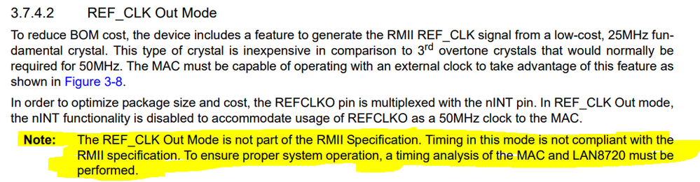

HLe.2
Associate II
Hello Mr. Adam BERLINGER
Thank you so much for the very helpful article.
I'm making a simple board based on STM32H7 and LAN8720 (currently I don't have LAN8742). I just started using STM32, I follow your tutorial and samples code on github, ping is OK but it disconnects after some time (please see the log below).
Do I need to change any parameters? Please give me some suggestions.

Dear all, @HLe.2@arena_chris1seto
unfortunately when LAN8720 is used in REF_CLK_OUT mode (RMII clocks generated by PHY), the timing is not compatible with STM32H7. In that case the RXD output hold is 1.4ns minimum on PHY side, while STM32H7 requires at least 2ns.
Also the datasheets of LAN8720 warns about this compatibility issue.
Such issue is not present when using LAN8742, or supplying 50MHz RMII clock externally. Also please note that STM32H7 PLL output through MCO (Micro-controller clock output) is not suitable for such signal, due to long-term jitter requirements.
Note: STM32F2/F4 and STM32F7 should be still compatible with LAN8720, since they have different timing constraints than STM32H7. But it is better to double-check the particular device.
Best regards,
Adam Berlinger

Thanks @Adam BERLINGER , yeah I will admit we were caught by this. I'll rework a new RMII reference clock onto the board. Any thoughts on the pbuf issues?
I bought some STM32 Nucleo dev boards to hopefully replicate the issue on official ST hardware with completely unmodified example code.
