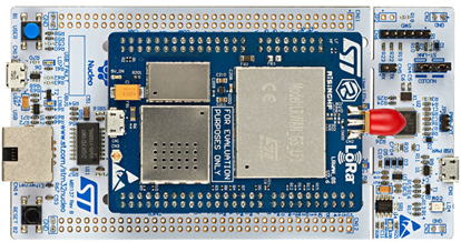

  • A packet LoRa forwarder, in this case the STM32F7 Nucleo from the P-NUCLEO-LRWAN2 package is used, but any other packet forwarder should work.

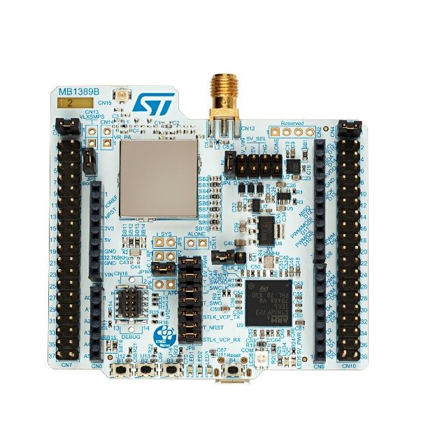

  • An end node, in this case STM32WL, but any LoraWAN node is possible to use, e.g. from the P-NUCLEO-LRWAN2 package.
1 End Node - STM32WL
2 Packet forwarder - STM32F7 Nucleo + RisingHF module

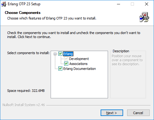

  1. The installation of the Erlang is a simple ‚wizard‘ procedure.

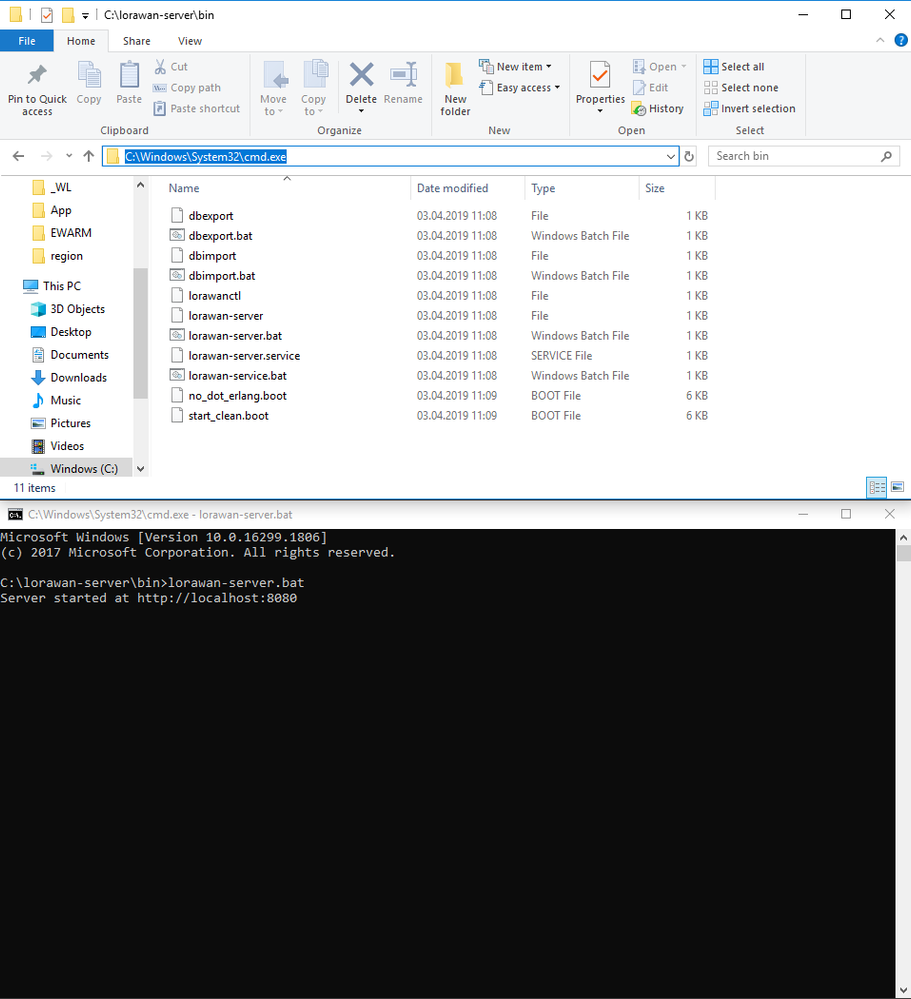

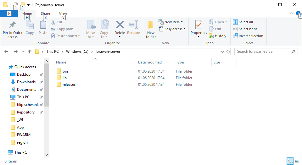

  1. After unpacking the Nwk server it should look like this:
  1. Now it should be possible to run the server. On Windows, go to the bin folder and write ‘cmd’ into the folder address. Write ‘lorawan-server.bat’ into the console and the server should start. DO NOT CLOSE THIS WINDOW.

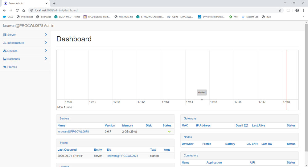

  1. Now the http server administration has started alongside with the Nwk server and it is possible to login to http://localhost:8080/ using username ‚admin‘ and psw ‚admin‘.

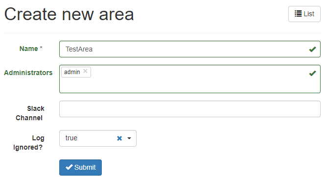

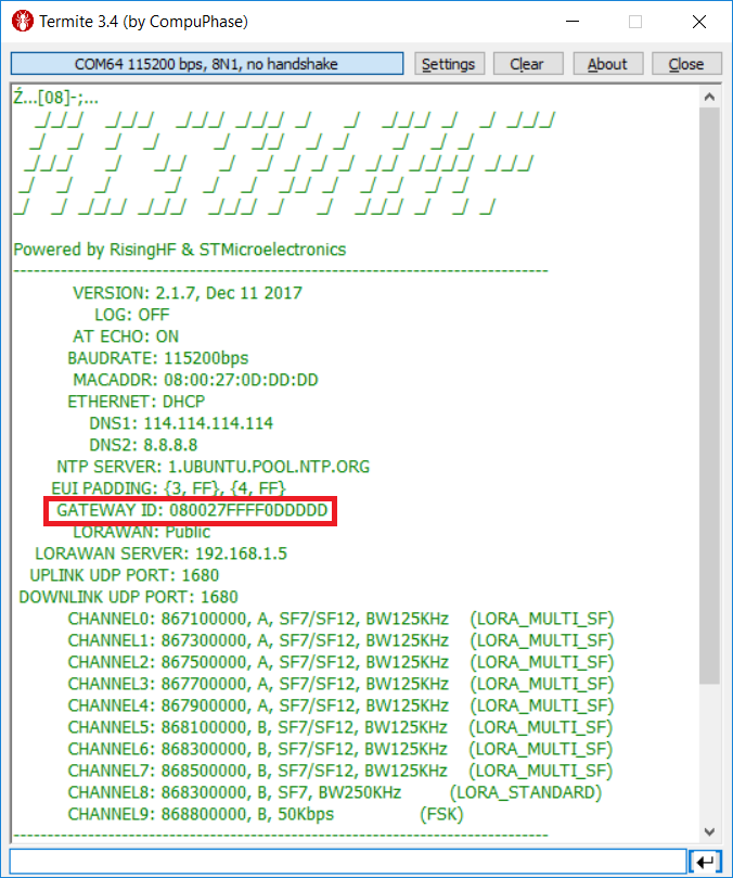

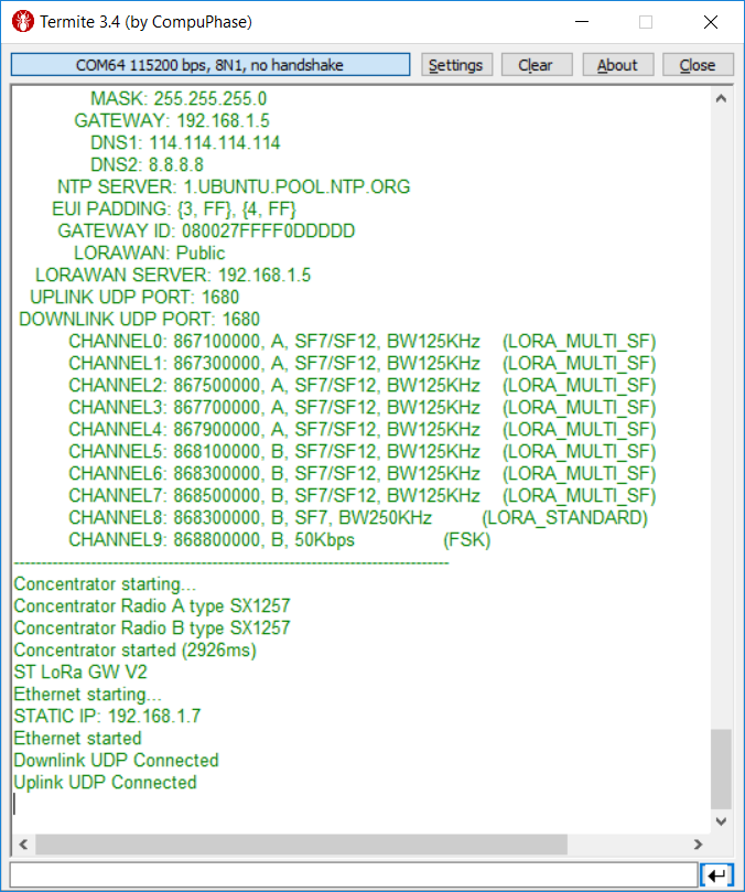

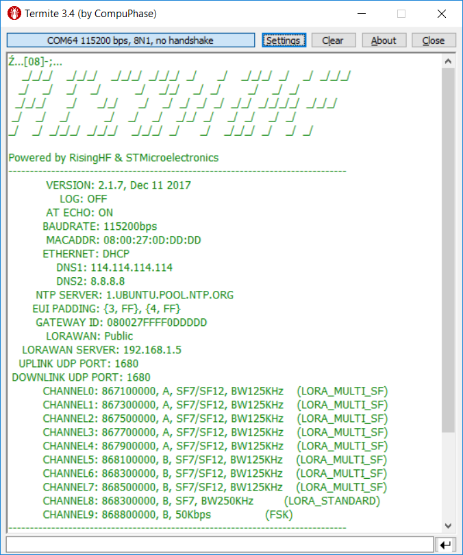

First, to get the necessary information – GW MAC, we need to plug in the GW/packet forwarder and point it to our server. The F7 GW in this tutorial has AT command interface available via the ST-Link virtual COM port. To connect to it, simply plug in the micro usb cable to the blue extension board to power the GW and another micro usb cable to the ST-Link side. By default, the driver should be automatically installed, and the device should be able to connect. The connection parameters are 115200bps, 8bits, 1 stop bit, no parity. It is possible to use any com port terminal, in this tutorial it is Termite.
After powering the GW, or toggling the black Reset button, something like this should appear:
The GW can be anywhere in your local network, what is important, that the GW has an assigned IP address and that the LoraWAN server IP is pointing to the PC hosting the server. In this tutorial, I use direct wire connection to a laptop, so a static network must be defined in the Internet setting in Windows. Therefore, the steps 1-2 are not needed if the GW is connected to a router with DHCP IP assignment.

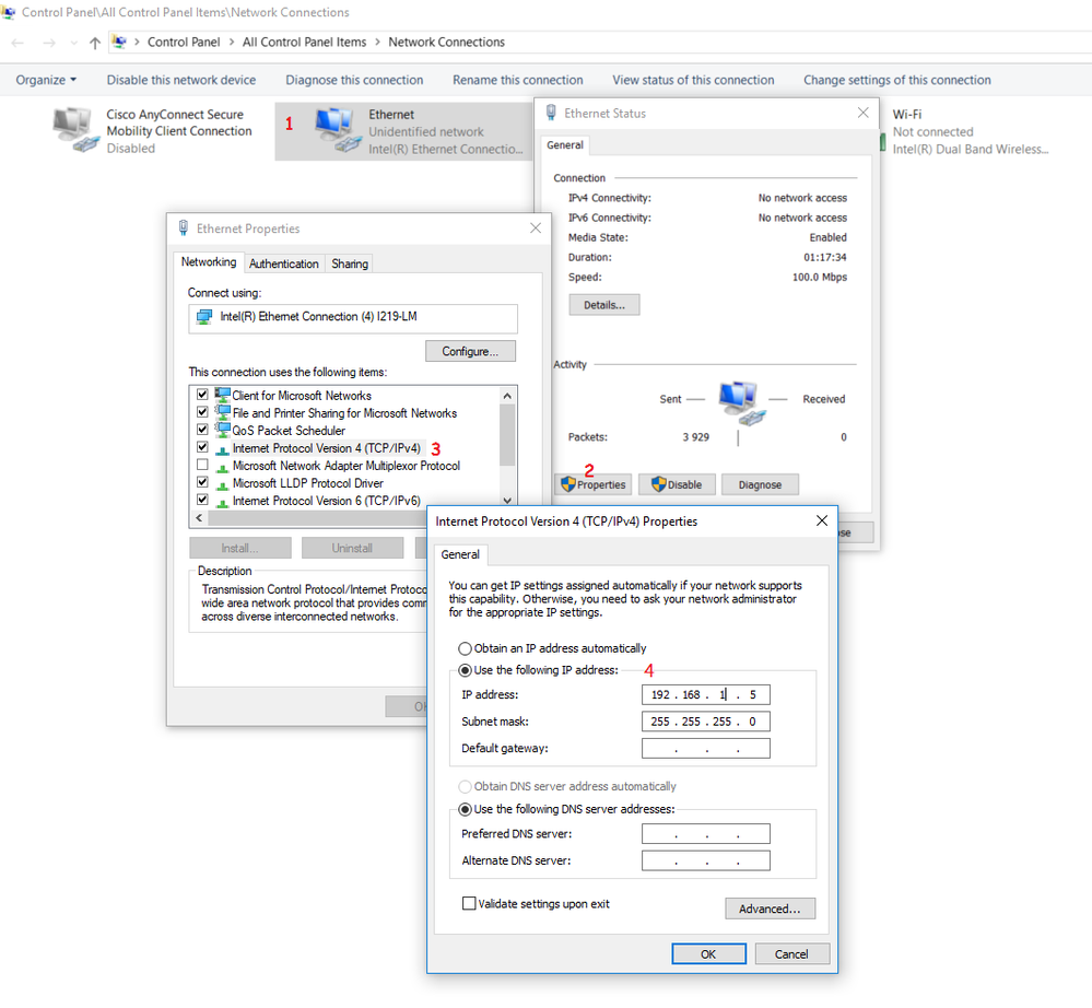

  1. In the system tray right click on your internet connection, Network & Internet settings, Change adapter options.
  1. 1. Adapter options, 2. Open its properties, 3. Open IPV4 settings, 4. Set IP, e.g. 192.168.1.5 for the PC, with subnet mask 255.255.255.0

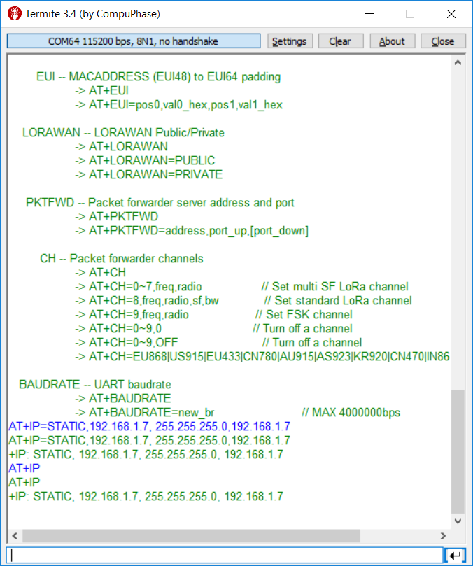

  1. Open again the GW terminal, send AT+HELP for the list of commands, one of the commands is AT+IP=STATIC,ip,netmask,gateway which we can set in following way: AT+IP=STATIC,192.168.1.7, 255.255.255.0,192.168.1.5
  1. To point the GW to our server, use command AT+PKTFWD=address,port_up,[port_down], in this case: AT+PKTFWD=192.168.1.5,1680,1680
  2. Now reset the GW and it should be able to establish a UDP connection with the server 38.png
  3. If the connection was not successful, check the firewall settings and allow any connection the Windows pop up.

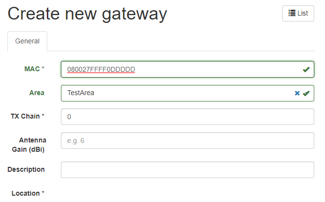

  1. Now it is possible to fill out the GW MAC – ID to the adding a GW form

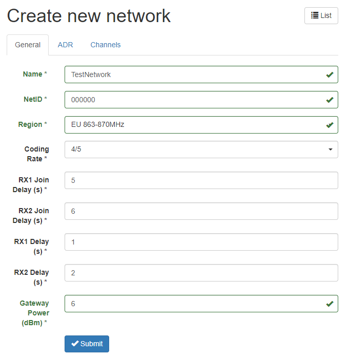

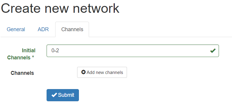

  1. Adding a network

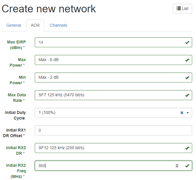

To add a network, Region depends on the country, in this case EU 863-870MHz, NetID can be 000000 for private network, Max Data Rate should be SF7 for EU. The rest can be left at default/suggested values. Just to note, not every parameter is required, but when one is missing, sometimes the popup window to inform the user does not appear. 40.png

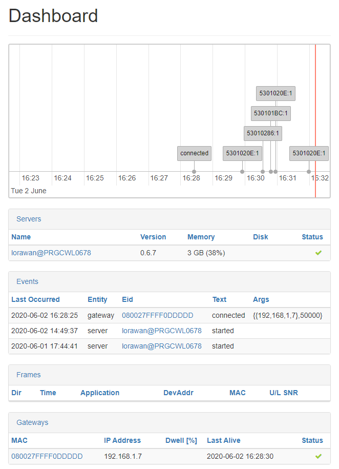

  1. If we now look back at our running server, we should see a GW connection in the dashboards, with some motes from the GW.

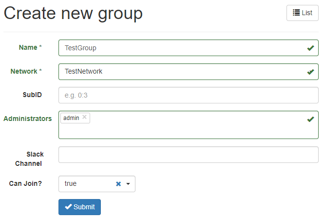

Last step on the network server side is to define a group for devices which will be added. To do that, again a few steps is needed:

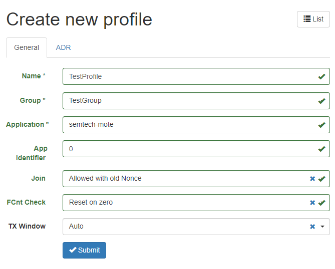

  2. Create a profile. Join and FCnt check is modified to avoid possible errors when resetting devices too often. Application – by default it is semtech-mote layer embedded in this LoRaWAN server, later we will change it to our Application server. ADR can be left as is. 46.png

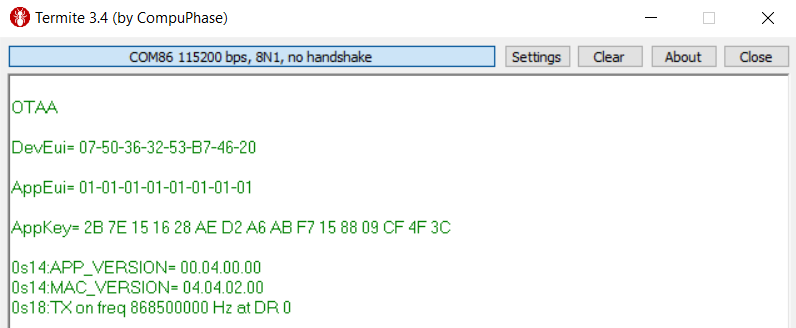

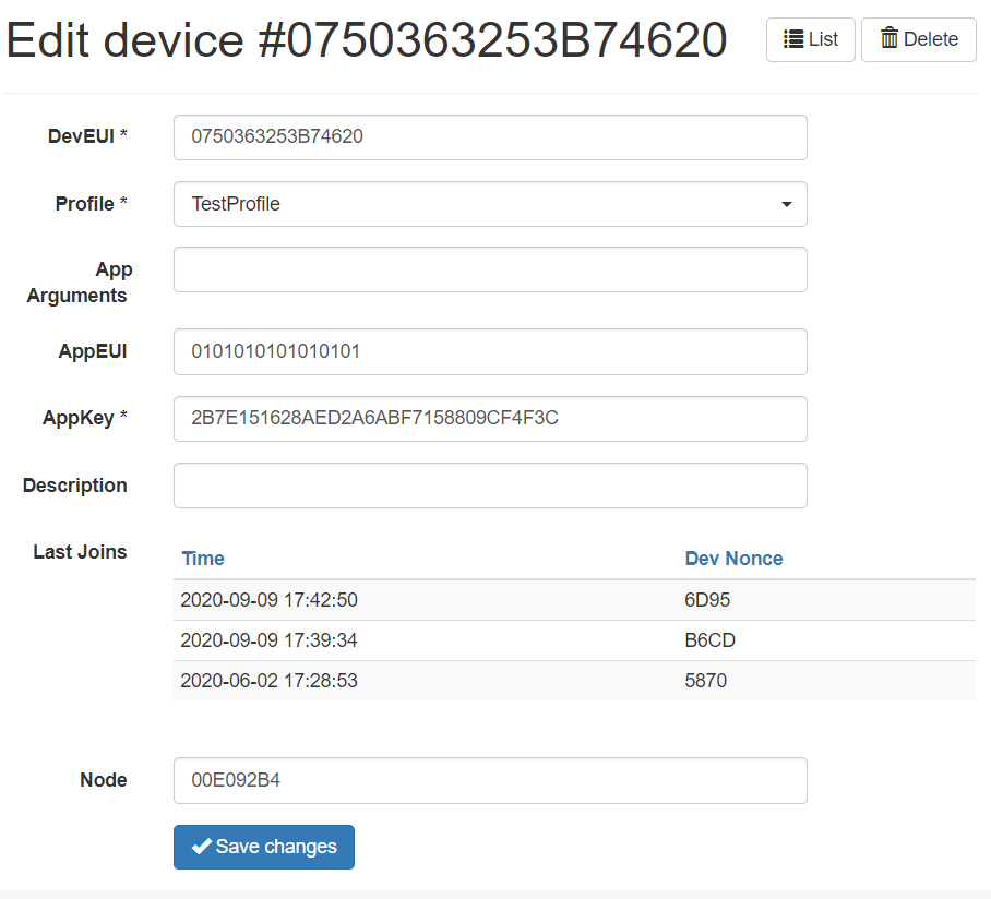

  4. (Optional) If you want to add a device manually, you need to go to Devices -> Commisioned and fill out the form. To find the data, the easiest is to open a terminal with the device and in case of End_Node application all the necessary information will be printed on the screen.
This is a joined device, but the information necessary to be filled is visible as well. Only the Node field is not necessary to fill out, as it is generated automatically by the network.
