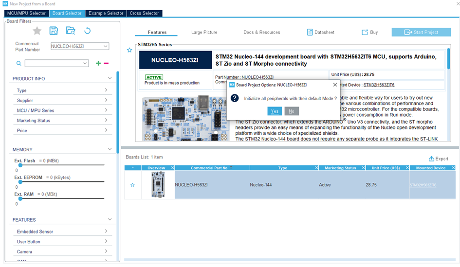

To start, we need to search for and select NUCLEO-H563ZI in the Board Selector
STM32CubeMX Board SelectorSTM32CubeMX Board Selector
 When prompted whether to initialize all peripherals with their default modes or not, select No.

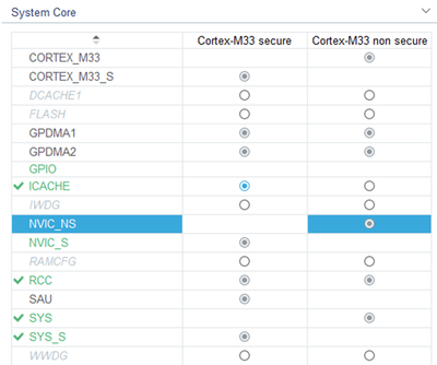

Enable TrustZoneEnable TrustZone
Since we want our project to utilize TrustZone®, we need to select the option "with TrustZone activated."

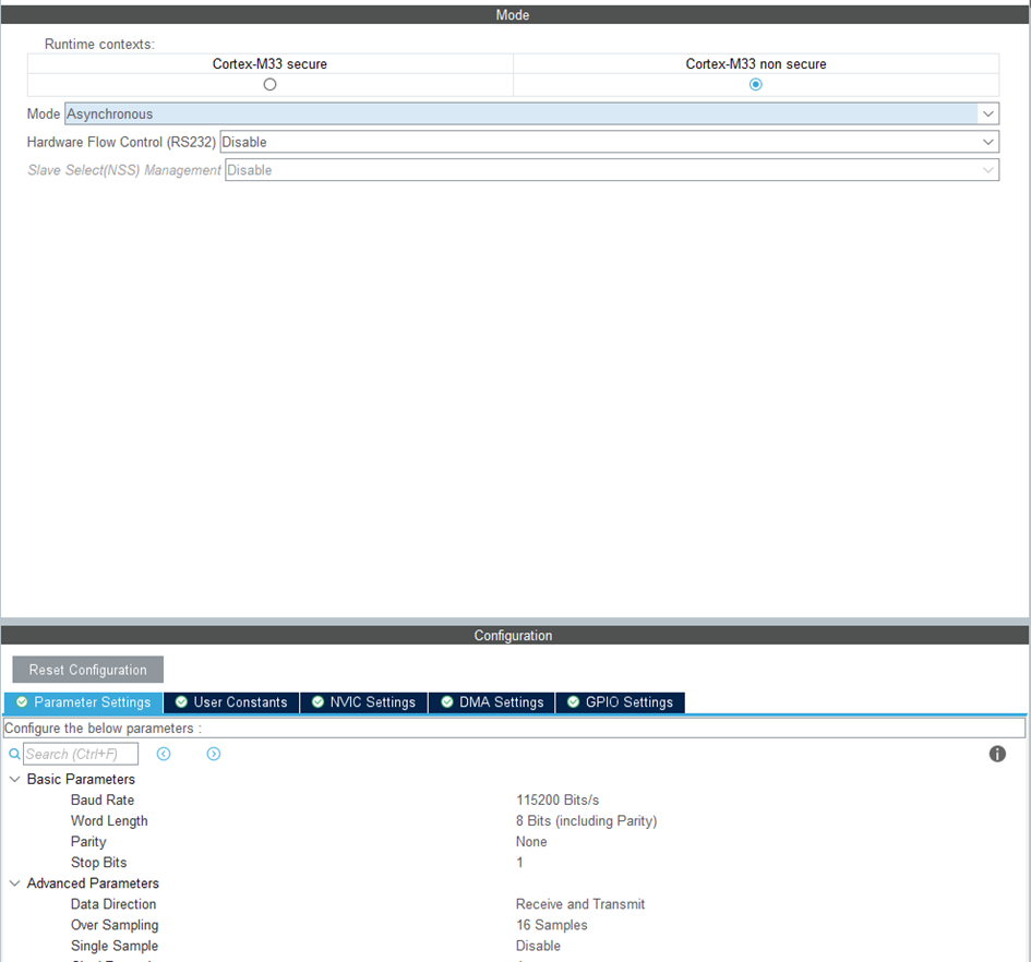

To visualize the state of our application and debug messages, we need to start by setting up a UART communication connected to the onboard STLINK. Doing so gives the ability to print the IPv4 address and incoming data on the terminal emulator.
We start by enabling USART3 in the "nonsecure" runtime context and set the mode to asynchronous. We do not have to change any other settings as the default configuration already suit our needs:
UART configurationUART configuration

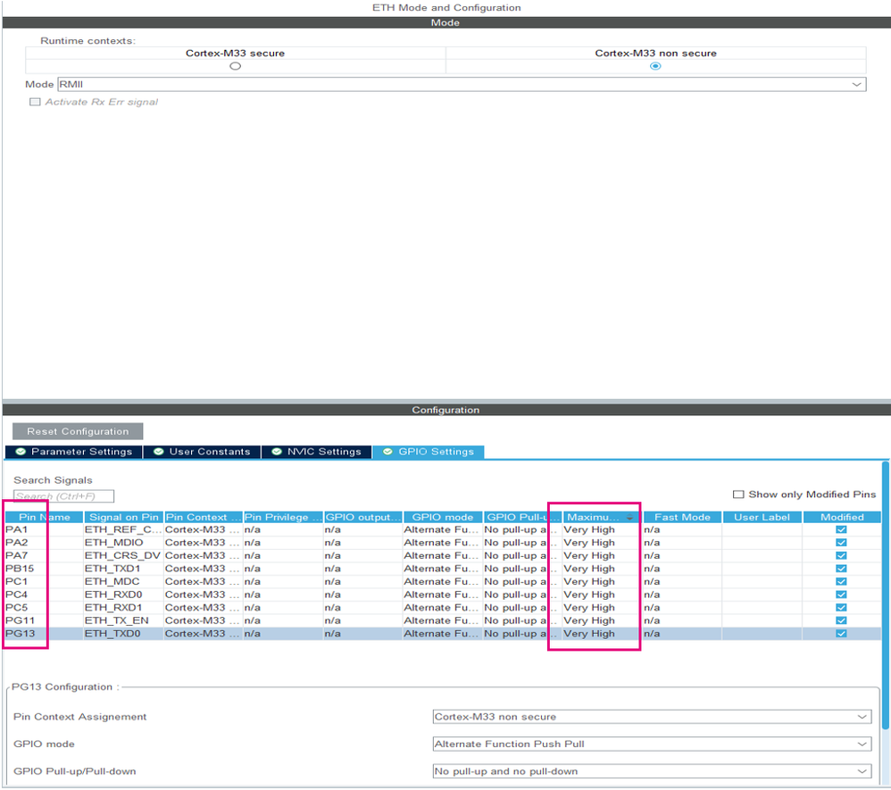

To run this application, select the ETH peripheral and assign it to the nonsecure runtime context as an RMII interface.
ETHERNET pinoutETHERNET pinout
We change some settings of the GPIOs for the ETH peripheral to reflect the board layout. Also, the setup of GPIO speed in ETH GPIO settings to "Very High" speed.
Next, we need to alter the ETH peripheral settings by changing the "Maximum Output Speed" to "Very High" in the GPIO tab and reassigning the following GPIOs:
ETH_TXD0 -> PG13
ETH_TX_EN -> PG11

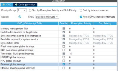

After doing so, we enable the "Ethernet Global Interrupt" in the NVIC settings to enable interrupt handling as shown in the figure below. This is automatically assigned to the NVIC_NS. If you have other interrupts to handle, you need to be careful when assigning other priorities as other high-priority interrupts could lead the Ethernet peripheral to stop functioning.
STea_7-1707240344837.pngNVIC settingsNVIC settings

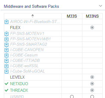

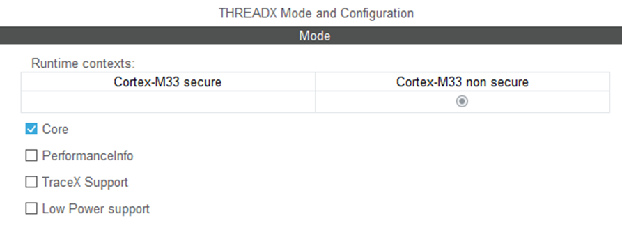

To handle the communication, we need to enable both ThreadX and NetxDuo.
ThreadX is used as an RTOS (Real time operating system) for the initialization tasks. As for NetxDuo, it is used in the task creation that handles UDP traffic.
Middleware inclusionMiddleware inclusion

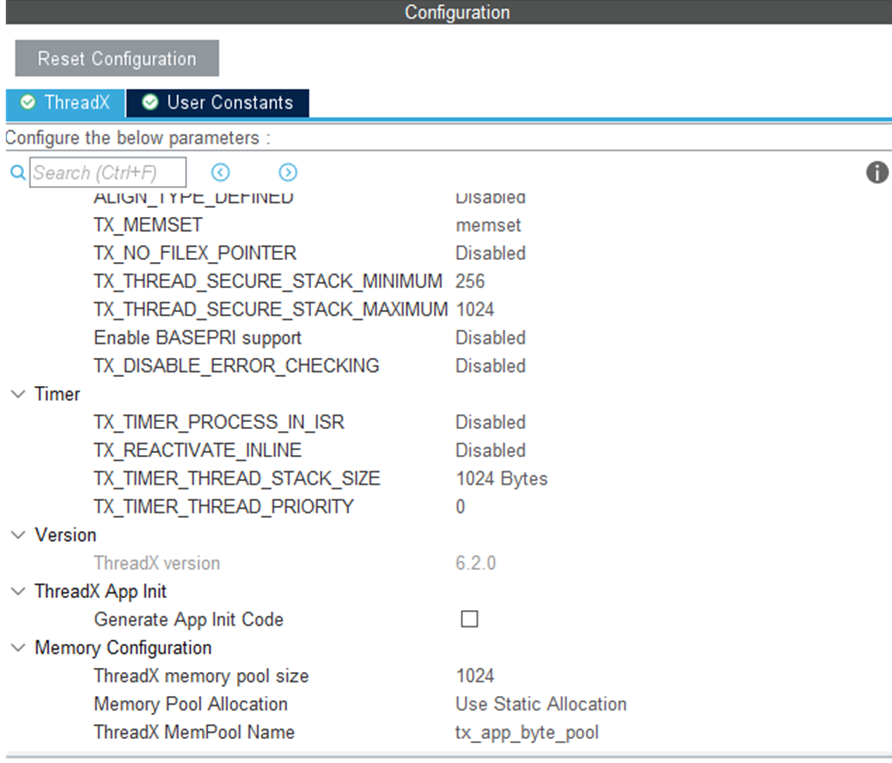

4. ThreadX configuration
Note that the ThreadX configuration can be modified according to the application. For example, the stack usage and memory pools allocated can be increased based on the number of threads handled by the RTOS.
ThreadX configurationThreadX configuration

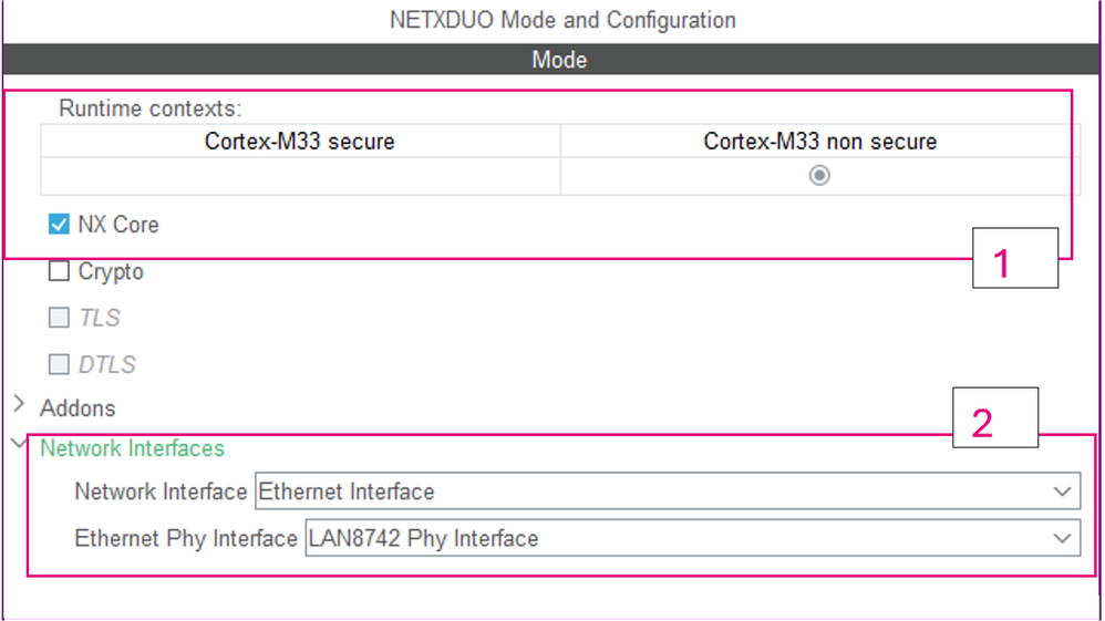

5. NetXDuo configuration

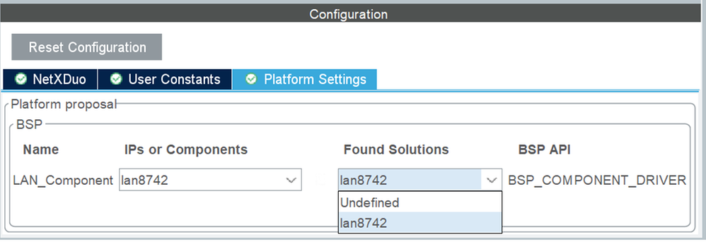

For the NetXDuo core middleware, we need to enable and assign it to the nonsecure runtime context.
The network interface should be set to "Ethernet interface" and the "Ethernet phy interface" to "LAN8742 phy interface." This is necessary for the middleware to identify the physical interface it uses, so that it can prepare the proper initialization code for it (see figure section 2 above.)

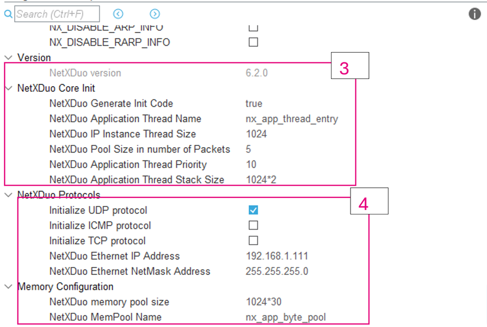

In the NetXDuo tab, it is recommended to consider changing the NetXDuo memory pool size to 30 K (1024 *30) Furthermore, the stack size to 2048 (1024*2) to allow for more flexibility in allocating packets and increasing stack sizes (see figure section 3 below).
NetXduo configurationNetXduo configuration
Additionally, it may be beneficial to adjust the IPv4 address to a more distinctive host address, depending on the specific needs and constraints of the application. As our demo utilizes the UDP protocol, we need to enable it in the configuration. These parameters can be customized to optimize the performance and functionality of the application (see figure section 4 above.)

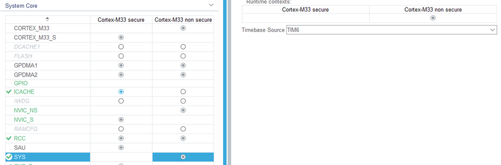

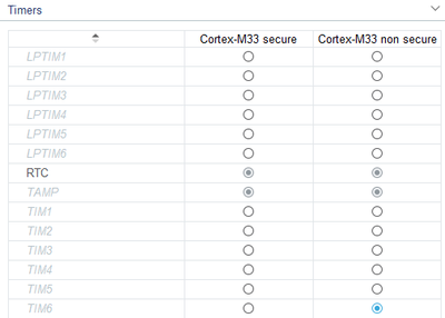

6. Changing the system time base to accommodate ThreadX
When using an RTOS, it is configured by default to use the SysTick timer to manage the timing of its threads. Since the default configuration for HAL libraries is to use SysTick for its timing operations, we must change the timebase for the system so that only ThreadX uses the SysTick.
In the following configuration, the "SYS timebase source" is set to TIM6 thus it needs to be assigned to the nonsecure runtime context first.
Timebase accommodationTimebase accommodation

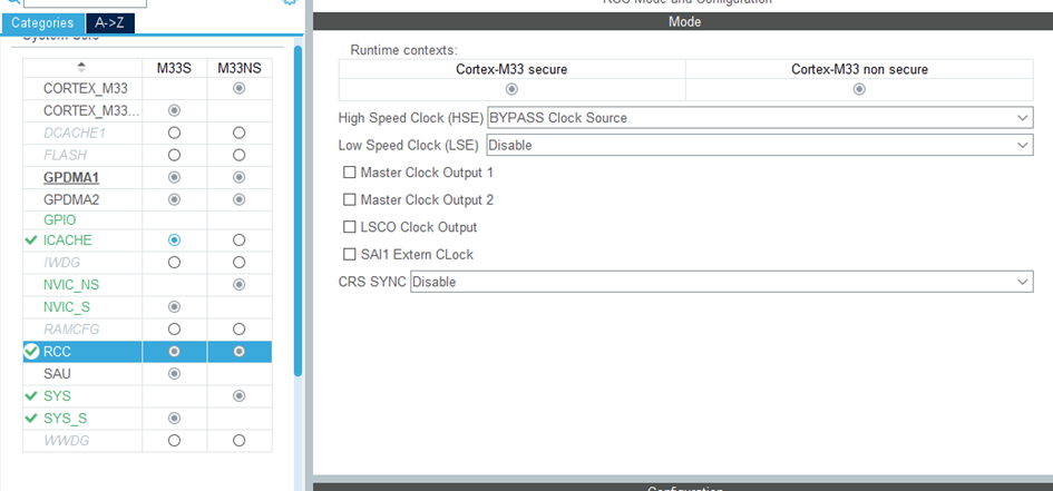

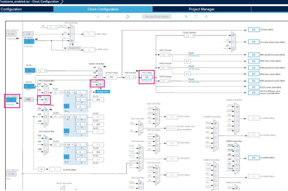

7. Clock configuration
All that is left for the CubeMX configuration is to set up the clock. To do so, we need to adjust the RCC settings before we can access the clock configuration tab. We start by setting HSE to "BYPASS Clock Source" as this Nucleo board sources a highly accurate reference 8MHz clock via the STLINK's clock output. It is advised to utilize an external, accurate, and stable high-speed oscillator. An example could be a quartz oscillator rather than an internal one when working with Ethernet applications.
STea_16-1707241583499.pngClock configurationClock configuration
That is it for the STM32CubeMX configuration. Navigate to the project manager tab, give your project a name, and generate the code for STM32CubeIDE

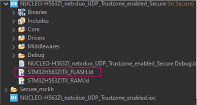

We need to add some code to the linker file before we can move on to the application-level code. We must ensure that the linker considers the fact that the Ethernet descriptors and NetX memory pool are located inside a particular memory address range. Our configurations are not considered by the default linker file initial configuration. Start by opening the STM32H563ZITX_FLASH.ld linker file.
linker file of secure projectlinker file of secure project
By default, the linker already has a definition for the RAM in which our descriptors and Ethernet Rx buffers are written:
MEMORY
  RAM    (xrw)    : ORIGIN = 0x30000000,   LENGTH = 320K
  FLASH    (rx)    : ORIGIN = 0x0C000000,   LENGTH = 1016K
  FLASH_NSC    (rx)    : ORIGIN = 0x0C0FE000,   LENGTH = 8K
 Now, we just need to add a new memory section somewhere in the SECTIONS brackets in the linker file.

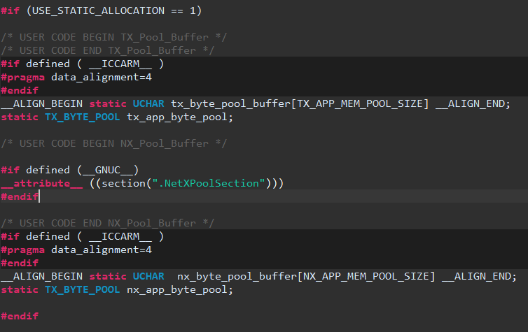

In the "app_azure_rtos.c" file of the nonsecure project, we need to add the following definition for the NX_Pool_Buffer as shown in the figures below:
/* USER CODE BEGIN NX_Pool_Buffer */
#if defined (__GNUC__)
__attribute__ ((section(".NetXPoolSection")))
#endif
/* USER CODE END NX_Pool_Buffer */

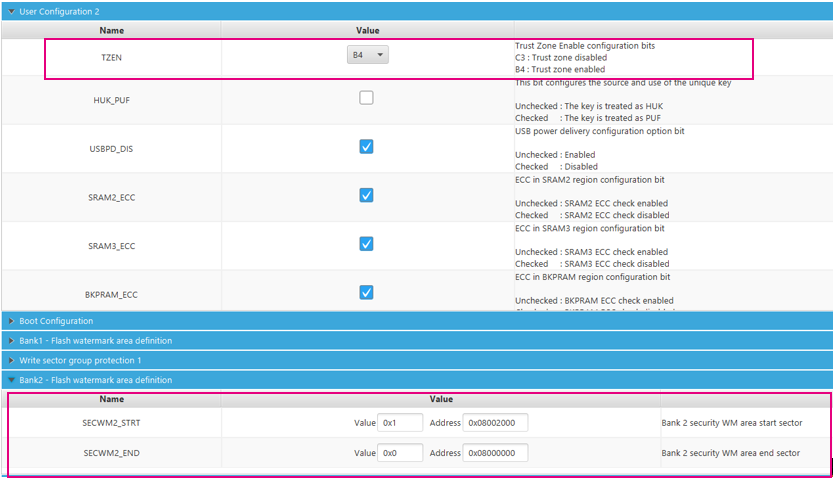

10. STM32CubeProgrammer configuration
In this section, we describe the option bytes configurations needed for this application.
User option bytes requirement (with STM32CubeProgrammer tool)
- TZEN = B4 System with TrustZone-M enabled
- SECWM1_STRT=0x0 SECWM1_END=0x7F All 128 sectors of internal flash Bank1 set as secure
- SECWM2_STRT=0x1 SECWM2_END=0x0 No sector of internal Flash Bank2 set as secure, hence Bank2 nonsecure
option byte config in CubeProgrammeroption byte config in CubeProgrammer

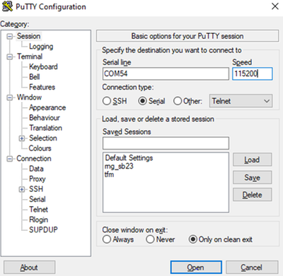

With the board plugged in, open a serial communication terminal with putty:
putty configurationputty configuration

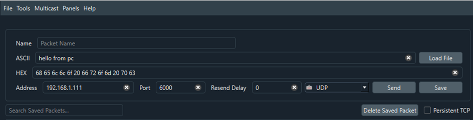

For testing, we can use the packet sender tool with or echotool, which can be found on GitHub:
https://packetsender.com/
Release EchoTool · PavelBansky/EchoTool (github.com).
Both tools support sending UDP messages as well as other protocols.

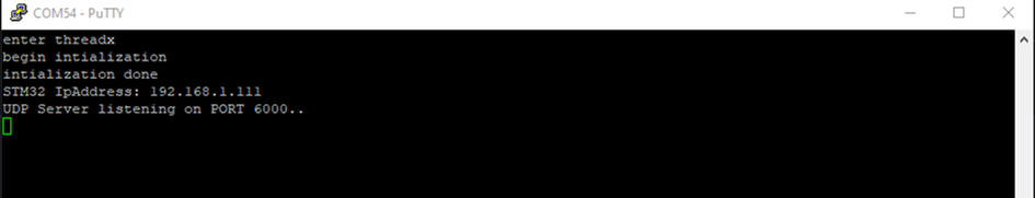

Before we can send any packets to the device, we need to connect the H563 board to a router or the pc and assign the correct IP address. It is also important that the addresses you have assigned to the H563 in the software align with the subnet of your router. You may need to open your router settings in a web browser for this information.
With the board hooked up to the router, plugged into a PC via USB, and PuTTY configured, if you reset the board, you should see the IPv4 address, and UDP port printed on the console:
Putty logPutty log
In the packet sender we can configure the UDP packet to customize these parameters, send the packets over the network, and see the messages print out on the terminal:Echotool configurationEchotool configuration
