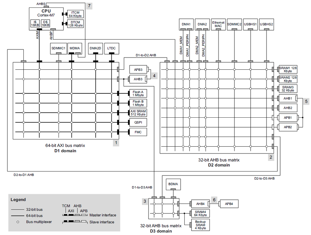

As we previously explained, most of STM32H7 devices consist of three bus matrix domains (D1, D2, and D3) as seen on the picture below.
D1 and D2 domains are connected through bus bridges, both can also access data in D3 domain. However, there is no connection from D3 domain to D1 or D2 domain.
The DMA1 and DMA2 controllers are located in D2 domain and can access almost all memories with exception of ITCM and DTCM RAM (located at 0x20000000). This DMA is used in most cases.
BDMA controller is located in D3 domain and can access only SRAM4 and backup SRAM in D3 domain.
MDMA controller is located in D1 domain and can access all memories, including ITCM/DTCM. This controller is mainly used for handling D1 peripherals and memory transfers between domains.
In the previous figure, we can see that USBHS1 and USBHS2 are located in D2 domain and have no interconnection with DTCM RAM which is the default memory used in approximately all USB projects. Therefore when enabling the internal DMA USB, projects do not work, as DMA will not be able to access the data buffers placed in DTCM and it results in DMA transfer error.

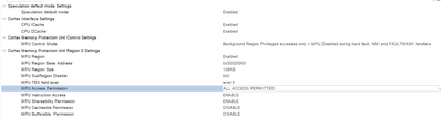

  • Disable D-Cache for part of the memory: use MPU to change DMA buffers to non-cacheable (device mode)

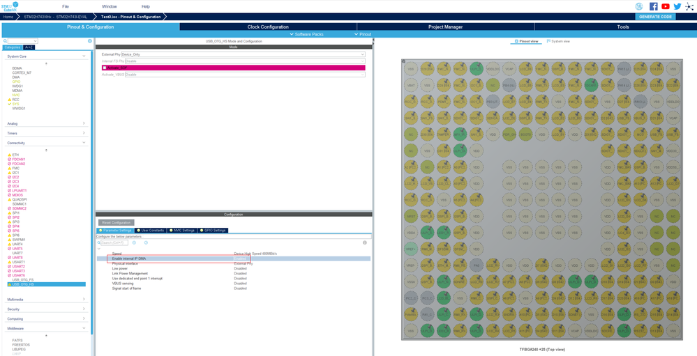

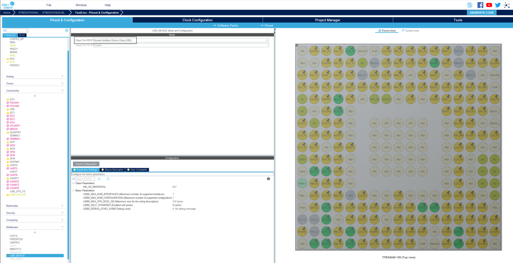

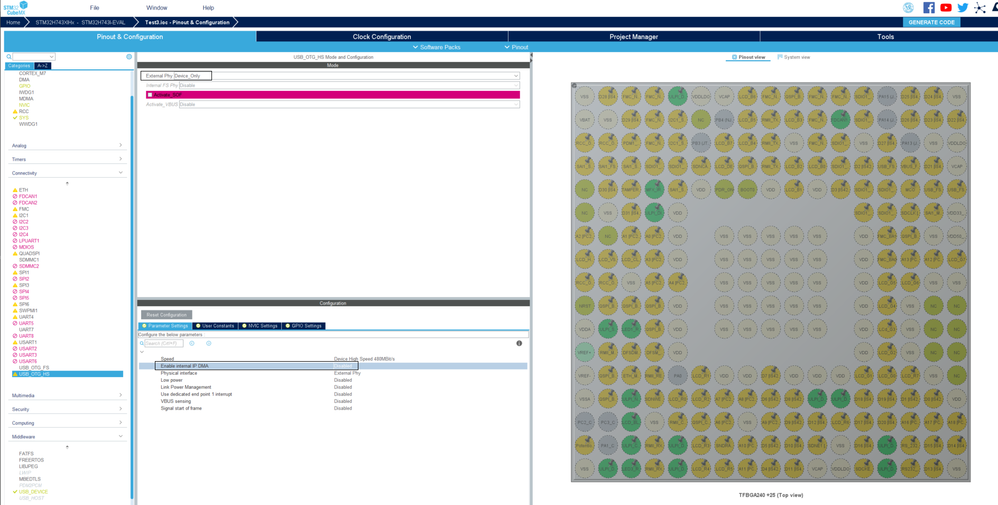

  • Project Creation & Generation: In this section, we will create and generate the USB project using STM32CubeMX. We will take as example the Human Interface Device Class (HID) USB HS application, but this is applicable for all other USB Device and Host projects. The following figure shows the configuration that should be set:

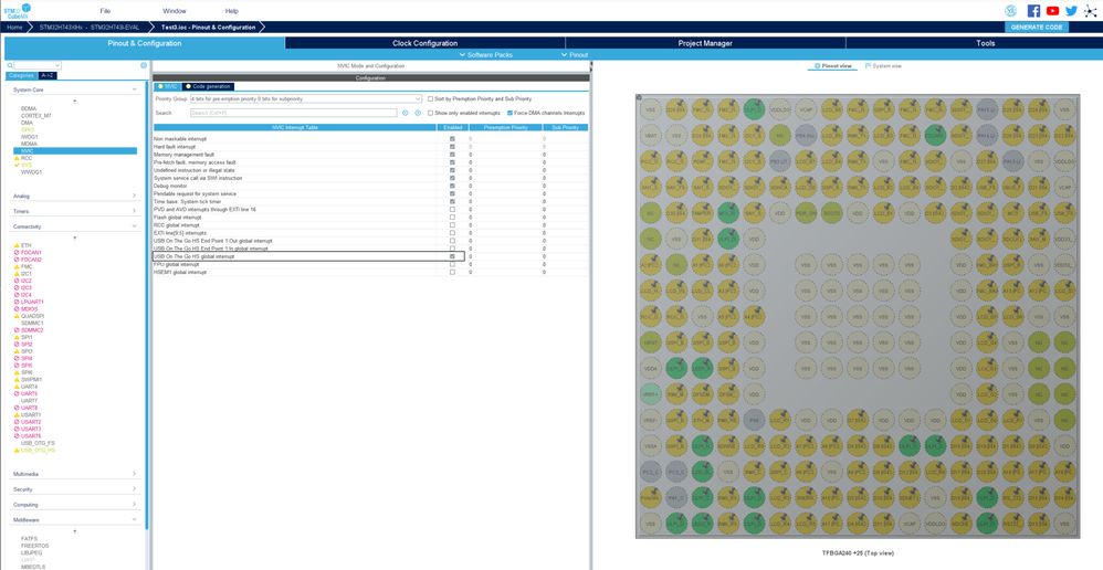

    Now, we will enable DMA IP:

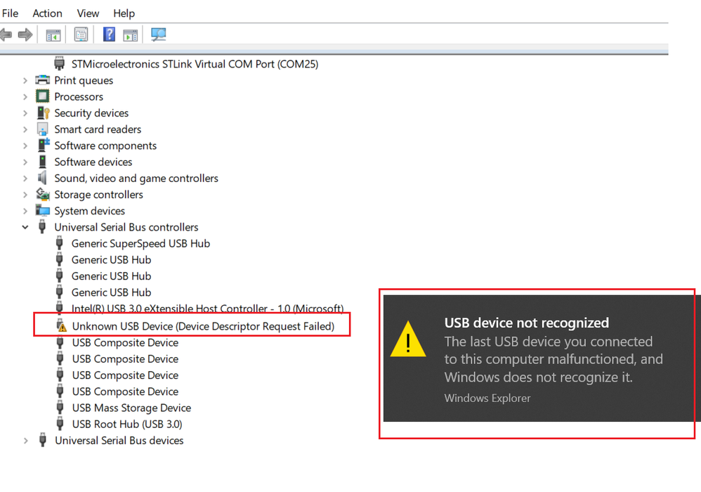

    After generating the project, you can remark that enumeration is lost and your laptop cannot detect HID device properly anymore.

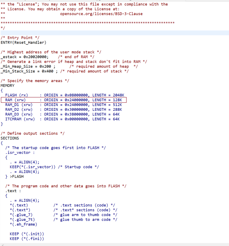

    The default memory allocation generated by STM32CubeMx and used by most of USB application in the STM32CubeH7 Firmware package is DTCM, which is not accessible by USB. After referencing to the corresponding reference manual, you can find memories accessible by USB under System Architecture section. So let change the DTCM memory with another one which is accessible by USB, for example AXI SRAM 0x2400 0000.

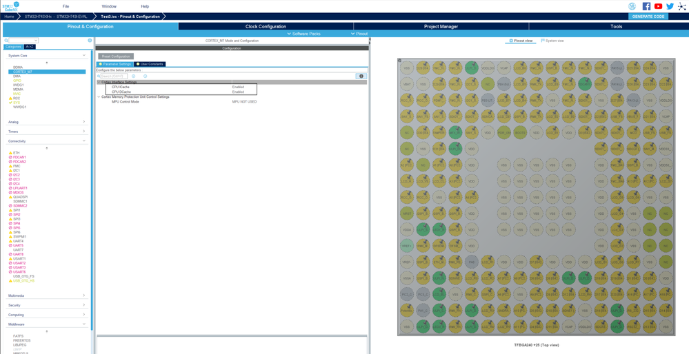

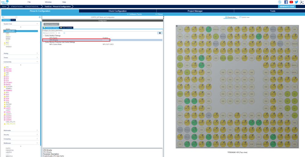

    Unfortunately, this configuration is not enough, but for the purpose of the example we will apply the simpler solution to confirm that the issue is related to data coherency. We will disable the data cache as explained previously.

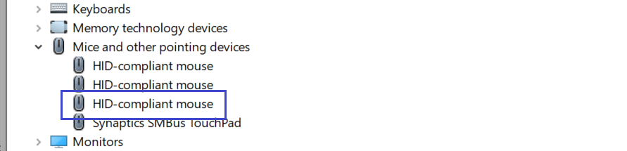

    Now, you can see your HID-compliant mouse device is well enumerated by Device Manager.

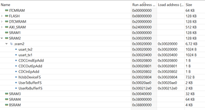

Really it start working when D-Cache disabled and all data placed in AXI_SRAM.
But what need change if I want place all input and output buffers in SRAM2 region ?
program payload buffers not a question, means all what need related to USB_CDC DMA data?
By manual SRAM2 closer to USB than AXI_SRAM. I can send data using massive placed at SRAM2 and USB HAL data at AXI_RAM. but once I enable D-Cache, catch Hard_fault. USB completely no init.
( SRAM2 (rw) : ORIGIN = 0x30020000, LENGTH = 128K)
trying one by one place HAL USB_CDC components to SRAM2 from AXI_SRAM, useless :(
