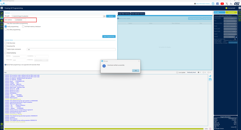

This method uses the STLINK interface (JTAG/SWD) and an external flash loader.

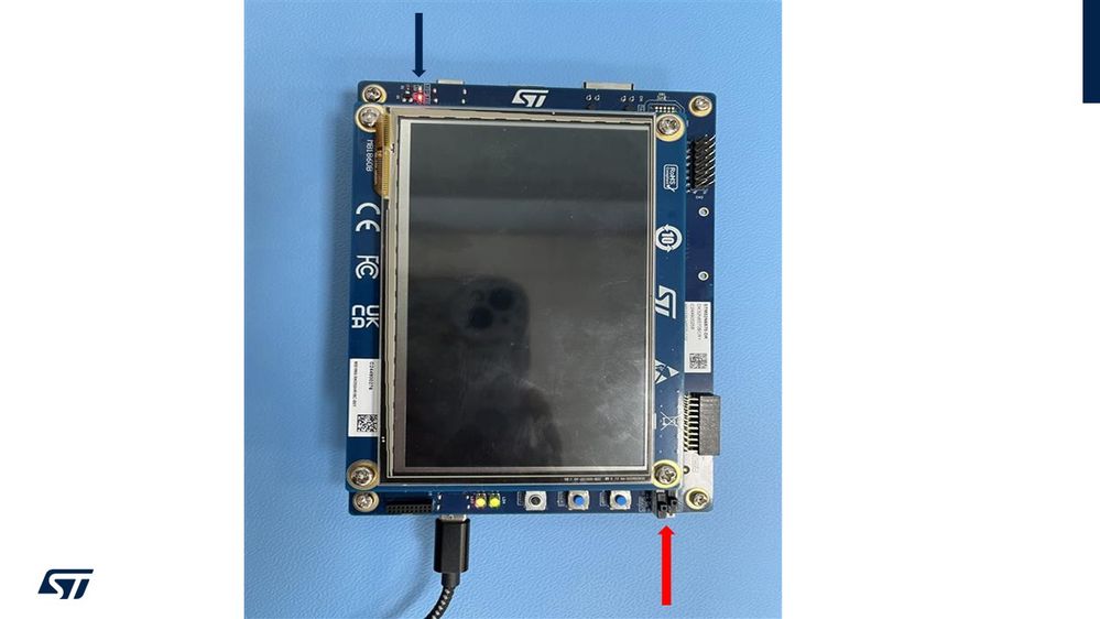

1. Ensure that the BOOT1 pin is set to 1. For custom boards, consult your board schematic to identify the exact pin.

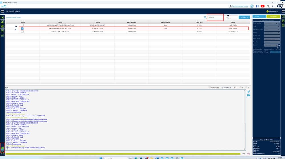

2. In STM32CubeProgrammer:
Select STLINK and try to connect.
Select the external loader for the STM32N6570-DK(NOR_FLASH).
3. Add the .bin file.
In this article, a simple GPIO_Toggle example with a trusted binary is used. Refer to the example readme file on how to add a header to the generated binary.
Note: The NOR Flash start address is 0x70000000.
To run your program, ensure that the BOOT pins are configured as follows: BOOT0 = 0 and BOOT1 = 0, then reset the board.

1. Configure BOOT pins for serial boot:
  • BOOT0 = 1
  • BOOT1 = 0

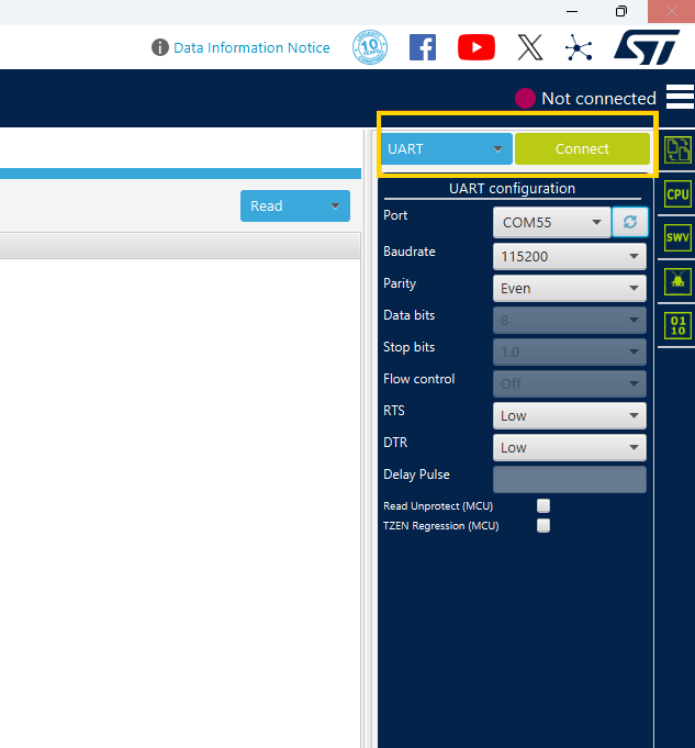

2. Select the UART interface in STM32CubeProgrammer.
If you are using a Nucleo board or the STM32N6570-DK, the default interface is the Virtual COM Port (VCP), where the UART functions over USB. If you are using a custom board, you need an external UART connection compatible with the STM32N6 series boot ROM pins.

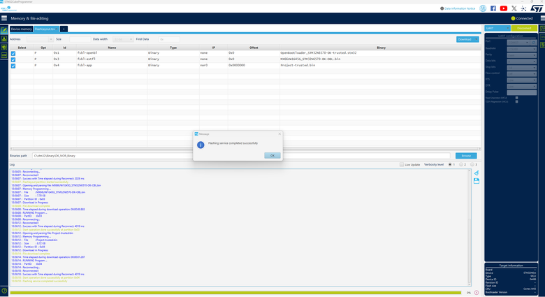

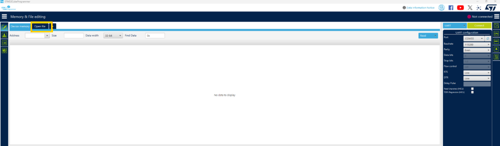

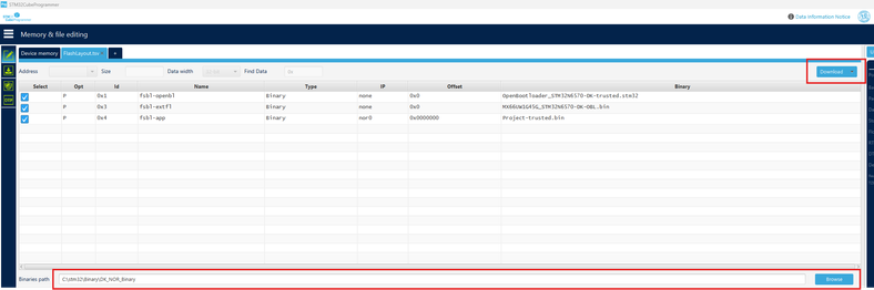

3. Navigate to the "Memory & File editing" tab and select [Open file].
4. Open the FlashLayout.tsv file located at:
STM32Cube_FW_N6_V1.2.0\Projects\STM32N6570DK\Applications\OpenBootloader\Binaries\NOR_Binary\
5. Browse the \Binaries\ path and download the file.
6. Click [Download]. This action loads the new first stage bootloader (FSBL).
Set the device to FLASH boot mode to execute the new FSBL.
