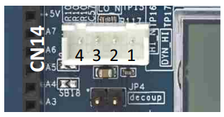

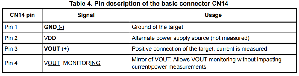

Step 1. Locate CN14 on your STM32 power shield – this is a 4-pin connector that can be used to supply and measure the target board’s consumption using wire connections. Each pin’s description and usage are described in the following table. For more information on this please see UM2243 (STM32 Nucleo Expansion Board for Power Consumption Measurement).

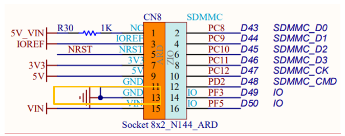

Step 2. Connect the STM32 power shield’s CN14 pin 1 (GND) to a GND pin on your STM32 board. We will use Pin 13 on CN8 of the Nucleo-U575ZI-Q as our ground reference.

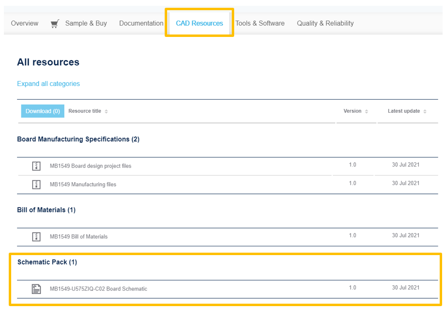

Step 3. Locate the IDD measurement pin on your STM32 board by checking the schematic of your board. Each STM32’s respective board schematic can be found on the board’s landing page under the CAD resources tab.

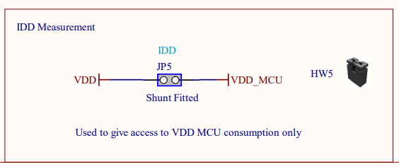

We will need to remove the jumper on JP5, and establish a connection between the VDD_MCU of the Nucleo-U575ZI-Q board and the STM32 power shield's pin 3 (VOUT(+)).
Unfortunately, the pin orientation on the schematic doesn’t necessarily align with the pin orientation on the board. Therefore, we’ll need to take an extra step and use a multimeter to perform a connectivity test to figure out which pin on JP5 is connected to VDD_MCU.

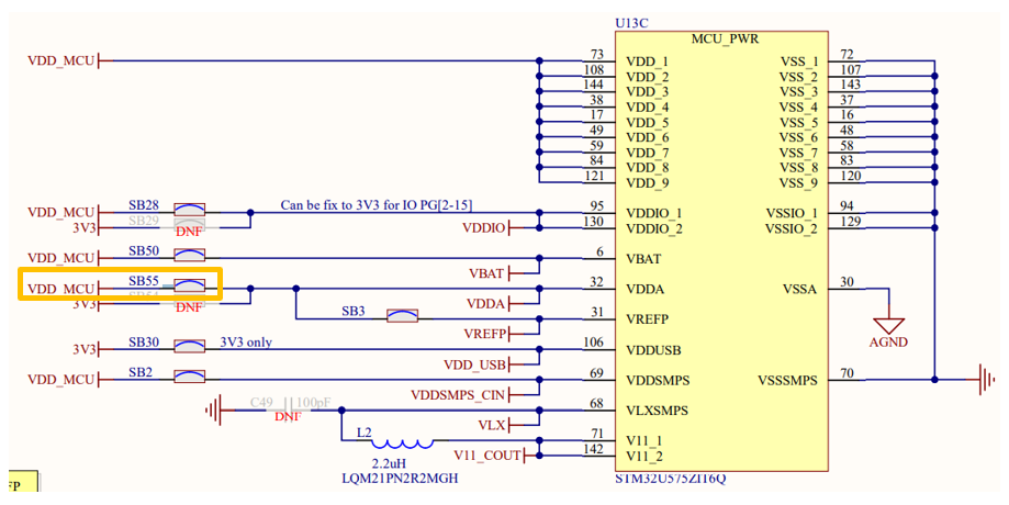

On the Nucleo-U575ZI-Q schematic we’ll need to locate another point of connection to VDD_MCU which in this case is SB55.
After performing the connectivity test and verifying the pin on JP5 that is connected to VDD_MCU, we then will connect the STM32 power shield’s CN14 pin 3 (VOUT (+)) to the VDD_MCU pin on JP5 of the STM32 board.
