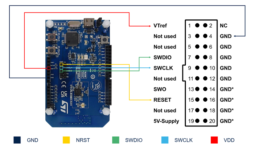

2. STEVAL-IDB012V1 and J-Link Debug Probe Pin Connections
On the STEVAL-IDB012V1 board, connect the BlueNRG-LPS SWD pins (left-hand side of CN7) and CN2 GND & VBAT pins to the following pins on the J-Link debug probe.
Signal STEVAL-IDB012V1 J-Link debug probe
SWCLK
Pin 8 – CN7 (SWCLK)
Pin 9 – SWCLK / TCK
GND
Pin 7 – CN2 (GND)
Pin 4 - GND
SWDIO
Pin 6 – CN7 (SWDIO)
Pin 7 – SWDIO / TMS
NRST
Pin 10 – CN7 (RSTN)
Pin 15 - NRST
VDD
Pin 4 – CN2 (VBAT)
Pin 1 - VTREF
STEVAL-IDB012V1 J-Link ConnectionSTEVAL-IDB012V1 J-Link Connection
Now, power the J-Link debug probe and power the STEVAL-IDB012V1 via the USB Type-C® port.
Launch your J-Link software and connect. Congratulations! You have successfully established a connection between the BlueNRG-LPS on the EVAL board and the Segger J-Link debug probe.
