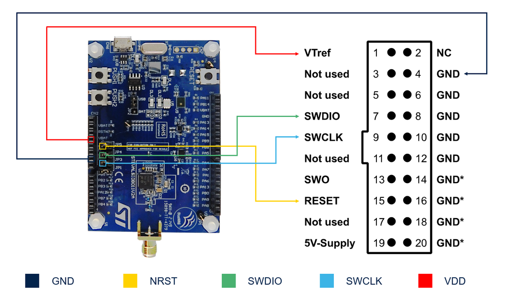

2. STEVAL-IDB011V1/V2 and J-Link Debug Probe Pin Connections
On the STEVAL-IDB011V1/V2 board, connect the BlueNRG-LP SWD pins (left-hand side of JP3, JP4, & JP5) and CN2 GND & VBAT pins to the following pins on the J-Link debug probe.
Signal STEVAL-IDB011V1/V2 J-Link debug probe
SWCLK Pin 1 - JP3 Pin 9 - SWCLK / TCK
GND Pin 7 - CN2 (GND) Pin 4 - GND
SWDIO Pin 1 - JP4 Pin 7 - SWDIO / TMS
NRST Pin 1 - JP5 Pin 15 - NRST
VDD Pin 4 - CN2 (VBAT) Pin 1 - VTREF
STEVAL-IDB011V2 J-Link ConnectionSTEVAL-IDB011V2 J-Link Connection
Now, power the J-Link debug probe and power the STEVAL-IDB011V1/V2 via the Micro-USB port.
Launch your J-Link software and connect. Congratulations! You have successfully established a connection between the BlueNRG-LP on the EVAL board and the Segger J-Link debug probe.
