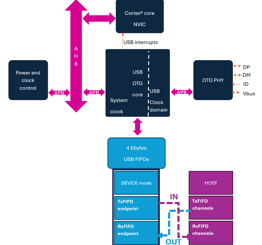

2. FIFO memory organization
The USB OTG controller module in STM32 devices organizes dedicated RAM into multiple Tx FIFOs for transmitting data and a shared Rx FIFO for receiving data.
Receive FIFO (RxFIFO) is used to store data received from the host. The size of the RxFIFO can be configured to optimize performance.
Transmit FIFO (TxFIFO) is used to store data that needs to be sent to the host. Each endpoint can have its own TxFIFO, and the size should be adjusted based on the type of data transfer (for example, bulk, interrupt, isochronous). The application pushes the data to be temporarily stored into this FIFO (in blue) before the USB transmission.

  • IN endpoints: Each active IN endpoint has its own dedicated Tx FIFO buffer.
  • OUT endpoints: All OUT endpoints share a single Rx FIFO buffer.
